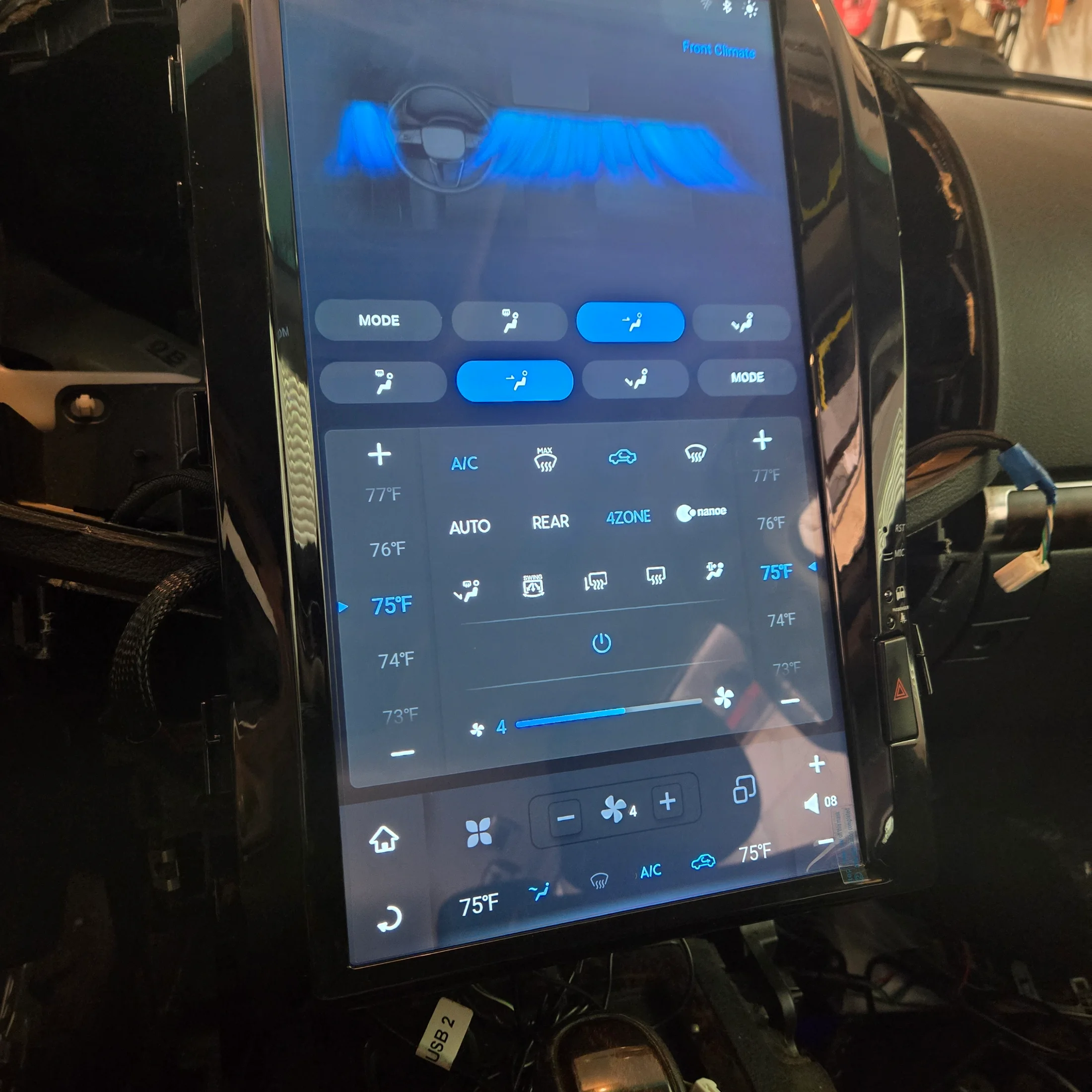

All the hvac buttons work. I havent tested that one specifically as it was close to 100 deg yesterday :)

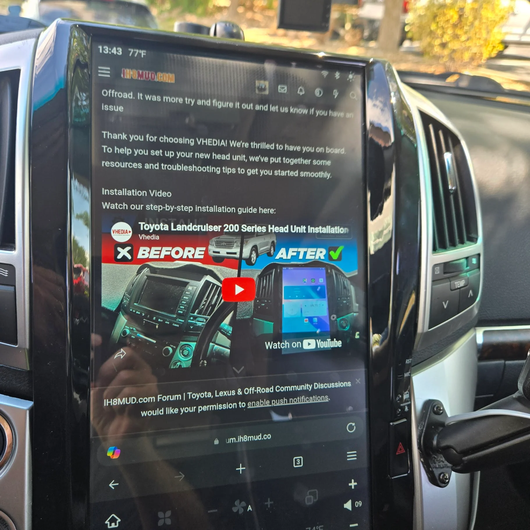

I went through the setup and configuration today and spent quite a bit of time troubleshooting a Chrome browser issue. It works as a web page but wont save bookmarks or synch with my Google account. I couldnt login to Gaia as that logs in through the web page before logging the app in. Gmail etc worked.
I then loaded the Edge browser and everything works fine and was able to login to Gaia. I did send an email asking how to delete the Chrome app so I can reinstall it. It won't allow me to delete or update it.

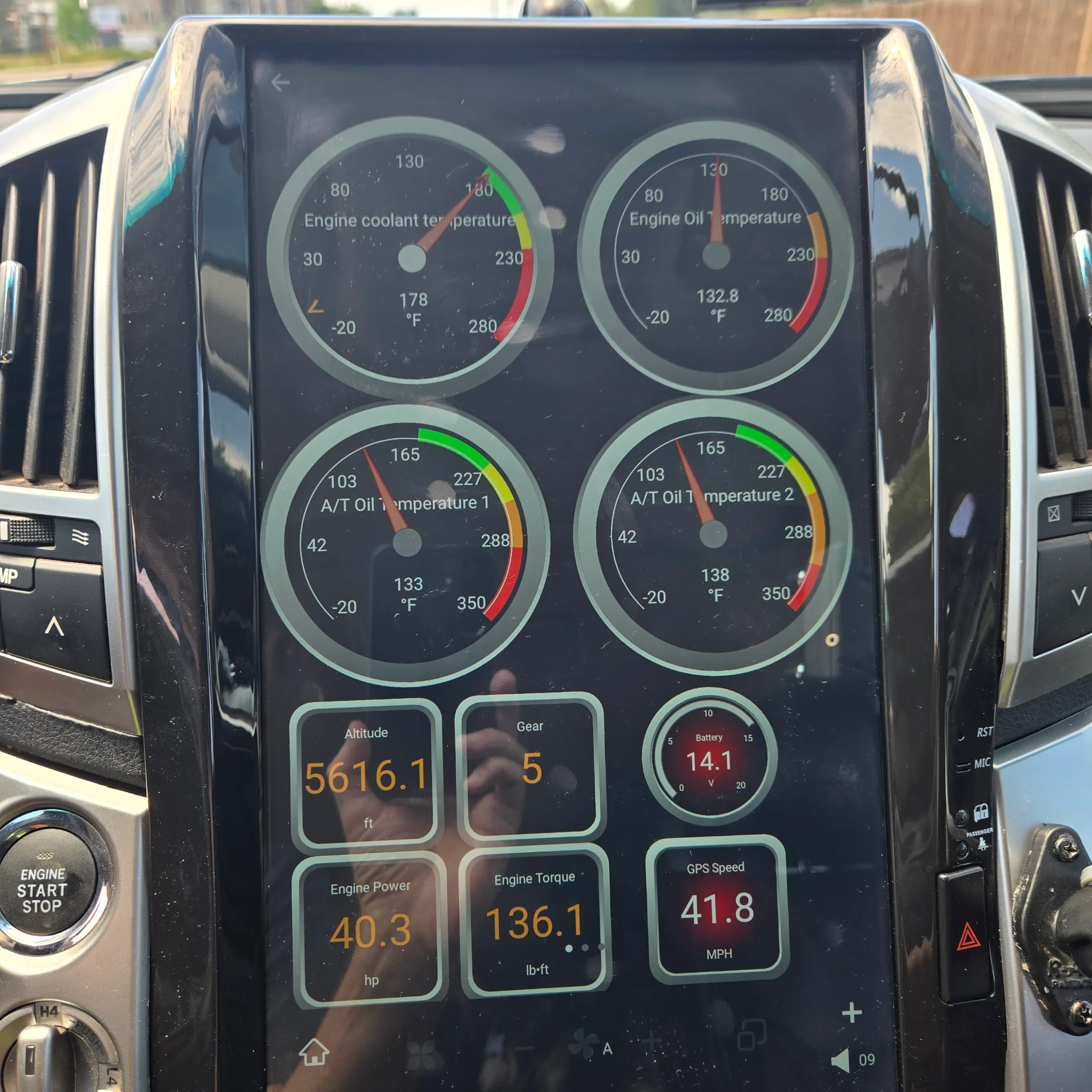

I also updated my OBD Fusion based on inputs from @linuxgod . The hard one to figure out was which was the gear display and he pointed me to ABS/VSC/TRAC as “Status of the gear position / Fail or 1st or 2nd or 3rd…” He also let me know the status of the turque converter can be found under “Engine or Electronically Controller Transmission” as “status of the lock up” I haven't installed that one yet

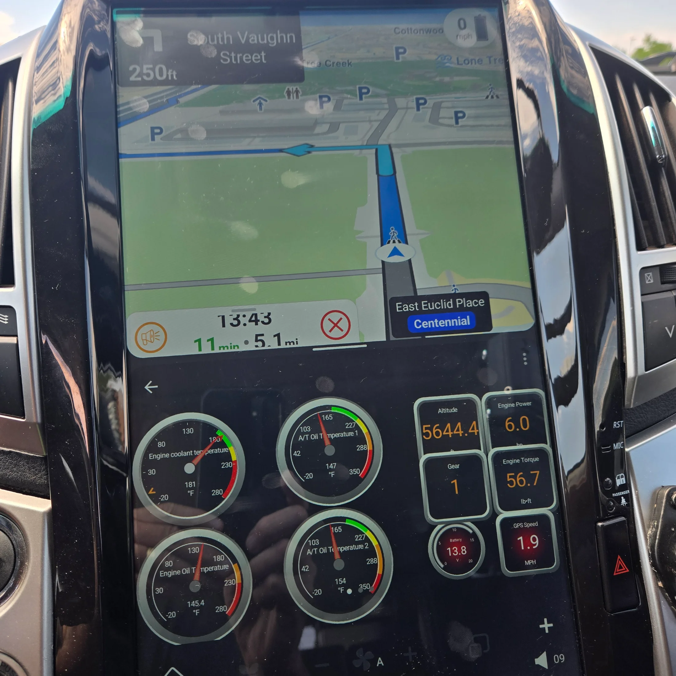

I looked into the split screen using Magic Earth app for navigation and it seemed to work pretty well. I did go in an reduce the number of POIs like the P for parking

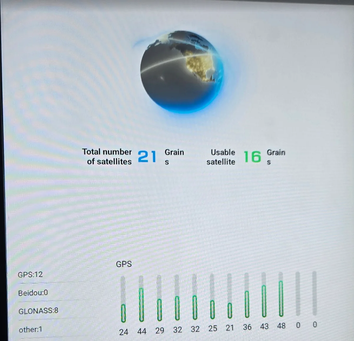

Pretty good GPS reception. I am still using the after market puck I installed for the older unit. Amazon.com: Proxicast Active/Passive GPS Antenna - Through Hole Screw Mount Puck Style with Right Angle SMA Connector on 20 inch Coax Lead - 28 dB LNA (ANT-190-003) : Electronics - https://www.amazon.com/dp/B08RW7R8KH?ref_=ppx_hzsearch_conn_dt_b_fed_asin_title_1

  • HVAC controls work

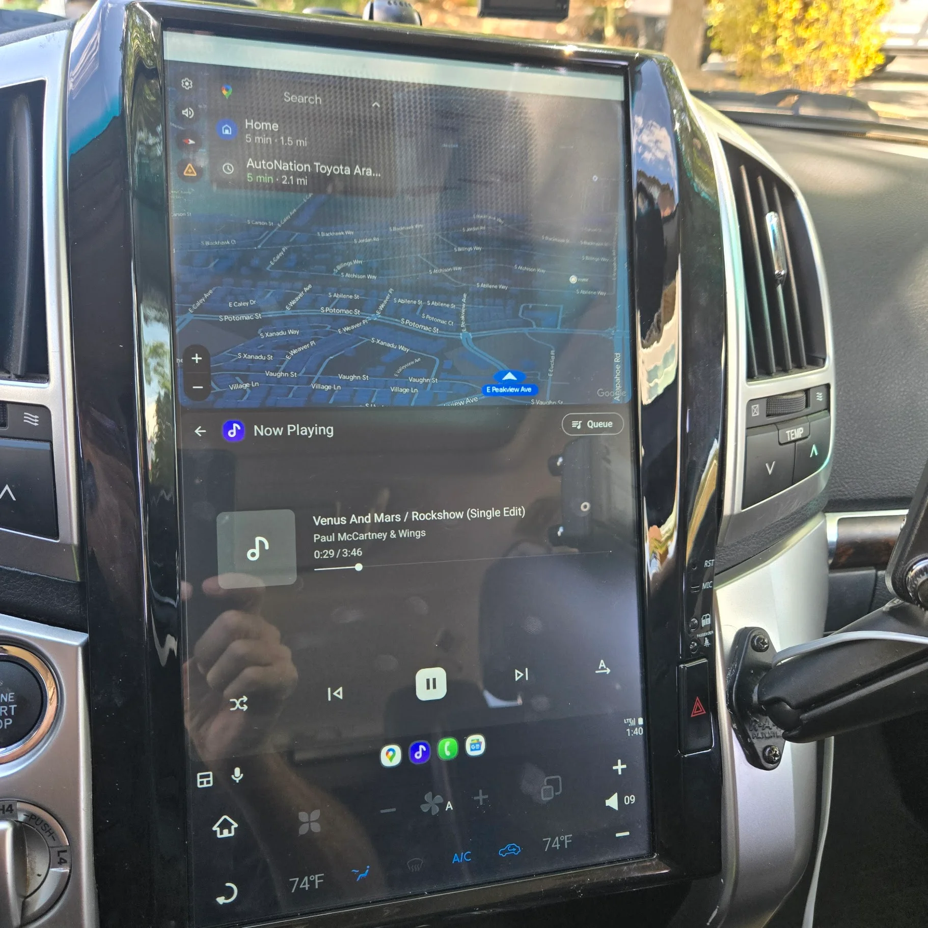

  • I have key OBD data on a screen, split screen to share with Maps, Music or other apps
  • Split screen function works well and you choose the app. However, you can't split screen Android Auto with another app. You can split screen apps within Android Auto from your phone

Vhedia responded pretty quickly. Chrome is built into the firmware and I can update/reinstall the firmware. However, it will delete all the apps I installed and reset all the settings back to factory. It doesn't look like there is a newer version of firmware out. Since I have Edge set up as the browser and everything is working, I think I will leave it be for now. Chrome still works as a browser and all the other google apps work

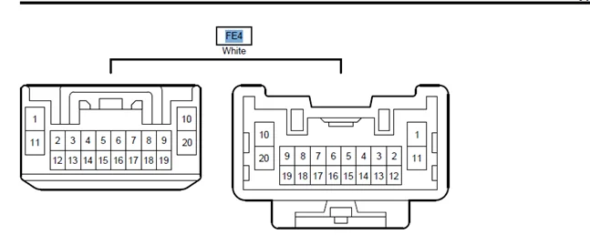

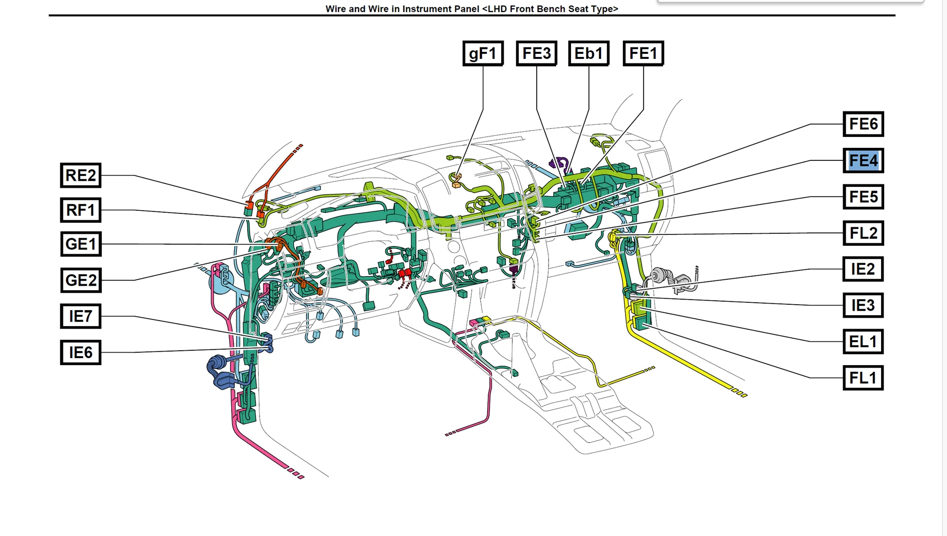

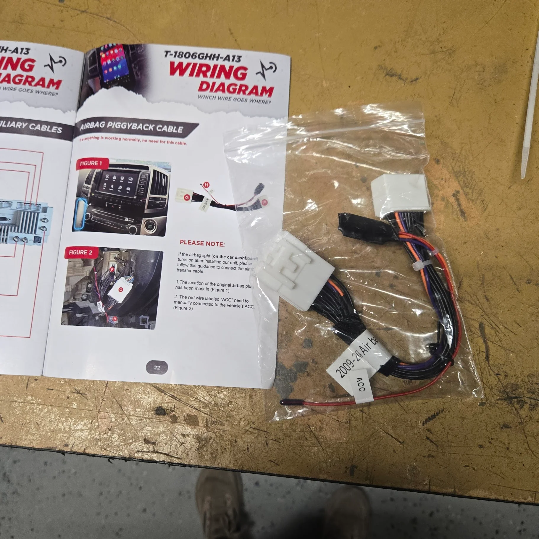

I have had on intermitant issue. The Air Bag light would come on in the dash. I could go several weeks without it, then it would be on at start for a few times and then it would be gone
The instructions say if the Air Bag light does come on, install the provided harness. It says it typically doesnt happen. Its a minor ocurrence for me, but I like to fix issues while they are still fresh, so I installed the harness
Their location of where to insert this harness is poor in the instructions and shows RHD (Aussie wheel on right). Essentially, you have to remove the glove box assembly. This video isnt in English but was helpful and made it quick and easy to remove the Glove Box Assembly

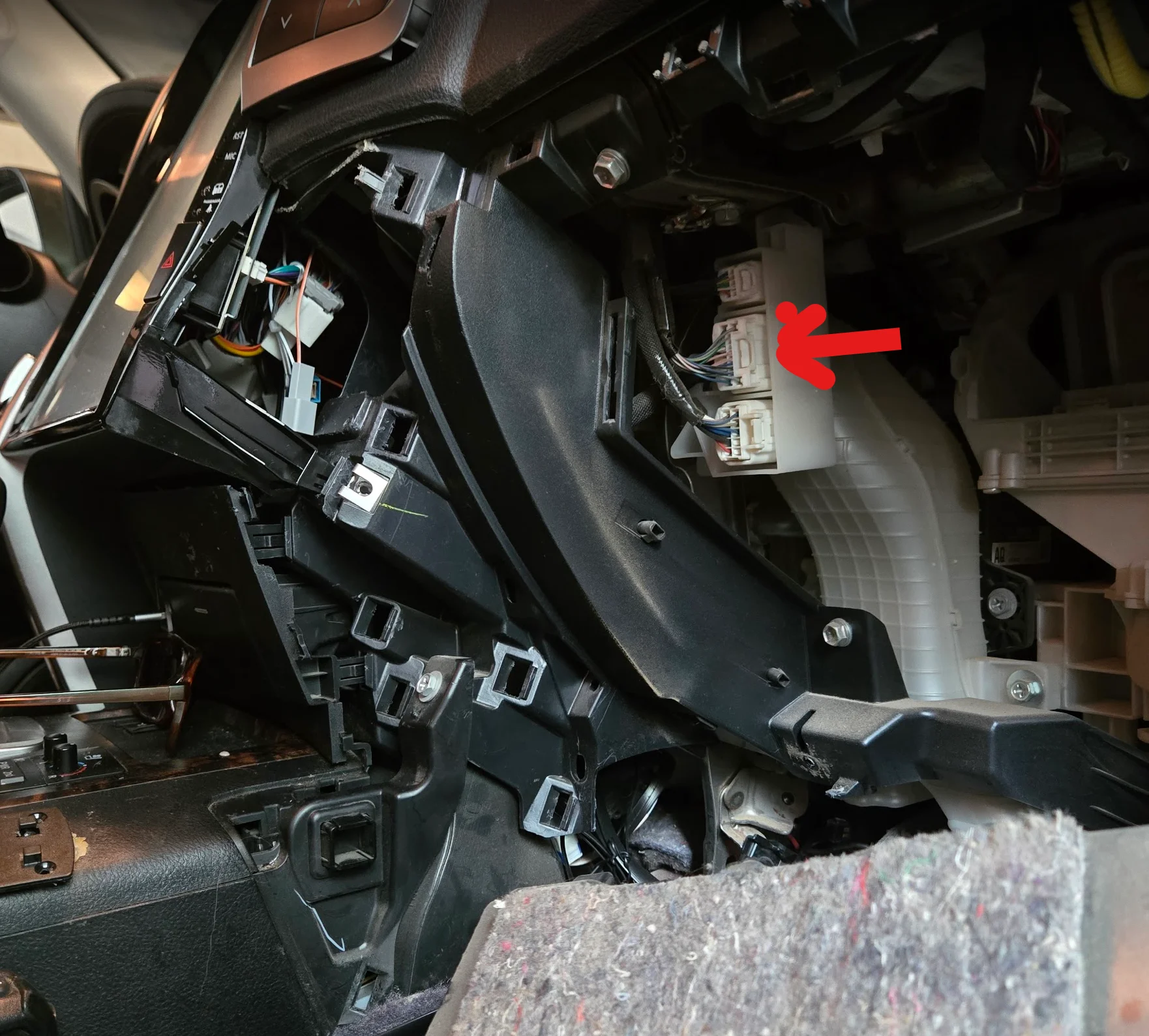

Matching up the connector wiring Diagram with the connector pinout, it is Connector FE4.
I then spliced the 12V wire from the harness into the Cig Lighter power which I verified is tied to ACC
I forgot to take a picture with the harness installed, put you remove FE4 and insert this harness in line and then route the 12V wire to ACC. Figure 2 in the instructions does show it pretty good. I just couldn't tell where it was at first and had to ask Vhedia for a more descriptive location.
It was much easier then I thought it would be. Using the video above, I did have the Glove Box assembly out in 10 minutes. The hardest part was unseating the connector and that took a bit of work.

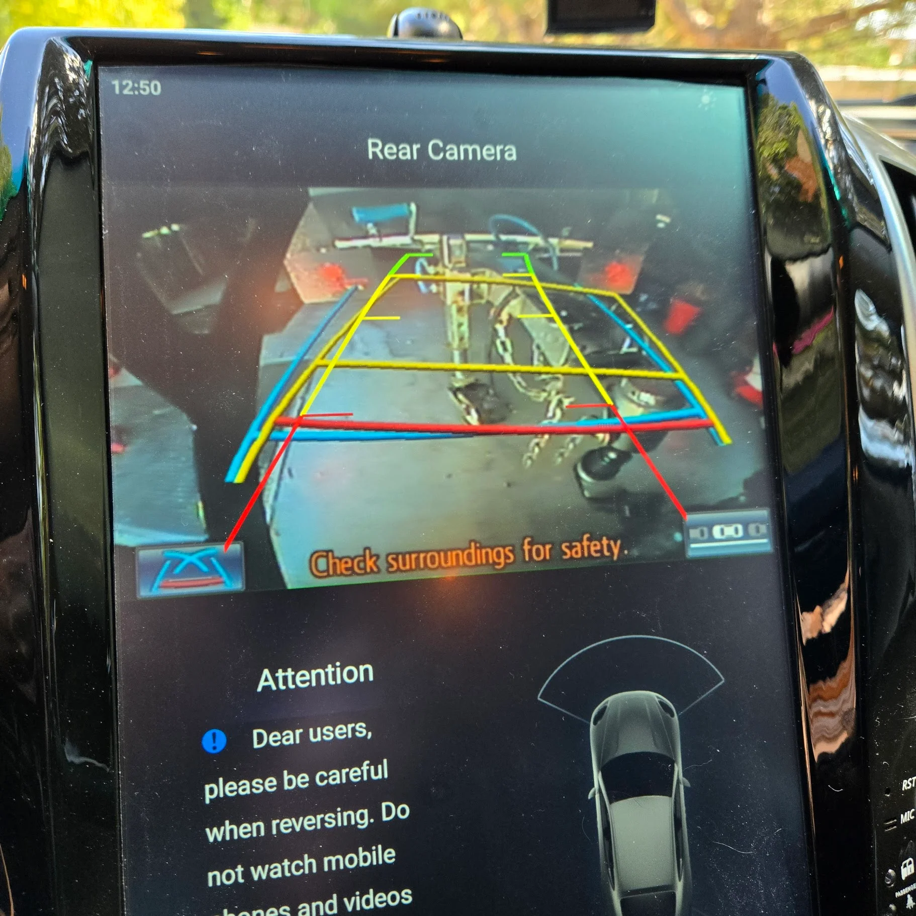

I also winterized the Camper today, so had an opportunity to really use the rear camera. The camera is the same, but the screen is better. You can tell the designers are from China as they start the caution with "Dear":rolleyes:
Note I have the anti glare matt screen protector on it which does remove some sharpness from the screen. The fact I havent washed the truck (dirty camera) also likely doesnt help the clarity

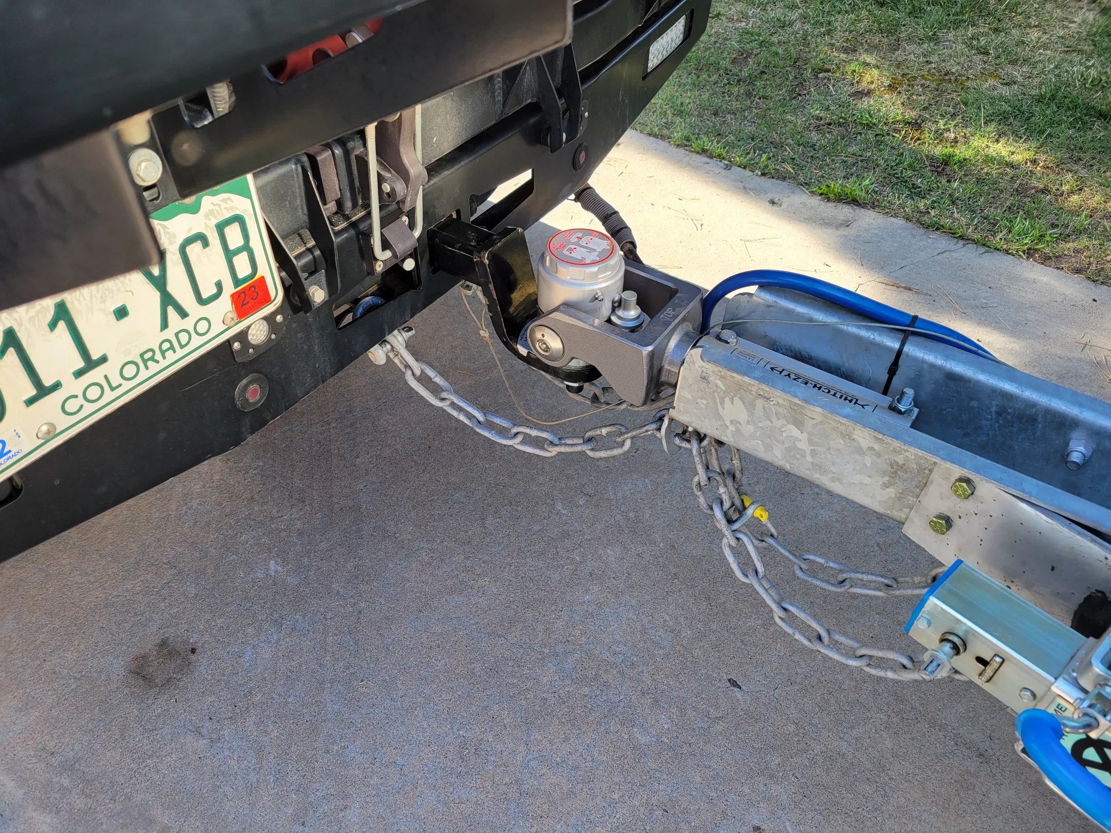

It worked well for me lining up my Hitch EZy hitch from my Kimberley Karavan to the truck. First an older picture showing the hitch set up and then using the camera from this morning
This is in a darkened Garage. Clarity is better outside. It was good enough for me to be able to line up perfectly using the camera

Before I posted you couldn't run Android Auto and other apps, that isn't correct. You can't split screen Android Auto with anything non Android Auto, but you can bring another app to the front. I switched to OBD program going over a MTN pass while Android Auto was running in the background. In all honesty, this is the same way Android Auto works in my 2024 Tacoma between Toyota Apps and Android Auto. You can't split screen anything there either.
I had zero issues this entire trip and really since I installed it. The only issue I have is with Chrome that I posted eralier. The factory said I could reinstall the firmware which would reset all my setting and that would fix it. The book marks dont work in Chrome, but it does work to type in a web address. Since Edge works perfectly fine as a Web Browser with bookmarks, I saw no need to reset it.
I did have the issue with the Passenger Airbag light, but was able to resolve that per my previous posts
OBD Fusion worked great going over the MTN passes
The above split screen was with Android Auto off
