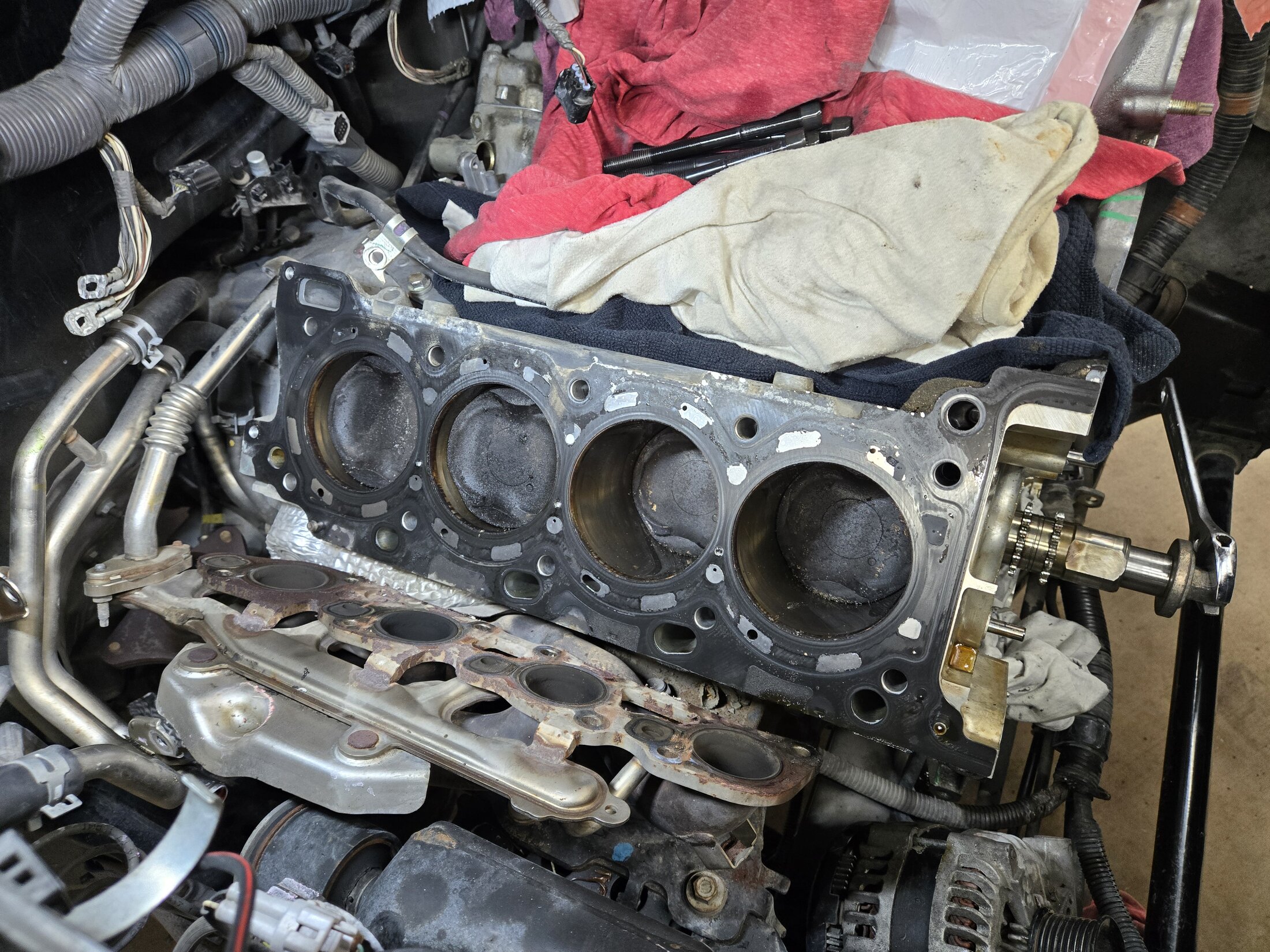

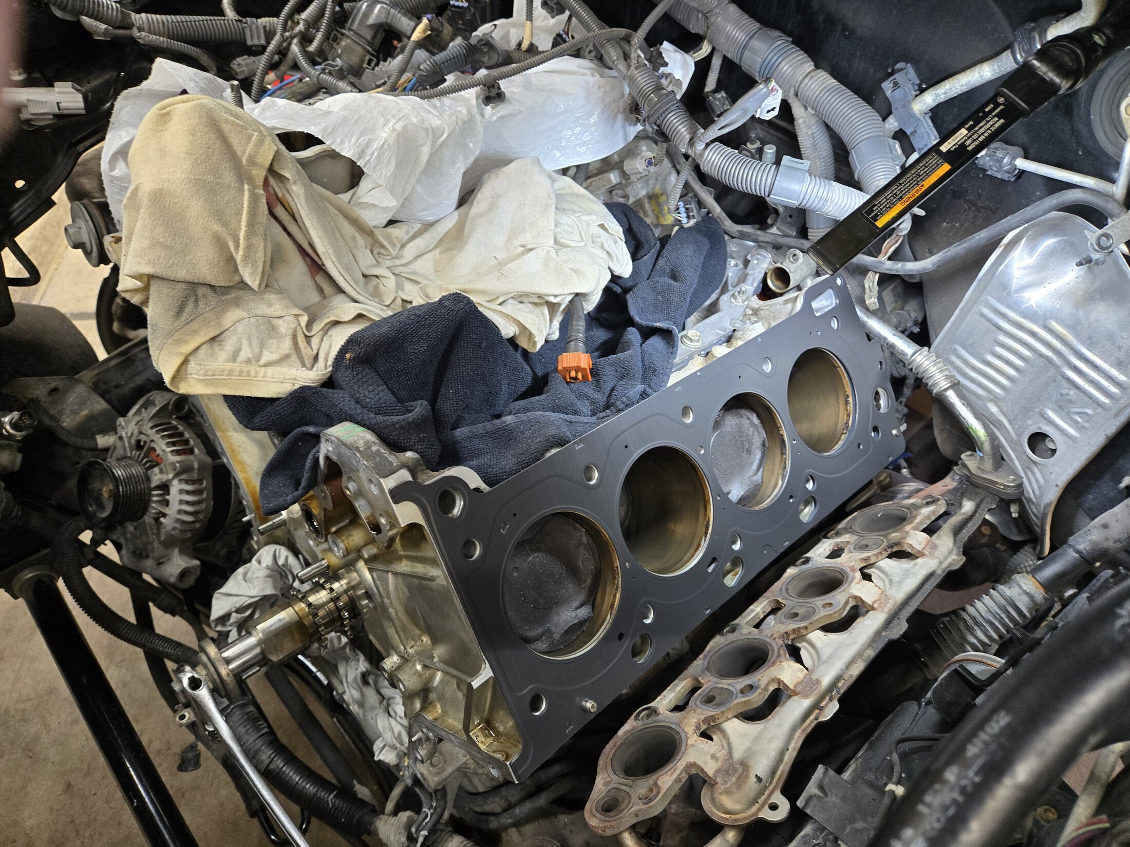

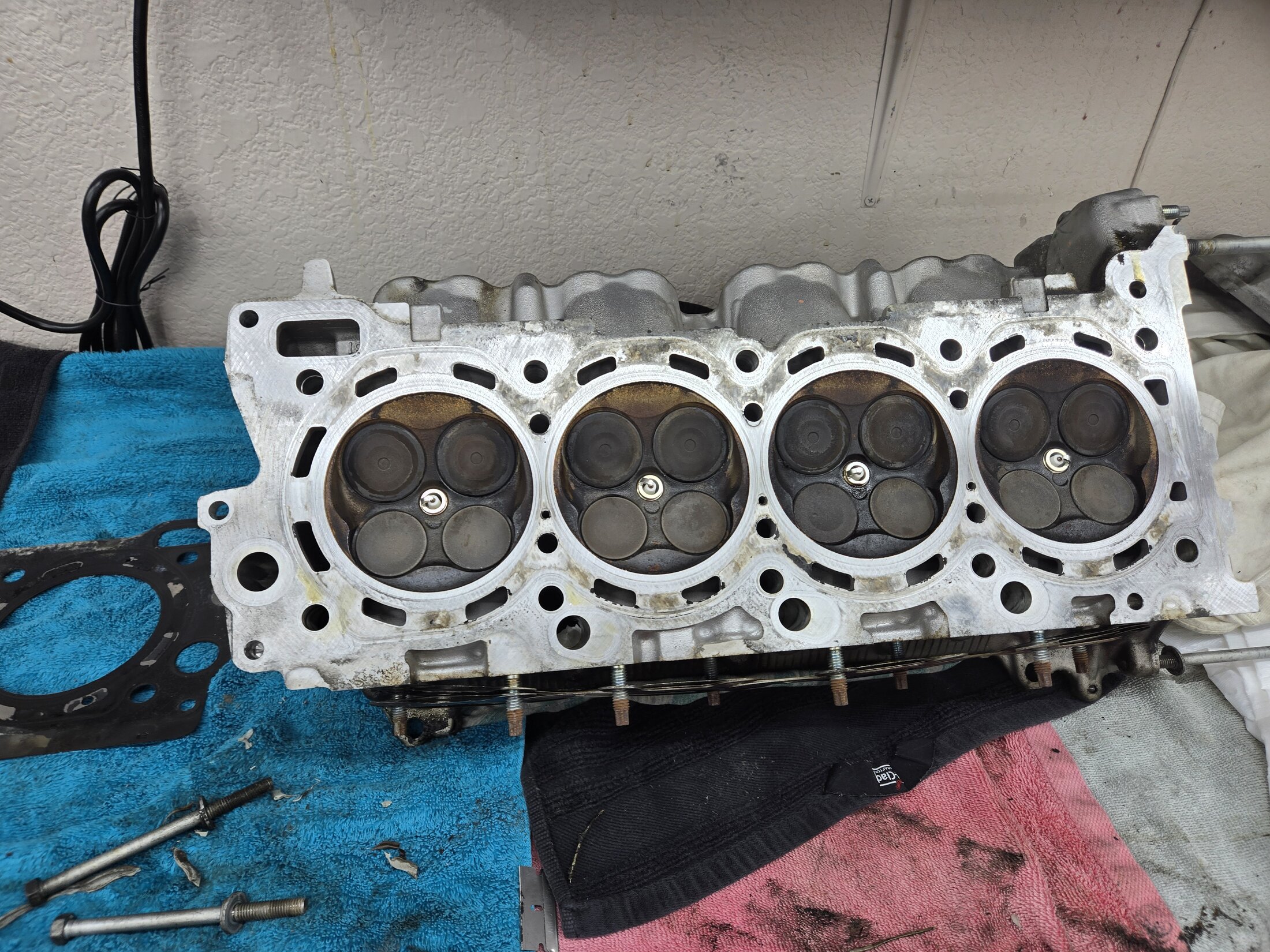

I don't know if y'all are as neurotic as me, but as a fellow "while you're in there" type of home mechanic I pulled the heads on my 2011 Sequoia so you don't have to. This vehicle has 220,000 miles and i just picked it up about 2 months ago. Unknown history. This is a vehicle I bought for a family member and want it to last another 10 years at least. It started with the valley plate reseal, then moved to pre-emptively fixing the timing tensioner issues these engines have. While I was in there I figured I'd reseal the cam towers. And while I was in there I figured I'd pull the heads for peace of mind, I mean I was 90% of the way there anyways right? To be clear there was nothing wrong with this truck besides a small leak from the valley plate and a weeping water pump.
I can make a new thread on this for those interested but what I found was some delamination of the head gasket coating around the suspect coolant ports but not bad at all. This easily would have held up fine for a long while I suspect. Passenger side was better than drivers side. Both heads perfectly flat, drivers side block surface actually did have a low spot near the suspect coolant port, but a .0015 feeler gauge would not fit. I could barely see light under the straight edge.
If you keep up on your coolant service and avoid overheating I wouldn't worry about this at all personally. I suspect overheating would cause this issue more than anything else. This is personal opinion but based on my research I no longer run Toyota SLLC pink coolant. It uses sebacic acid to make it last as long as it does, but sebacic acid is a plasticizer and not necessarily the best thing for coatings, plastics and rubbers. I personally prefer to change my coolant more often and use something with a shorter lifespan but safer on plastics and seals.
Enjoy some photos
Enjoy some photos

It never rattled, but I only had the truck for about 2 months and never started it up in the cold of the morning. The tensioner was heavily varnished on the drivers side and I'm glad I replaced it. Based on what I saw it looks like the drivers side where the tensioner is located gets very little splash oil which causes it to varnish and seize. The whole area around the tensioner had a lot of oil varnish while the rest of the motor including the cylinder heads looked almost brand new, so I know whoever had this truck did regular oil changes.
