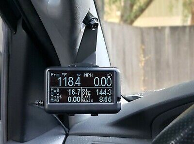

Having a scan gauge II (without alarm) or a large scan gauge III (with alarm) or a small ultragauge (with alarm capability, the one I may get for towing as well) could be a good thing to prevent a severe overheating event. Or a water gauge sensor and gauge with alarm like the one on Amazon, be it that is more modification of the factory setup then I think there is value in doing so.

I have no experience or done much research on them yet. For now I can see:
- Scangauge II - Small and compact, will fit on top of steering wheel column or in my 16+ area for the wireless charger (you would have to look down a lot, not ideal), however it has no audible alarm for any of the settings which would be good to have for coolant temps and for that matter transmission temps
- Scangauge III - All singing and dancing, but quite big, not really what I want for a vehicle my wife uses a lot as well
- Ultragauge MX1.4 - Is relative small and would fit on top of the driver side window vent dash area and has audible alarm capability. Not sure how easy it would be to setup on a 16+ US market 200. On the website I only see reference to 16+ 4.5 diesel versions. I do think it can be programmed with the PID stuff I also have on my OBD fusion app. The fact I am considering getting the ultragauge is primarily the audible alarm and keeping my phone free to run waze or google maps or spotify.
Beside the mounts offered on the ultragauge website this also looks like a good setup
Another reference to the ultragauge. I like the way it is mounted.
Anybody experience with the Ultragauge MX1.4 in a 16+ 200, I would love to hear.

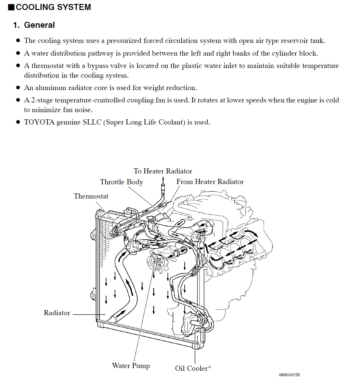

Where is water temp taken? If it’s after the radiator then you don’t really know if something is wrong until the radiator can’t keep up
I think I will go the ultragauge route so real time temp data is tracked from the existing 3UR-FE coolant temp sensor.
In case of installing this water temp gauge with little spool and sensor, I agree that is better in the hose from the engine to the radiator than on the return. Per 3UR-FE info below, that would be the upper hose on the driver side (LHD models).
Further snippet showing the same. During initial warm up until the thermostat opens at 170 to 180 degr F you would not be seeing the right temperature with the separate coolant temperature gauge.

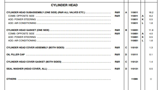

Looks like it's 16 hours for the head gaskets. If you R&R the valves it's 24 hours by the FSM. Other stuff like valve cover gaskets should be part of the 16 hours as those have to come off anyway.
I'm not surprised in the amount of labor though. Just doing the timing chain cover (gasket) is 6.6 hours by the book, and I think the valley plate was also like 10 hours by the book.

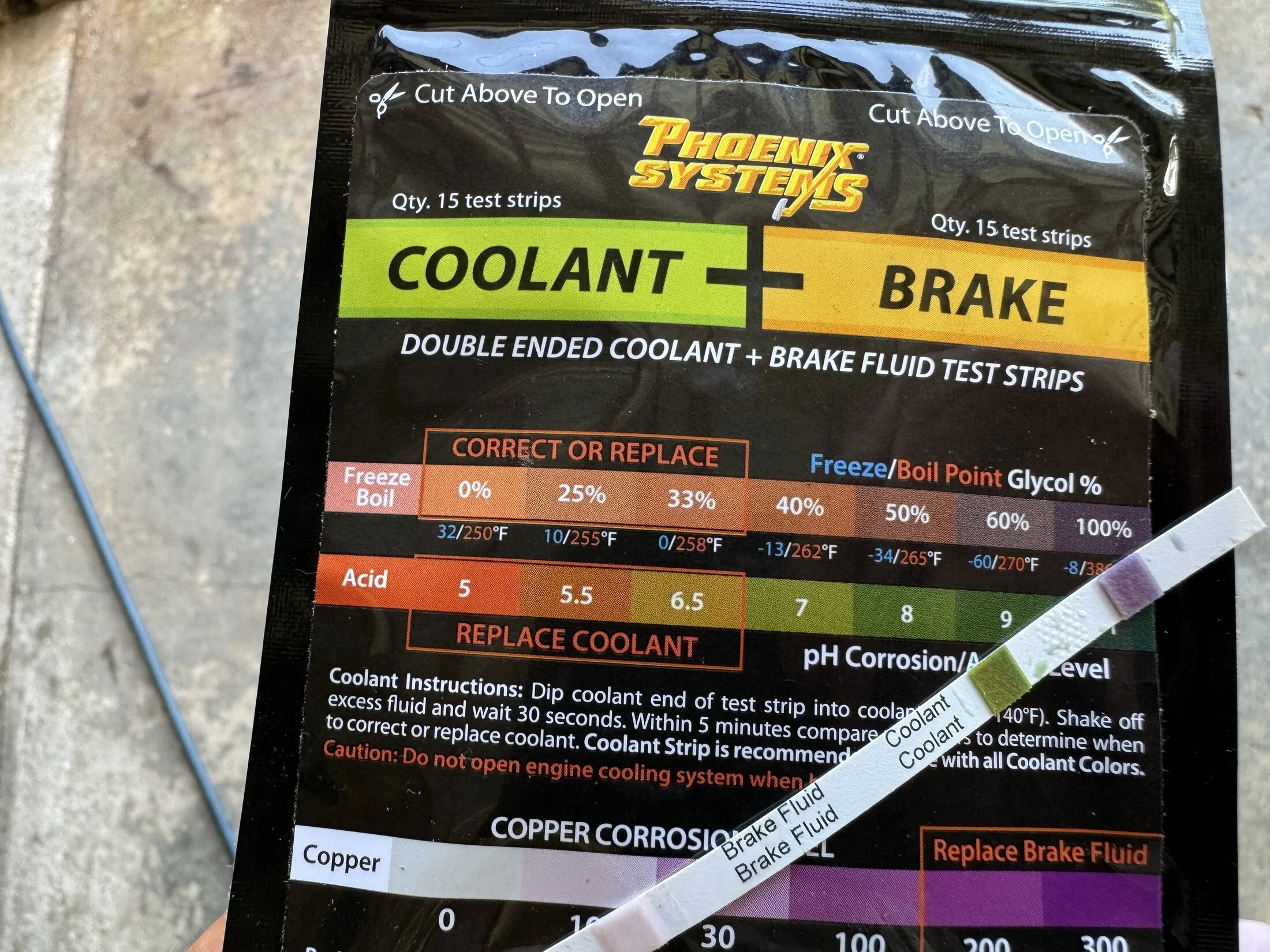

Due to images not looking true to life, I angled the strip to the actual corresponding colors. Dipped the brake fluid side as well.

If all results are using the same test strips (they appear to be very close in appearance), they could read falsely alkaline. I don’t know much about how a coolant would become more alkaline over time. But think the simplest explanation is test strips reading falsely high vs the SLLC being consistently too alkaline.
