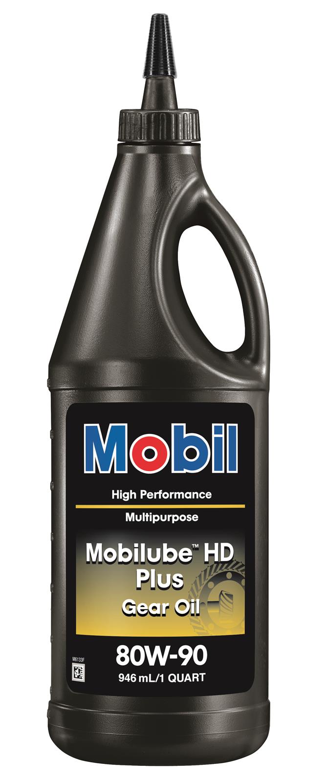

Hell yeah man. Can’t go wrong there at $15. I’ve never gone to Summit for good deals as they haven’t really competed in price for anything I’ve bought before. Picked up gallons of this stuff for my 100k flush and it got me looking at prices of other stuff and they are definitely on the list to check on for anything else.
this is a great deal also. Not sure if LCs require a friction modifier, but could be used with confidence as a top off or with limited slip additive. Do you know if LCs need a limited slip?
I use this for the gear drive on my excavator, and in my 1986 M1008 truck
