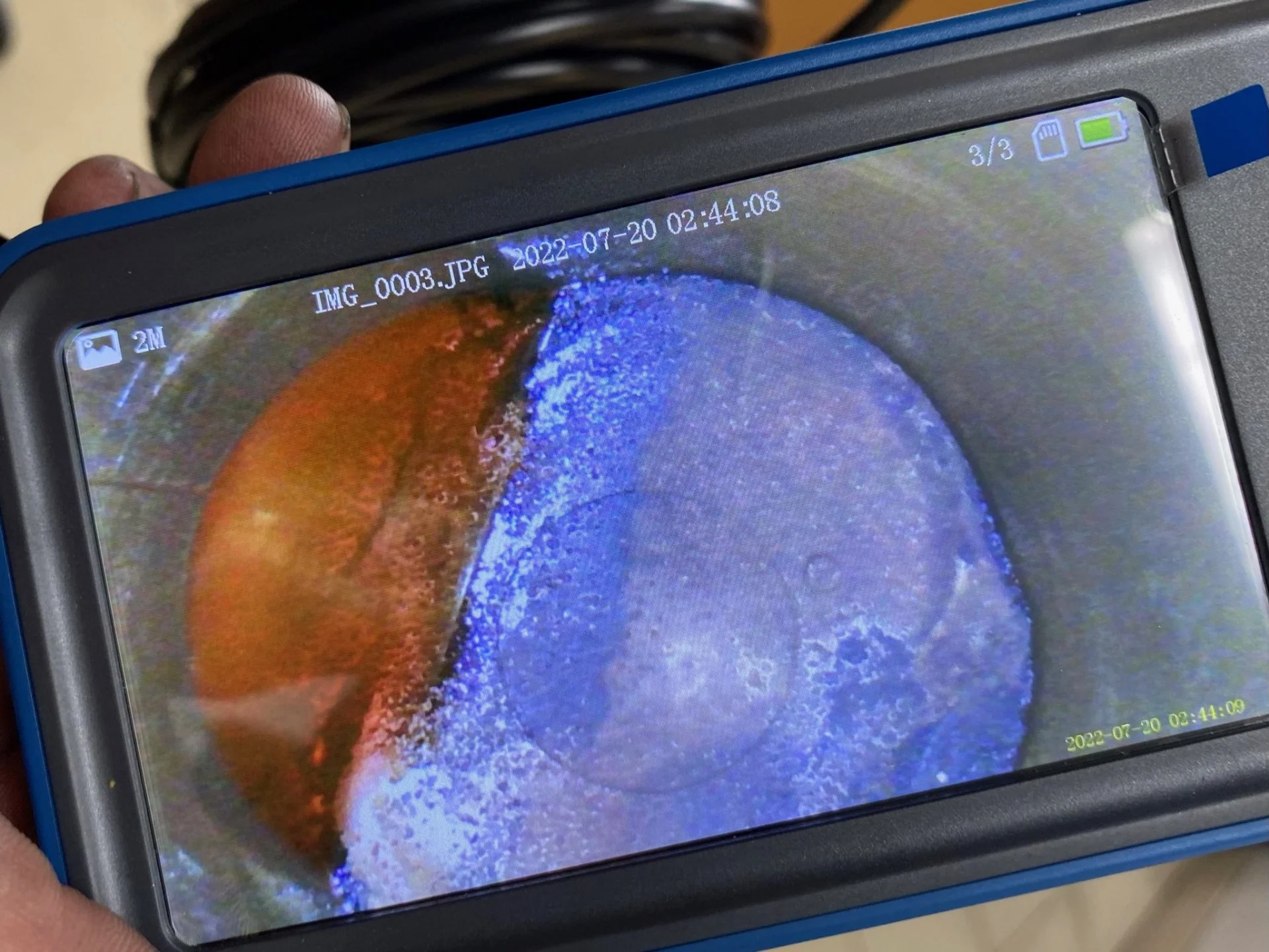

I spoke with the warranty company adjuster today. They are sending an inspector out to confirm the dealer's diagnosis. I am attaching an image from the borescope here:
Bummer, that sure looks like coolant sitting on top of the piston to me. While these types of failures are really rare, most part failures follow a normal bell curve, and the tails are out there somewhere. And for every well maintained truck that has an early failure (not that 125k for most vehicles is all that early), there always seems to be one that has poor maintenance and lasts forever. Not that that helps if you're the unexplained "early" failure. I hope the warranty company takes care of you.
