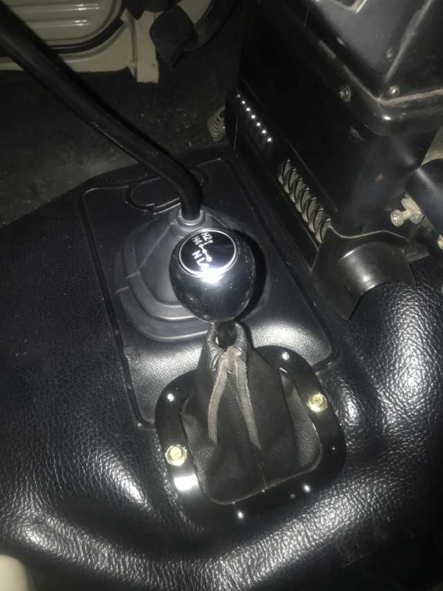

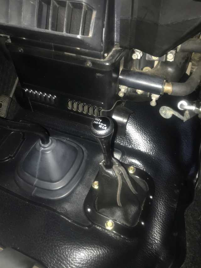

T-case shift knob, 1975
^ … and @63FST can (maybe) get you the H2-H4-N-L4 shift pattern sticker to put on it
Yea, what are you doing with that shift knob?
I’ve been using them on 40’s and 60’s since 1982 and have never had a shift knob failure! Others probably longer?
This could be the first time it has ever been mentioned!
What a strange run of crummy ones I've had then. Makes me wonder if they are genuine oem or only packaged as such. Yes, 3 of em wrecked in 3 or 4 years. My '76 didn't come with one either. I'll definitely loc-tite my next one.
