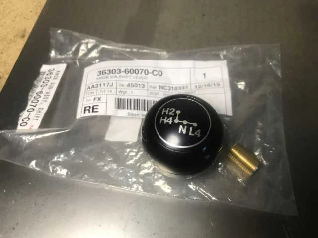

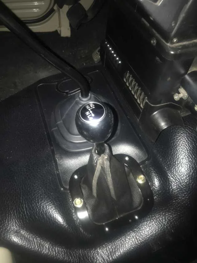

A few months ago I read a post on here about changing out the original FJ40's transfer case's shift knob for an FJ60 model. I liked the idea, so purchased the FJ60 knob. But the knob doesn't fit directly onto the FJ40's lever, so I had to purchase a brass shift knob reducer/adapter, M12X1.25 OD M8X1.25 ID.

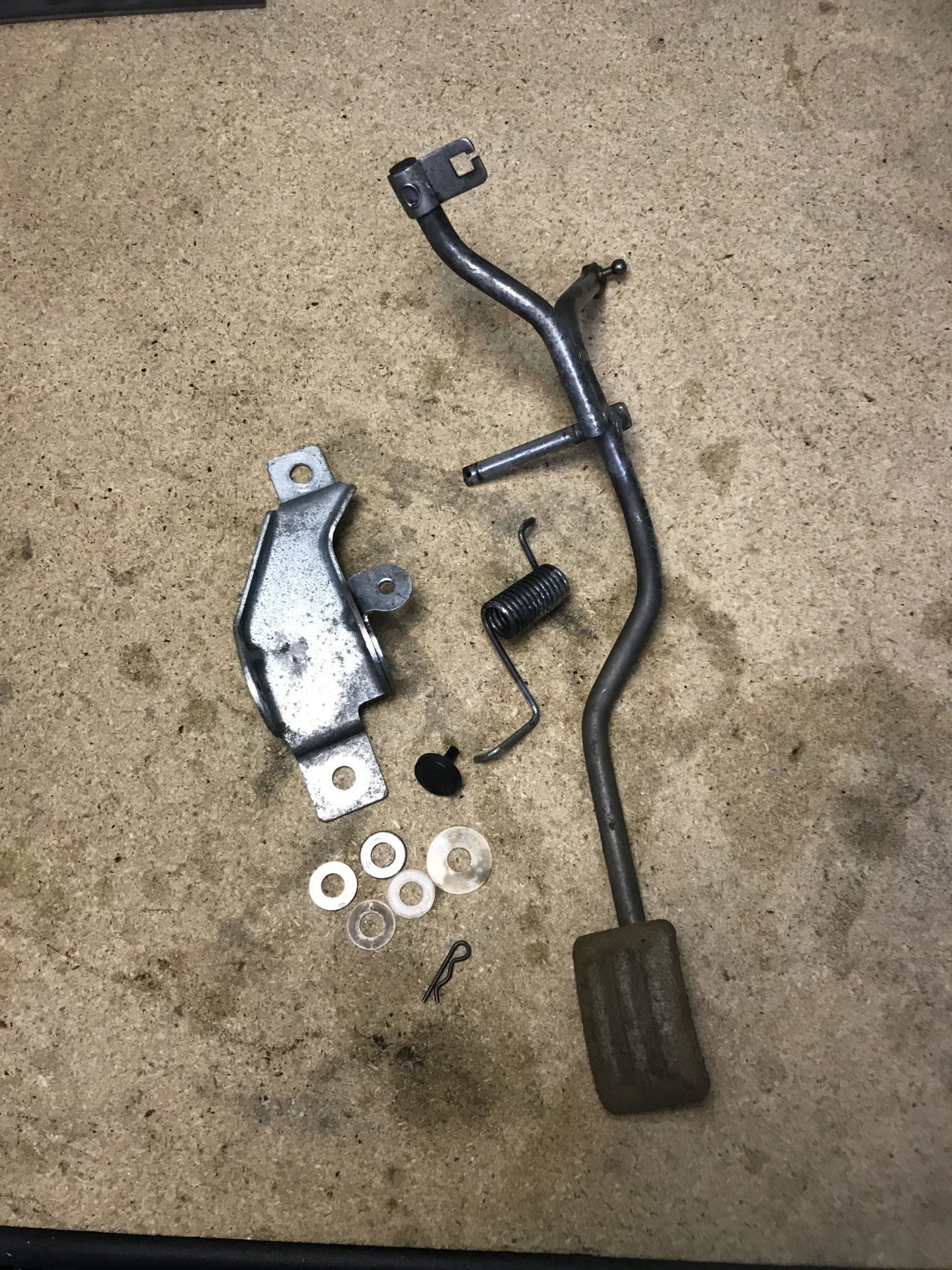

Took 1/2 day off to mess around with my 40. The plastic accelerator torque rod bushing gave itself up many moons ago, but I didn’t figure it out till a few days ago. So, MUD to the rescue. Found a post where someone mentioned the door hinge bushings are the same size. Just my luck, I have a few of the brass ones from @SouthBostonFJ40 ....with a little dremel work, the linkage works mo better now.
What a coincidence! I just dropped that link into my bucket of carb cleaner today to clean it up. Now I know there's supposed to be a bushing on it - thanks!

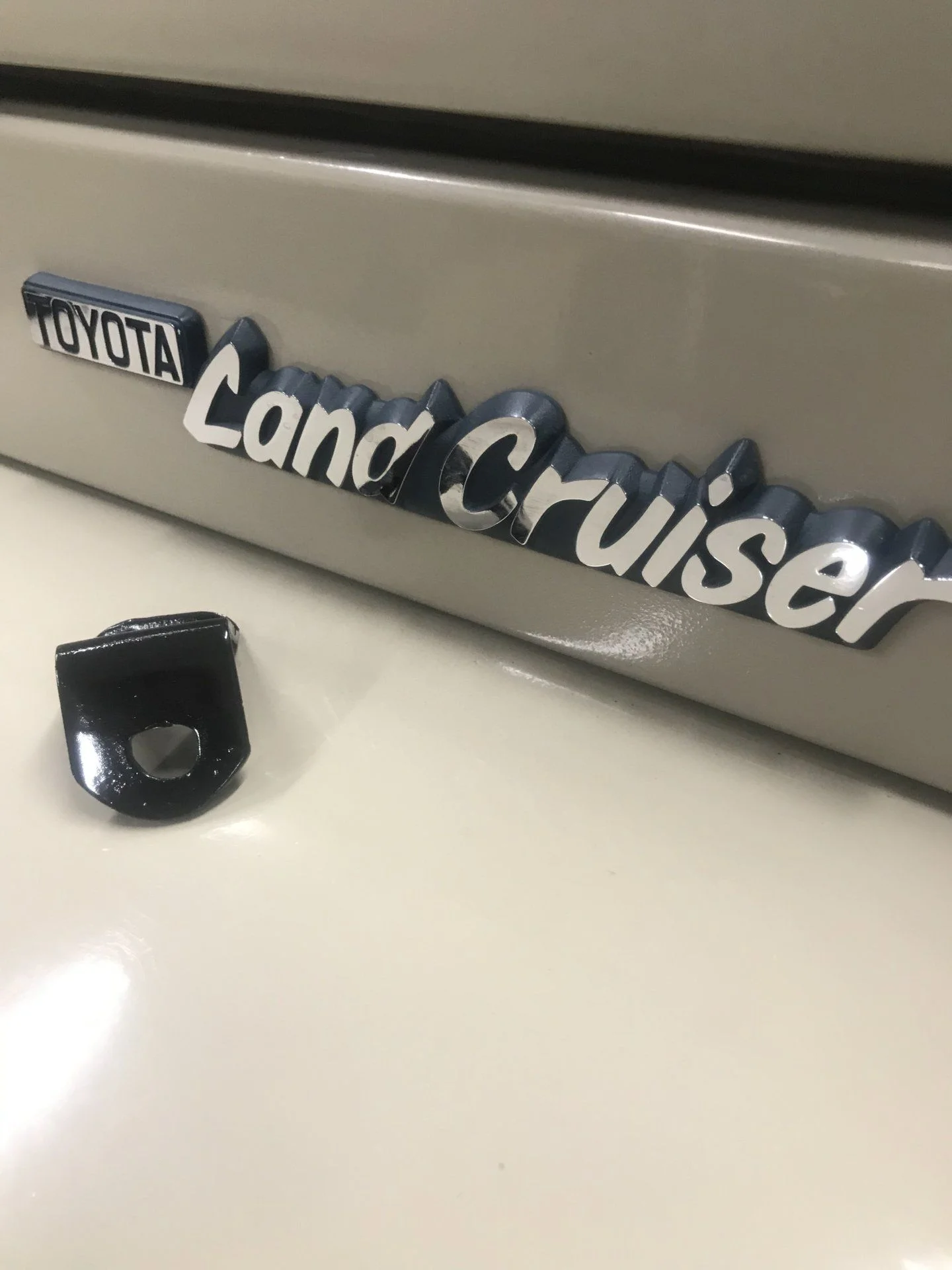

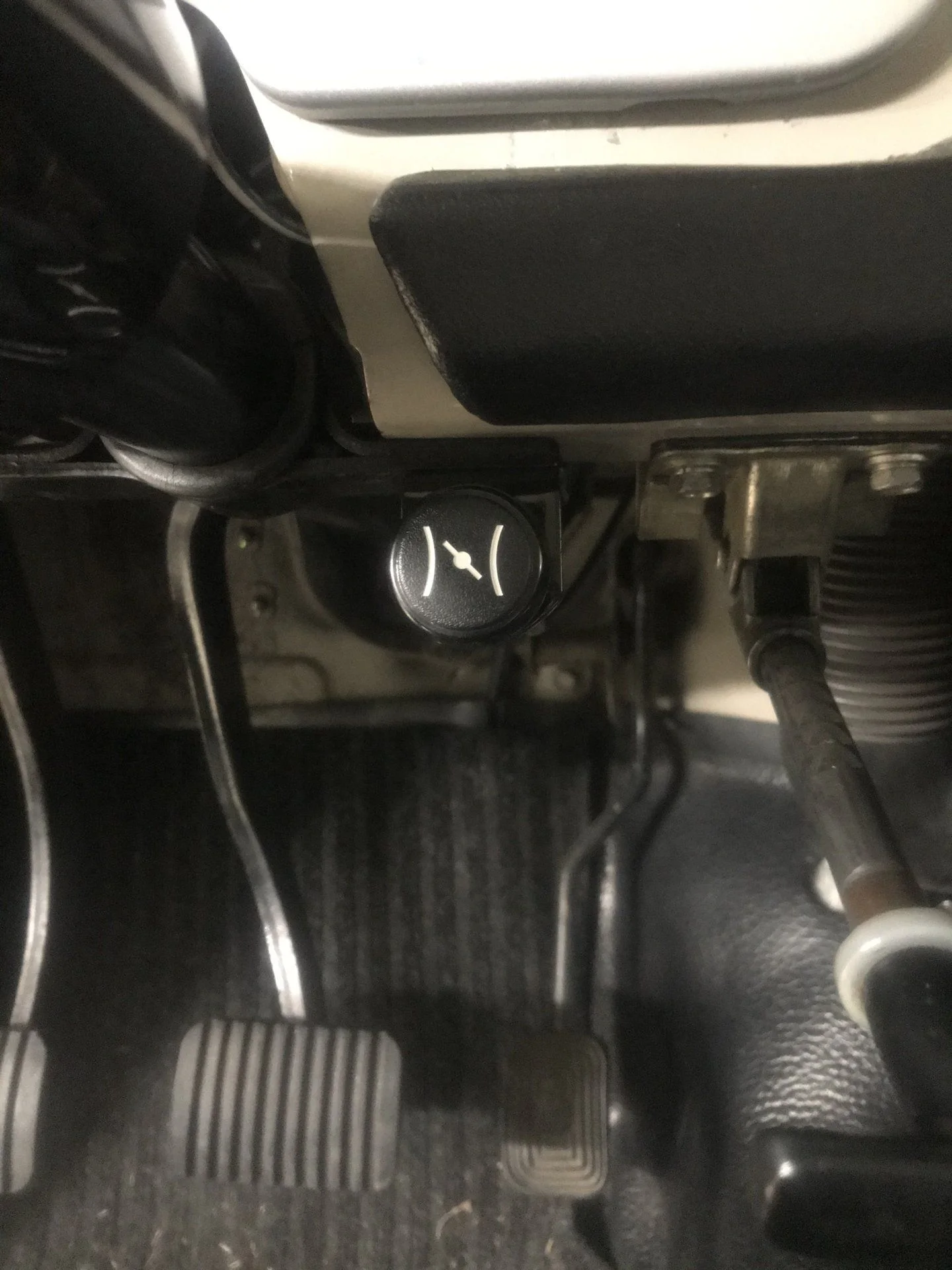

If you don't have one already, I'd recommend installing the hand throttle to go along with the accelerator pedal you have there.
Thanks, I'll take your recommendation....got the bracket already installed. :hillbilly:
Just waiting for a friend to send me the firewall bracket so I can make my own. :grinpimp:

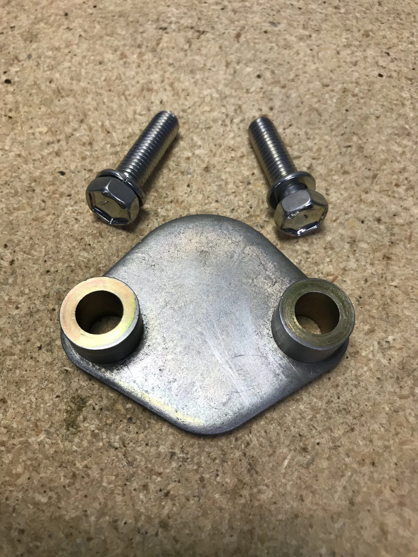

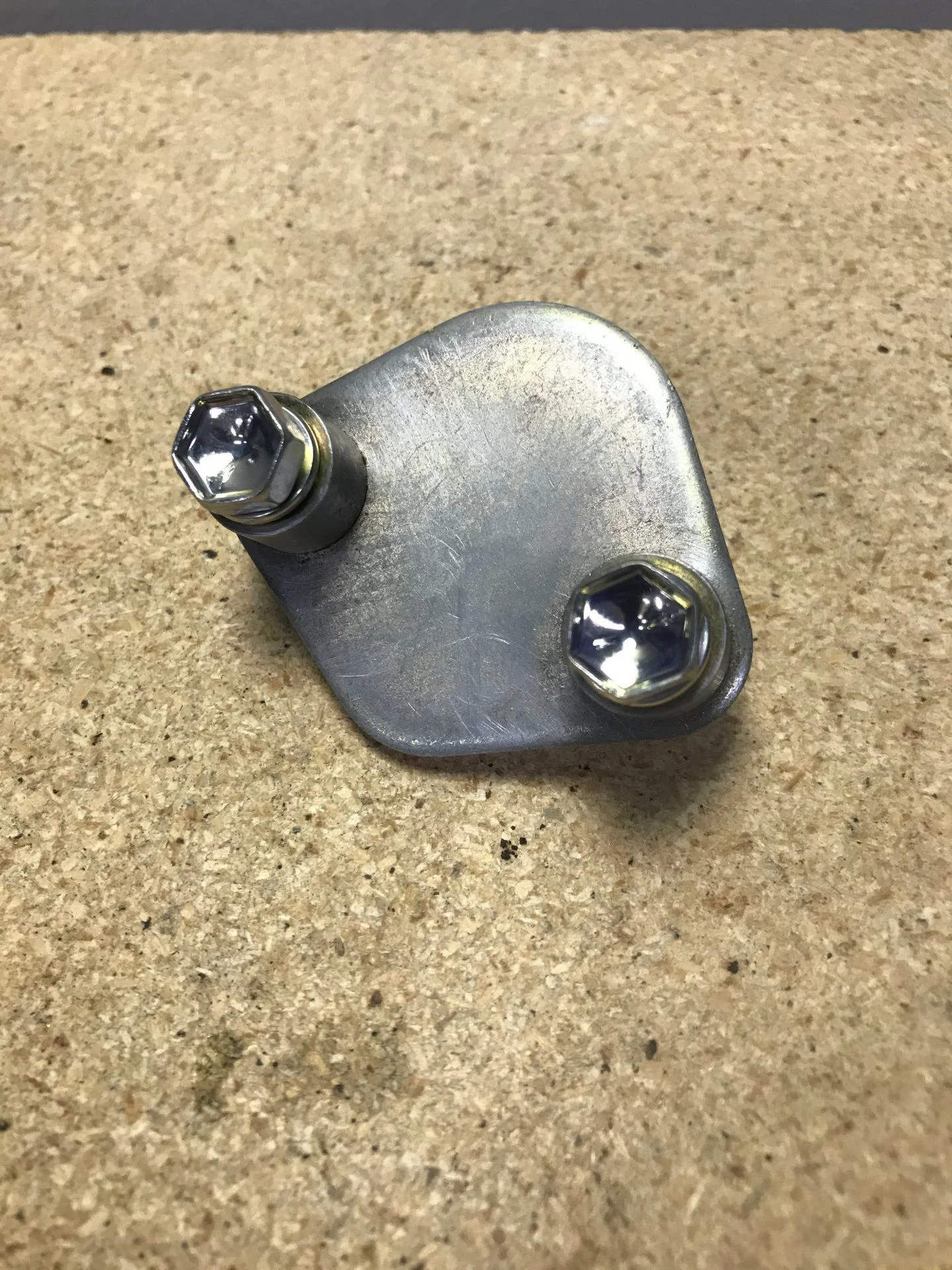

Where did you source the fuel pump block-off plate?
I stumbled across this Toyota block-off plate by accident. It is actually a 3FE's block off plate, from an FJ62. The shoulders on the block-off plate means I can reuse the OEM bolts.
