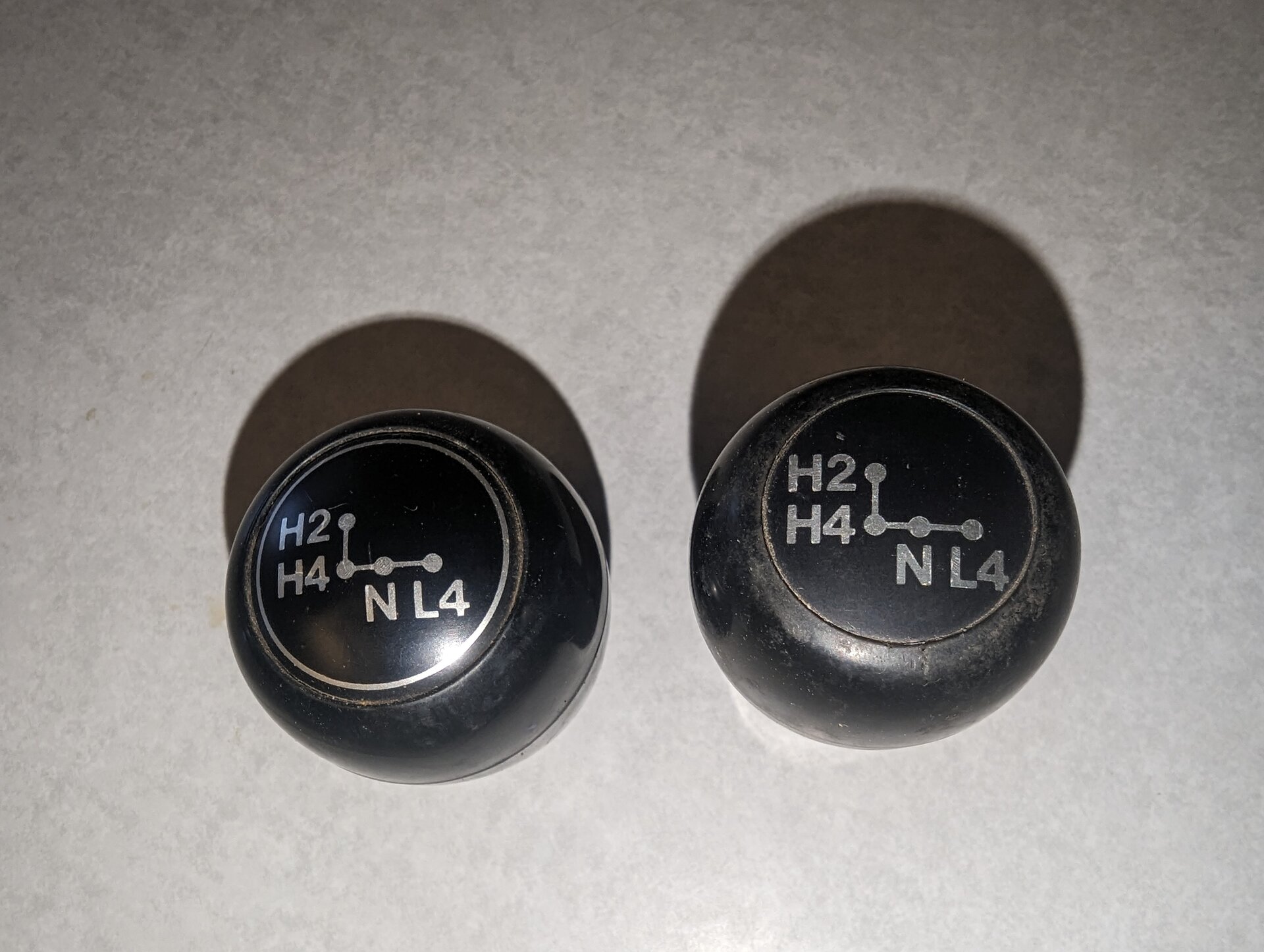

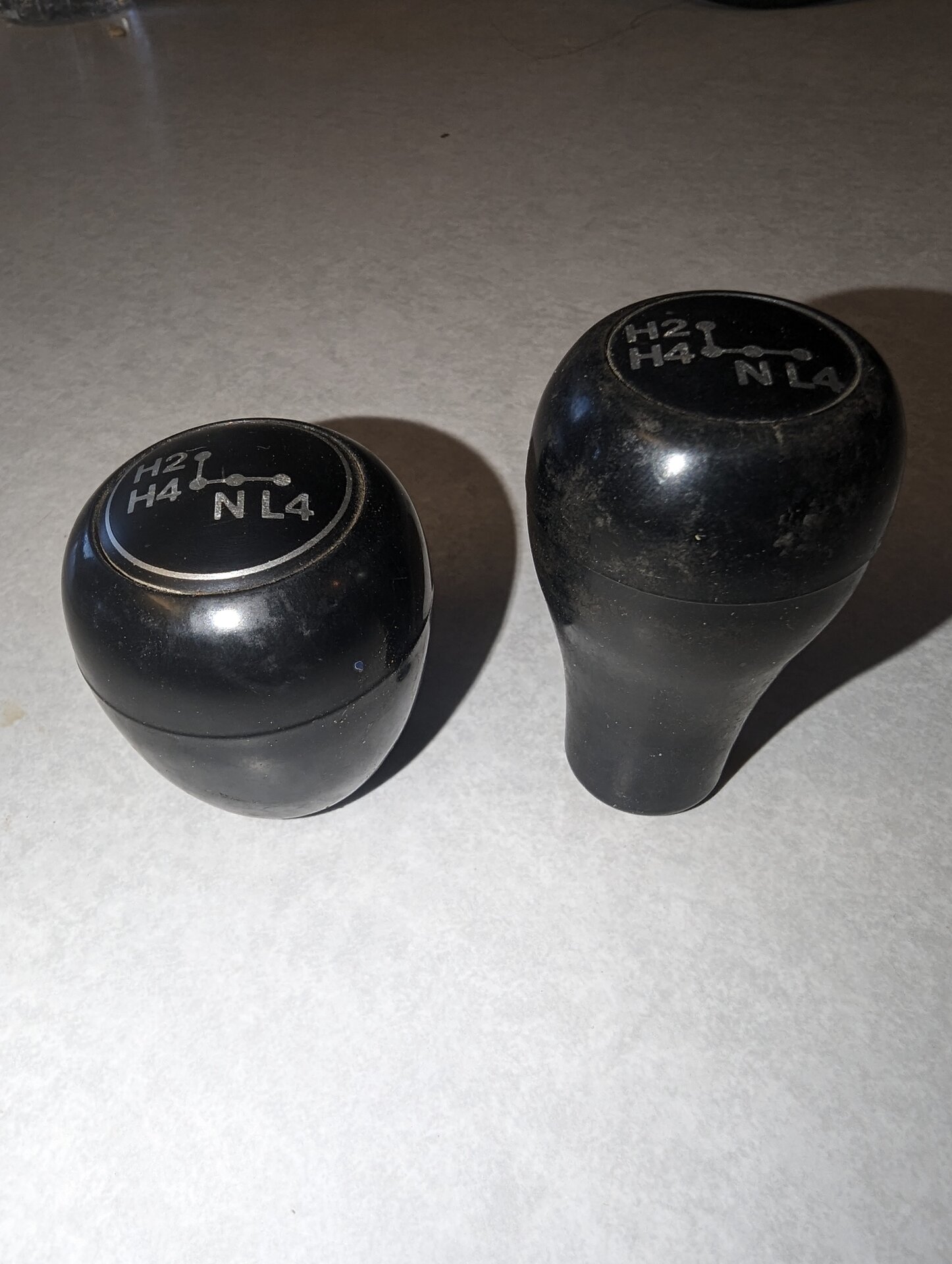

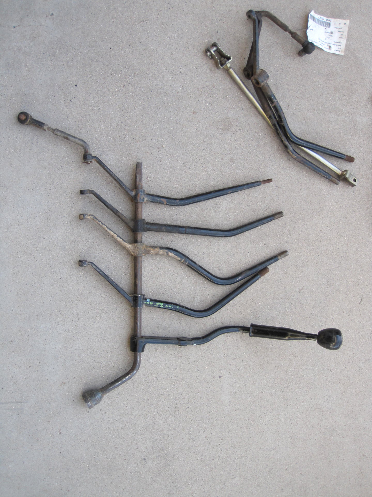

Curious how hard is your transfer to shift? Not a common problem. 8/80 the 40 series and new 60 series used a larger thread for the transfer case shifter. Possible a nutsert with the two different threads could be used. Lock tight the smaller inner thread and just tighten the knob. Depending on the month in 75 may just be able to use a 40 series 8/80+ four speed shift lever.
Top two on the lug wrench the two different types.
8/80 and later 40 series and 60 series.

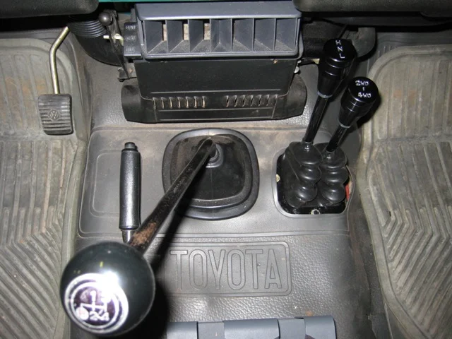

Maybe more money than you want to spend, but you could convert to twin sticks for the transfer case. More direct/positive-feeling linkage, the ability to use 2WD low-range, and heavy-duty aluminum knobs that are not going to crack or split.

Thankyou! Nutserts have been my friend on the 40. I'll check that out! A larger knob would maybe be nice too. As for difficulty of shifting to 4L, it seems easier than my 76 was and about average for the few other rigs I've played with.

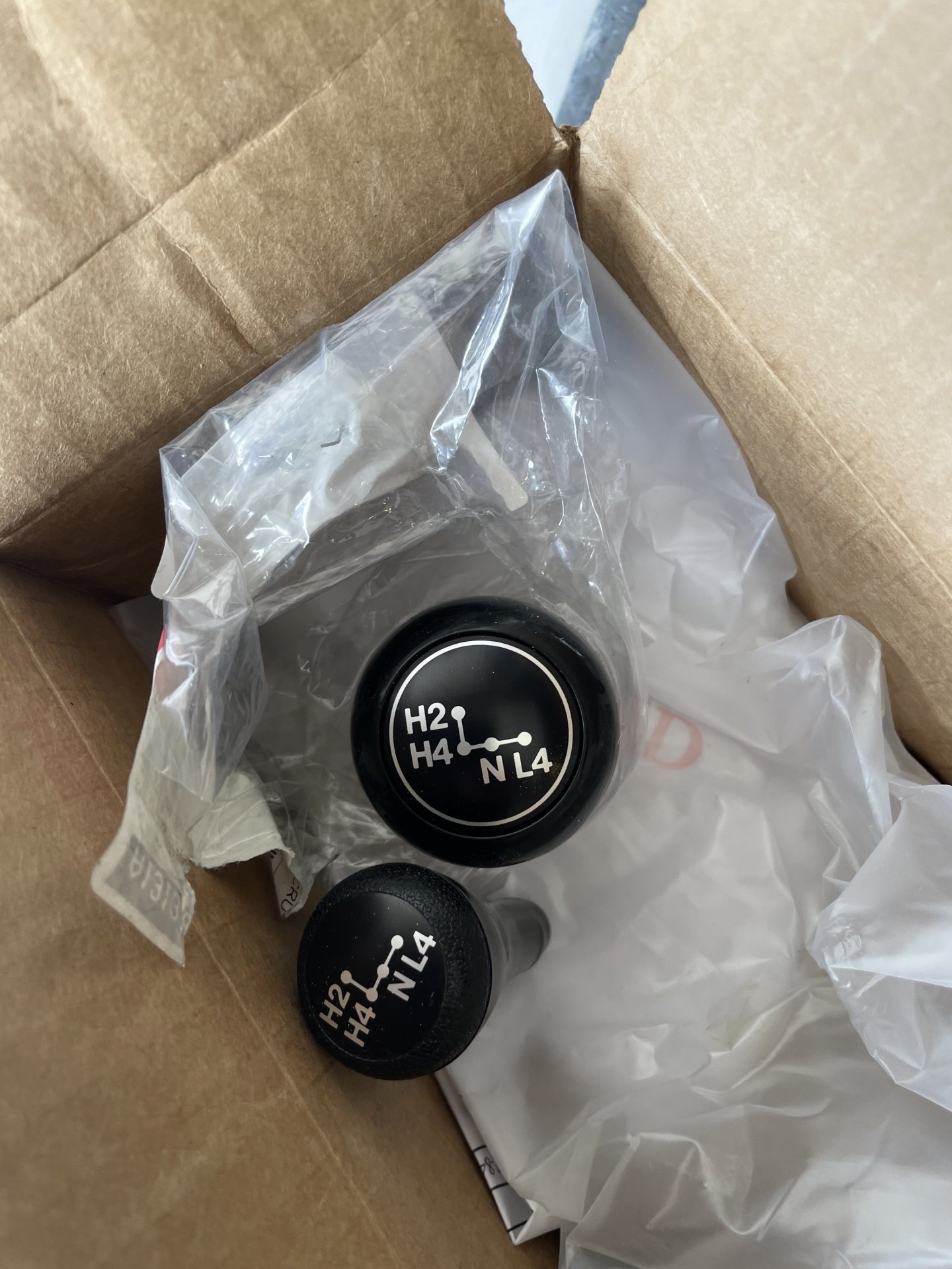

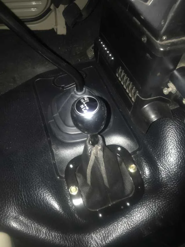

Went from this OEM FJ40 knob:
To this FJ60 knob using a shift knob reducer/adapter:
