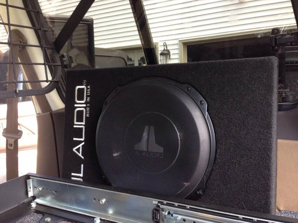

I built a removable box in my Drawer Build that has a 10" in it with a piece of expanded metal for the top to protect woofer.

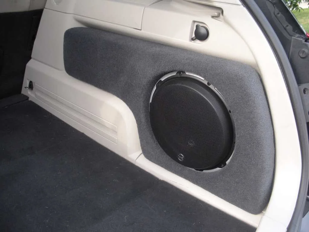

Here is what I did, I am pretty pleased with it, but I think I will just use a box next time.
As for my box taking up space, of course it does, can't change that. But I have the box tucked up against the back of the front seat (the back is angled the same way as the seat, and the second row seat is removed). It sits above a small box in the foot-well area, hinged at the front so I can tip it forward and store stuff underneath. Essentially serving as the lid on the box. So at least it's in a place that's not the best storage space.

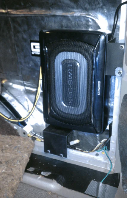

OP - below is a pic of my install of the powered Kenwood sub I've got. Again, it generally sounds great and makes a huge improvement although is obviously at times (certain music) a "small" and somewhat punchy sub. All things considered, I love the installation and fact that it is tucked away without compromising any storage or seating (one of your objectives).
