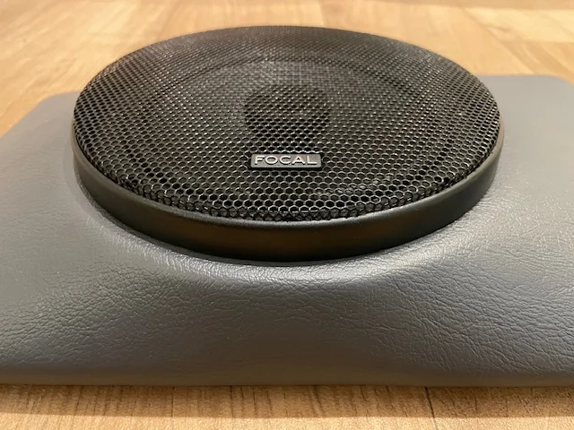

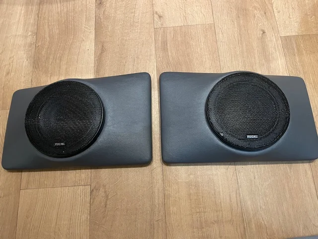

I'll be installing these bad boys tomorrow. Got them from our brothers down under at StealthtechMildura - https://shop.stealthtech.com.au/. Speakers are Focal Auditor ACX 165 S.
They are for the rear doors.

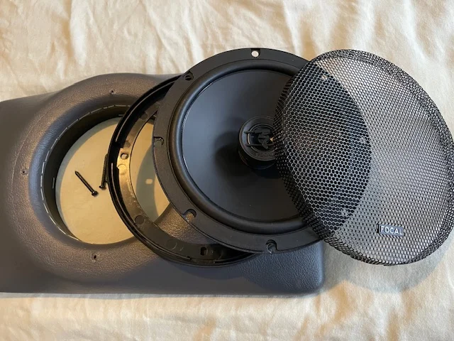

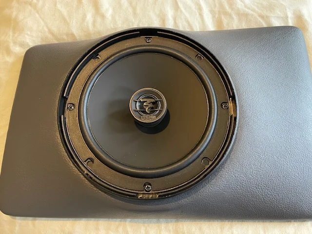

As for the Focal speakers, the backing plate (or base plate) are attached to the speaker grills for shipping and must be separated. The speakers come with 8 self-tapping screws. I placed the backing plate on the speaker pod to use it as a template, marked the 4 holes with a marker, and drilled small pilot holes. It was strange to drill into fresh vinyl, but it is necessary. After that, it was just a matter of lining up the speakers and securing them into the backing plate and onto the speaker pods.

FYI, The speaker pods are designed to fit 6.5" speakers.
My speaker dimensions (from manufacturer) are:
Mounting plate: 6.5" (167mm)
Speaker diameter (sound producing area--minus the mounting area): 5.7" (145mm)
Speaker depth: 1.9" (48.5mm)

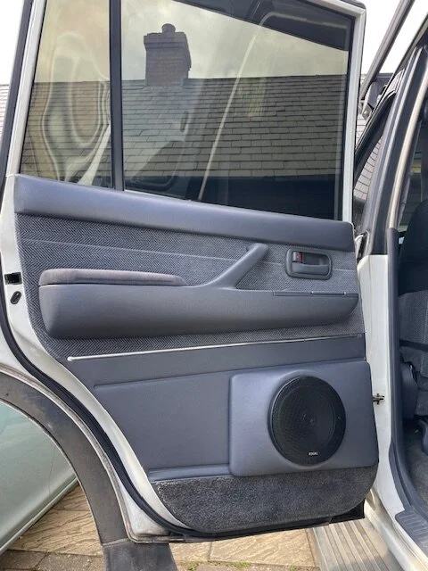

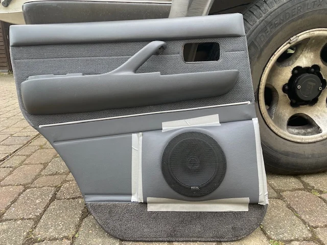

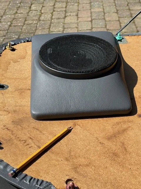

Here's how I installed the speaker pods:

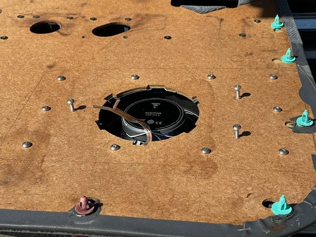

1) I used the opposite speaker pods as a template and traced it on the back of the door cards.
2) I taped the appropriate speaker pod into position. When positioning the speaker pod, make sure you leave enough space at the leading edge so you can close the door. Mine was flush up against the plastic trim that covers the front seat belts.
3) I used a total of 13 screws per speaker pod. Probably overkill. The 3 center screws are 4.8mm x 19mm. The 10 outer screws are 4.8mm x 13mm.

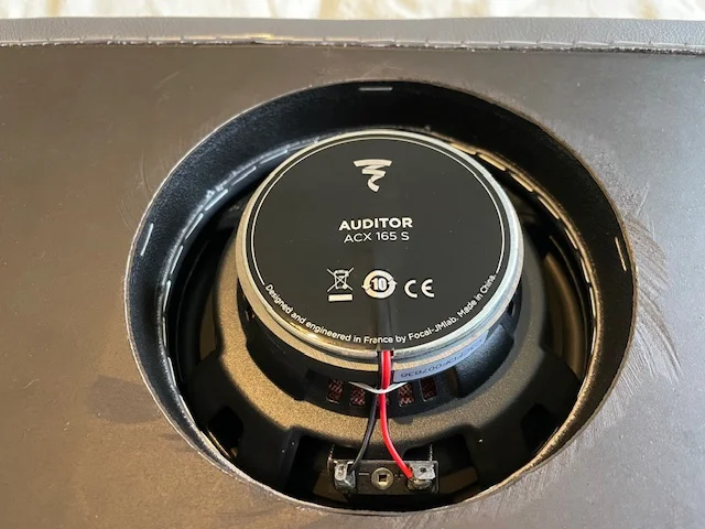

4) Installed. Speaker wire were soldered to the speakers and I used the Wago 221-2411 inline connectors to connect them to the car for easy removal of the door card if needed. FYI, from the car, the blue wire is positive and the gray wire is negative.
The sound from the speakers are a notable improvement over the 4.5" Pioneers I had back there. I feel that the upgrade was worth it. Hope this helps.
