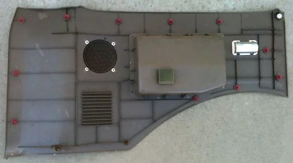

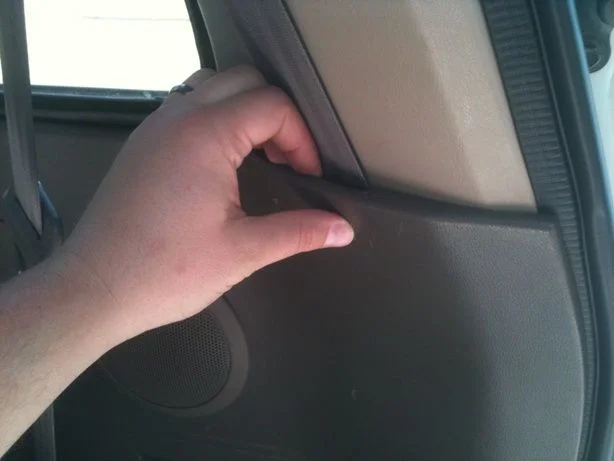

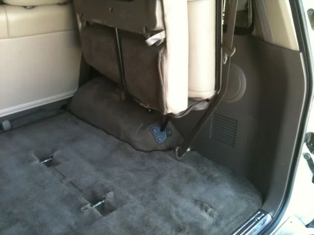

We started by removing the factory trim panel on the passenger rear corner. This is held in place by 14 clips on the backside of the panel.
Be careful with the bottom tab that mounts under the trim plate at the tailgate. Once the clips are snapped out of position, simply rotate the panel away to remove.

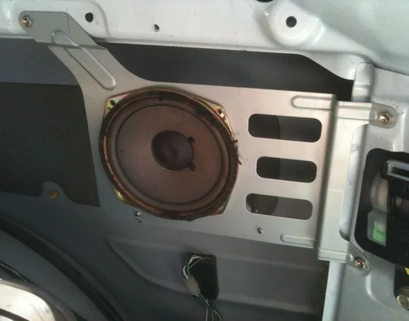

The factory sub woofer and amplifier are mounted as shown below. Take the factory mounting bracket off after disconnecting the electrical connectors. If your original sub woofer is as worn as ours, it might have already been disconnected to stop the hiss of a torn paper cone...
Save the bolts if you'd like to reuse them (takes a 10mm socket). If you forget, Whole Hog Technologies supplies a set of new mounting hardware if you'd prefer new steel in here.

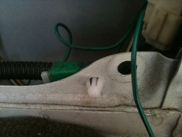

There was a plastic clip to secure the factory loom on our 80-series as shown in the picture. Just pinch the plastic and this clip will release. This clip needs to be removed from the hole to make room for the amplifier mounting tab. (We will discuss this clip again later in this post)
We test fit the panel before mounting our new electronics just to see how things lined up. As you can see below, everything lines up great with the factory body holes.

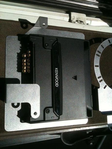

We used a Kenwood KAC-8405 amplifier in this install. This is a 4-channel amplifier with a footprint of 11 inches x 9-1/2 inches. On the electrical side, we did a bridged setup to only run the sub woofer. Our head unit handles the door speakers just fine by itself. Position the amplifier and mount it as you see fit. We used the mounting hardware supplied with the amplifier from Kenwood.
The amplifier mounting plate allows for two major footprint sizes; 12 inches x 11-1/2 inches for a vertical mount or 13-1/2 inches x 8 inches for a horizontal mount. As a technical reference, we have identified amplifiers that fit this footprint (mono amps, 2-channel amps, 4-channel amps and 5-channel amps) on the Whole Hog web site. You can find the amplifier technical information at www.wholehogtech.com

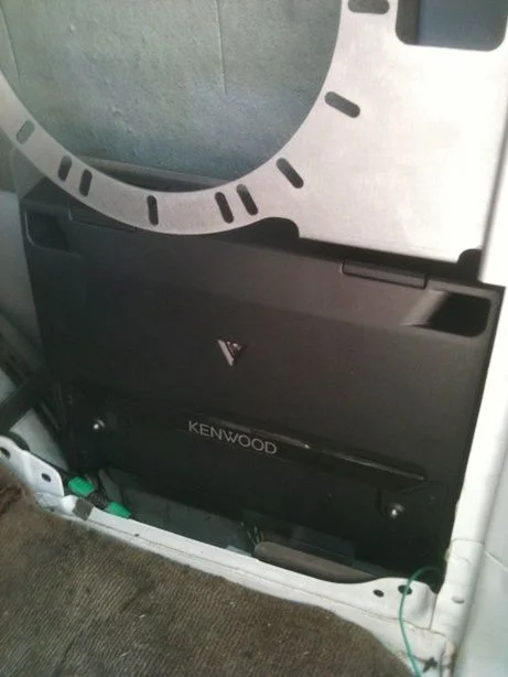

After we secured the amplifier to the mounting plate, we again did a test fit to plan ahead for wiring. On the Whole Hog web site we discuss that the wiring and amplifier adjustments may not be accessible after the plate is secured, so keep that in mind during the install.

During our installation, we ran audio cables down the passenger door sills and the positive power cable along the driver door sills to prevent potential interference problems. There are several good grounding points at the passenger rear corner of the vehicle (make sure you don't try to use one of the isolated bolts for the factory rear bumper though...)
