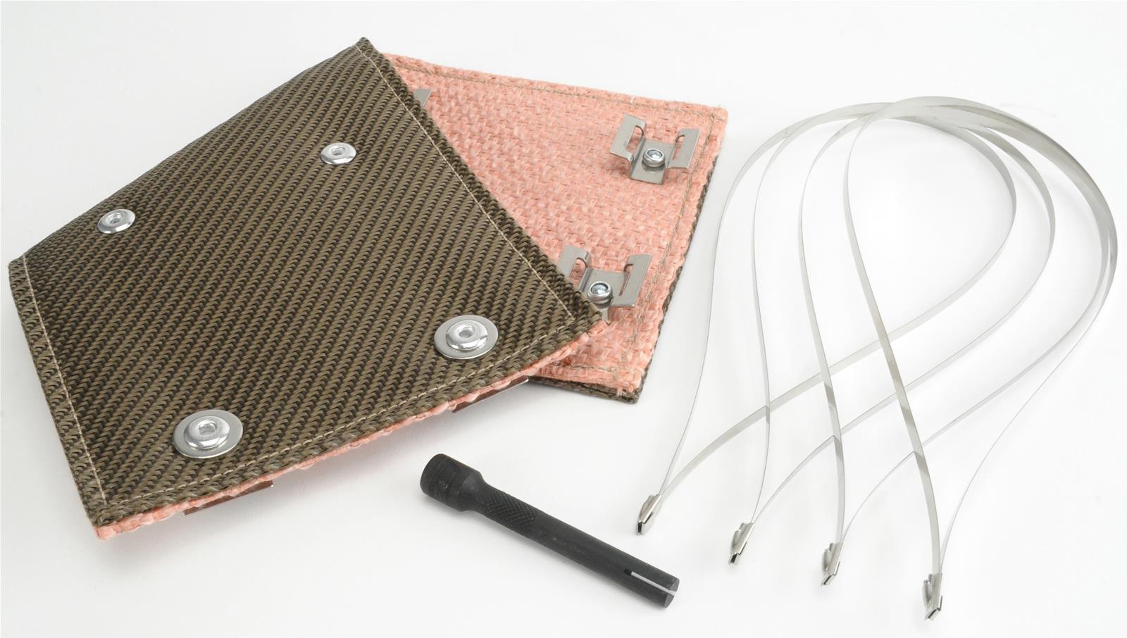

Even with five coats of lizard skin ceramic heat shield and DEI under floor heat shield, the floor temperature inside the Land Cruiser got up to 150°F plus last week while driving to work in about 85°F ambient temperature temperature. I’m trying this catalytic converter heat shell from DEI to see if that helps reduce the heat. We will see how this works and I am open to additional suggestions.
I will say that I just drove it for 3 hours and the floor temp never rose above 110°F, so we are making progress. I have some exhaust wrap coming. I’m not a huge fan of wrapping the pipe but I don’t really care if it drops the temps further.

Thanks for doing this. I am interested to see what you find out. I have a cat under my floor and the whole pipe in front of the cat is turning blue. I am thinking that might be the problem. 110°F is so much better than 150°F but it is still pretty warm in there. I should also add that these temps are with the A/C cranked all the way up. This thing has never been this hot before with any engine or exhaust.
