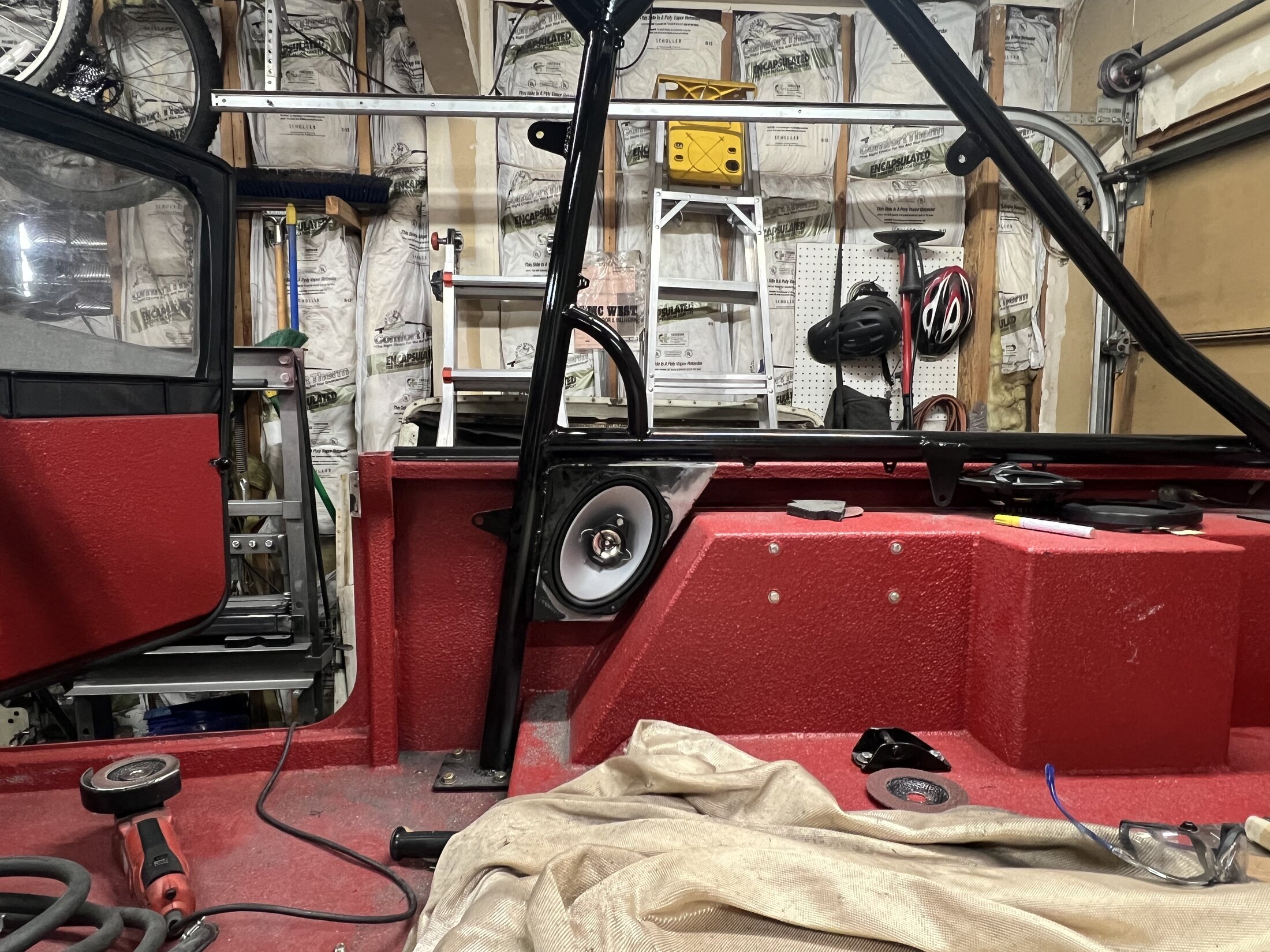

Back on track. It is as good as I can get it as it’s hard to get the grinder in place. I didn’t want to take the cage off as I had to use the Nextdoor app to find enough help to get it on. Most of my neighbors are out of town. It will work.

I’ve been radio silent this week and making really good progress. I will get some more pictures tomorrow. I have the cage in and all inside wiring done, plus I have music!!!

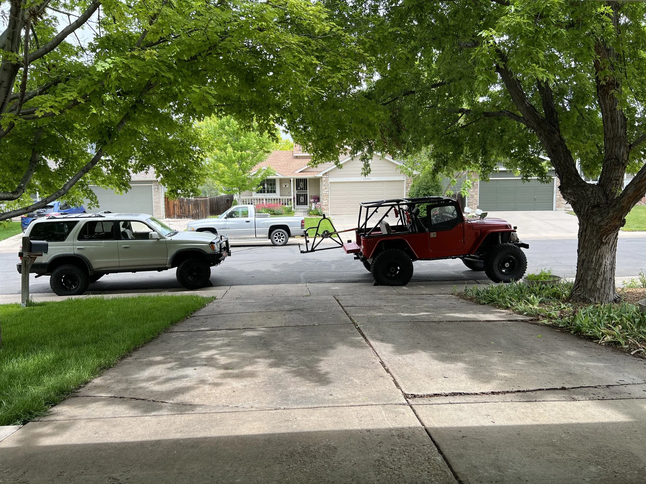

I gave it everything that the 4Runner’s winch could handle to get the rear cage bolts in. I am glad that I did those last as I don’t know that I would have been able to winch the cage forward.

Glad you got it worked out. I was wondering how the install would go as I didn't see ant temporary bracing in the pictures of you doing the final welding.
That has come back to bite in the a** in the past 😂
You also didn’t see me do the final welding. 😉 It only moved by 1/4” and I didn’t want to drill the holes larger
We only see what you show :cool: and tell.

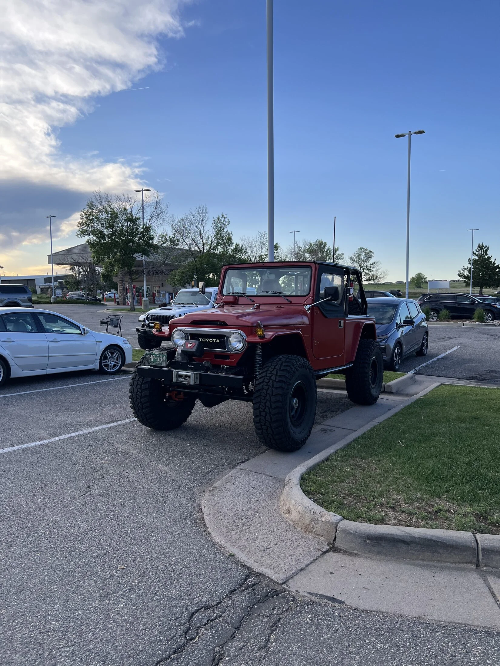

We had a great time hitting the trails for the first time since the start of this build, and we figured that we might as well hit an 8-rated trail for the first run! We made that decision because this was the last trail that I ran in this Cruiser before taking it apart and the comparison from before is crazy.
The Cruiser did amazing! I have a few things to work on, including ironing out some sort of starting issue when it gets hot. The crawl ratio is perfect and it feels like the same old Cruiser that is crossed with a bull dozer.
We only recorded to the halfway point as it got dark. We were winching over 3-4’ snow drifts at the end.

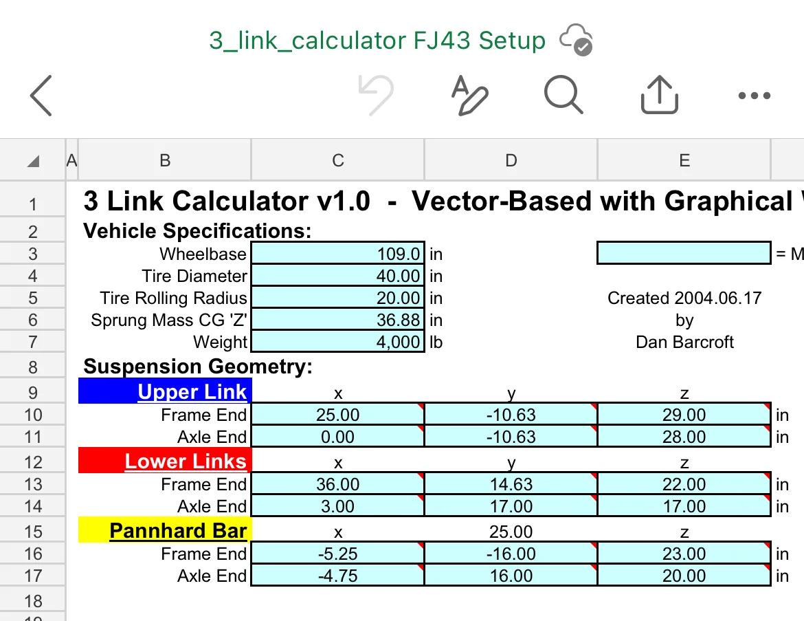

If you recall, what did the link lengths end up at ?
I don’t remember but I will get a tape on them when I get back home. What I can confirm is that I have almost zero axle hop and this thing plants down to the ground when I am throttling through the snow. I can’t wait to get it on a steep obstacle to see how it hooks up at an angle. I was too unfamiliar with it to try the wall and I don’t think that I need to tackle that one anymore.

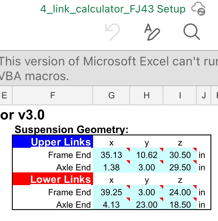

Here are my link dimensions. I double checked the lower links and they match.
Oops. X is the length and Z is the height from the ground.
Well technically the link length is the x frame end minus the x axle end…so your rear, upper link is 35.13 minus 1.38 long and the lower rear is 39.25 minus 4.13, to clarify for @peesalot .
It’s how you fill it out in the form, and when your filling it out on the later versions it’s much more visual and makes more sense than seeing a chart IMO.
