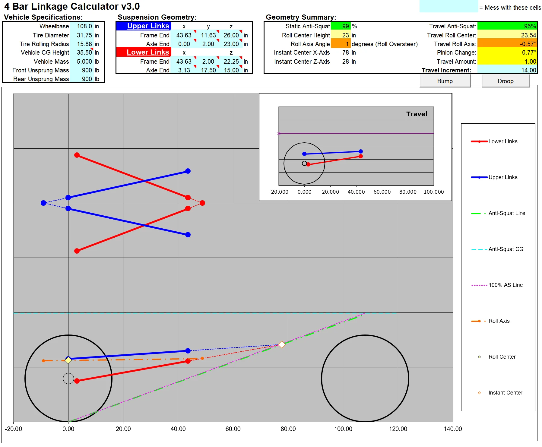

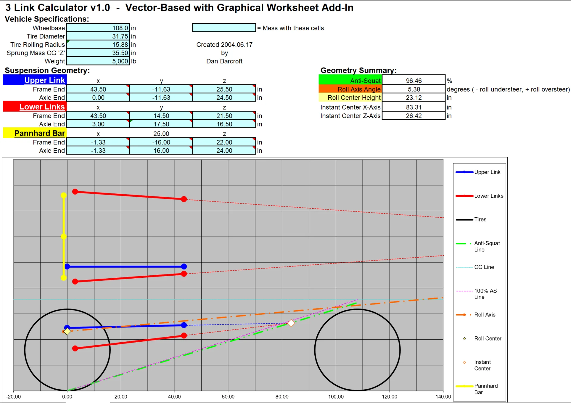

Before I order links, would you all mind having a look at these very rough specs and let me know if you see any major concerns with the geometry, please? I am running out of space to make it any tighter. I was aiming for around 90 anti-dive and 100 anti-squat without compromising the roll axis. It's tough!

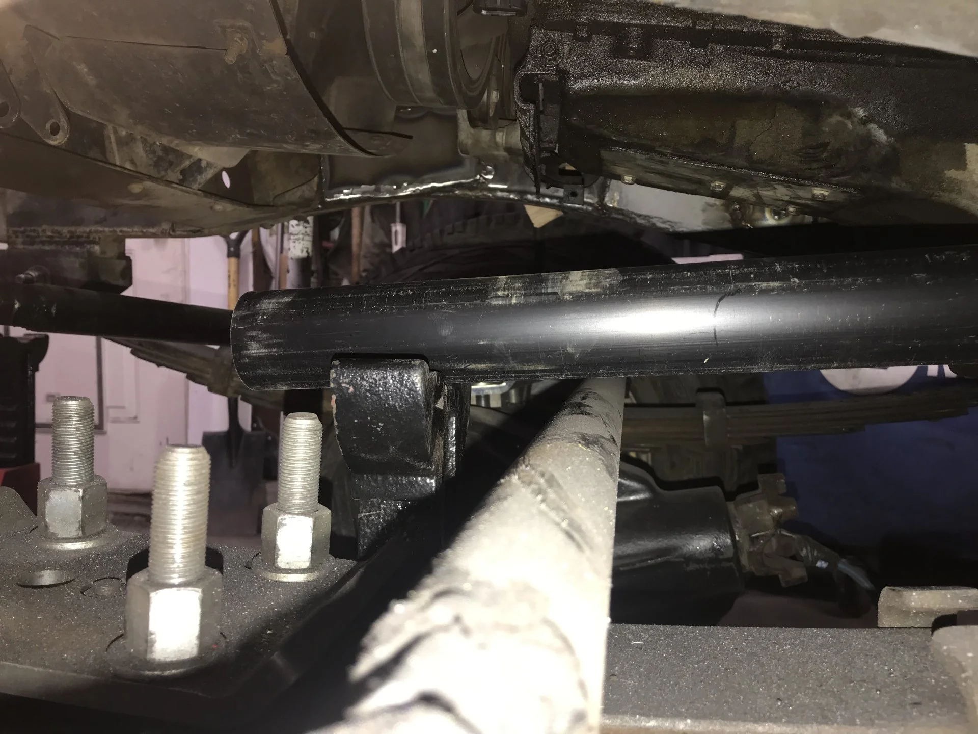

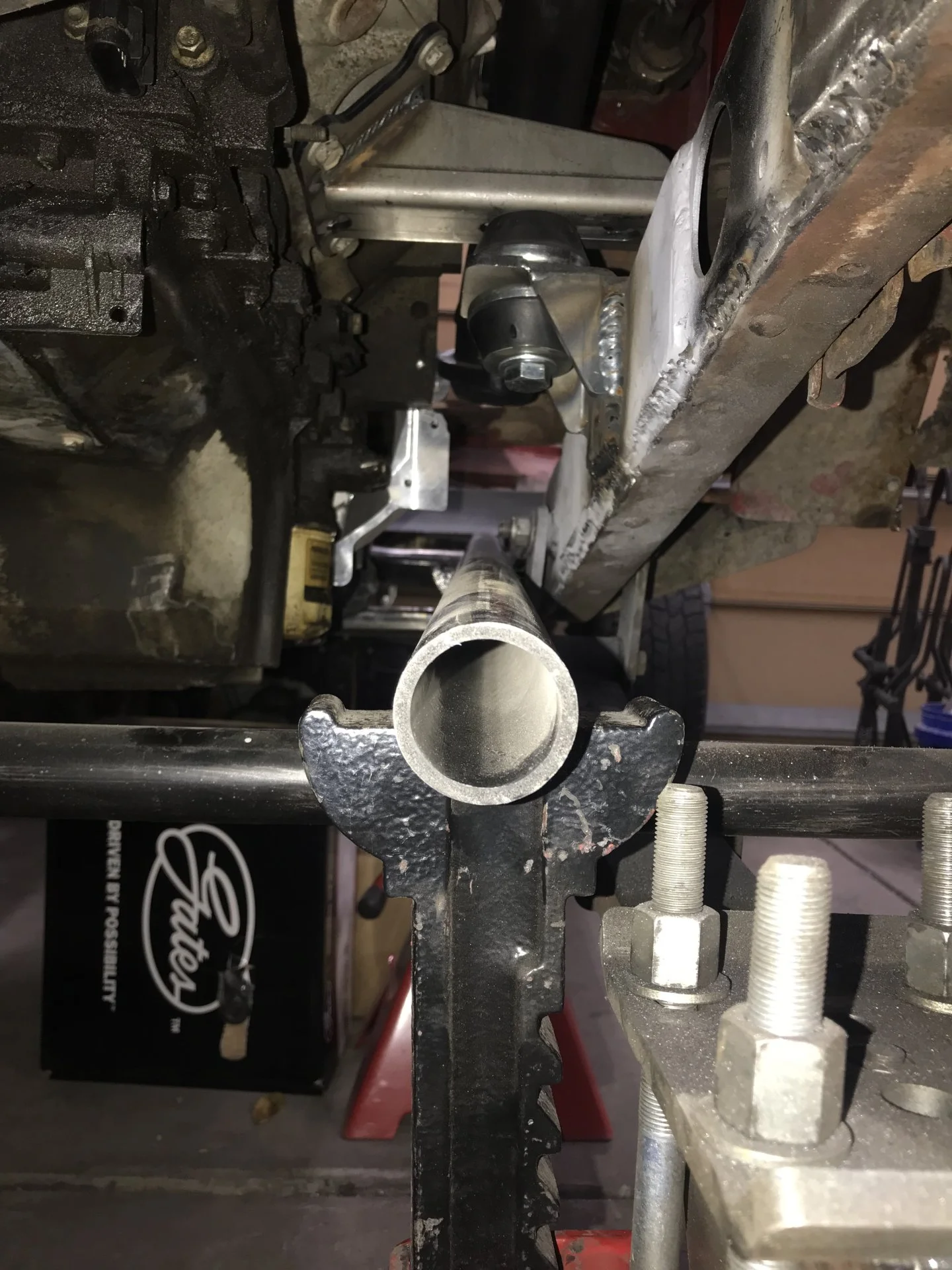

On a sidenote, I didn't take any pictures but I am mocking this up with a piece of ABS pipe. Okay, now I need to snap a picture of this...

I would shorten up the uppers. Normally you want about 75% shorter uppers.
Is that primarily to control caster/pinion angle change?
Yep, it's a good way to keep vibrations down at speed.
I second the 75% uppers. Your front roll axis looks a little high to me, I'd shoot for under 3*.
You all are saying that the uppers should be 75% the length of the lowers, not shorter, right? In other words, the recommendation would be to make my uppers around 33” if my lowers are 44”? Does that seem a bit too drastic of a difference?
I was trying to improve my pinion angle when the axle drops but I wasn’t thinking about caster. Good thing I’m just messing around with ABS and cardboard At the moment. What if I did something more like 44” lowers and 38” uppers?
It is not an exact science. the calculators are nice but it is also about packaging. If it does not fit than it does not matter. We used basic math on my race car but it was about were stuff fit. It handles good and I can run 18" chop at 50 mph with no problems. That is 18" up and 18" down! It works at speed but you will want to run at least a rear sway bar. I am running 14" shocks and a lot of HP so it will pull the front end up on hard accel but it does not bounce or hop when climbing and in the throttle. I do drive it on the road at times and it does fine at 45-55 mph. It is a different animal that what you are building but some of the same concepts.
Those are pretty long links. I think I'm somewhere around 35" for my lowers, 25" ish for my upper. I mainly had to do that to clear my oil filter, but overall length isn't too important.
I would run between 70%-80% on your lowers. It helps keep a constant pinion angle which can be pretty helpful. If you aren't planning on roading this thing at all, and are just planning on going slow, 100% of the lower length can be good to get some better longevity out of the driveshaft joints, but that really isn't much of a problem.
The roll axis has been a challenging one since I shortened my front axle to 63” WMS. I’ll mess around with the figures a bit more.

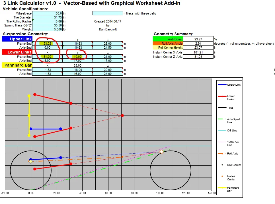

@matzell, @DangerNoodle and others, please have a look at the revised front 3-link calculations below and let me know your thoughts about the lengths of my upper and lower links. I am hoping that they are not too short. I am trying to create enough room for the exhaust. I'm thinking that this should flex fine with a 14" shock as the lower links are still 5-7" longer than where my current shackle sits.
Also revised is the inboard of the lower links at the frame. If I inboard them by 4", I will lower my roll by 3 degrees. Are there any concerns with placing my lower links inward from the frame? Does this even matter in your opinion?

I can recomend not inboarding the lowers. It's a mistake I made, and it has made it much harder to run exhaust. With your current roll axis, I wouldn't bother.
