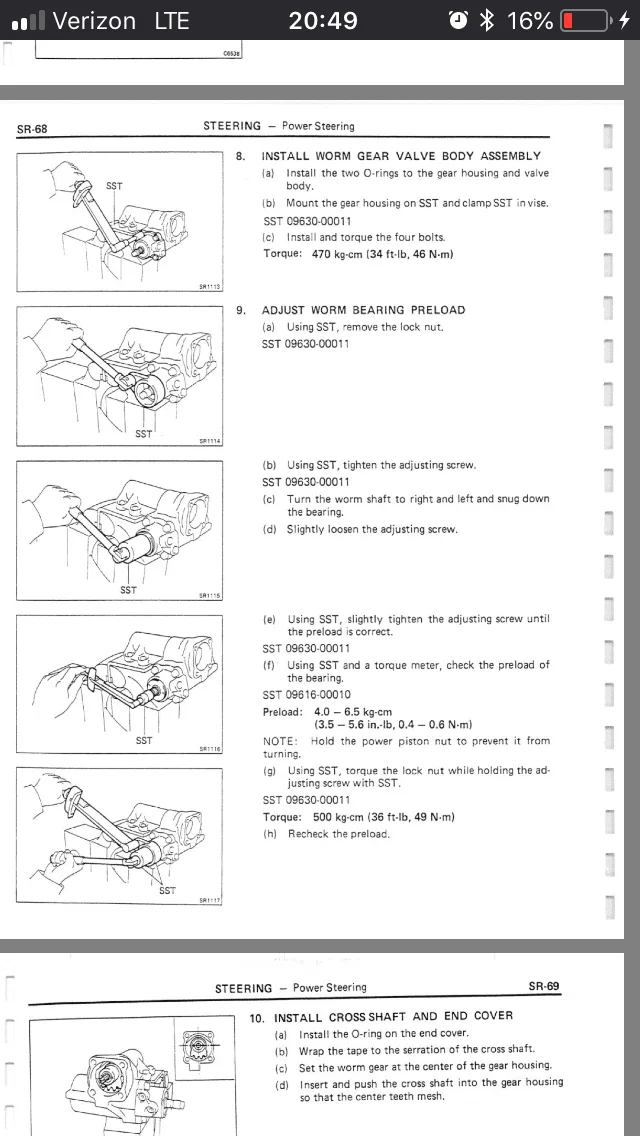

Finally got everything back together and I feel that there is a lot more play than before the rebuild. Have the adjusting nut cranked down as hard as I can and there is still play. What should I be looking for? I had the wife adjust the wheel while watching the linkage into the box so I know its not slop in the tie rods.

Play, as in turning the wheel before the pitman arm moves, or general loose steering? Are you referring to cranking the threaded adjusting rod down all the way? A picture or 2 would be helpful.

How much preload did you put on the input bearings?
Oops, yeah, forgot about that... that is the threaded cap with the two holes on it on the front of the box where the steering shaft connects.

I marked it and thought it was back to the position pre taking it apart. Was worried that might be it. Guess I will pull it and crank the preload down a little more!

Best to use an in/lb beam type torque wrench and set it to spec.
Set it to *fj60/62* spec?
Yep, plus a bit. On the '80, Toyota considers the input section not serviced, so doesn't publish a spec.

Searched the 60 forum but no luck. @Tools R Us, Do you recall what is fj60/62 torque spec for preload?

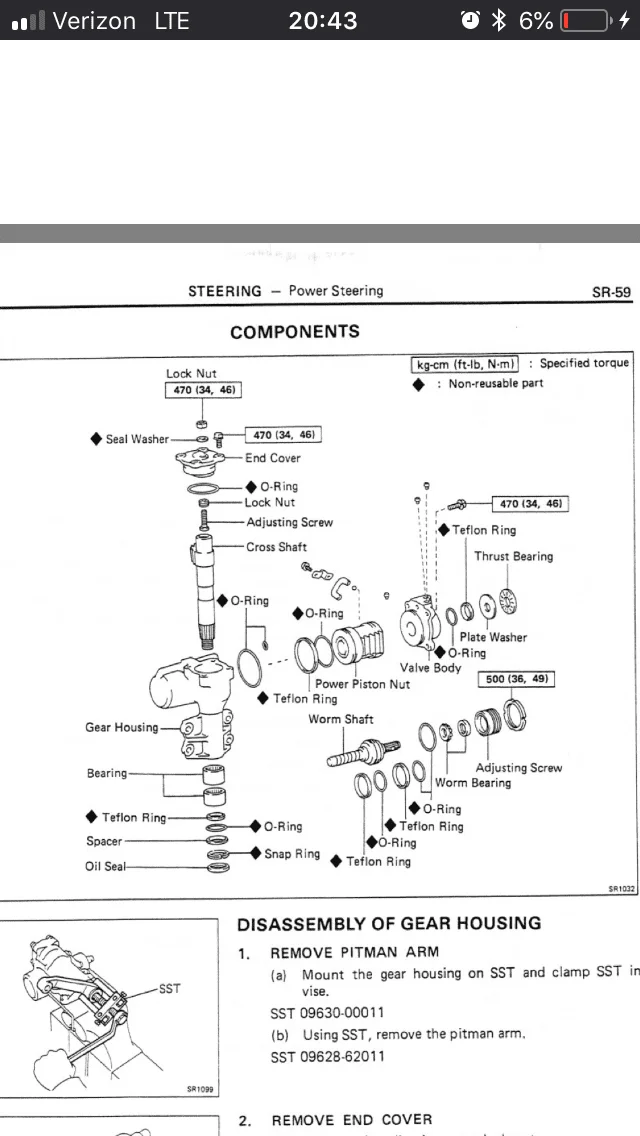

All broken down. Piece of cake except for the plunger piston nut. I had to drill mine out and i ruined the spring and then plunger. I would suggest ordering these ahead of time if you dont have access to a welder. Will follow up with part numbers when i have them.
I don't have that info handy here. Snag the FJ60 chassis manual; For Sale - 40, 50, 60, and 80 series FSM for a hell of a price. it has the procedure. The big difference in the '80 box has the adjuster internal, but the concept is the same.
Thanks @Tools R Us !
Looks to be a lot of SST use here but still good to know preload is 3.5 - 5.6 in. Lbs.
