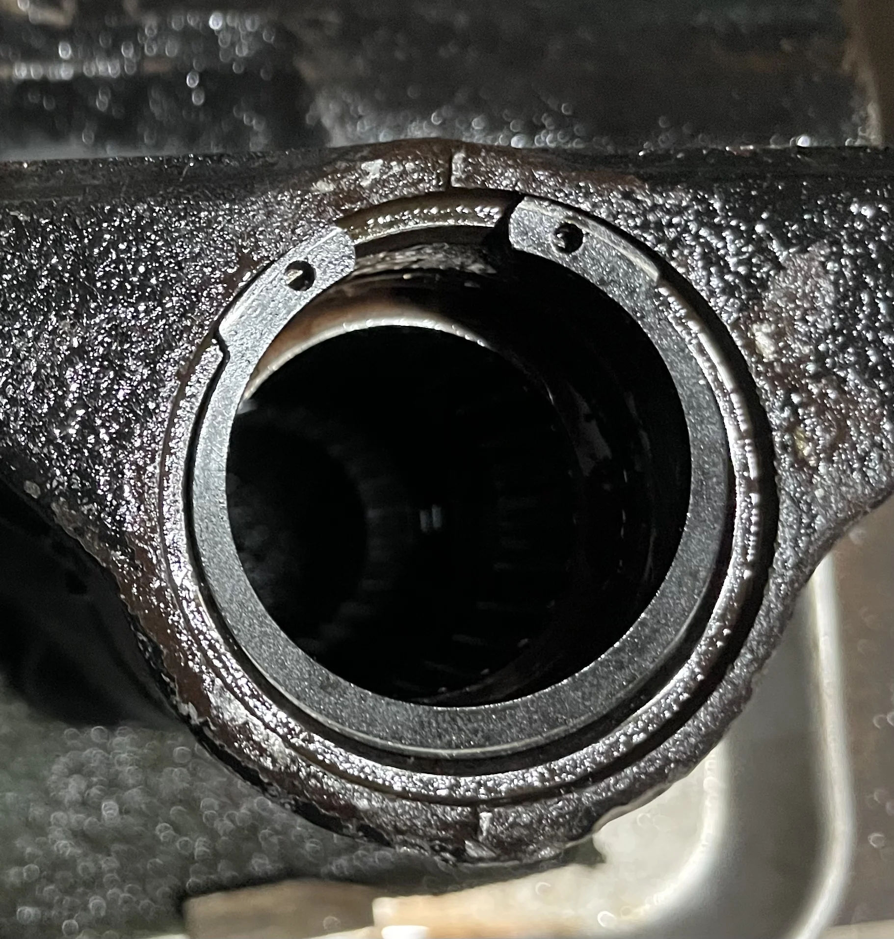

- After removing the sector shaft, I looked closely at the seal which was pushed out at an angle. I removed the seal and noticed that the snap ring was askew. I thought, "this is what happened, I didn't make sure the snap ring was seated securely which pushed out the seal."
- I removed the remaining rings and put the snap ring back in, making sure it sat properly in the groove. It did. but when I moved it so the two open ends moved all the way into the groove, I was able to pull the closed/rounded side out of the groove and slightly up.
- This was the actual problem.

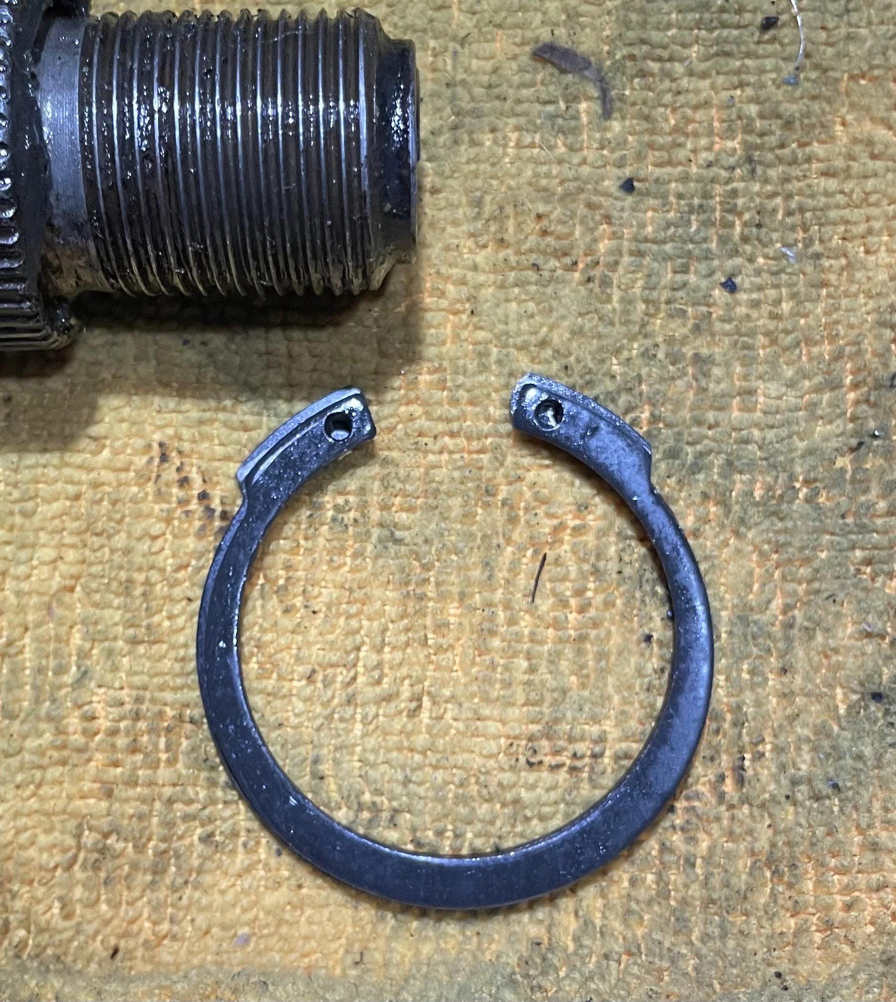

-I compared it to the old snap ring (that I originally removed for the reseal) and there is a "small" difference in size. The old one is larger. It doesn't look like much, but it was enough so that the new snap ring was able to come out of the groove and push the seal out.
The reseal kit I bought was not a "Toyota" kit. I purchased it on eBay, largely because I needed it asap and they had fast shipping. If I remember correctly it was about $48, so not much cheaper than the other lower-cost kits. And when I compared everything when I received the kit, the size "matched" but I didn't look super close.
Photo 1: Snap rings compared. New one is on top.
Photo 2: The NEW snap ring when held over the opening for the sector shaft.
Photo 3: The OLD snap ring.
This seems like the problem. Unfortunately, the o-ring got chewed up a bit so I won't be able to test this for about 10 days, while I wait for the new replacement parts to arrive here. However I am pretty confident this is the issue.
Lesson for me, just buy OEM for the things that really matter.
