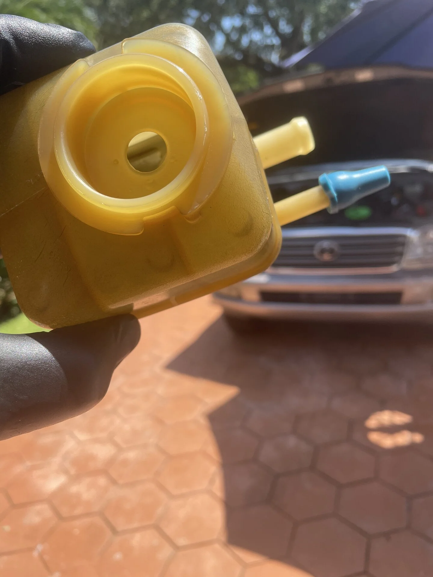

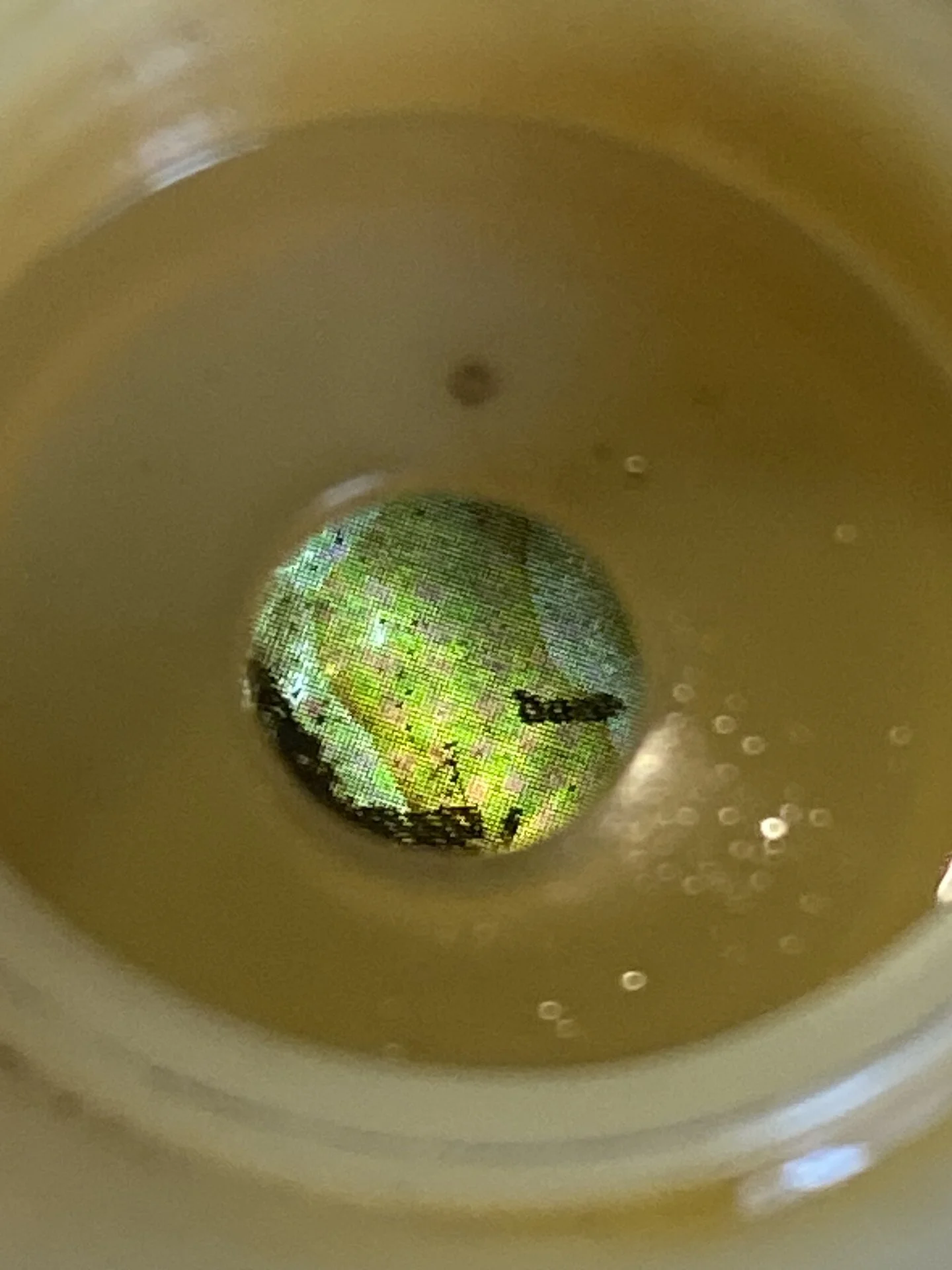

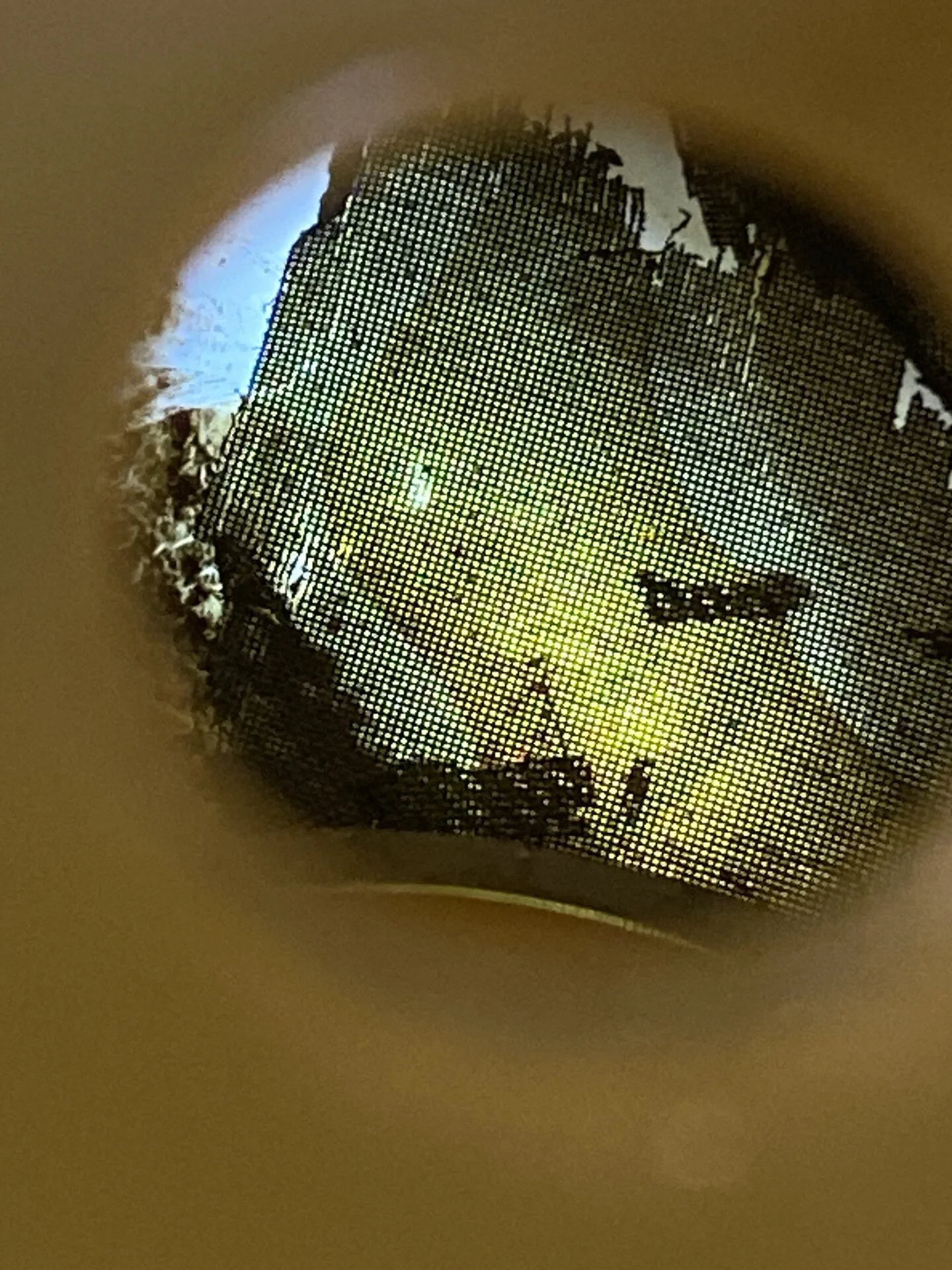

2001 lx. Original everything. Kept Cali/nev dry. Diagnosing front end noise when turning. Starting with ps. Removed and emptied reservoir. Fluid occasionally replaced. Maybe never flushed. Not often enough. Don’t remember fluid type.
Photos show screen disintegrating.
Edit: wasn't meant as reply to Forger. Just extending this thread.
Plan is to clean reservoir, flush. Screen is toast.
Best to replace, if screen damaged.
Yes. I will look into that. Screen seems like a weak point for these reservoir. No body was in there mucking around with it and it just fell apart by itself. I removed as much screen material as possible to keep it out of the pump. The experience will change my maintenance routine.
