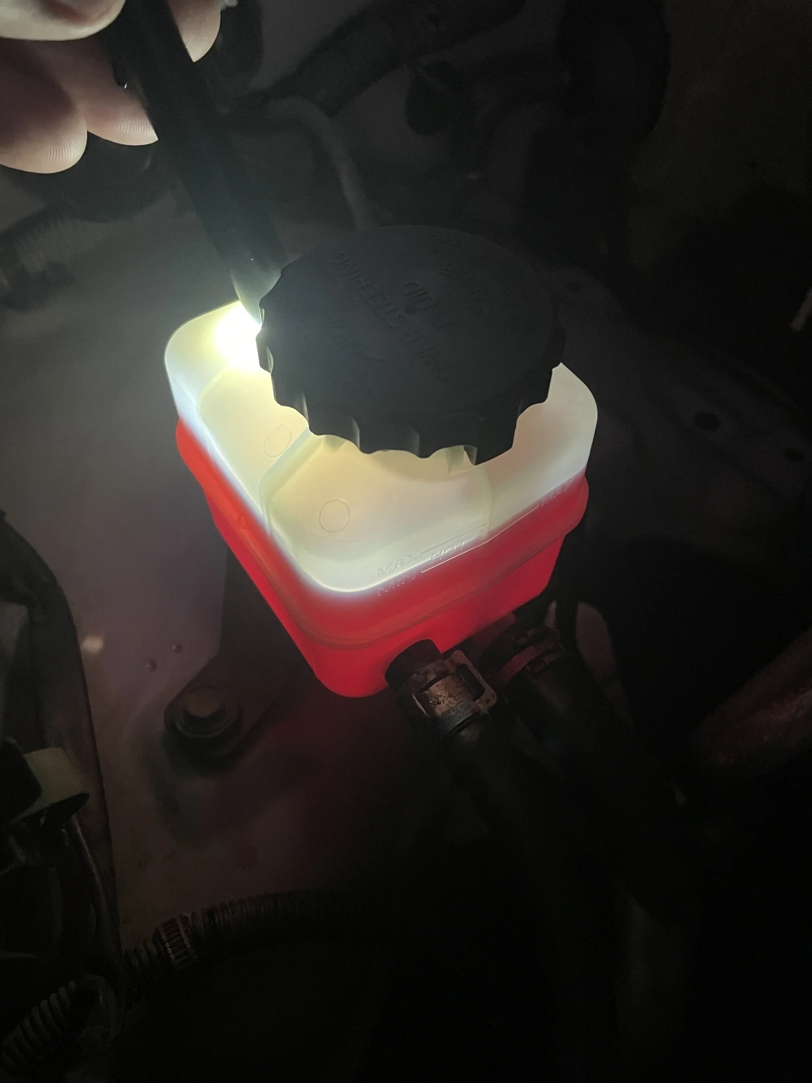

Rhetoric - thank you for providing the part number for the GM power steering reservoir. I just swapped a new reservoir in this evening after flushing my steering system with 3 quarts of new ATF. The reservoir costs $38.79 on Rock Auto, with 7.99 for priority shipping. Total cost of the fluid was less than $20.00, so overall a very economical way of replacing the old/stock power steering reservoir. (Mine was an ugly yellow color after 24 years of life on the 2000 100 Series.)

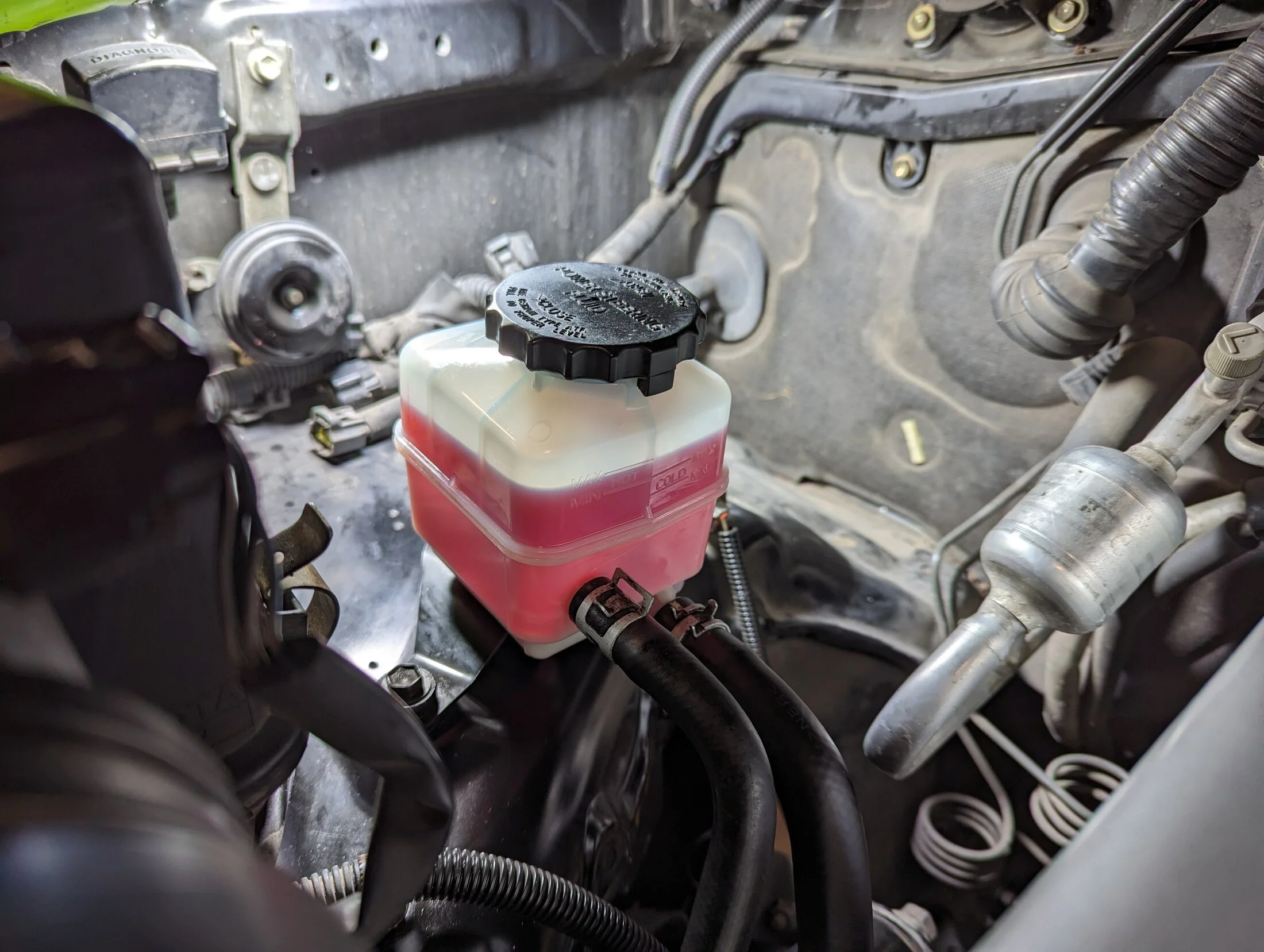

My final photo looks almost exactly like @Rhetoric lol

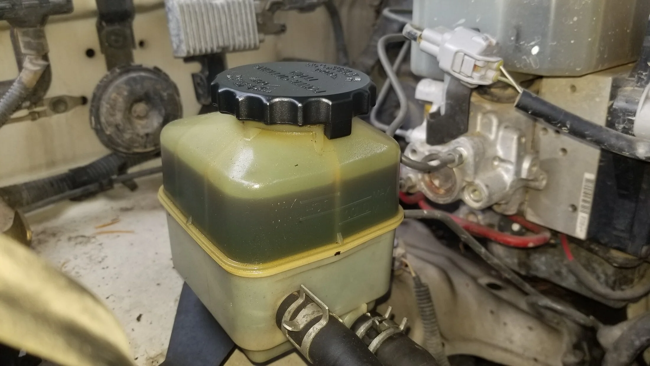

Who knows if or when this has ever been done on this truck. The fluid was absolutely black with clearly some not so great looking sediment in there.
