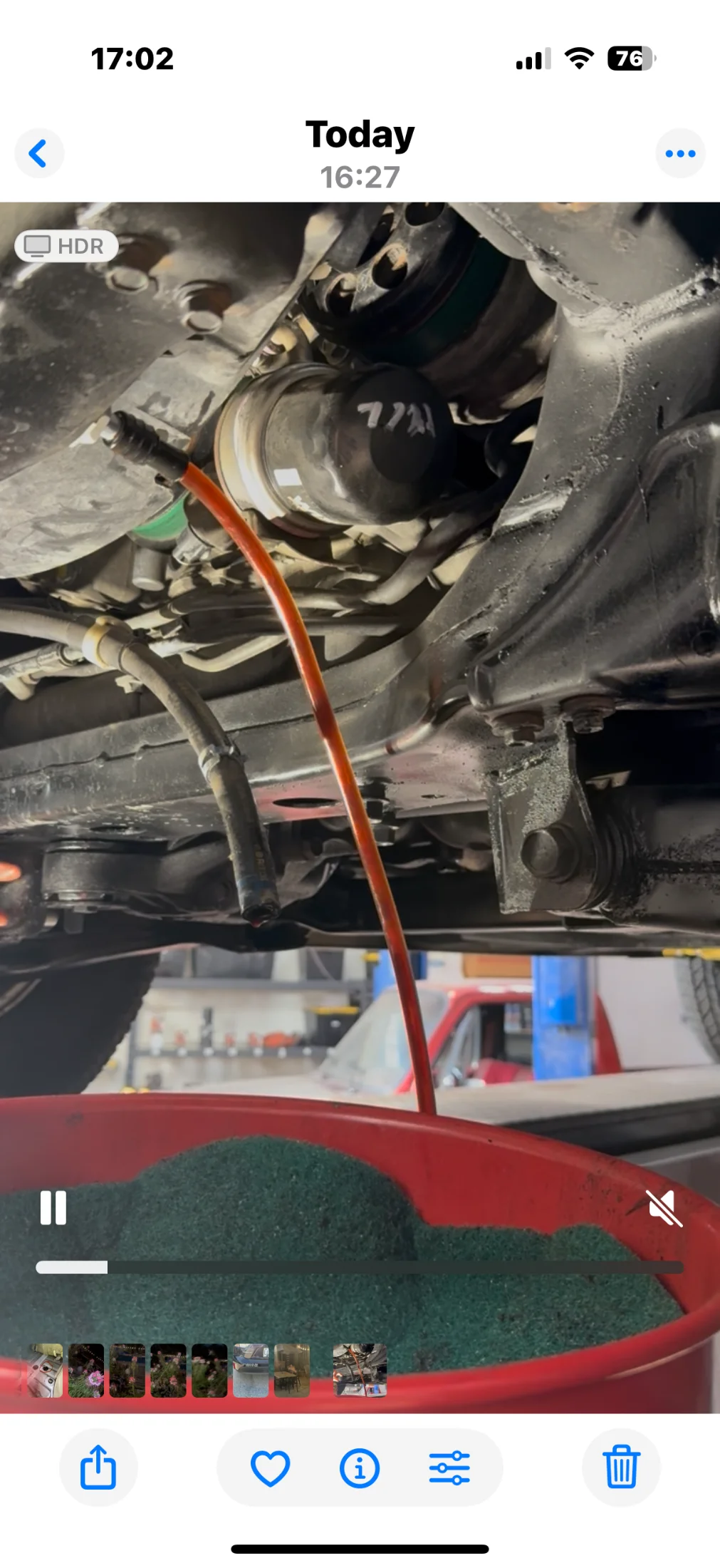

I just did mine a few weeks ago. It was really straight forward and I normally screw up small tasks. If you pop the hood and look down between bumper and radiator/condenser, you will see two black trans fluid hoses. I disconnected the return line that is making its way back to the trans. Used a connector to attach a clear tube from that line into bucket with quart marks on the side (HD/lowes paint department sells these).
Steps:
1. Have helper start vehicle and let 2qts drain out into bucket. Then turn off vehicle.
2. Pour 2 qts new fluid in via dipstick tube.
3. Dump bucket into container for disposal so it’s empty and ready for another cycle.
4. Keep cycling vehicle on/off adding and removing fluid until it’s bright red or your out of replacement fluid.
