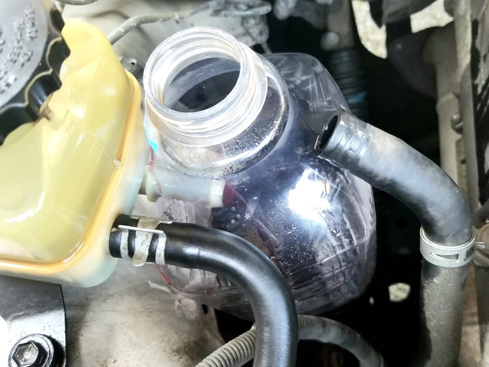

One only need poor out the reservoir. See second picture in OP (post #1).

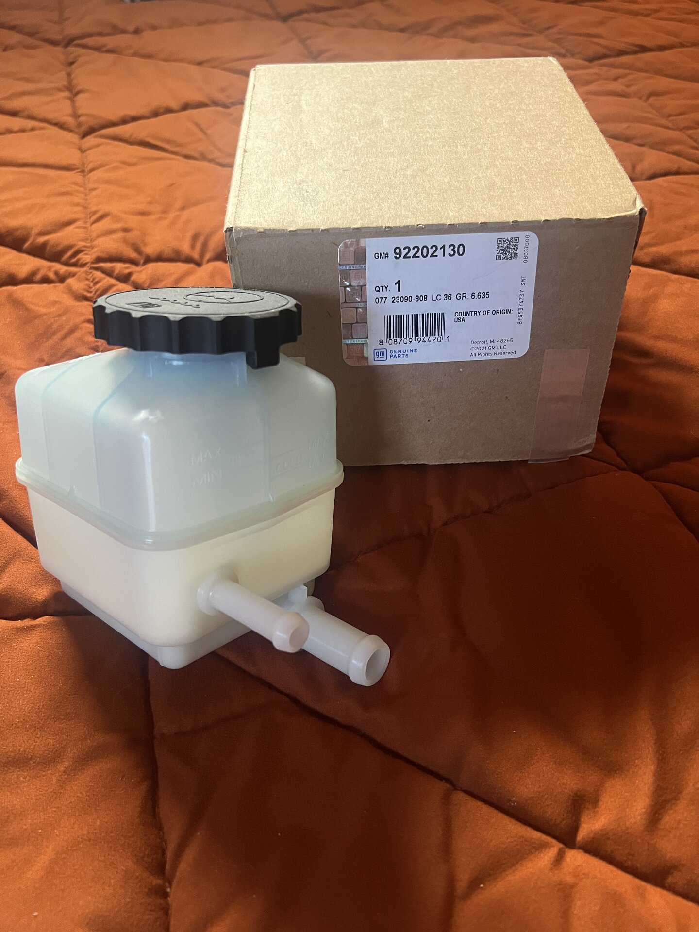

I found a cheaper alternative to getting a replacement reservoir for these trucks if you aren't in need of the metal bracket. I can thank an old Motorweek review segment of the 2006 Pontiac GTO for this. This reservoir is used in many vehicles so after seeing it under the hood of that GTO I dug up a P/N.
GM 92202130
I received the part yesterday and can confirm it's identical to the reservoir in our trucks. They changed the labelling on the cap to just a couple info graphics, but that's irrelevant to me.

If that is the same and works with our system that is a great find. I just spent $148 on a new OEM reservoir.

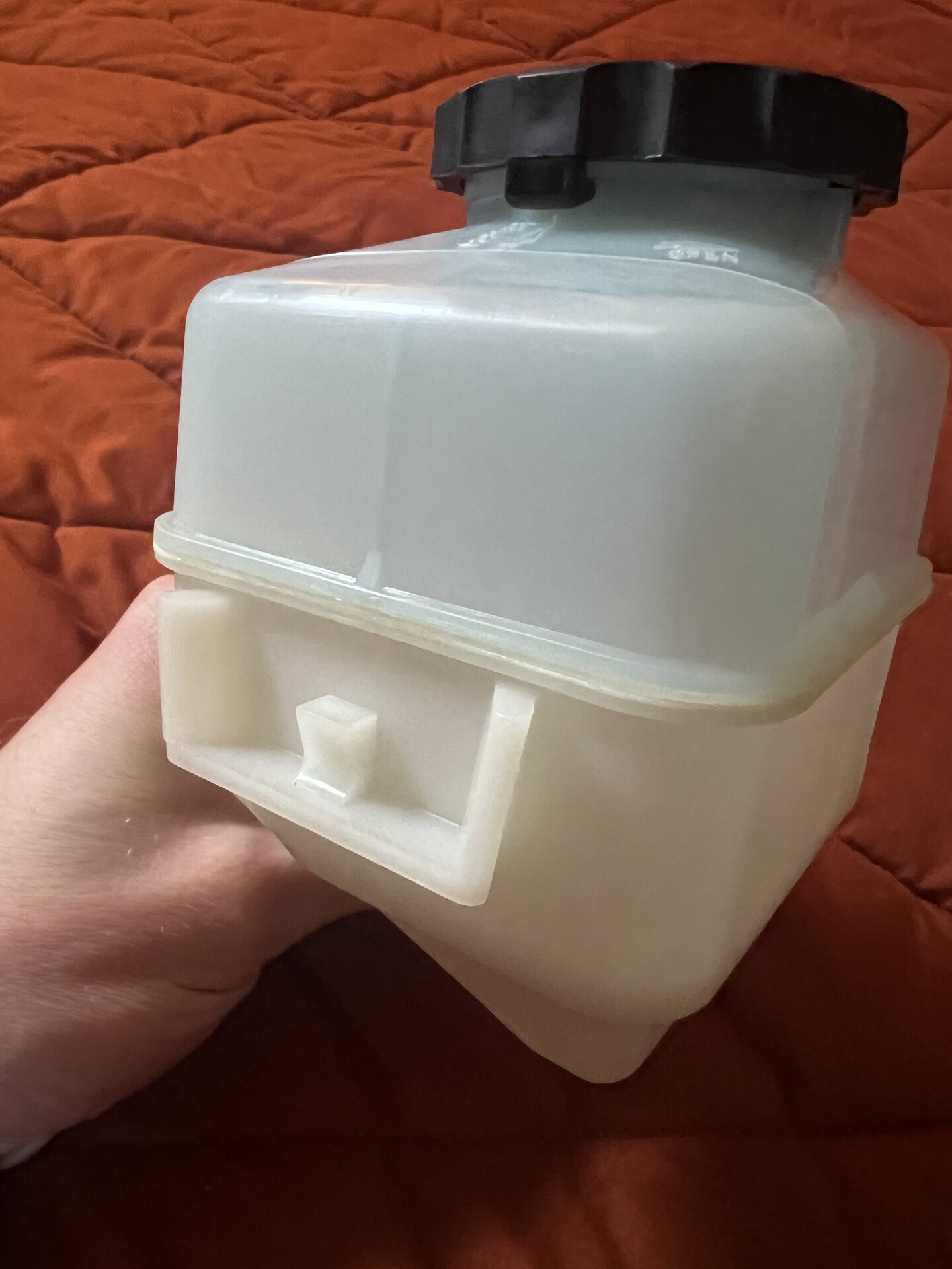

Mind posting a picture of the back where it clips in?
I verified the diameters of the nipples fit the Toyota hoses perfectly.
This seems to be an "off the shelf" part that Toyota (and other manufacturers) used in a bunch of applications. The 92-01 Camry, the 95-04 Avalon, to name a few. But each Toyota res comes with a specific bracket, inflating the cost. What we need is just the reservoir itself and these are all identical.
I went with the GM version vs a knock off part as I figured going with a 'Genuine' part it would be the best of the batch. The knock offs have different cap designs and what appear to be inferior plastic quality.

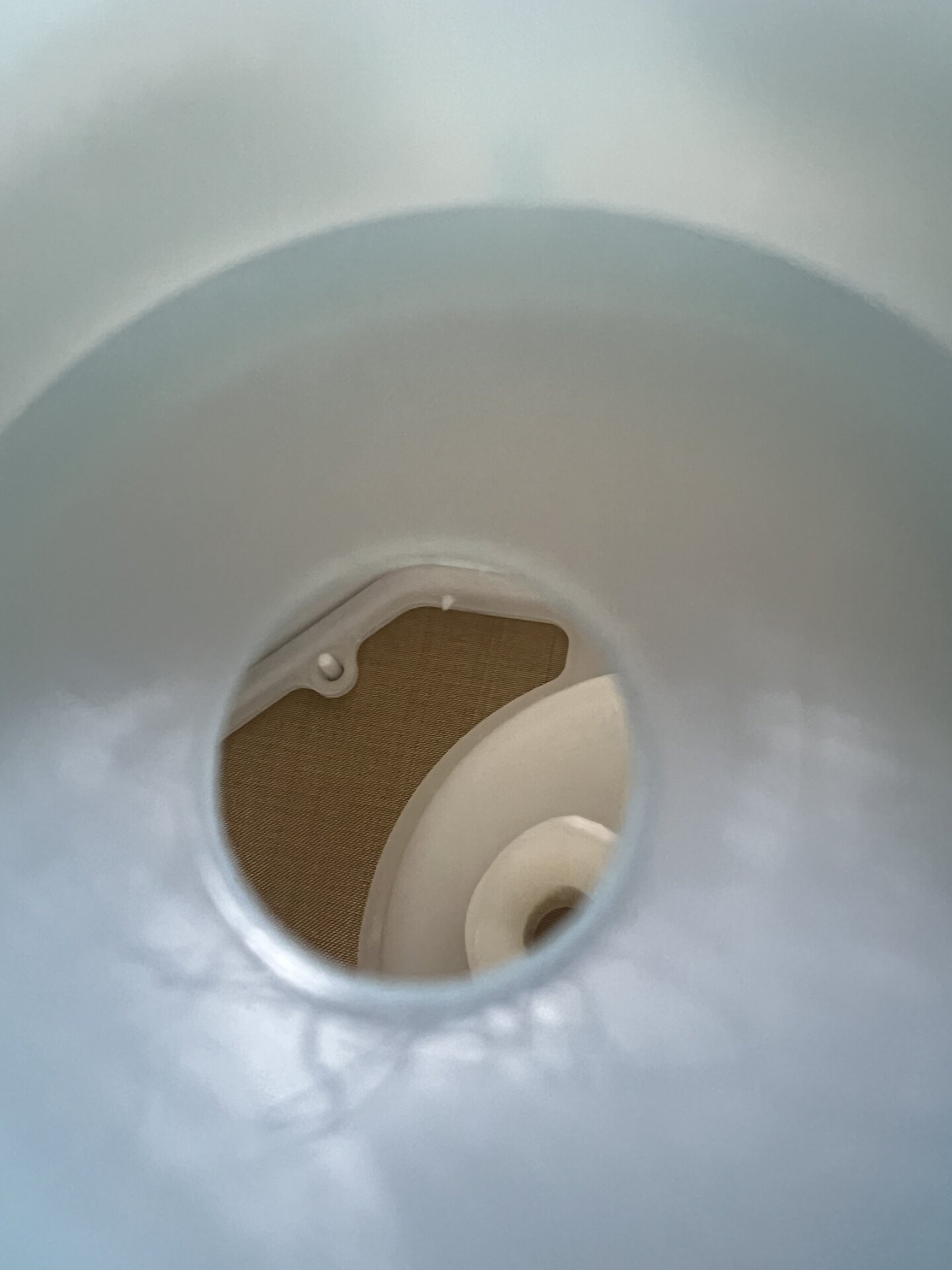

If you look at additional markings on the reservoir itself, there is a PA6 stamp on the firewall side of the reservoir and a PA6-GF30 stamp on the bottom.
These markings exist exist on the GM reservoir and the other Toyota model reservoirs.
Images are from genuine Toyota part 443606210
