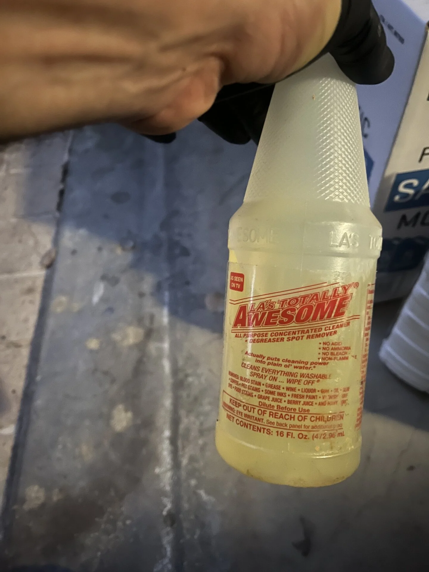

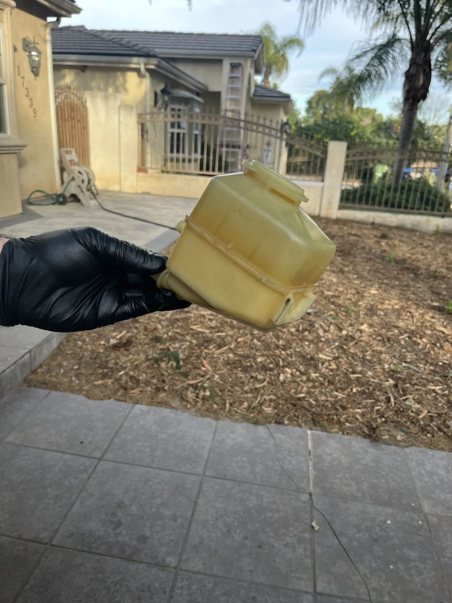

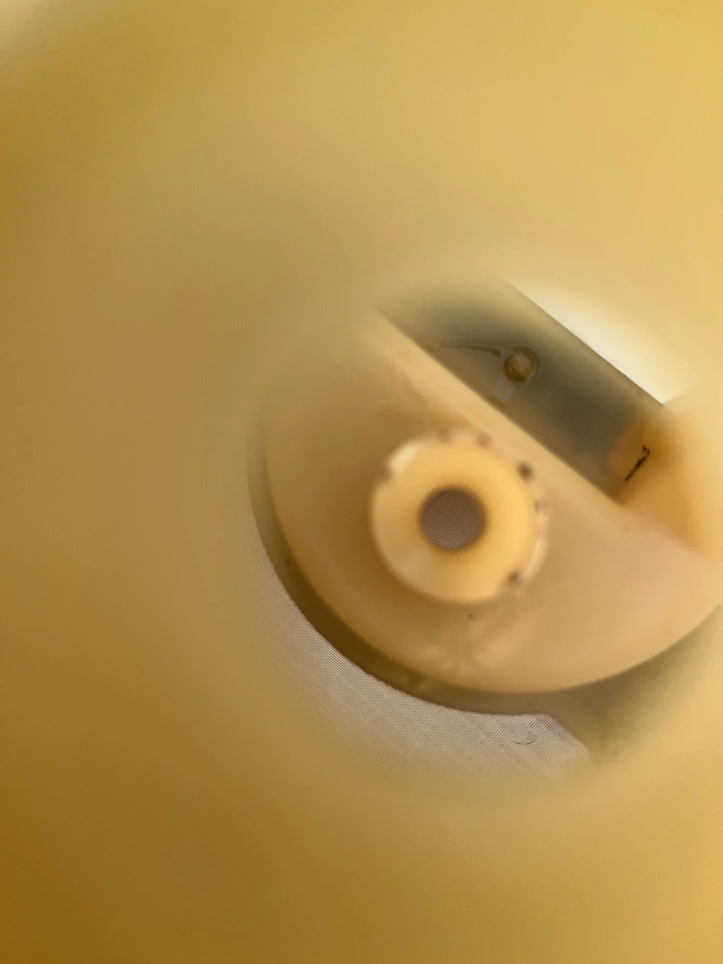

I could not believe how dirty the reservoir was/is. Soaked one day on simple green and another day in bbq charcoal fluid but walls are still dirty. Screens look good though.
Thanks for the responses.
Update: reservoir cleaned really well using the Totally Awesome degreaser - took about 15 min. Simple green and charcoal fuel did not do that good.

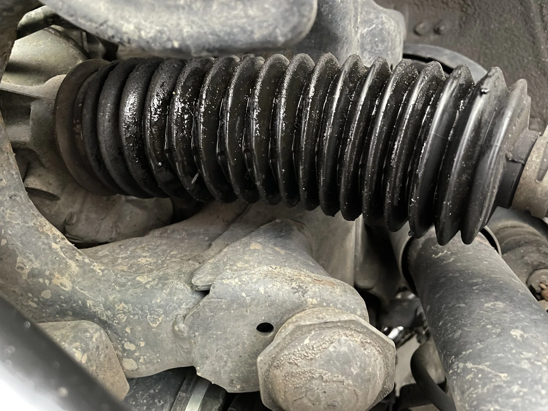

If you are getting a leak from the driver side steering rack boot, which is torn, I would replace the rack, or order the service kit for the steering rack and rebuild it. The pump may still be good. Start with the known problems first.

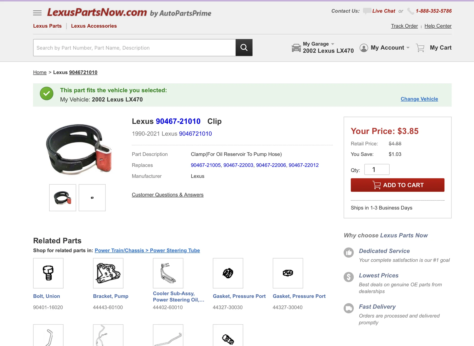

Is this the right part number 9046721010 of reservoir suction hose (larger hose) clamps? I keep getting contradicting information between partsouq and dealer sites. Thanks
‘Looks like the correct part number

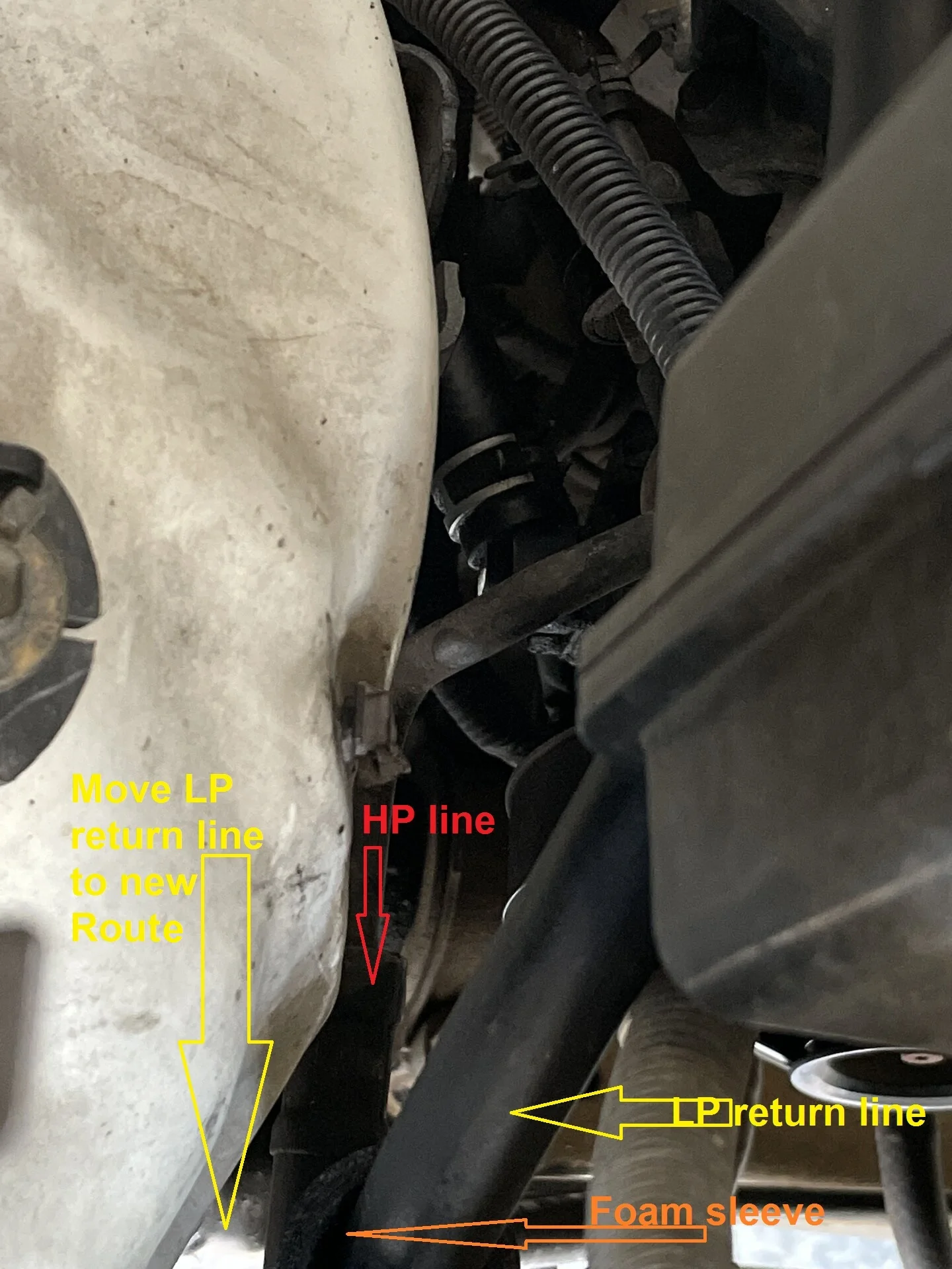

Is this broken clip supposed to hold the PS line? The 3/8” hose is obviously not contoured like the factory hose and I’d like to secure it away from the belt if possible.
You can use 1 or 2 of those clip. I also like routing new LP return hose between PS high pressure line and inner fender. I take old foam sleeve off old hose, clean and use on new 3/8" ATF cooler hose. Side sleeve to a point it cushion/protects hose from inter fender well rub.

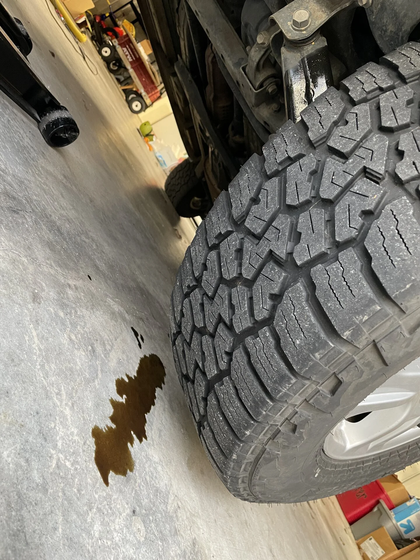

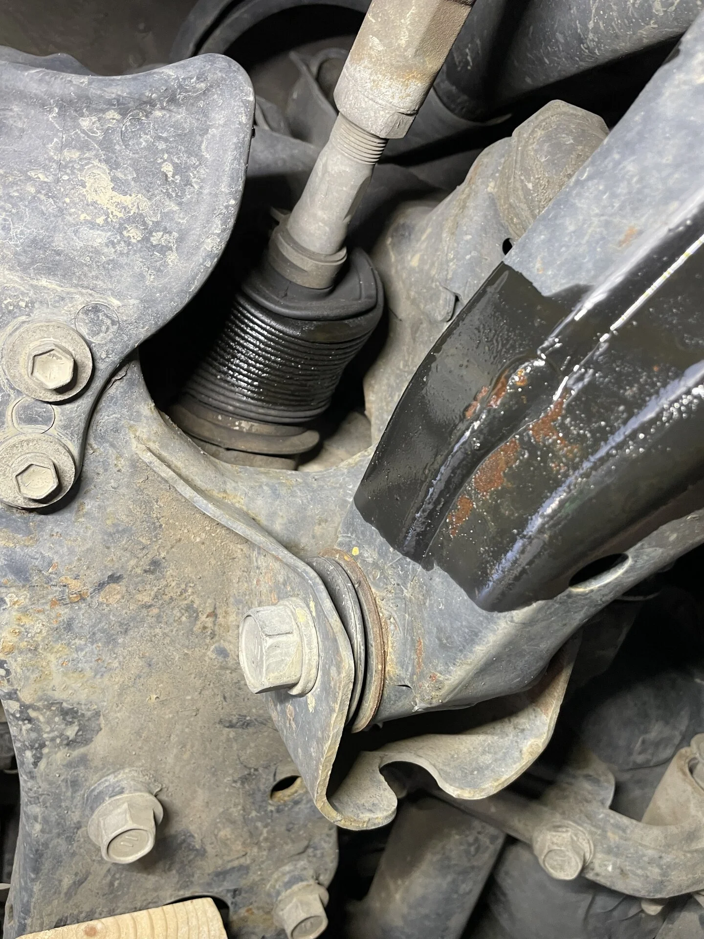

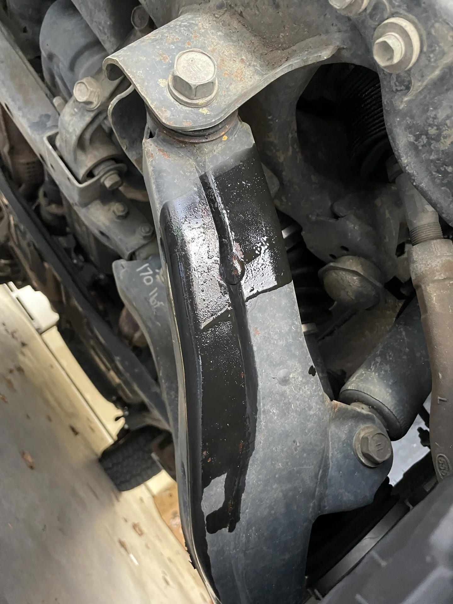

Also I left if turned to the right overnight and woke up to this…. Ugh. The stuff on the ground is definitely old fluid, not the fresh stuff I just put in. Boots have been “damp” on the bottom since I’ve owned it but never saw any drips or anything.

Have any pictures of this? Trying to visualize but can’t quiet get it.
I started using this route between fender & HP (high pressure line coming off vane pump) for LP (low pressure) PS return line (hose) on 98-02. Because bracket/clips often missing or busted. Which would often result in belt rubbing/cutting LP return hose on vane pump pulley and or drive belt.
I reuse foam sleeve that is found on old OEM return line, to protect hose from fender rub.
Recommend you slide off those boots and have a look…
