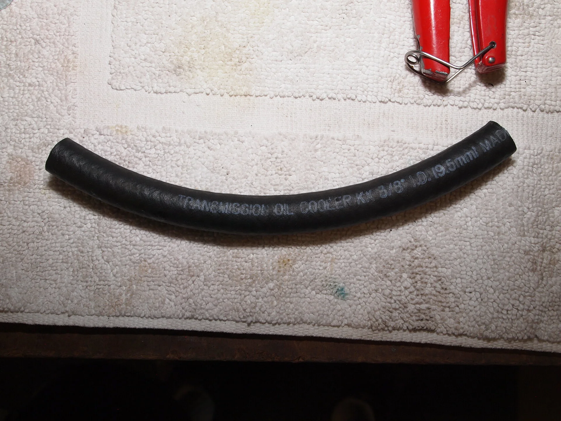

Having just read through this, I noticed some 3/8 ID hose is claiming not to fit well. Can anyone provide a brand that does work well? Maybe @2001LC
For non OEM 3/8" transmission hose is best I've found, so far! It's just a bit tight, which is better than loose.
Paul, do you recall what brand of hose you have been buying?
For 03-07, Toyota OEM for reservoir return line (different set-up than 98-02).
For the 98-02 I've had several. The best was from Advanced Auto in 2018-19. It's OD fit the OEM clamps perfect.

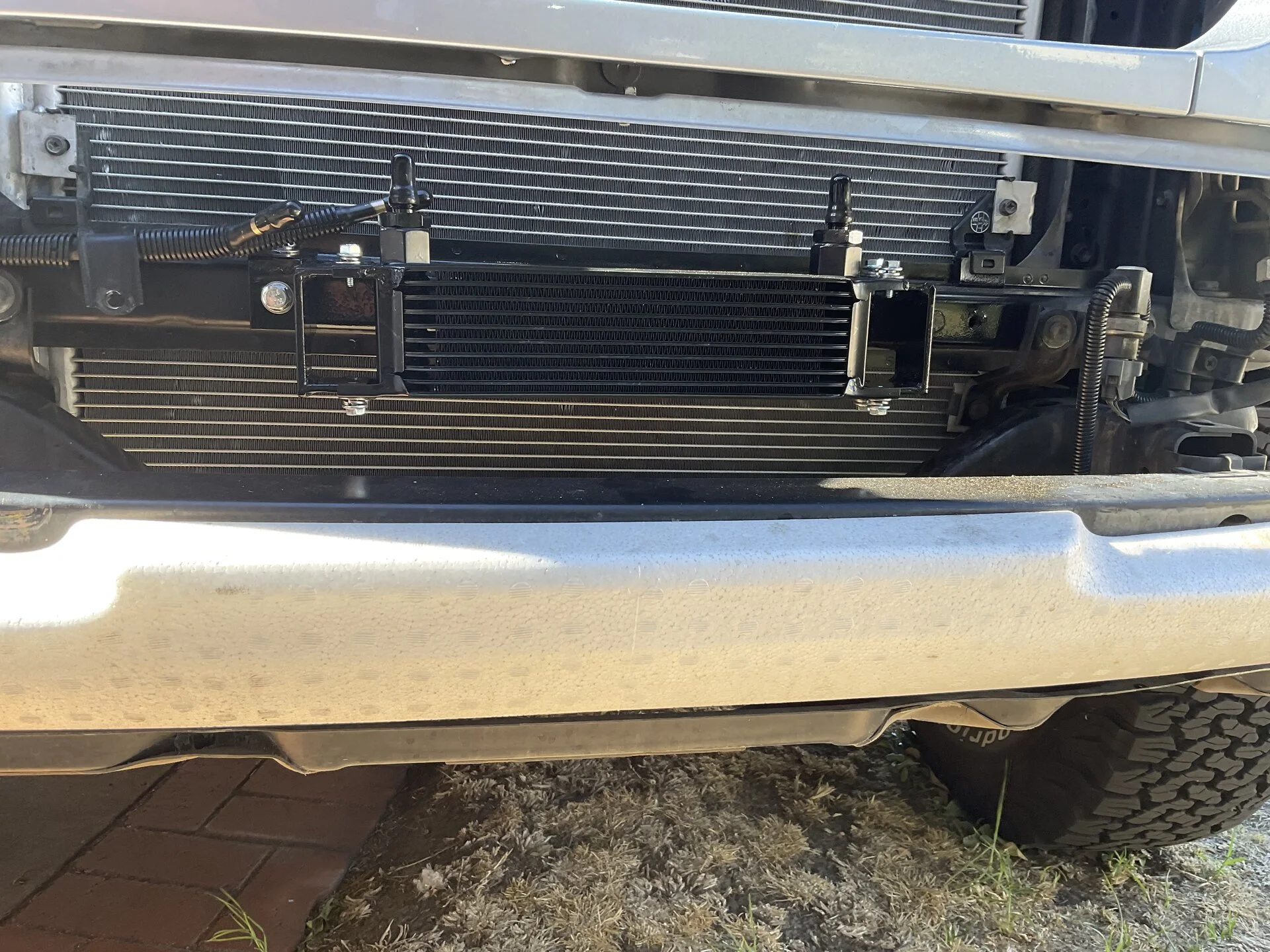

Fabbed up a couple of brackets for a 20,000 btu power steering fluid cooler… I completed this power steering cooler installation just before thanksgiving.
On this forum, I have read many a story about the need to replace power steering racks and power steering pumps… and Toyota did begin providing a cooler for power steering fluid beginning in 2003… Although it was a cheap heat sink paper clip type.
The root cause of power steering rack and pump failure is heat… Super heated fluid swells spinning shafts, and causes premature failure of seals that create an expensive end result. I figured if I could cool the fluid, these parts should last much longer if not indefinitely… Especially if you use full synthetic high quality fluids.
I found that after driving for as little as five minutes, the power steering cooler becomes quite warm/ borderline hot. I also found that the hotline into the cooler is MUCH warmer than the cold line out of the cooler. So despite the diminutive size of the cooler that I installed, it is quite efficient at shedding the unwanted heat that could potentially cause the failure of very expensive parts.
Used wet location high voltage splicing sleeves from Lowe’s to snake the hoses past the radiator foam to achieve the most direct routing of the cooler lines, and shield the lines from possible abrasion. Looks and fits more OEM than routing the cooler lines around the bulkhead behind the headlight…
In summary, that little cooler is doing its job, and I am quite happy with the installation. The fluid in the reservoir is much cooler now than it was prior to the cooler installed.
I was striving for an OEM appearance… all metric bolts and M8 riv-nuts… OEM constant tension hose clamps.

I was thinking of adding wire loom over the front lines like you did since I have a bunch left over, but wasn't sure of moisture getting trapped and damaging the hard lines lines. How long have you had the loom on?
The split loom is for impact protection from stray road debris and/or errant tools handling. I thoroughly sprayed each hard line with Boeshield T-9 to prevent corrosion and for wax surface protection prior to installing the NYLON split loom.
I installed the split loom over all of the AC lines as well for the same reason. Would be a shame to damage a hard formed aluminum AC line by dropping a wrench or ratchet while working on the car. I understand that 2004 and newer models had split loom factory installed in certain frontal locations on the AC lines.
I went ahead and did all of it… as impact protection.
Under hood temperatures get quite high. Strongly recommend UV rated and flame retardant 6/6 NYLON split loom for any under hood areas. It is the same material used by the factory for all wiring harnesses…
NYLON costs more, but it’ll last a lifetime… the cheap stuff from Home Depot will dry out, get brittle and disintegrate within a couple of years… and the cheap split loom can melt and catch fire!!!!
The same advice for Ty-raps or zip ties… use 6/6 NYLON with stainless lock tabs if you want them to last. They cost more, but you’ll only have to install them one time.
