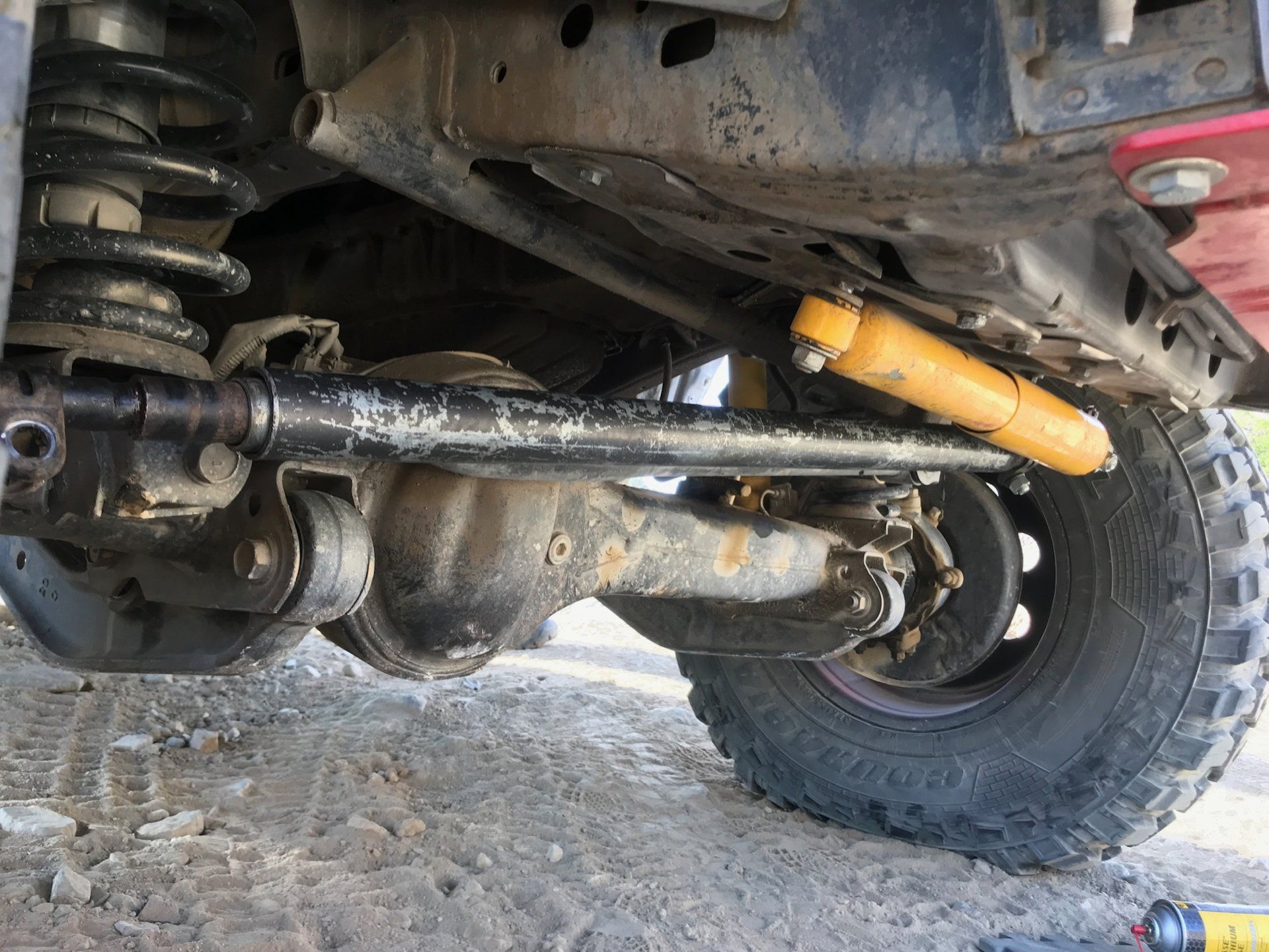

Steering arm keeps bending (pic included)
I bent my steering arm by ramming it on a rock I didn't see in the desert
We did our best to straighten it up as much as possible with a winch so I can stumble home
I ordered new ones from Slee
Then at the shop we took it down from the rig and used the proper tools and a press to straighten the arm. And we checked the alignment that was in spec
I drove with the arm for 2 mounts with no problem until I got the new ones fro Slee
Fuze my :deadhorse: I added a set of tie road ends and that's it

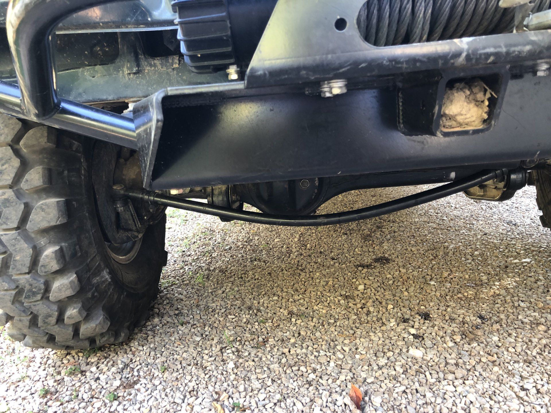

Do you really want to know? Did you have an actual opinion or did you just copy and paste some wiki article on tubing. Do you disagree with what I said? Do you advise running some sch 40 poop pipe steering? Honestly never seen your fabwork so no idea. How much experience do you have fabricating automotive structural components? With pipe?
FYI My tie rod is 2” .250 DOM with 7/8-3/4 heims. My drag link is 1.50 .250 dom with same heims. Both running weld in hex bungs. I’m running mild steel .035 wire at home. Can tig at work but not needed.
Point is hack s*** on steering isn’t cool. Just fix it right. Its not that expensive. If making one is too much then buy a nice replacement.

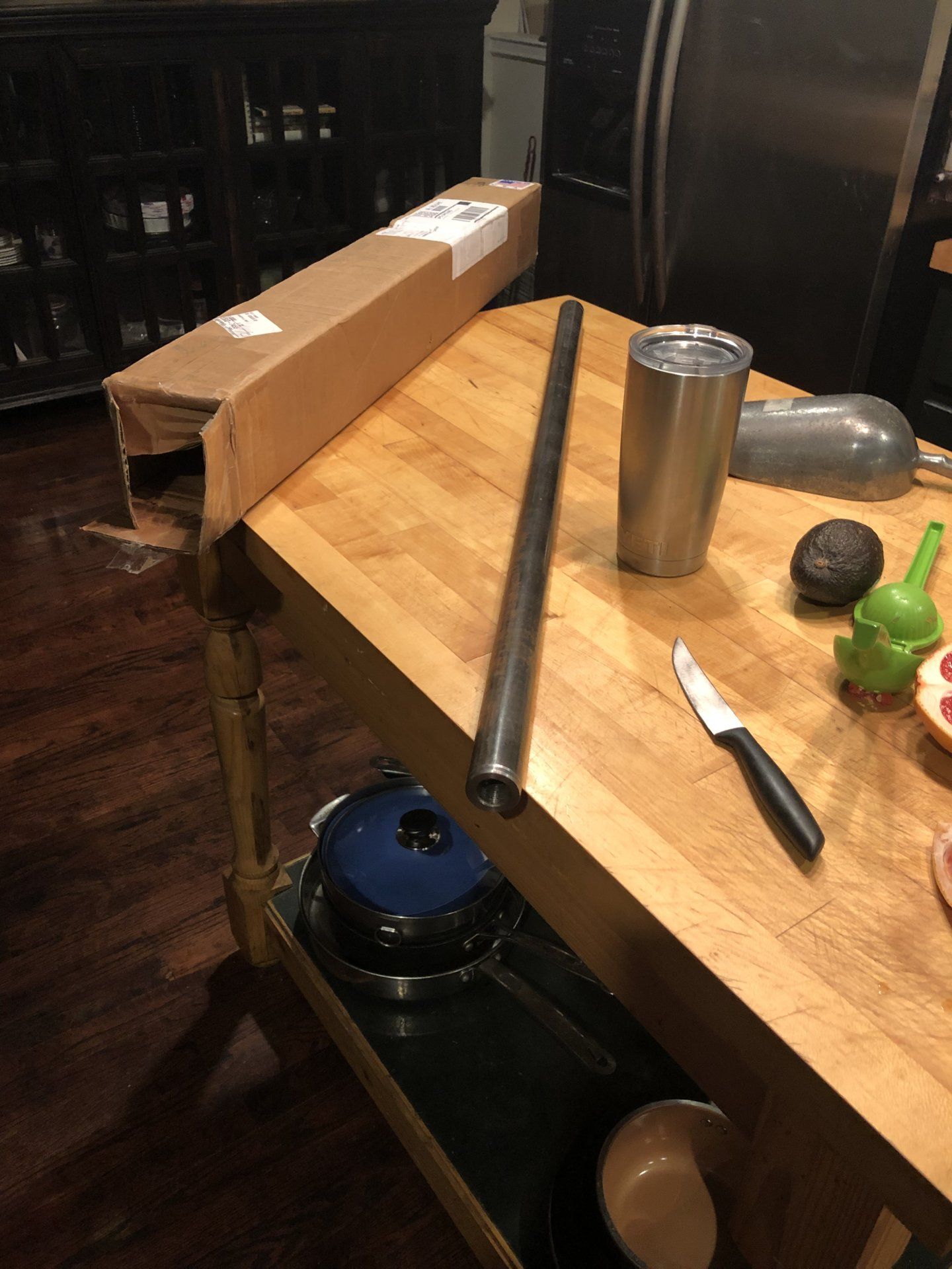

I bent my 2" .25 wall tie rod. Was thinking of sleeving 2" .120 wall over a solid 1.75 aluminum bar next? Dunno
Try putting the aluminum inside the steel tubing like we talked about.
The solid aluminum ones I’ve seen also tend to bend and stay bent. That whole spring back thing is BS
That's what I just said bro
I think thats a good plan. Had considered that myself but so far so good on mine. Wadded up my 1.5” .250 pretty quick. Might end up building a tube guard deal for it too if I bend it again, which is kind of haggard looking but seems like it would help.
If not sleeved with solid AL maybe 2” heat treat chromo like the heretic fab links. Maybe 2.25 .375 wall. I THINK I have enough clearance I could make that work. Lots of dudes running 2” .250 heated treated chromo lower links though and not bending them. Don’t see why it wouldn't work as a tie rod.

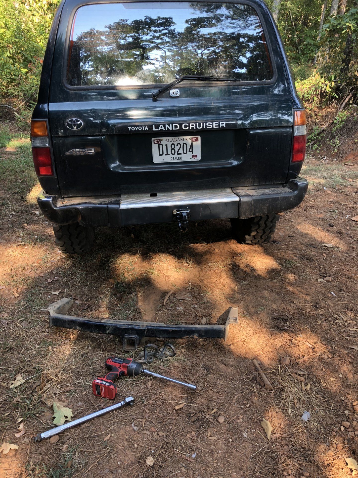

Recycling the square tube from the receiver to sleeve his steering link.
Nice work there on your steering links. They look like a hitch receiver
