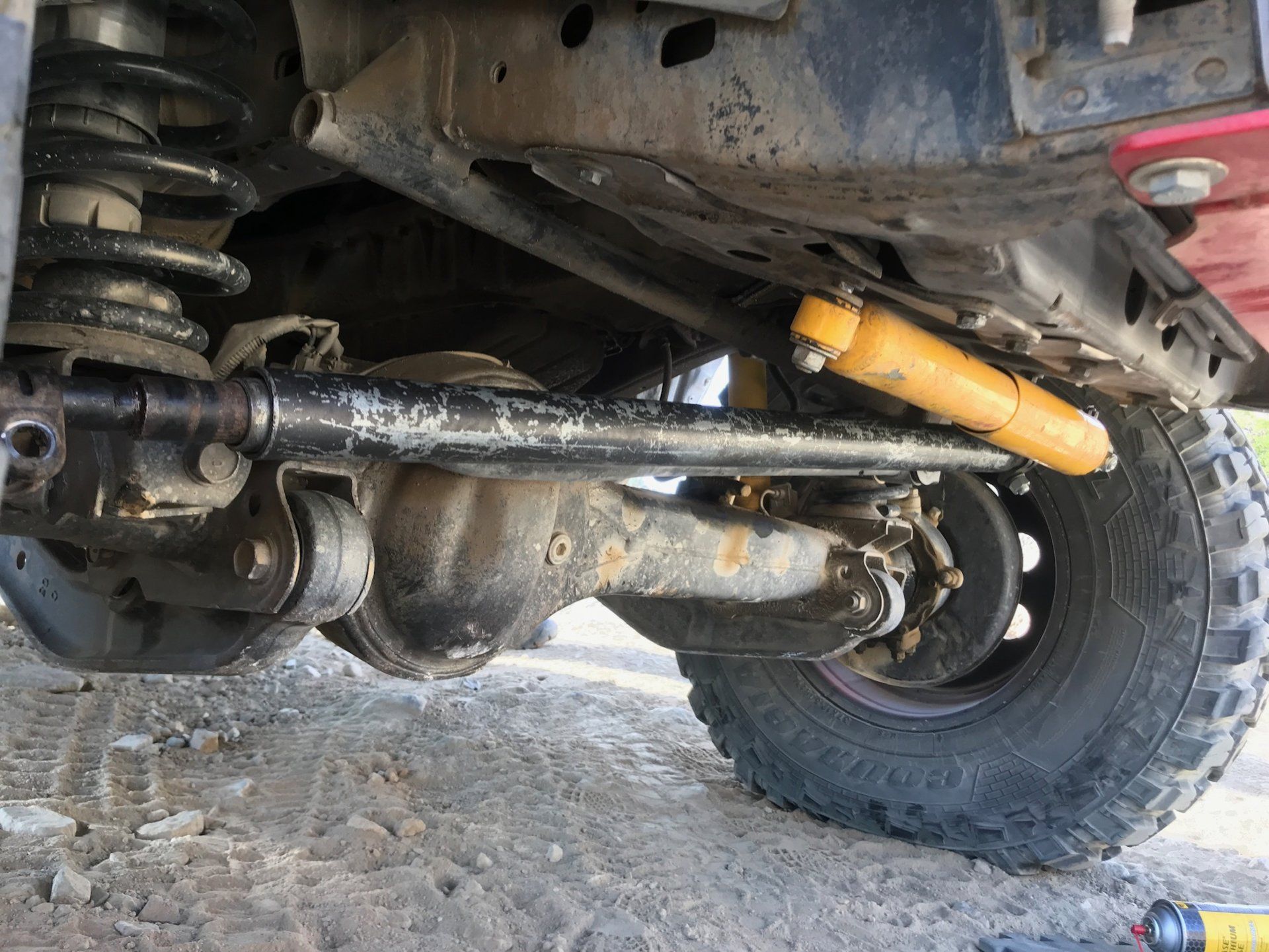

Steering arm keeps bending (pic included)

Do you really want to know? Did you have an actual opinion or did you just copy and paste some wiki article on tubing. Do you disagree with what I said? Do you advise running some sch 40 poop pipe steering? Honestly never seen your fabwork so no idea. How much experience do you have fabricating automotive structural components? With pipe?
FYI My tie rod is 2” .250 DOM with 7/8-3/4 heims. My drag link is 1.50 .250 dom with same heims. Both running weld in hex bungs. I’m running mild steel .035 wire at home. Can tig at work but not needed.
Point is hack s*** on steering isn’t cool. Just fix it right. Its not that expensive. If making one is too much then buy a nice replacement.
Time for a new beefier one or smaller tires. Bending it back is a limp it home solution, not something that will last.

Rather than straighten it and weld a bunch of s*** to it, just replace it....
Cruiser Outfitters has a good one for good pricing as well. @cruiseroutfit
However, if you were going to fix it, I would cut it out, use a comparable diameter, (I may have to use calipers to measure the OD), then use a heavy wall tube, either DOM, CDSMLS, or Chromoly. Probably 1/4" wall, as long as the ID would clear the threads on the TRE.
If you make it too heavy, it pushes the fail point into the steering gear or pitman arm.
It's just a helluva lot easier to call Kurt
Marlin Crawler makes a very nice DOM replacement and they can do custom lengths if needed. TRE's are also included.

Geez, all the worry warts. Looking back, I would have done DOM.
My rig was wrecked, iI nstalled new front axle (with e-locker). New passenger radius arm, ect.
First time I turned the wheel, kink!
I straightened it out, bought water pipe from Home Depot, sleeved, welded the ends, drillled & rosette welded the length.
10-12 years later, Zero issues.
I posted it to a thread, but I’m not trying to look something up from that long ago.
A hi-lift handle fits over it, so just sleeve it with that. Then add another, larger pipe each time it bends, like so:
Once it fails it should be replaced. It will continue to fail as it has been weakened from original form.
Some say upgrade, others prefer this to be the cheaper ‘fuse’ in the system. Grab one from a part out and wheel on.
I used to think it was a fuse in the system. Two twisted sector shafts on mine and one on someone else’s all with straight OE drag links (actually, one of them might have been a a Chinese knockoff) and I no longer subscribe to this theory.
