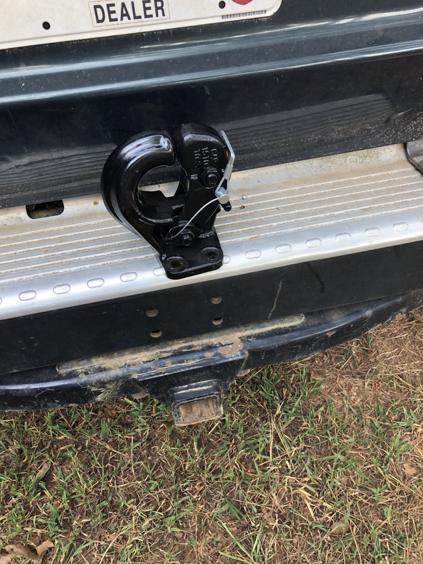

Also need to know what size bolts are needed for top two on my pintle hitch?
There's thing that you can do called measuring that will answer both of your questions
M12x1.25 if memory serves. Two holes are threaded, two require nuts.
