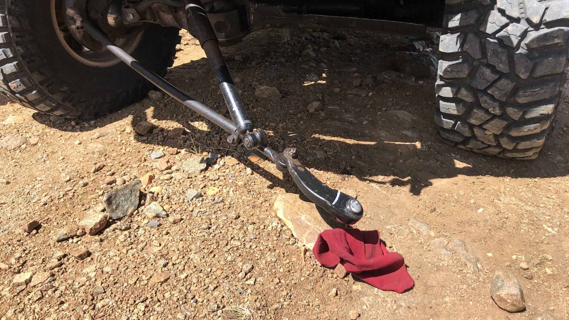

Steering arm keeps bending (pic included)
Good luck on your 4.6 swap :)
So bent twice? Once in oe form and once in winched kinda straightish form. The title makes it sound like a repeated problem.

So certain, are you?

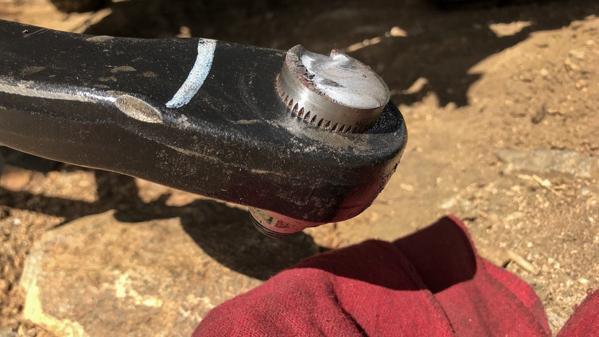

Note the bent $10 rockauto Chinese drag link which has also twisted two other sector shafts back when it was straight over the last couple years.
But maybe that Chinese crap is just that tough. Except that inkpot twisted a sector on an OE drag link.
The factory steering rods are not fuses. I don’t care what CDan or any of the others have said at this point. It’s 6,000lbs against a (comparatively) puny rod of steel.
Maybe the 105 sector is stronger. Maybe hydro assist would be a good preventative. Those are the things I’m about to be testing, so I guess I’ll find out in time.
I’m not sure how many times I fixed it. Doesn’t matter anymore now that I’ve got the BidBuilt one as a backup. All I’ve got to do is remember to turn the wheel all the way to the left while jacking up on the bent bar before heading out each morning.
Wait the bar bends every day and in the morning before you would leave you would turn the steering all the way left and then jack the truck up by the bar to straighten it? That’s some out of the box thinking.
