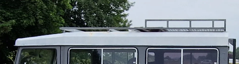

My safari roof was coachbuilt by Meano in South Africa as part of the conversion, and is a pretty simple arrangement made mainly of flat sheet (not at all the same shape as what came out of the toyota factory).
Yes it's probably heavy, but it also gives me about 8" more head room all the way to the back, a good overhang over the windscreen to keep the sun/ rain off, supports the weight of the roof rack, and I can sit on it and watch game.

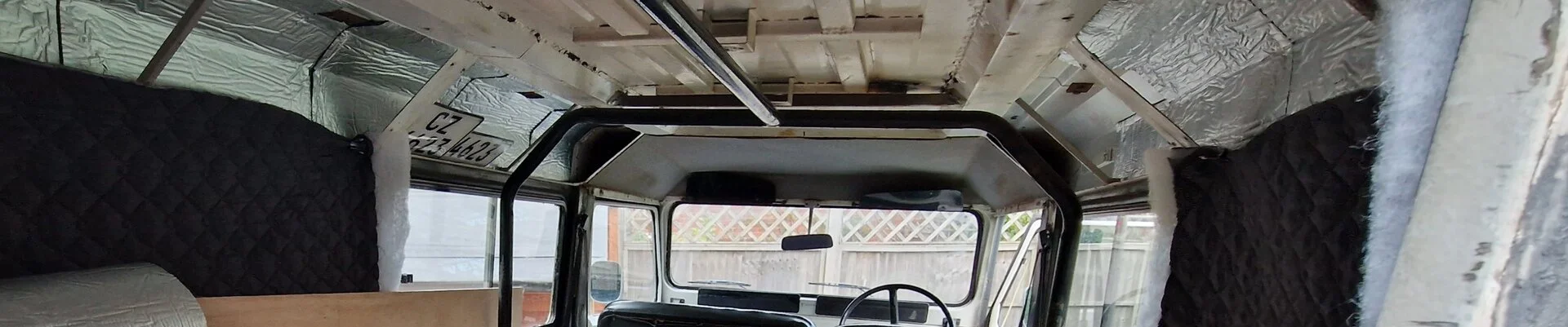

I've insulated it for sound, and it was cool in summer.

If you go with big and flat, then you'll need stiffening ribs like mine and triangulation to acheive the same stiffness - similar to a Landrover Defender.
