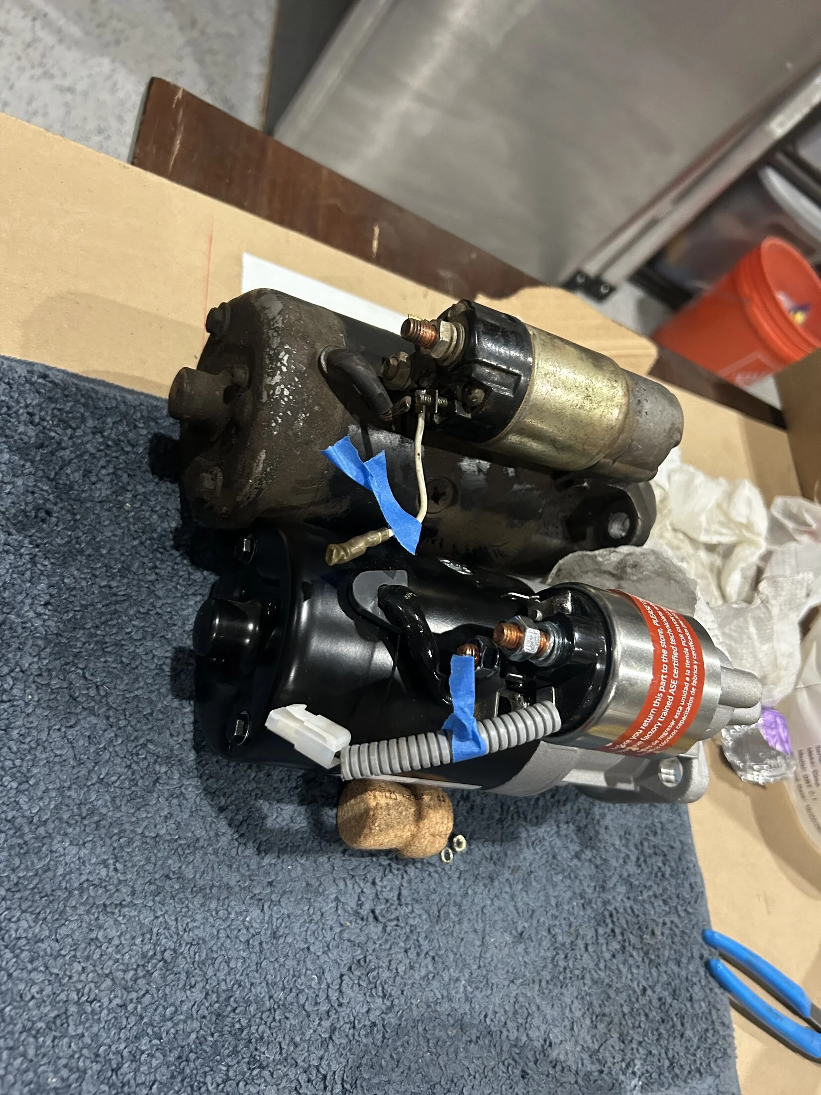

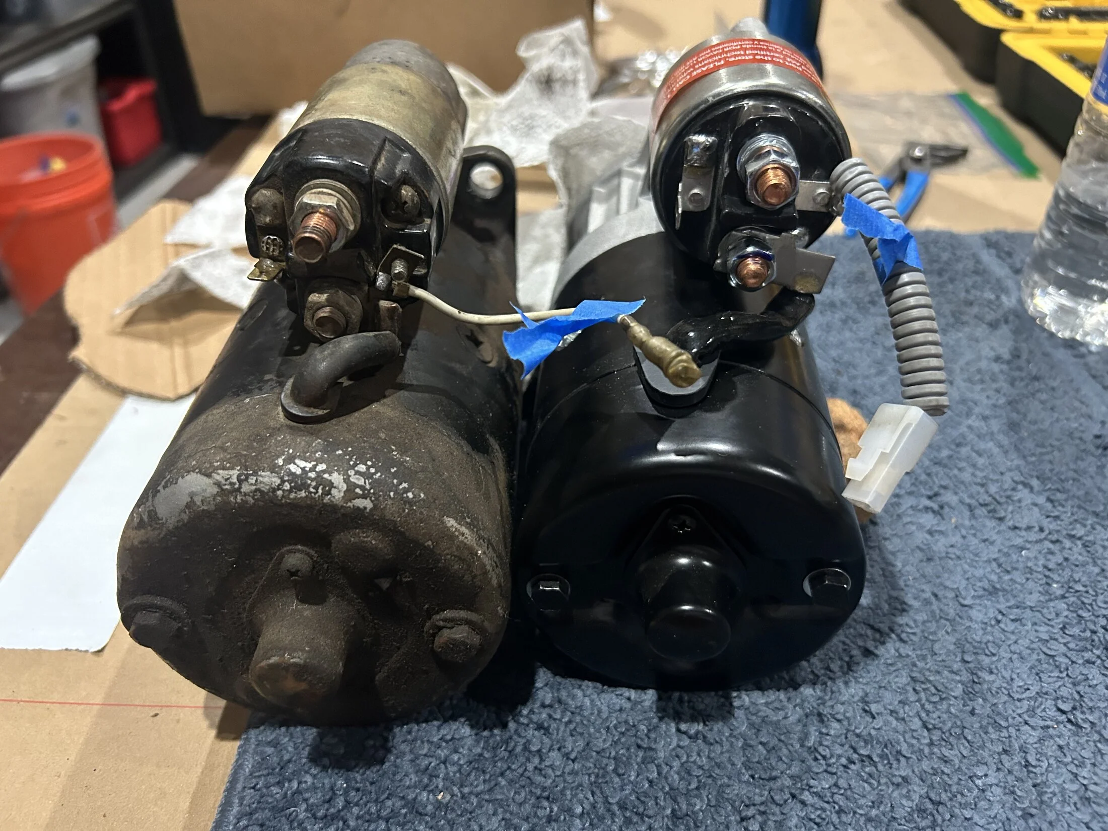

I’m replacing the starter and the wires on the right of the solenoid (marked with
blue tape in pic) aren’t the same. Does anyone have any recommendations regarding reconciling the differences? New starter is on the right.
Thanks!
Lots of options. Find mating new connector that's on new starter and put that on your wiring harness. Cut that new connector off and water proof butt joint it to wiring harness. Cut old connector with the complete wire and and wp butt joint it to a short section of the new wire.
You are over thinking it. just change one of the connectors and go.
