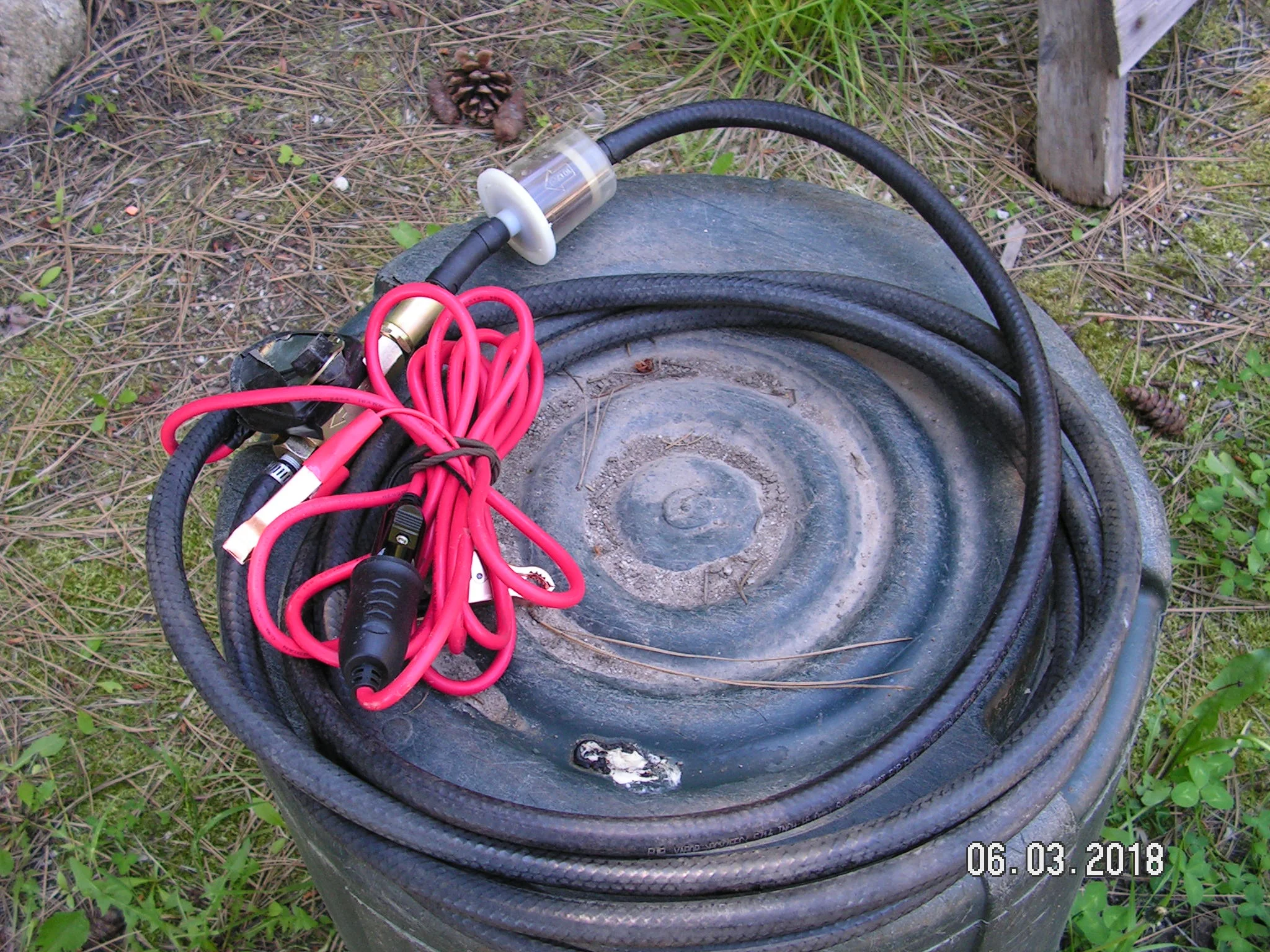

Make fuel transfer units with the pump - beats holding up 5 gallon cans
Water Proof switch, fused and filtered. 5' draft 20' delivery from a spool of gas hose. The 12' cig lighter cord will plug in or clamp to the battery. Will also do diesel. Have several spare filters as water will stop them up until they dry out in the sun..

What pump did you use? This is a sweet setup
