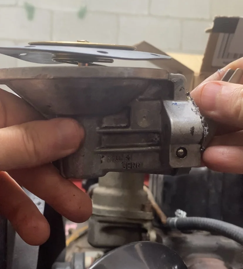

Following up and closing out! So the issue was that the diaphragm must not have been all the way sealed. I think what was happening was that the arm with the ‘t’ that goes down to the lower half of the housing wasn’t going to the bottom side of the lever. So while the ‘t’ was through the top hole, it wasn’t all the way through. Once I pushed the ‘t’ Al the way through to the underside of the lever and pushed the lever it was a little more difficult to push the lever…then when I put the top of the housing on and pushed the lever I could hear the suction! Just put it back on and seems to be running like normal again. I appreciate all of the help.
For future reference….this is about how low it should be to ensure it is locked in properly. If it is only locked in the top keyhole it will be about an inch higher.
