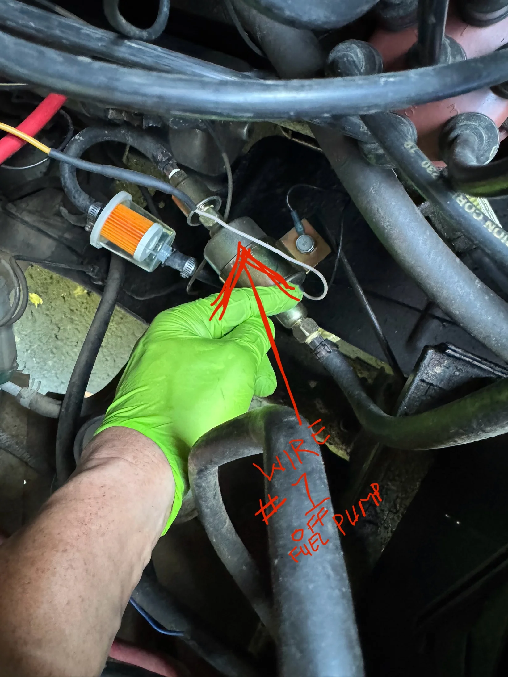

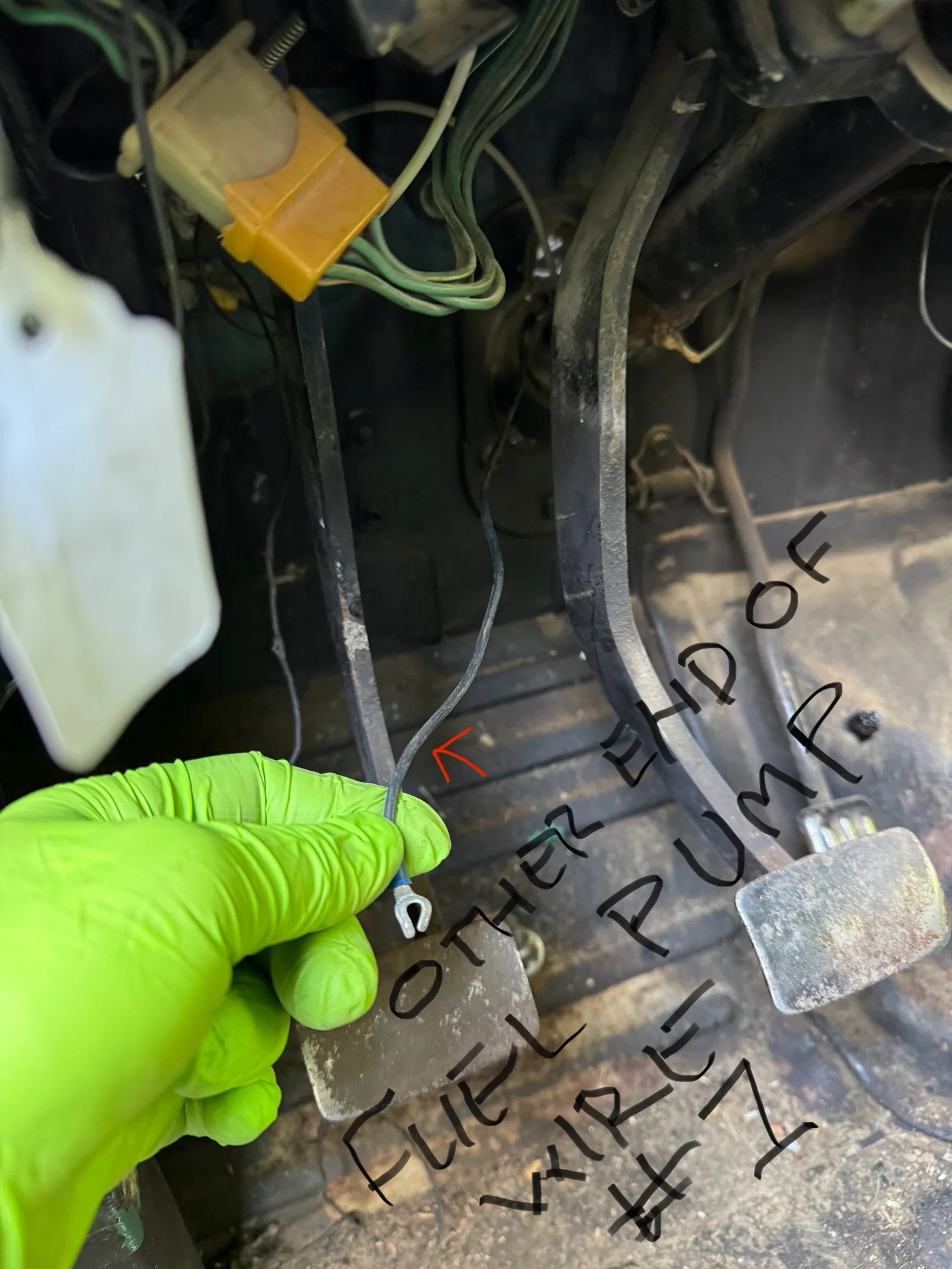

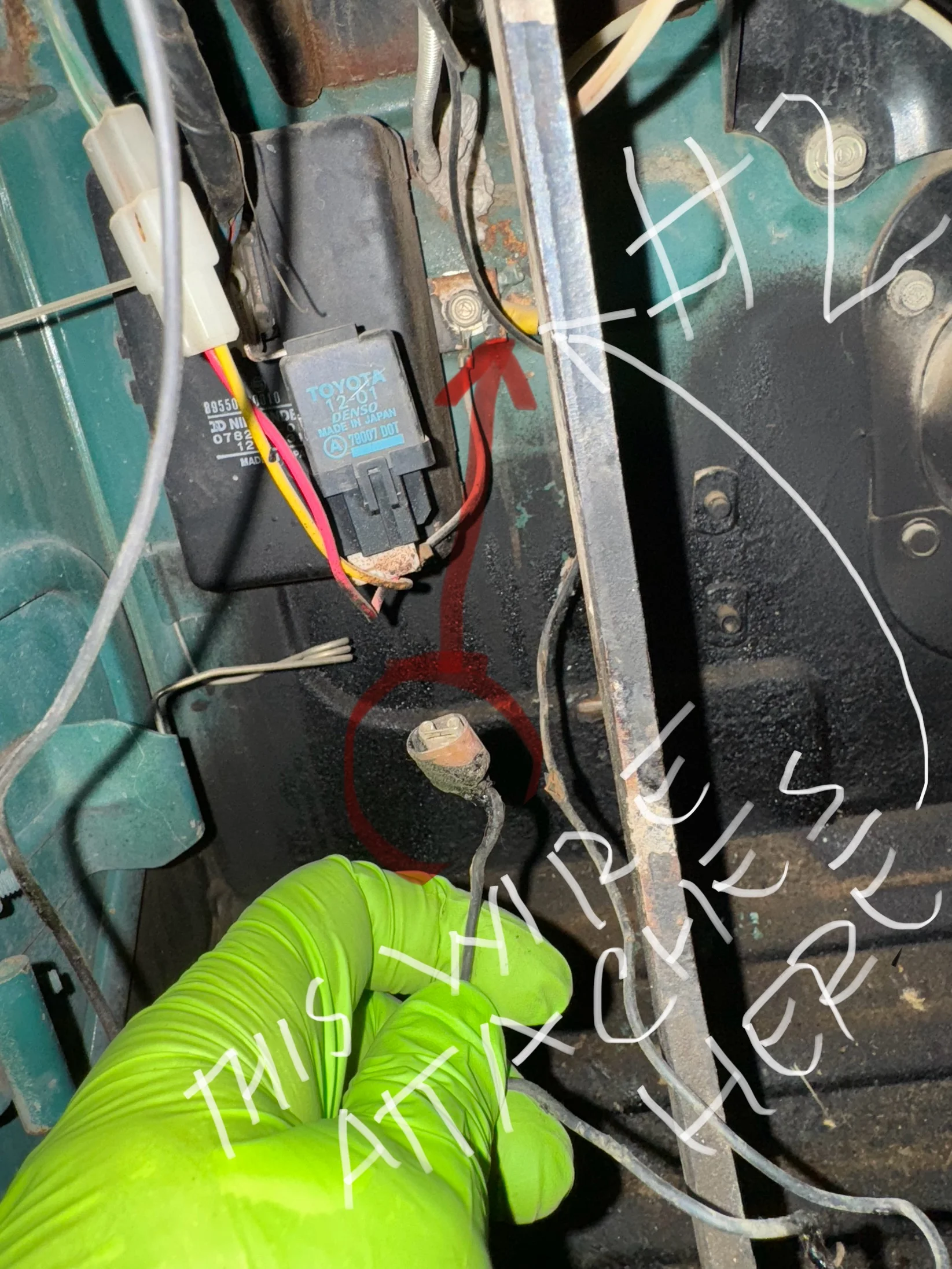

the previous owner had the hot wire from the fuel pump going up the firewall and in the hole for the steering column and then it just hangs there most likely due to me hitting it with my foot? Where does this wire (#1) connect please? Also there is another wire (#2) hanging loose but it appears to be off a ground.
Fj40 1973 not starting I have a clear fuel filter so I I can see if gas is coming through.
Thanks
I run my electric pump red + to the +coil and the black - neg to the engine/frame. Key is on the pump is on - some folks wire them to start circuit and threw a low oil pressure cut out - so if you loose oil pressure it cuts off the fuel.

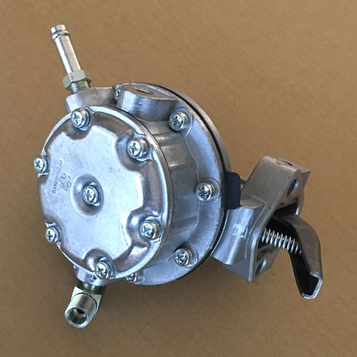

Should point out this is aftermarket. All stock fuel pumps on the FJ40 were mechanical.
So I’ve replaced mechanical fuel pumps on other vehicles I’ve owned. I’d rather use a mechanical one. Normally, they bolt onto the engine and have a little arm on them so when the engine cranks, it moves the arm and pumps the fuel. So you’re telling me there is a to put a mechanical fuel pump on the 73? I’ll search YouTube as well.
I run the cheap diode electric fuel pump on my 72 and my 83 F150. Most times they only get started/run once or twice a month. Mechanical pump takes forever to prime. On the LC I have the Man-a-fre block off plate. The F150 has the electric in line.

All the wires you have pointed out appear to be added and not stock. You might follow the wires back to their origin. They may connect to the stock wiring harness. From there you should be able to ID the circuit they are connected to. Most all stk fj40's have mechanical fuel pumps.
