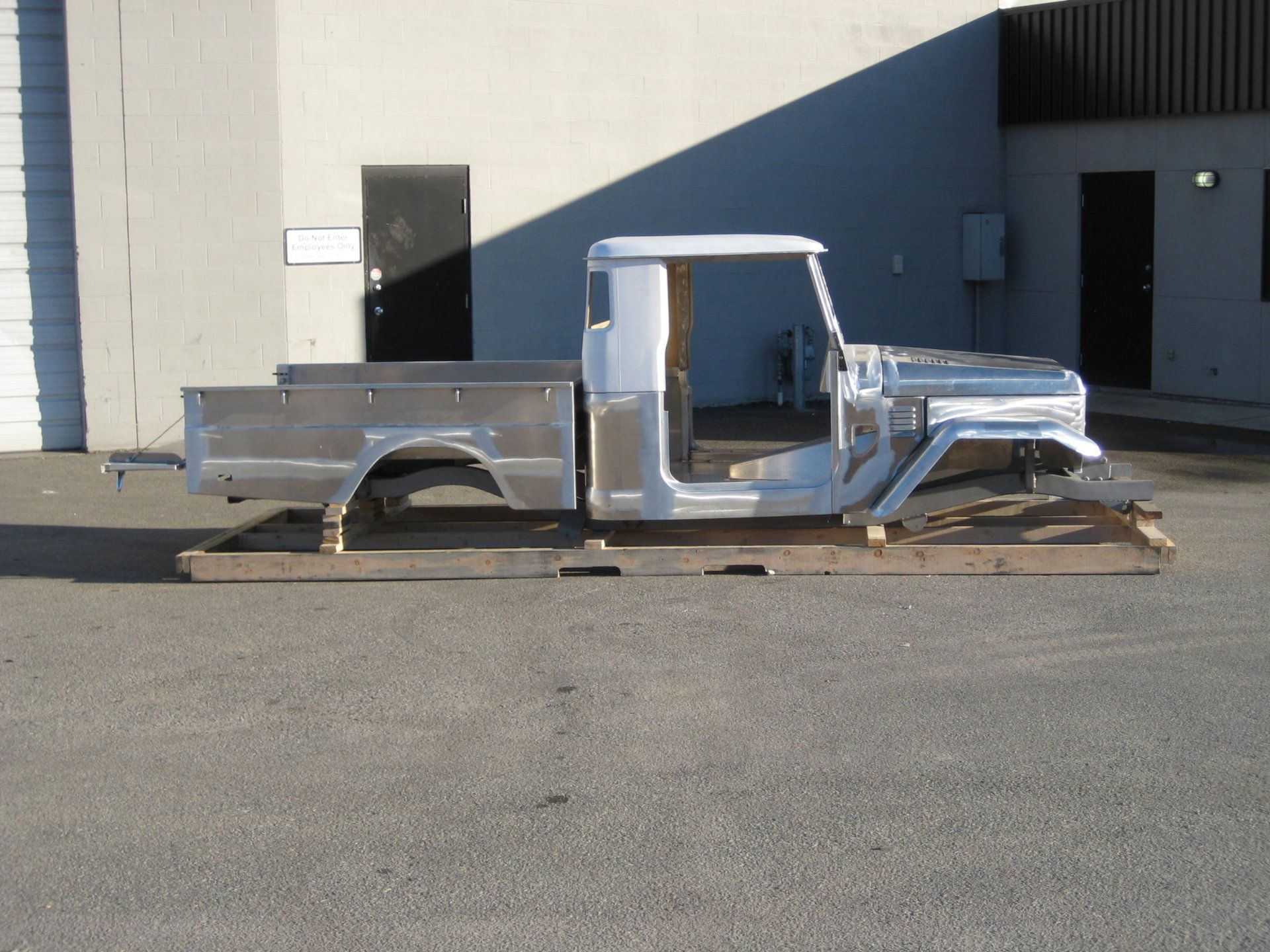

I'm in the process of gathering the stones to submit an order for an Aqualu FJ45 exactly as pictured below, getting every part they make for it frame up, with a 6" cab stretch and 6" shorter long box. I have a 1980 FJ40 350/SM420 I've hit the end of the road with, it's now parked in my barn and has been for some time, and will be cannibalizing to get it back on road in a new more interesting form.
I have a NOS 4BT 105hp crate motor on deposit slated to go into her, but I'm not set in stone on that, have another truck it can go into. I'm at peace with the 4BT and its shakes and noise, and tow boats a good deal so narrowed down to either the 4bt or a fresher V8 than my 350. Attracted to the simplicity of the 4BT and used to noise and shakes fly helis for a the day job that were made in the late 60's that make the 4BT seem reasonable.
What I'd like to pander here for are opinions on my driveline from those who've built trucks, I'm not a builder, to date just a modder and usually take the path of least resistance. In this case that appears to be mating the SM420 I already have and a Ranger OD to the 4BT, and just changing driveshaft lengths for the new frame/chassis. This little truck will tow irresponsibly heavy boats, very slowly, and will be asked to launch 8000lbs at boat ramps regularly, crawling gears are welcome like the SM420's 1st.
Years ago I nearly bought a Ranger OD and never went through with it, tolerating the 350 kindly reducing my fuel load by way of the SM420s 4th gear on the highway instead. I think I'd really appreciate a NV4500 setup too though, as I do highway a lot, live up in BC and work at a different end of the province, 1,100 miles away, than where I live.
So right now I have a 350 I want to be rid of, an SM420, and stock cruiser transfer case. I'm most inclined to go NV4500 behind the 4BT right now, with the Ranger OD and my SM420 a close second. I suspect I may not be too bothered by the gear whine with that 4BT jack hammering the frame rails up front. But a smooth shifting 5 speed sounds pretty good and won't get in the way of the kid's legs in the middle of the bench seat I plan as much as two sticks.
If you were doing what I'm doing, what am I choosing that's stupid and what would you do instead? Would like to hear from guys who've built trucks in depth, I'm not one yet.

I would stretch the wheelbase to 112ish inches. I would stretch the cab 12 to 15" instead of 6 because I like cab room and 45 cabs are tight and 6" just makes it livable not comfortable. I would have the firewall recession extended a few more inches. Then I would drop a 6bt in it. If your pulling a lot then you want the tow rig to have a long wheelbase and to have some weight, the 6bt would give you the weight and would be smoother. It would also give you plenty of power. The 4bt can be made to rattle less, if you use it I would take those steps. But personally I would just go all in and go 6bt. You could put the intercooler under the floor to give more engine bay clearance. For a Trans I would use a nv4500 or nv5600. I would put a 14bolt axle in the back, and fj60 axle up front or Dana 60 or ford 9" with Dana 60 ends. I would keep diff gearing around 3.70 for good highway cruising and use Trans and tcase low gearing if you need to pull up a boat ramp.
In your currency $15K with a package discount and doors not pictured, and no sweat.
This, my friend, I'll be watching very intently! Note, I'd swap out the aluminum hood for a standard metal one.
As White Stripe said, stretching the cab 12" would be better (and available from Aqualu). I've ridden in a standard cab 45, and it is definitely tight. 6 inches would be nice, but 12 would be ideal. The other thing I would look into is getting OEM fenders. To me, the Aqualu fenders have never looked right. They are better than they used to be, but they still are just a little off. If you can find a good set of OEM fenders, I think it would look a lot better.
