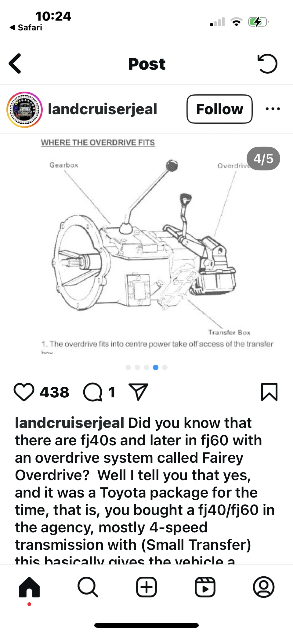

I’m sure I can figure it out. I’m just not seeing anything on the web that would help me. It is mated to a 3 speed.
