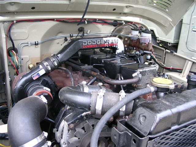

I have built a very similar Cruiser to what you are considering.
If you haven’t already been over to 4BTswaps.com it’s going to be a better place to get some real world answers to your questions. You are going to hear a lot of nonsense like “They're loud and shake no matter how you try and tame it” here on MUDD but I daily drive a 4BT in a Landcruiser and it’s not significantly different than any of the 12 valve Dodge trucks I’ve driven and only marginally noisier than my common rail 6BT’s. I’m not saying that a LS or the new Cummins R2.8 isn’t a good option you’re just going to want to broaden your search to get informed input on your 4BT specific questions.
The BT diesel engines with direct injection high-pressure fuel pumps by default are noisier than their petrol counterparts but with some sound deading (I studied my Dodge trucks and mirrored their setup) the in cab engine noise is no better or worse than what you would expect from a 40+ year old vehicle (it’s not modern luxury car quiet but yes you can carry on a normal conversations with your passengers and listen to the radio at a moderate volume).
So to answer your transmission question I like the NV4500 for a 4BT Landcruiser swap, they are strong and adaptors are readily available to mate to the Toyota Split case. I’m using the Marks 4X4 Landcruiser 60 series 44% low range gears with 8% high range over-drive, I drive my Cruiser on extended road trips @ 80MPH and this is a great combination for what we do.
