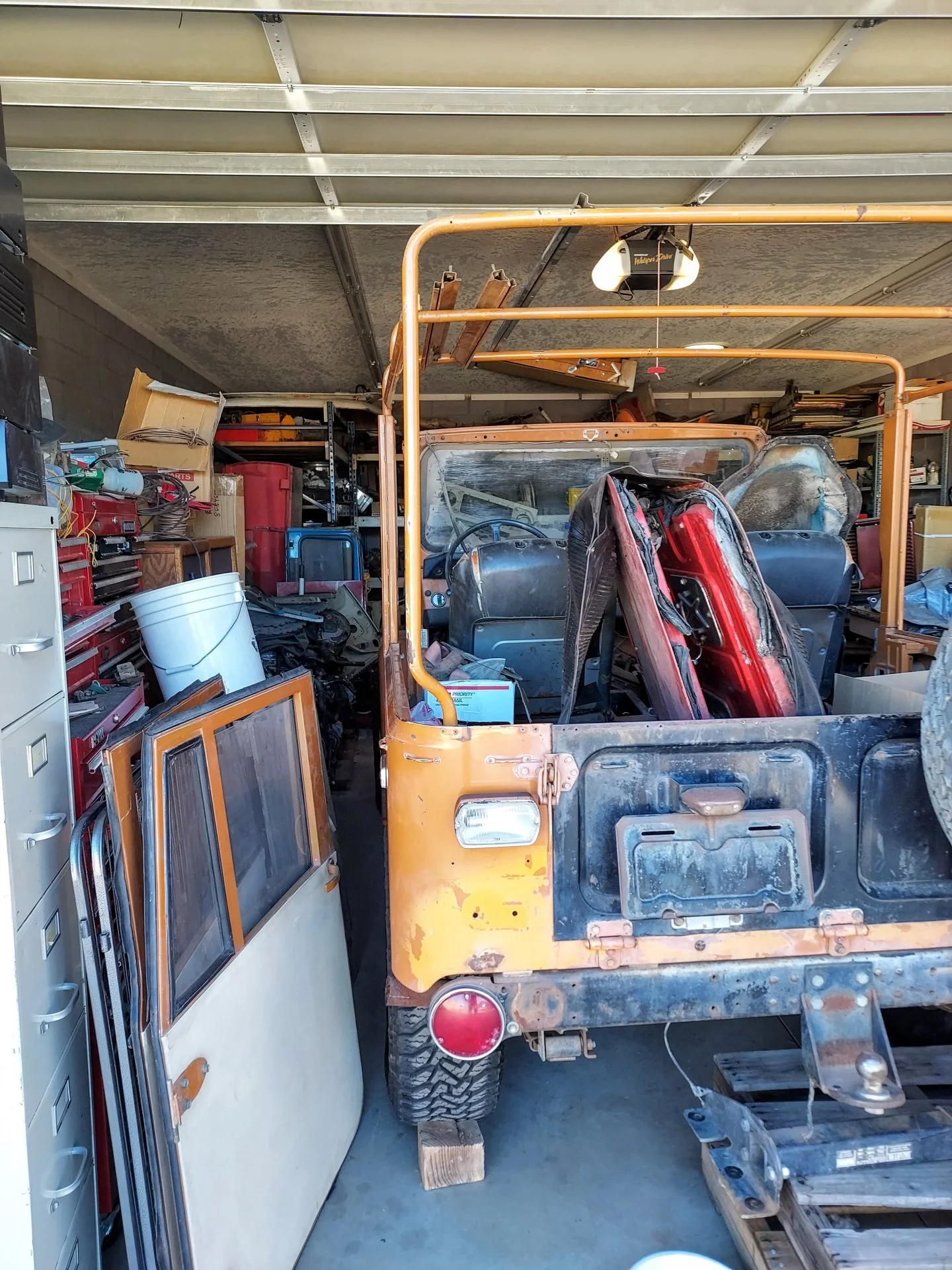

I had no place to work on the engine and she sat on the curb. The cops kept giving me tickets for an abandoned vehicle so I sold it in 1989. I sold it to Dennis, a mechanic I had known for years. About one year later, I moved into a new house and had room to work on cars. So I got a hold of Dennis and asked to sell me back my FJ40. Of course he said no. Every time I saw Dennis I always had the greeting of, “Hey Dennis! Sell me my FJ40 back!” This went on for years! Finally in 2013 I asked him to meet me for a beer. When he came walking in I asked for him to sell me my FJ40 back. He reached into his back pocket and pulled out the title and gave it to to me! He said he was getting to old to work on it and wanted it to have a good home. So he gave her back to me!
Dennis had tore apart the engine down to rebuild it and never got around to it. She sat there for all those years. Never driven, never repaired, never fixed up.

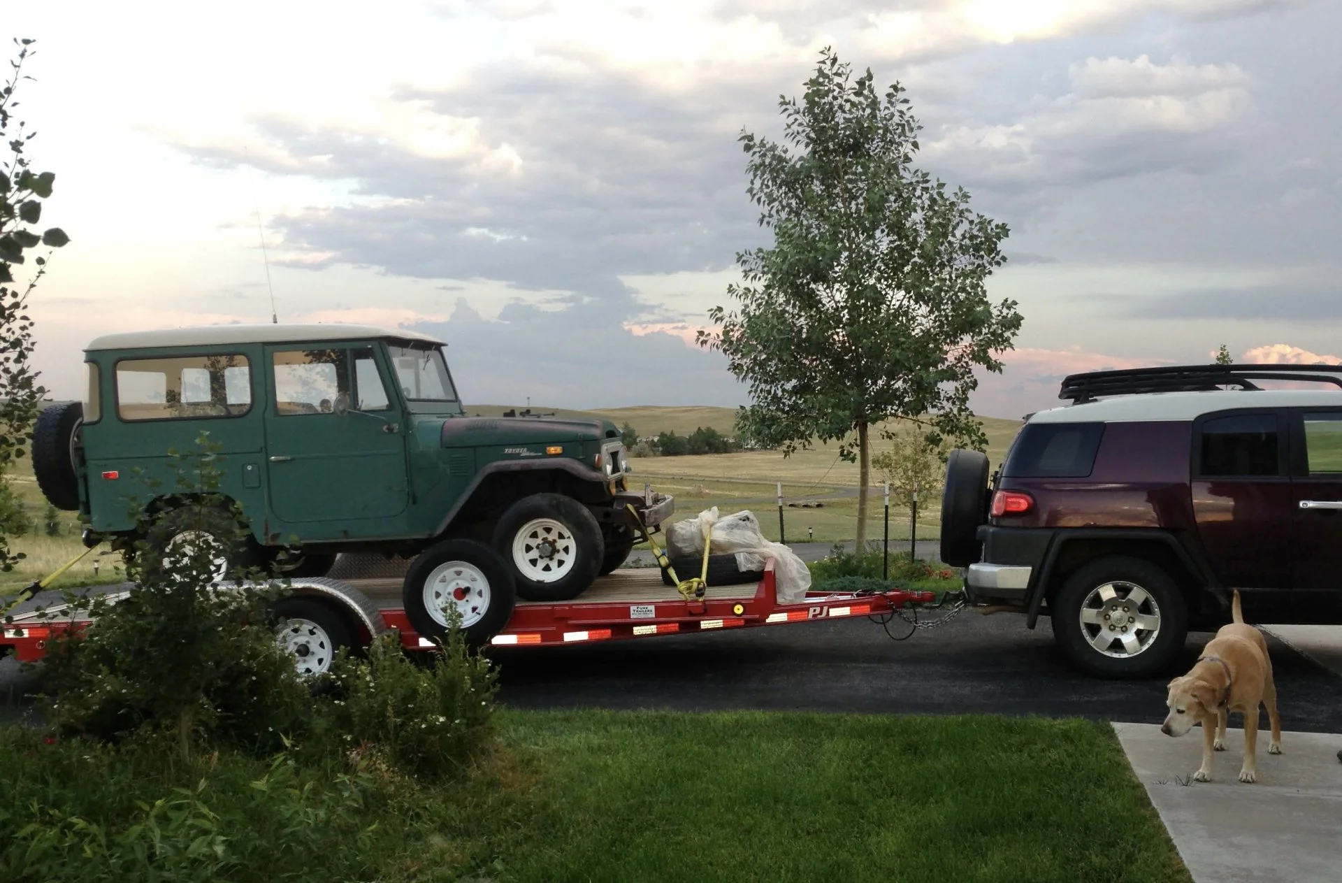

So here she is coming home in 2013 being towed by a FJ:

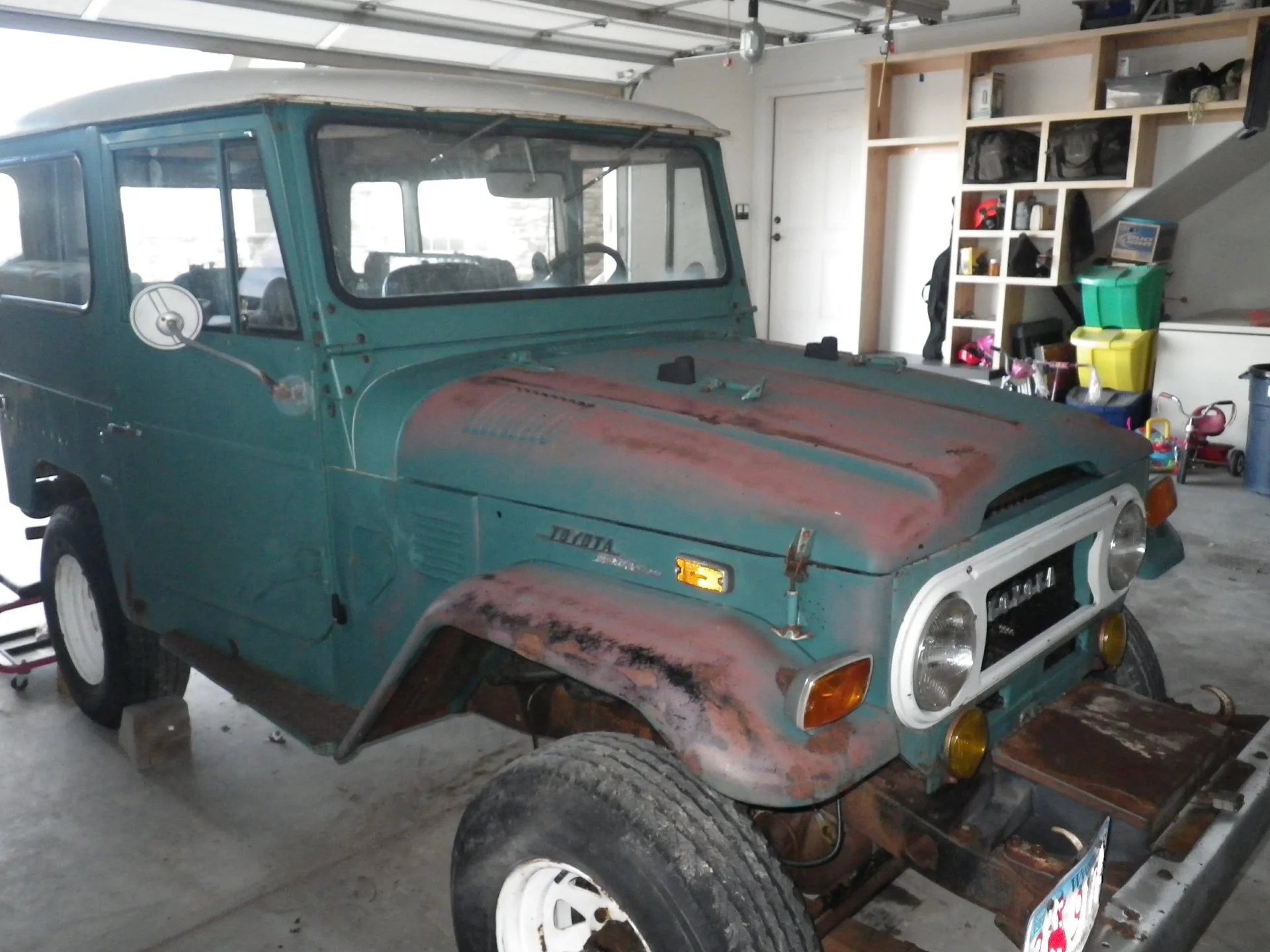

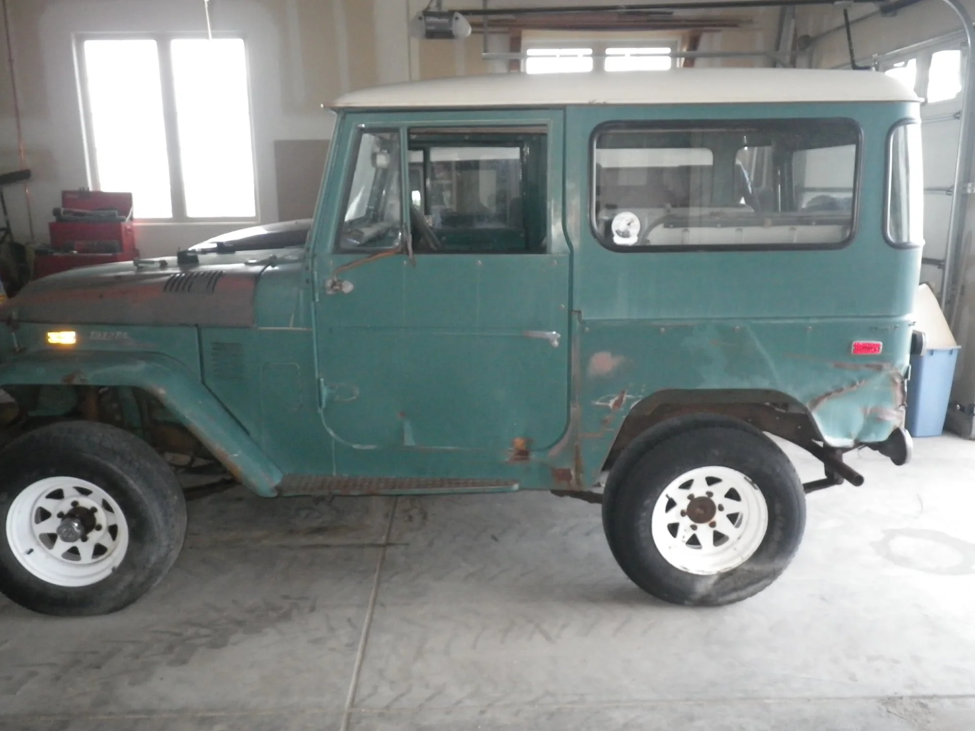

I first thought this was going to be an easy restoration. She looked in prettygood shape. A rear sill, a floor board repair and she’d be running again.
Then I started to take her apart. Holes and rust rot all over. I should have just done a total frame off restoration from the beginning.

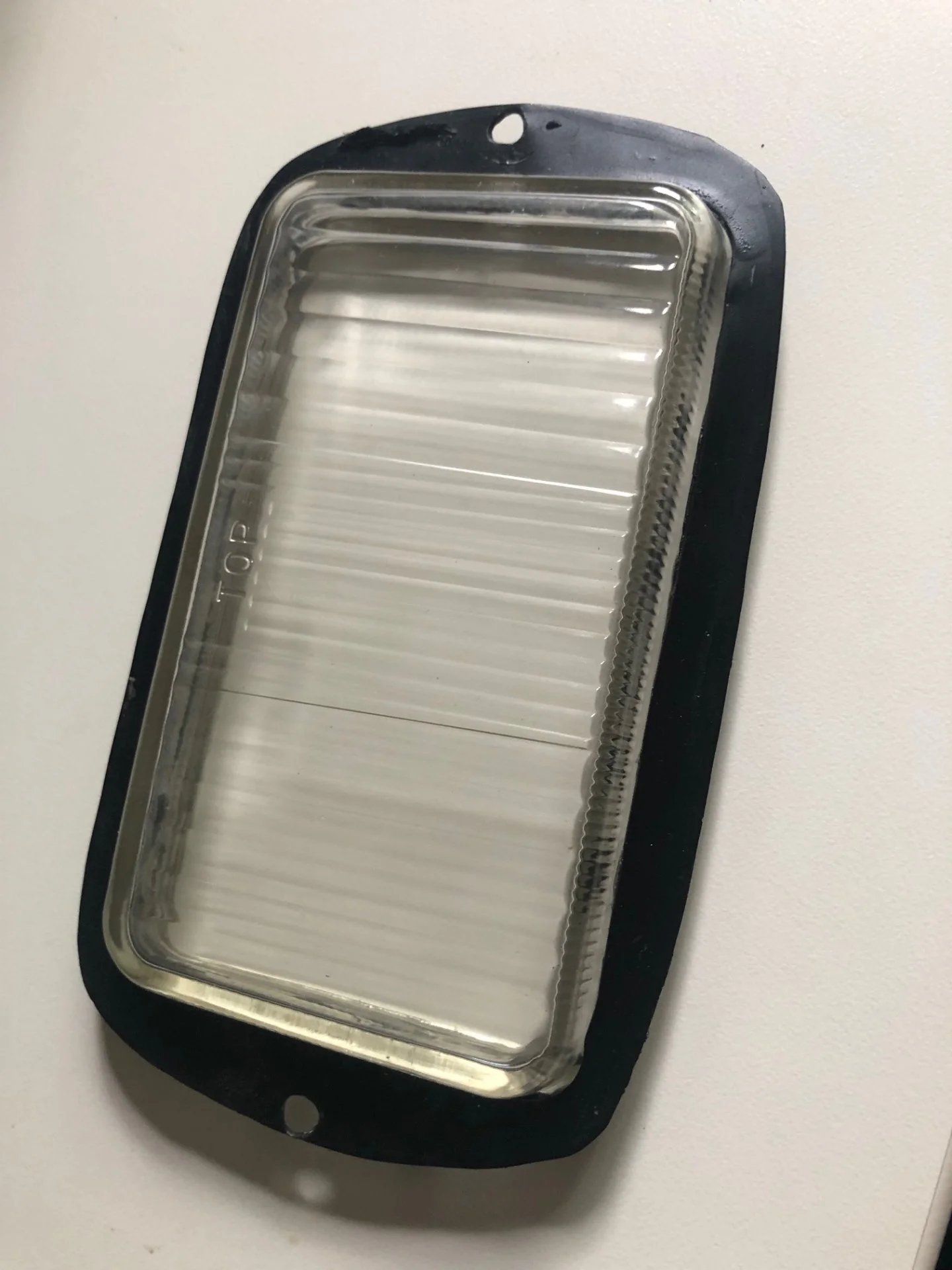

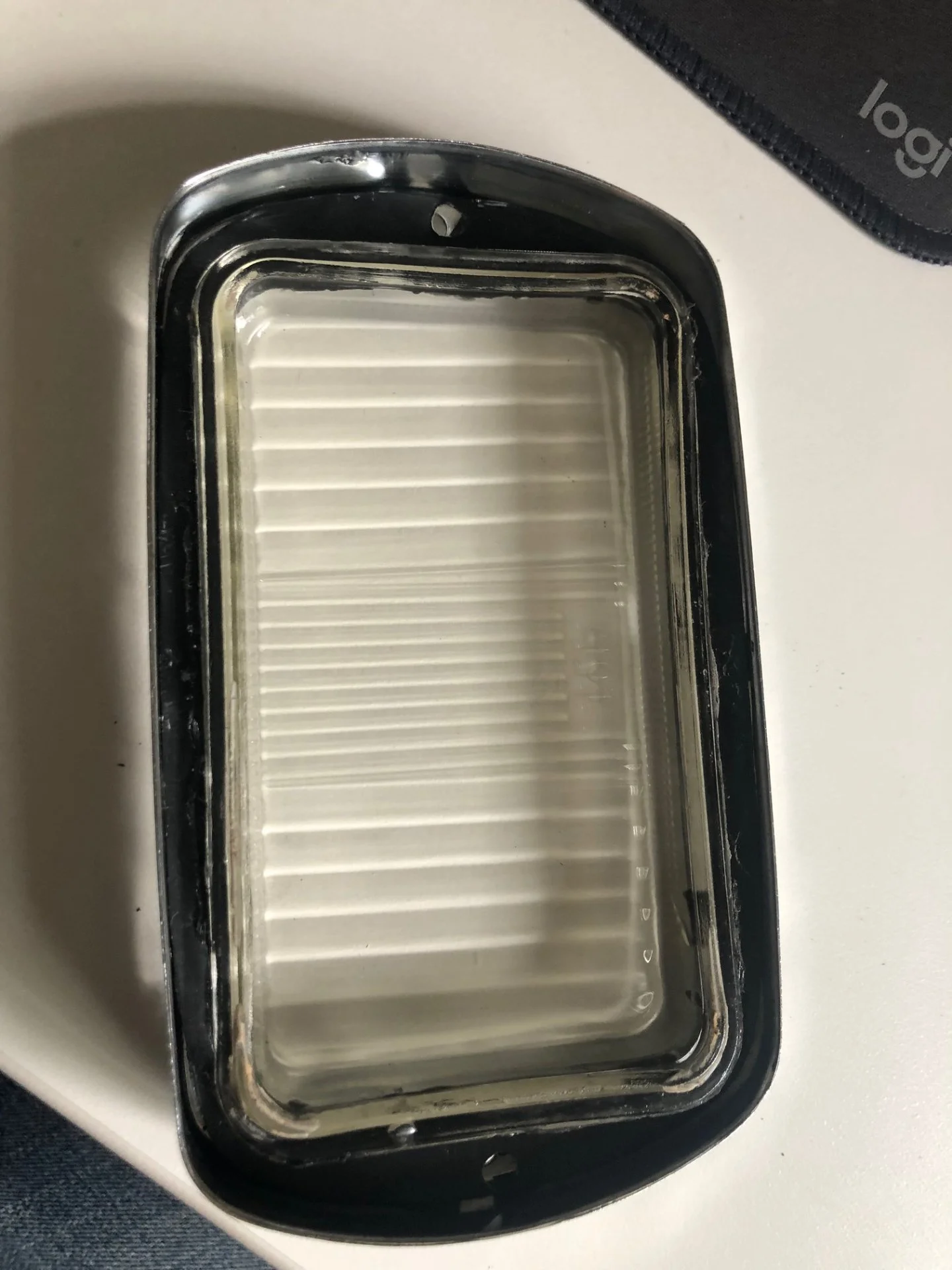

Welcome back to the 73 club. A reverse Lens can be found. I found one last year from a Mud member. I'm sure there are other Mud Members that have one hidden in a box. The PO of Louie made a lens from a rectangular driving light and insert. Here is a picture. This might be an option until you find a unicorn lens.
Would have there would be enough lights with rusted housings that the lens would be easier to find. That hasn't been the case.

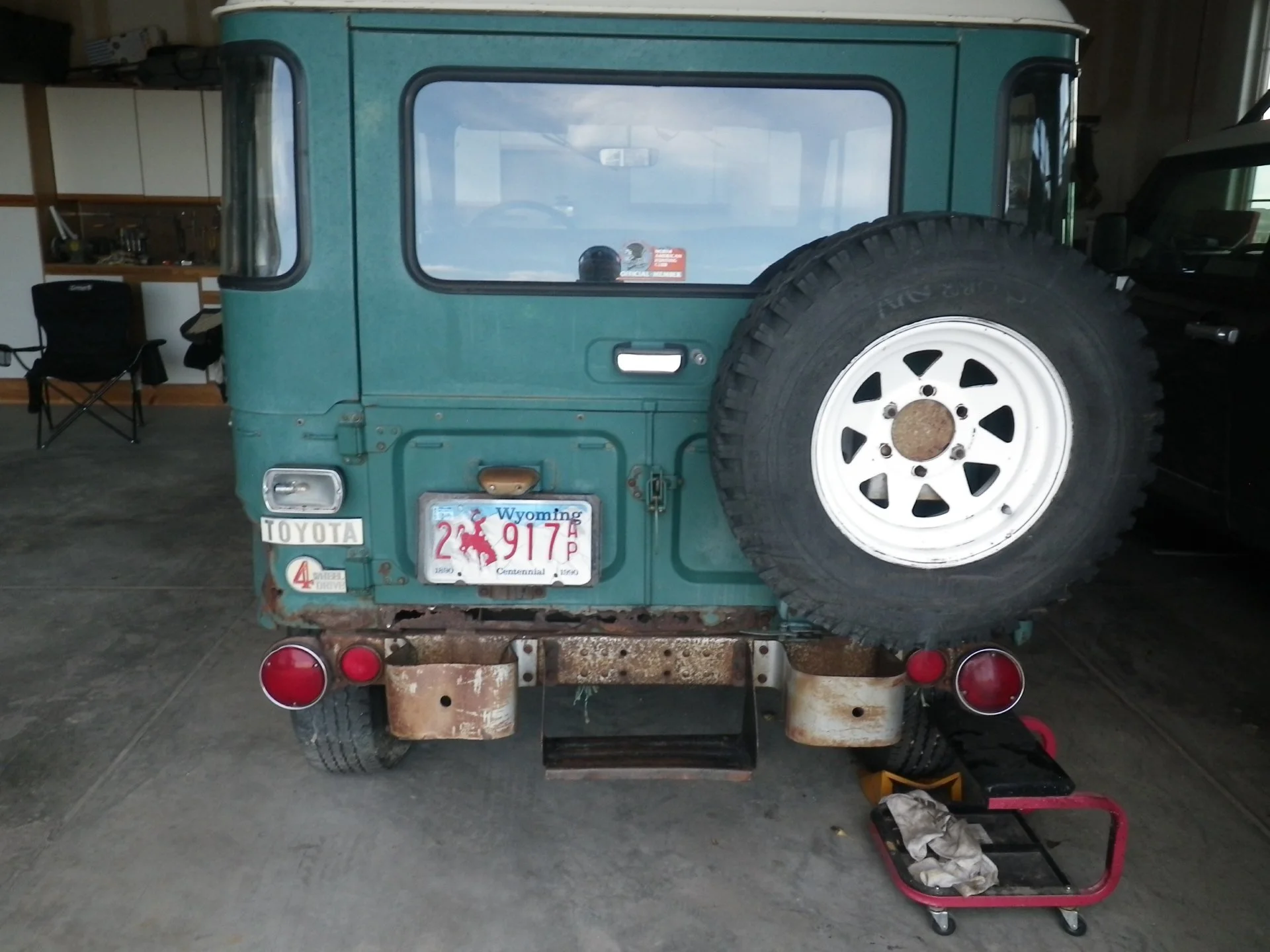

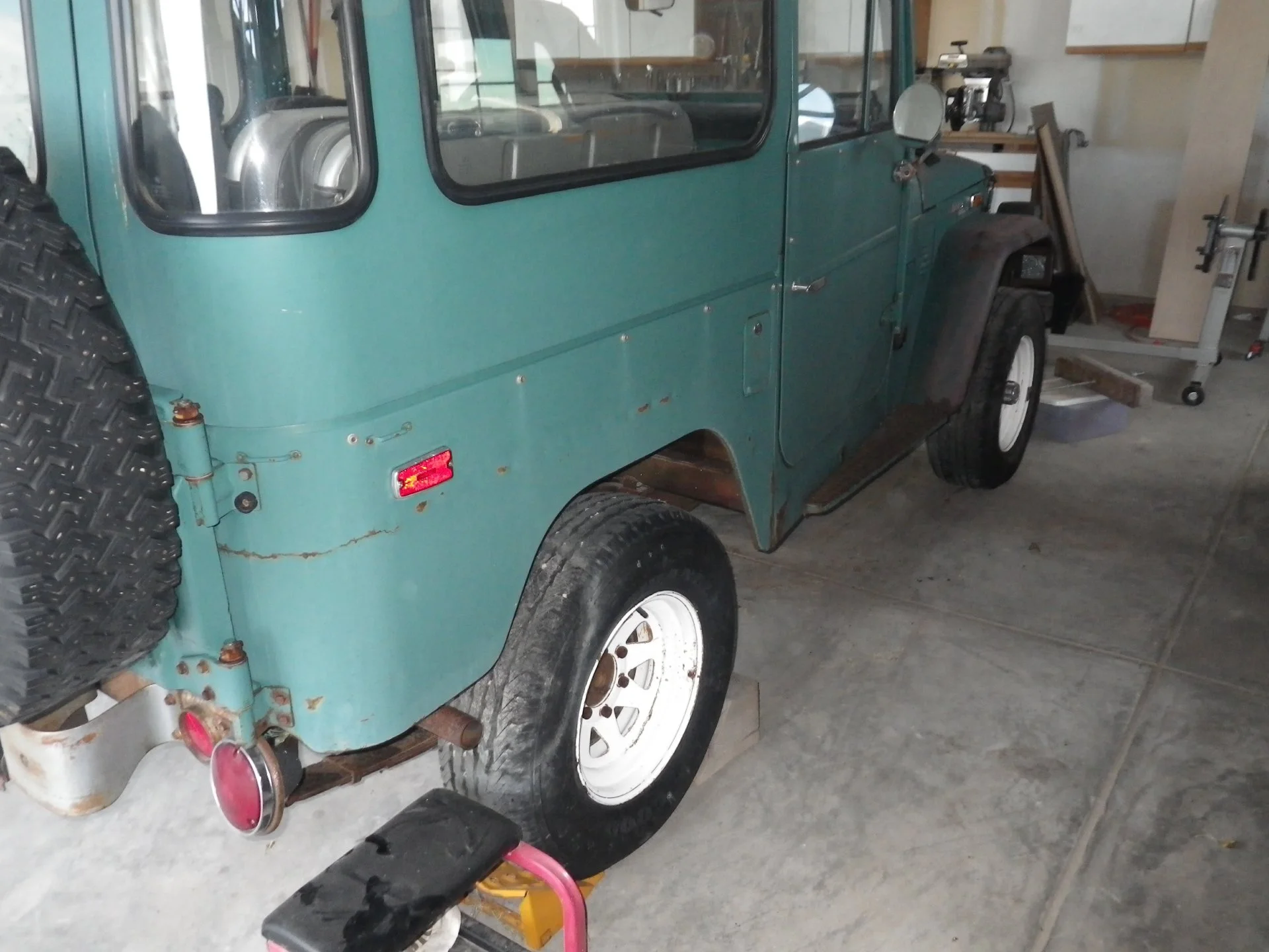

So I started at the rear seal thinking this was all I needed on the rear.

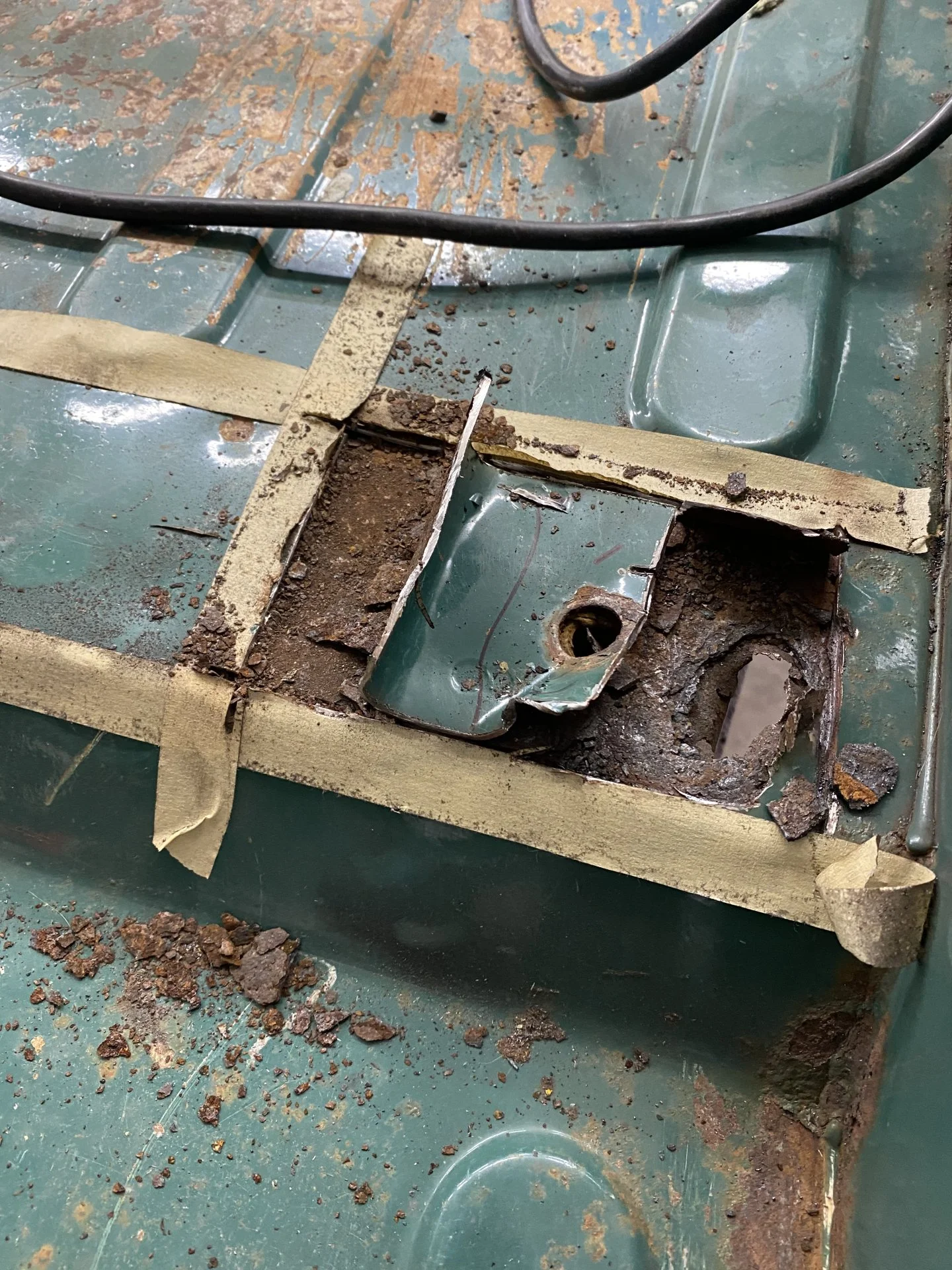

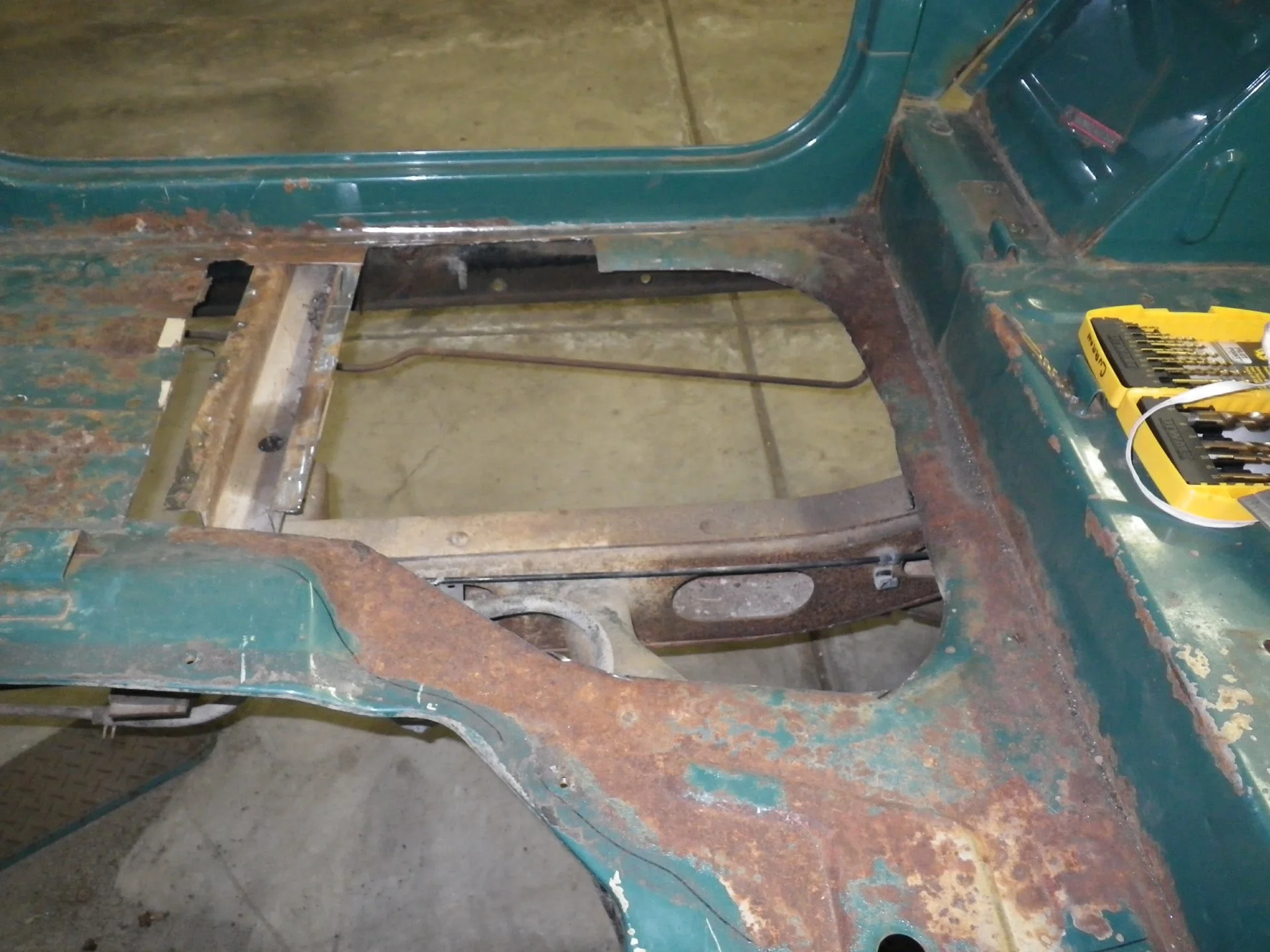

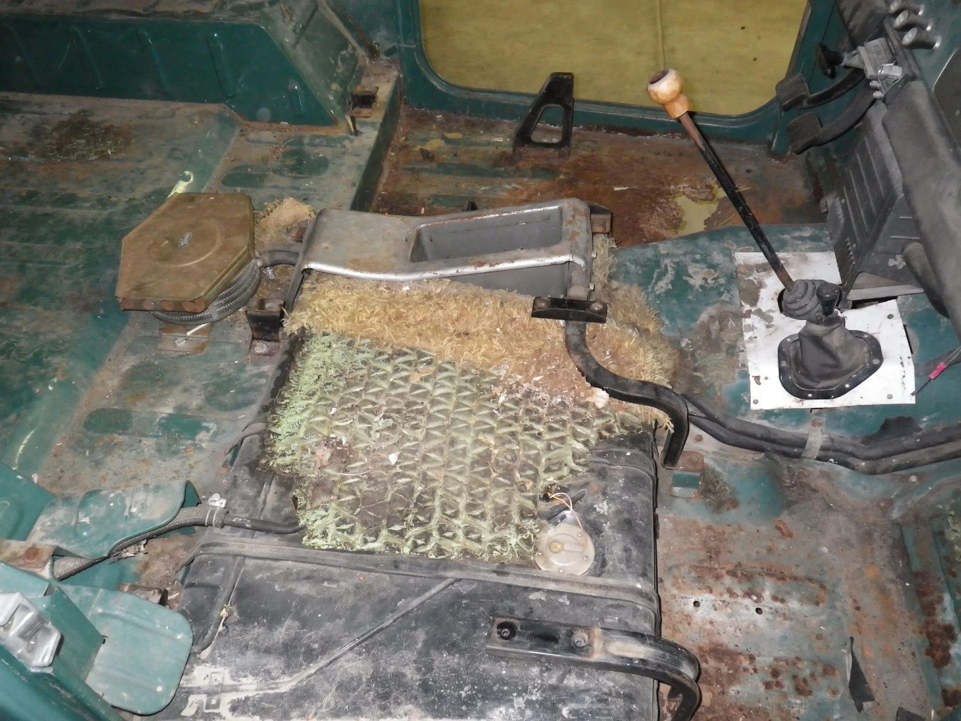

Pull the tank, which the bottom was rusted out, and found this:

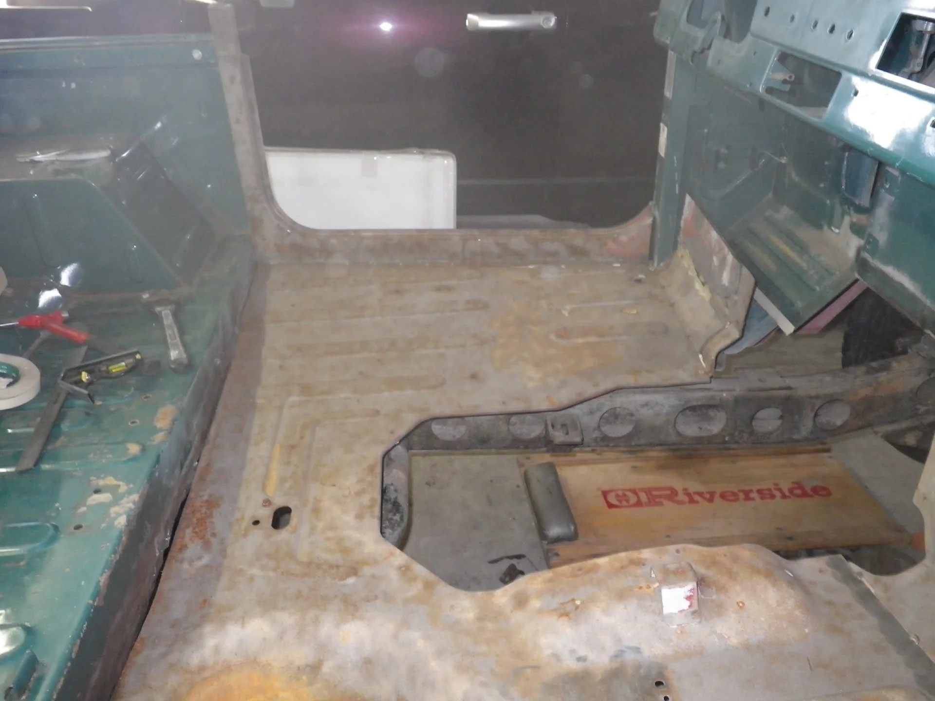

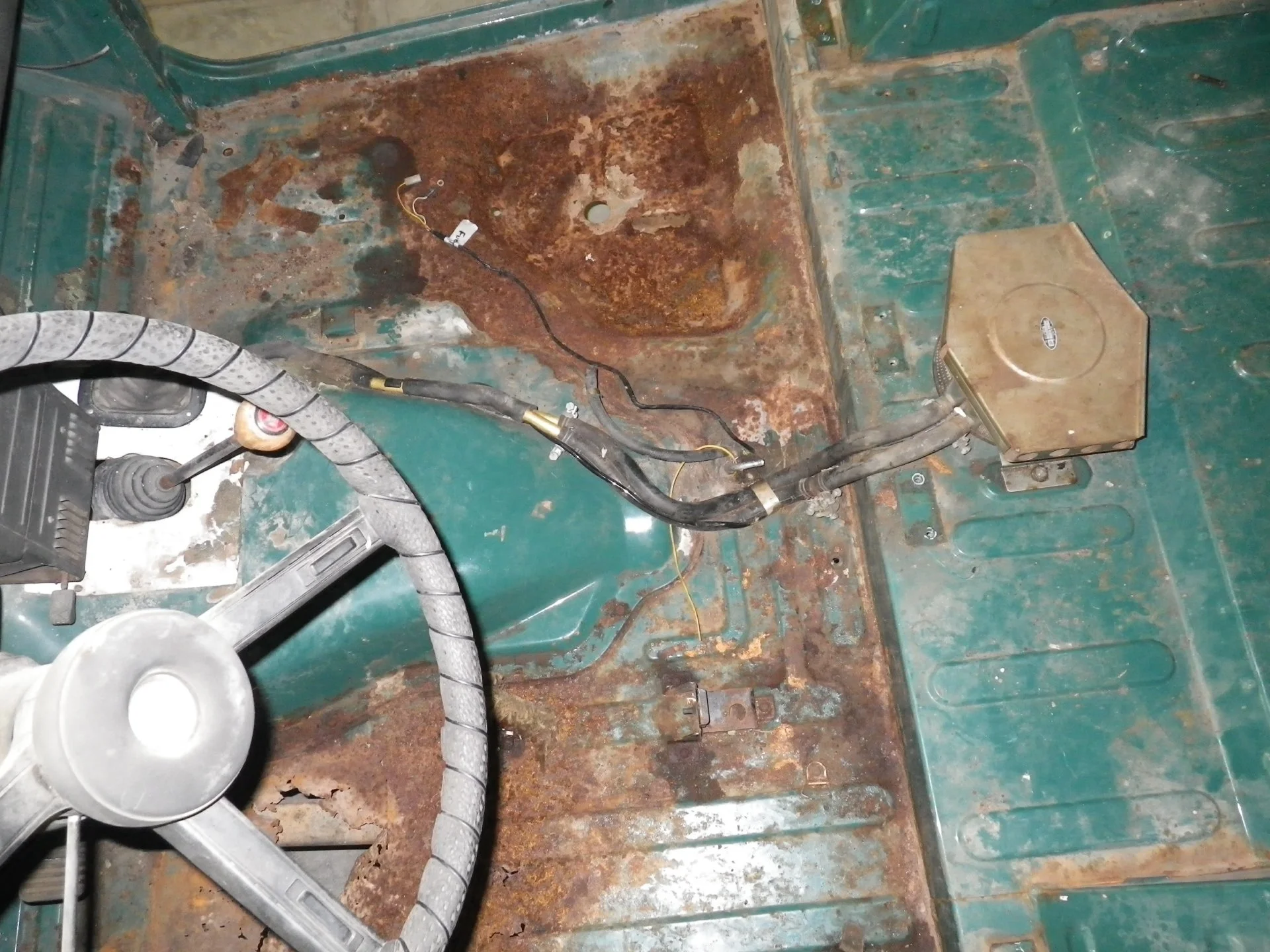

Then i kept digging and ended up removing the entire floor board.
And damage in the corner and the drivers door sill and pulled those too.

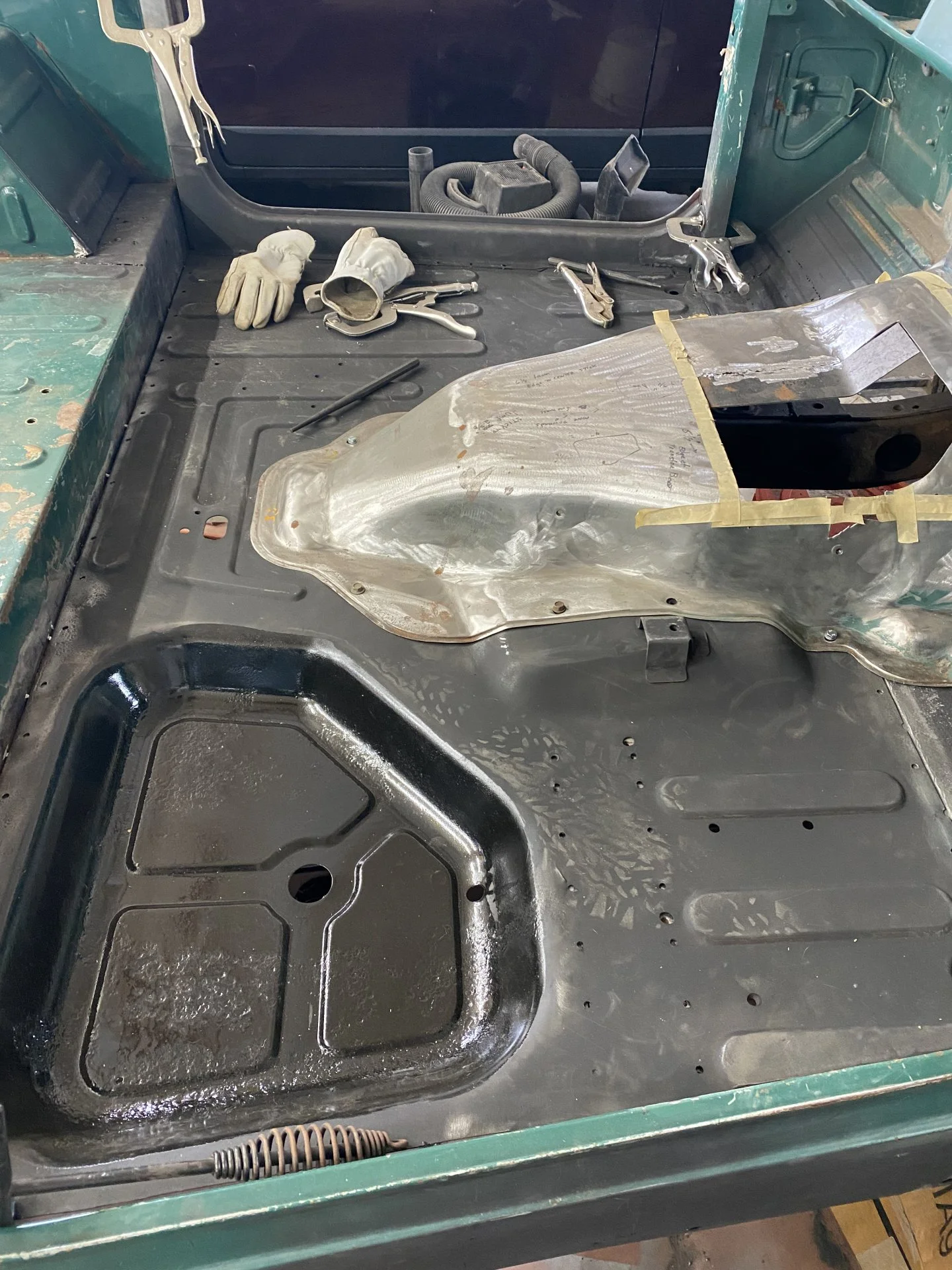

I found a partial tub down in Colorado and pulled the floor board and door sill from it.
Getting it fitted:
More rust

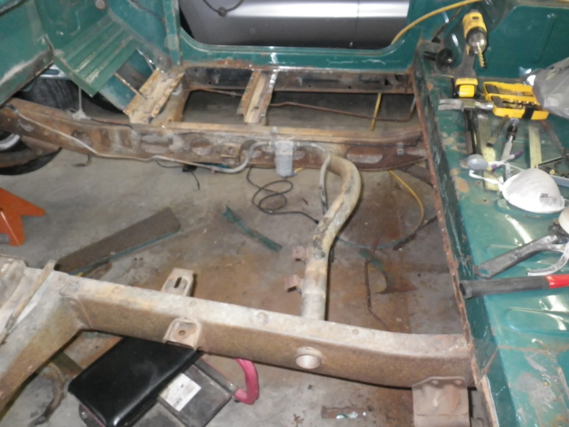

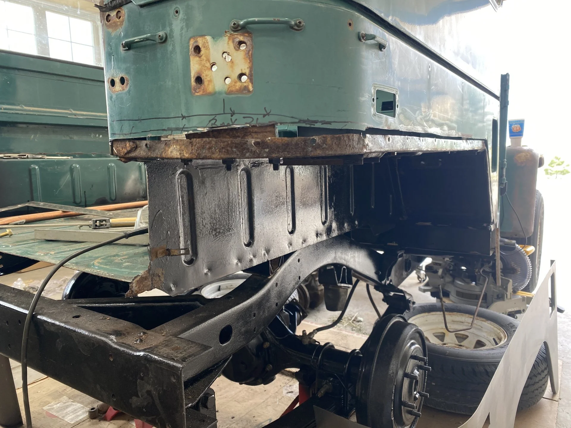

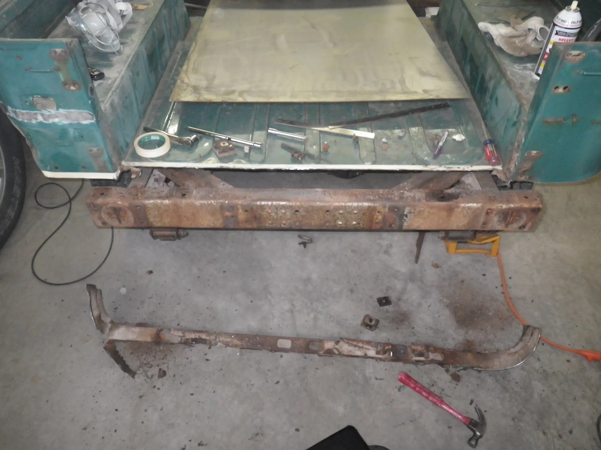

And this is when I wished I would have down a frame off. I had to pull the rear tub and repair the cross support.
And the minute I pulled the tub I realized I did not have a good supported tub to maintain integrity. I had already pulled the right rear quarter off and didn’t support it correctly.
Thanks for the lead! I will definitely check into it.
Back in the mid nineties I made the mistake of installing 73's reverse on my 68 which was registered. While parked in the driveway the lens got broke. Back then the 40 series was as popular as prices reflected that. Found one on eBay that was listed as a unknown Toyota fog light. $10 opening bid and was the only bidder.
Edit. Didn't start eBay until 2001 so was after that. Maybe it was one from a junkyard I'm thinking of.
