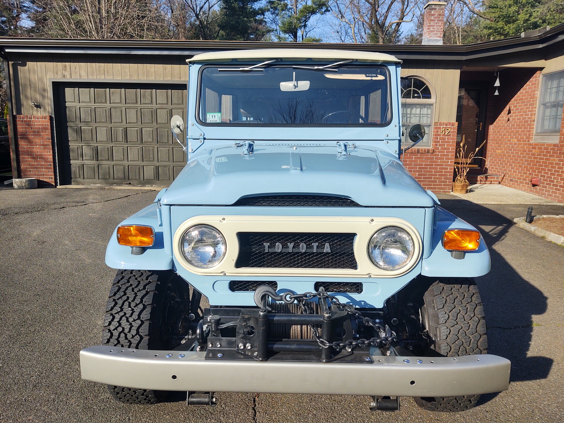

Beautiful truck... From what I can see of it.
Thanks.

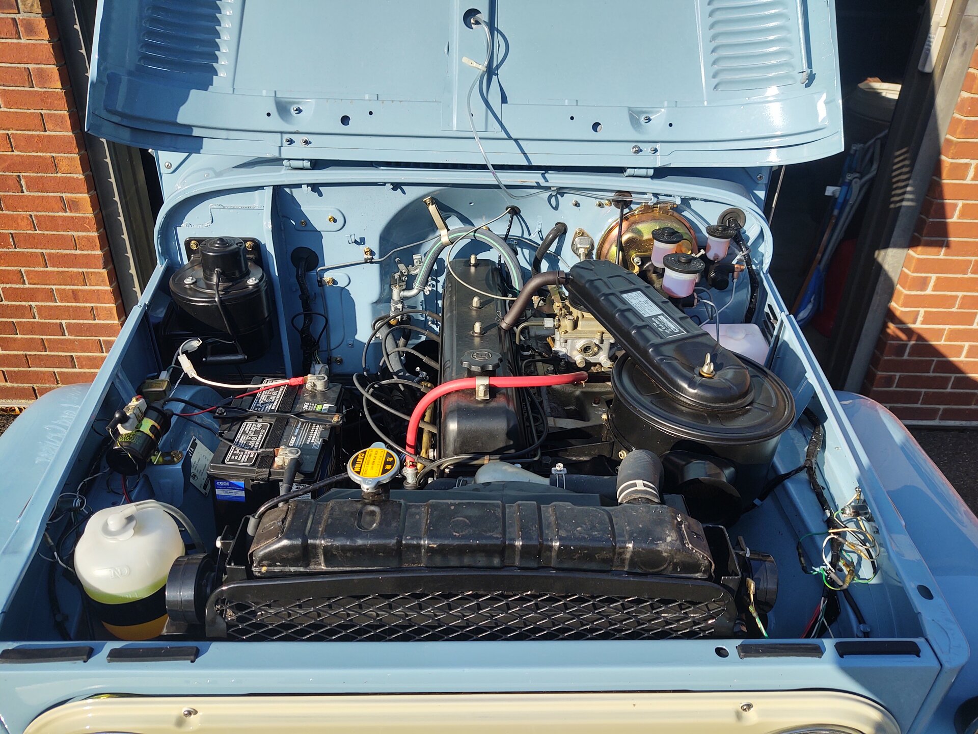

Restored as stock as stock can be.
Only upgrades from 1973 were heater valve and coolant tank from later model FJ40's.

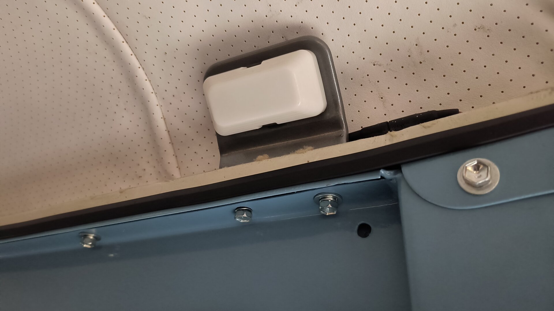

The 73 room light on the hard top did not have a switch in it. 9/73 the switch in the light. After I flipped my 68 in 1975 I purchased a hard top from a 73 in 1976. It had the same room light. I used the 68 light on the passenger side.

Air you running all the US emissions? Mine were removed but think it was in the all the extra parts that came vehicle.
@Living in the Past
Can't remember is this 73 from bought from McCoy Motors on Switzer Canyon Dr in Flagstaff?
The truck was bought new by the PO in Holyoke, MA.
I bought it in 1977, and eventually ended up in Holbrook, AZ working a startup of a power plant in Joseph City, AZ.
My wife bought me the winch from McCoy Motors for my birthday in 1979.
The emissions stuff was removed after the air rail rusted out, and Massachusetts ends emissions inspections after 20 years.
I have all the evaporation components, just need to fabricate the tube from the fuel separator to the canister. Fortunately, there's seldom if any odor so it's on page 2 of the "honey-do" list.
Was the hard top dome light controlled by the vader light switch or a separate switch near the ash tray? I am using a push/pull HL switch with a quarter turn switch for parking lights. I use the quarter turn switch for the dome light.
Hardtop dome light controlled by a pull-on push-off switch above the ashtray.
2nd picture in post #16, above.

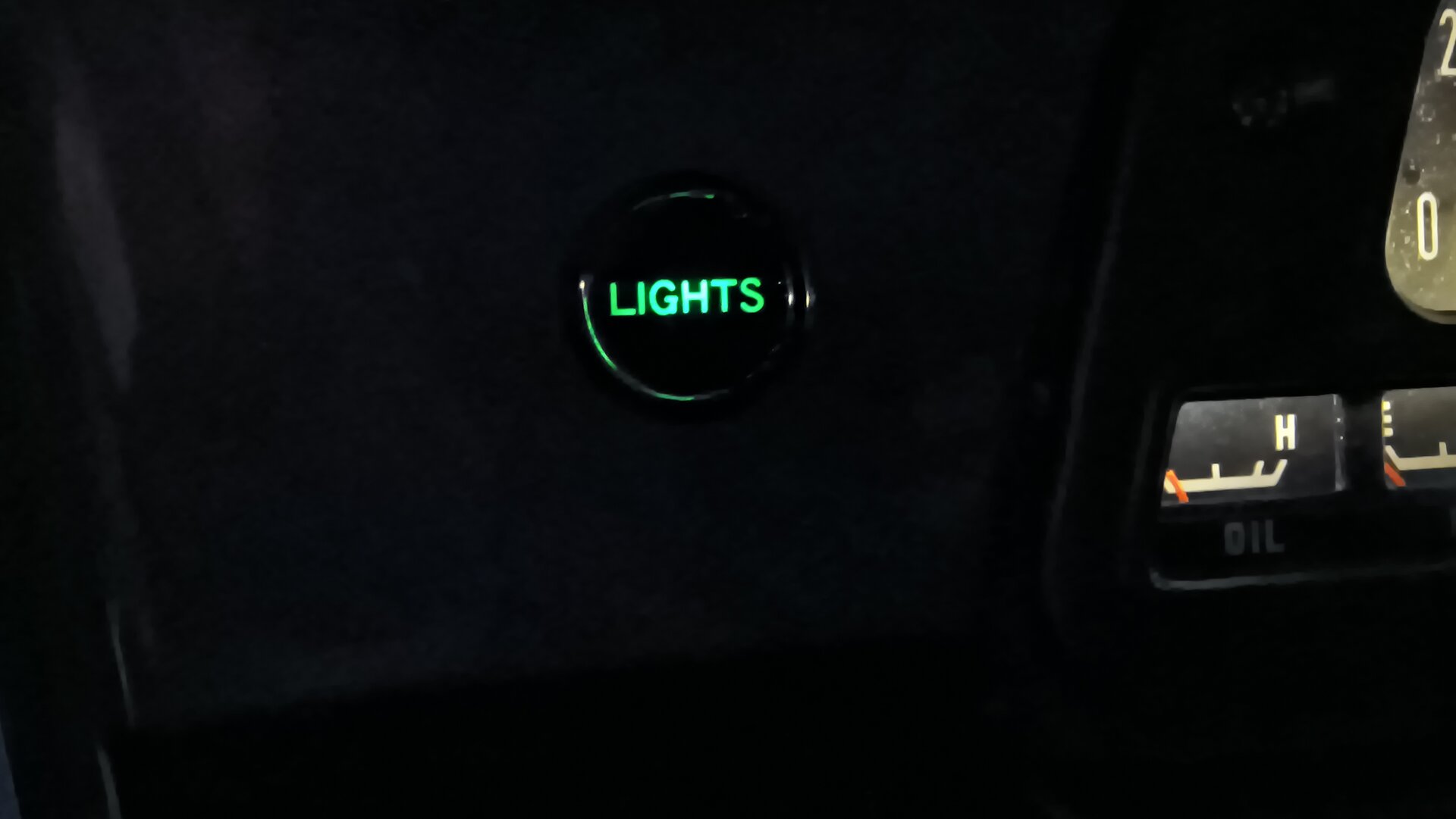

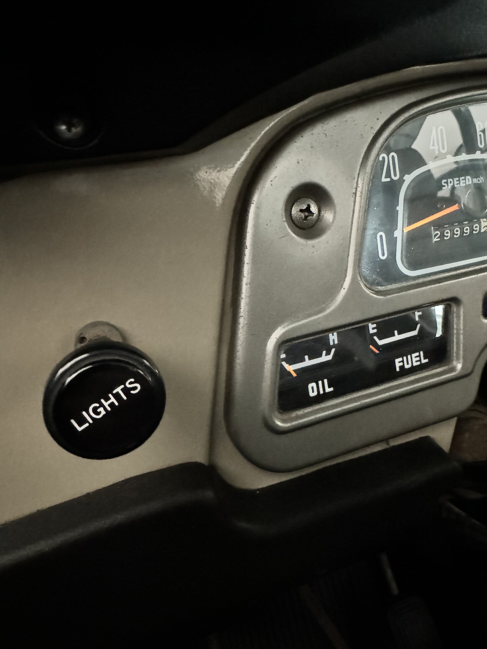

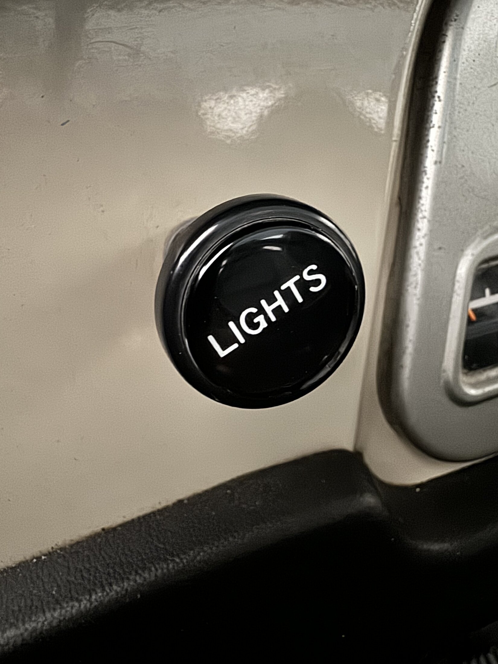

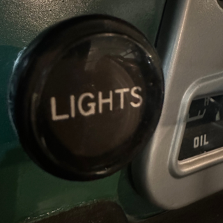

I just checked my 73 and the light switch doesn’t light up. Is there a bulb source that makes it light up ? Mine could have been replaced with another year part.
Other features of 1973 model year which may or may not be common to other years:
Illuminated headlight switch:
Last year for hardtop "dome" light just behind driver's B pillar, with dashboard located switch:
View attachment 3652052View attachment 3652053
The original switch has a lens over the writing so the blub in the back can illuminate the front switch. In the back of the switch is a small bulb. There is a small OD "light tube" that helps transfer the blub light to the front of the switch. There is a plug in socket for the blub.
90981-11009 BULB, LIGHT CONTROL SWITCH is discontinued as well as the supe number it looks like now
See here for bulb replacement in led as well if your into that :meh:
