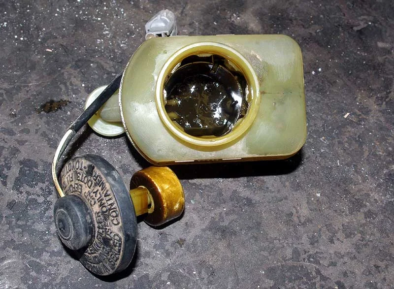

Does the fluid get dark enough over that year to know when you guys have successfully swapped it out with new or do you just push through more than's feasibly in the system?

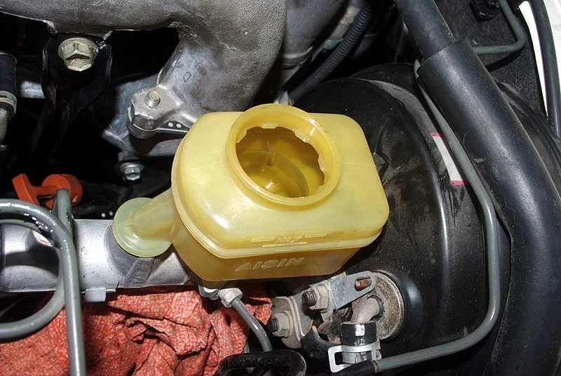

It gets dark enough to easily tell. When you flush the fluid through there is a obvious transition from old to new (new is clear like water).
We do the turkey baster thing. Anytime it looks a little dark, suck the reservoir dry and refill. The best time to do a full change is with a pad change. When the caliper pistons are fully compressed most of the fluid is in the reservoir, suck and refill, then use the bleeders to get the last of it.
Some that we see are long term ignored, on those, suck the reservoir, remove it, wash, then flush.
My brake fluid typically starts to go light brown at the 9 or 10th month mark. I usually gravity bleed through the left front to clear out the master, then regular bleed through the rest of the system until it runs clear like water.
