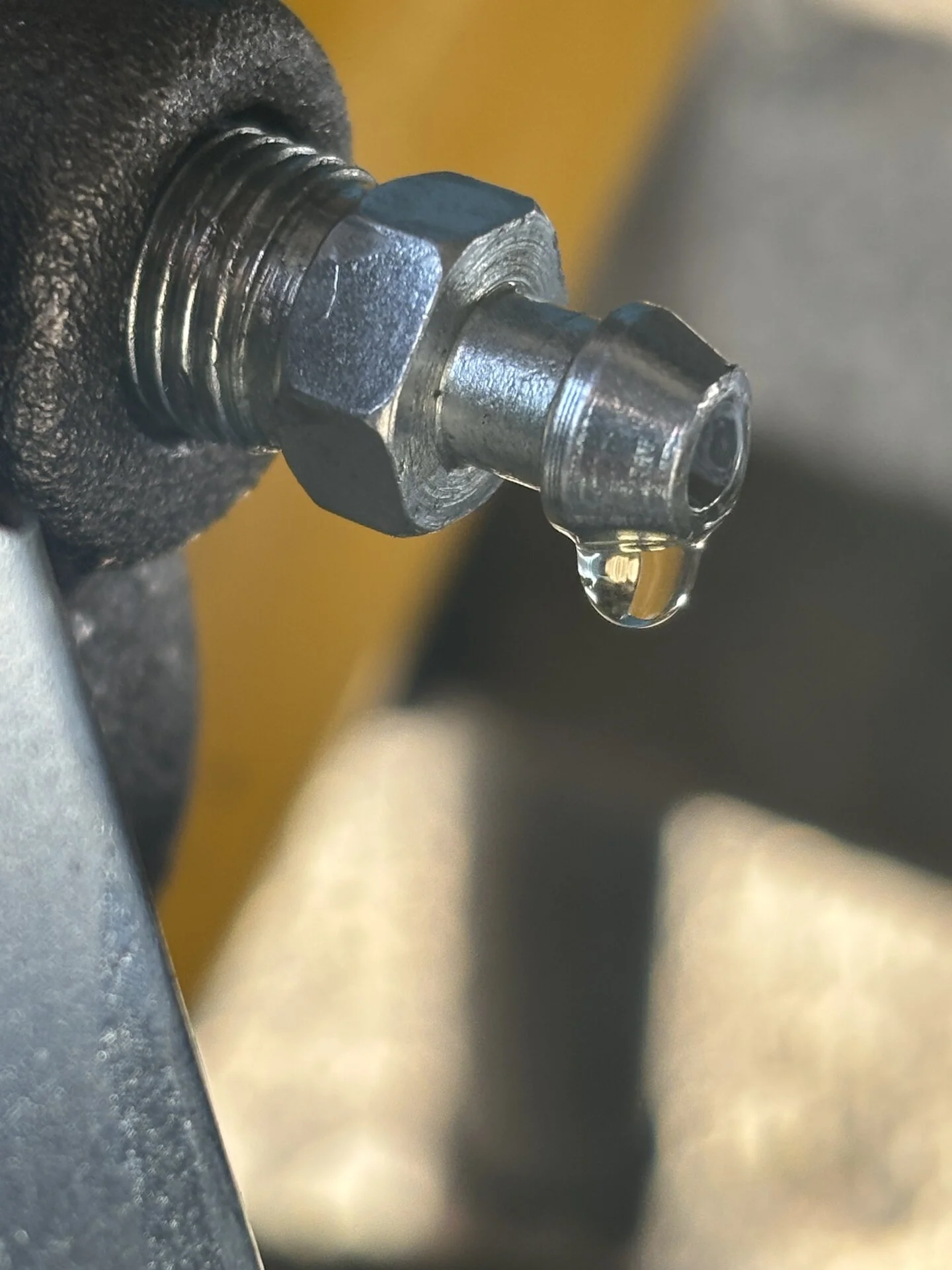

Passenger Rear Wheel Leaking Brake Fluid

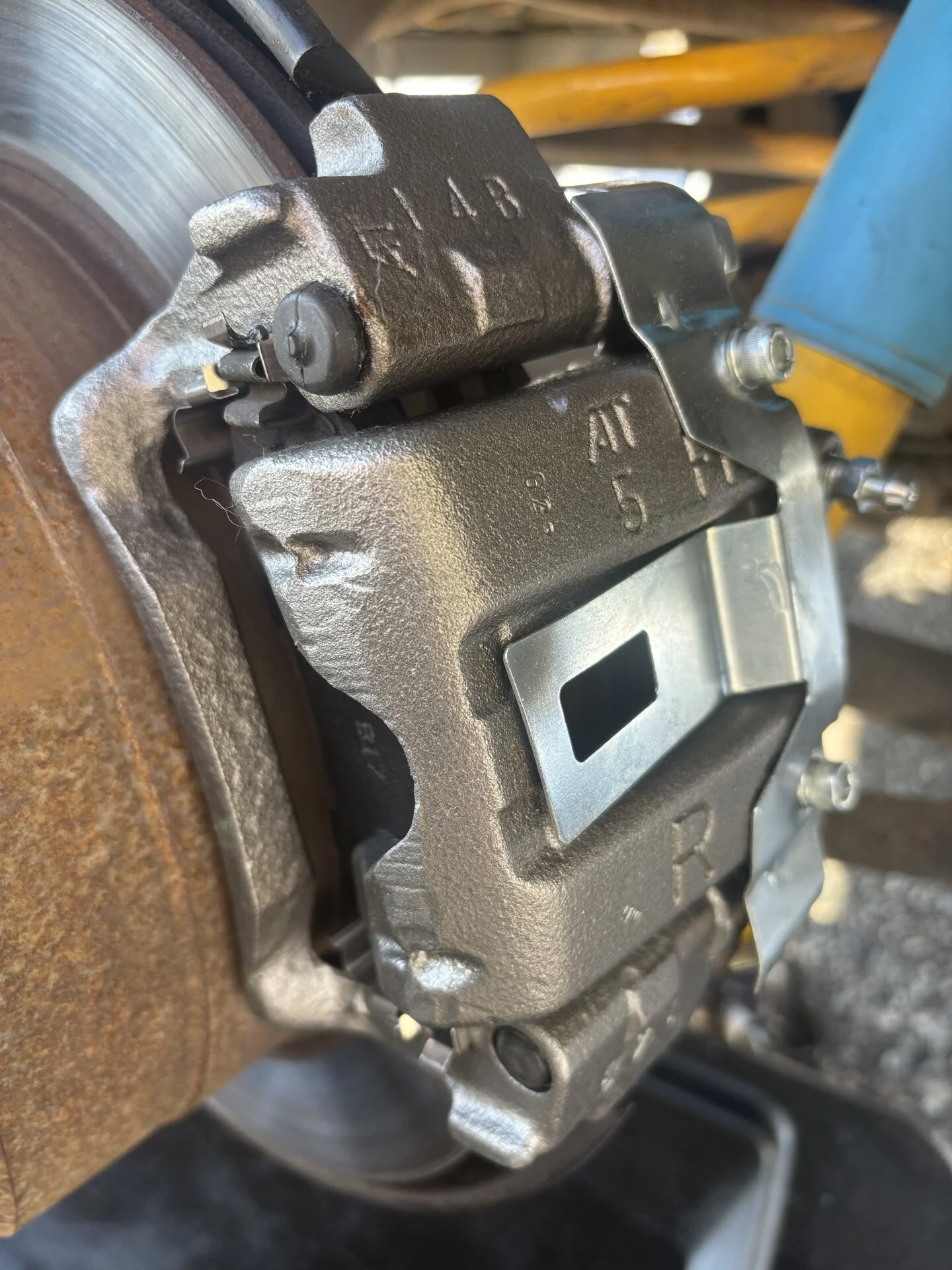

Making progress with assembly. Reached 10 ft-lbs of bearing preload. Bleeding the caliper with a vacuum pump and gravity. I do my best to not press the brake pedal as it can take it out sooner on a bleed if the bore is worn. Seen this several times.
Axle shaft slid right in after using my kids SST & saying a prayer to move the elocker cog back in place.

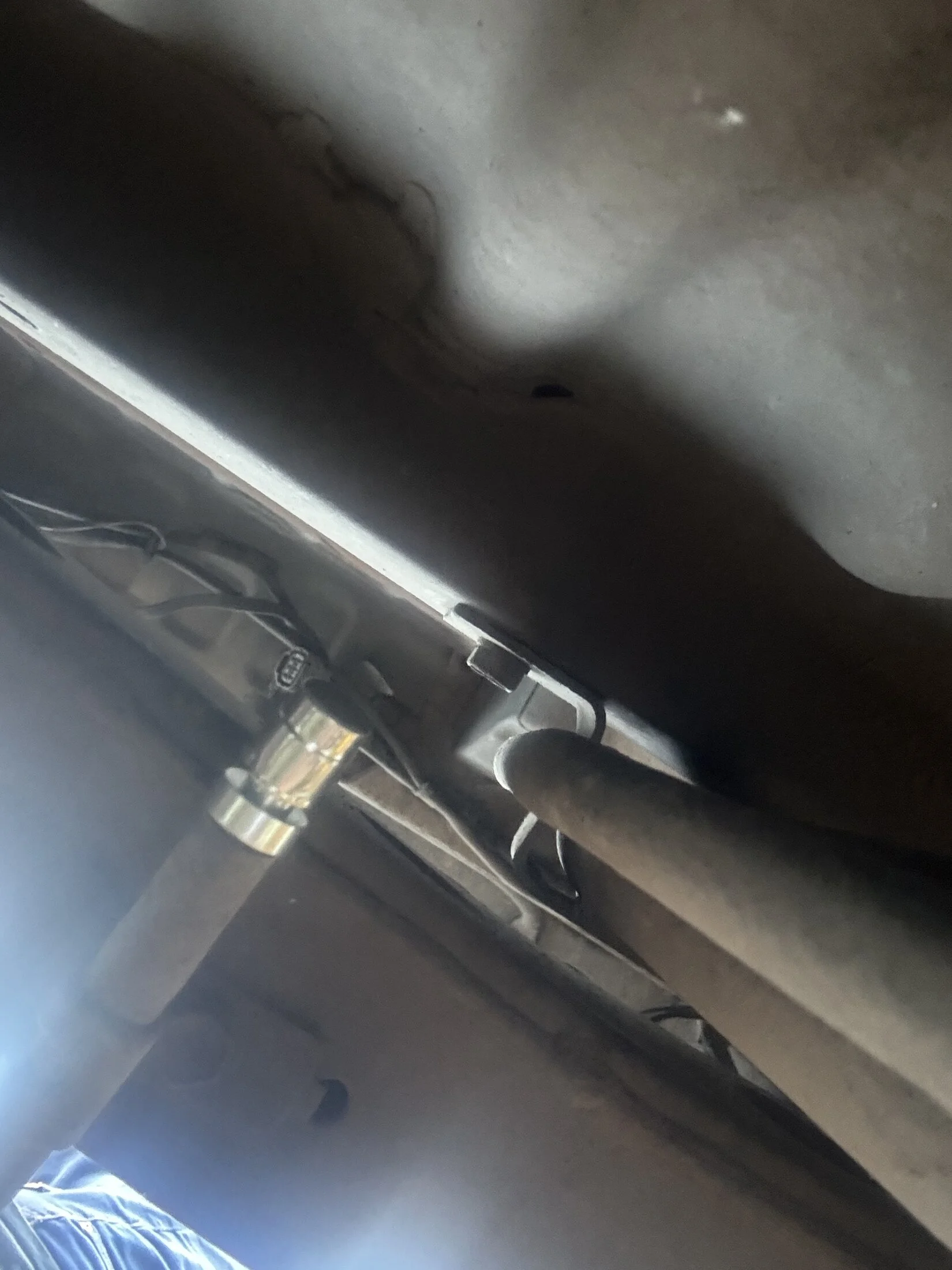

Doing a 30k major maintenance. I don’t know about others, but I like to use it as a time to catch up on little things that I may have gotten behind on or have thought about how I want to clean up better. After scouring the Internet and doing research on this axle vent, I decided to just replace it with a new Toyota one. Easy 1 banana job. Pull the old one out with a pair of pliers and pop the new one on. I noticed the new one has a cap that has a little more movement than the old one, but definitely is made for pressure to escape not come back in.
I'd eventually like to extend that breather up into the frame or rear tail lamp and do the front as well. I know I can use fuel hose but I like how this factory hose is more flexible. Anyone know what it is or how to buy it in bulk or longer sizes?

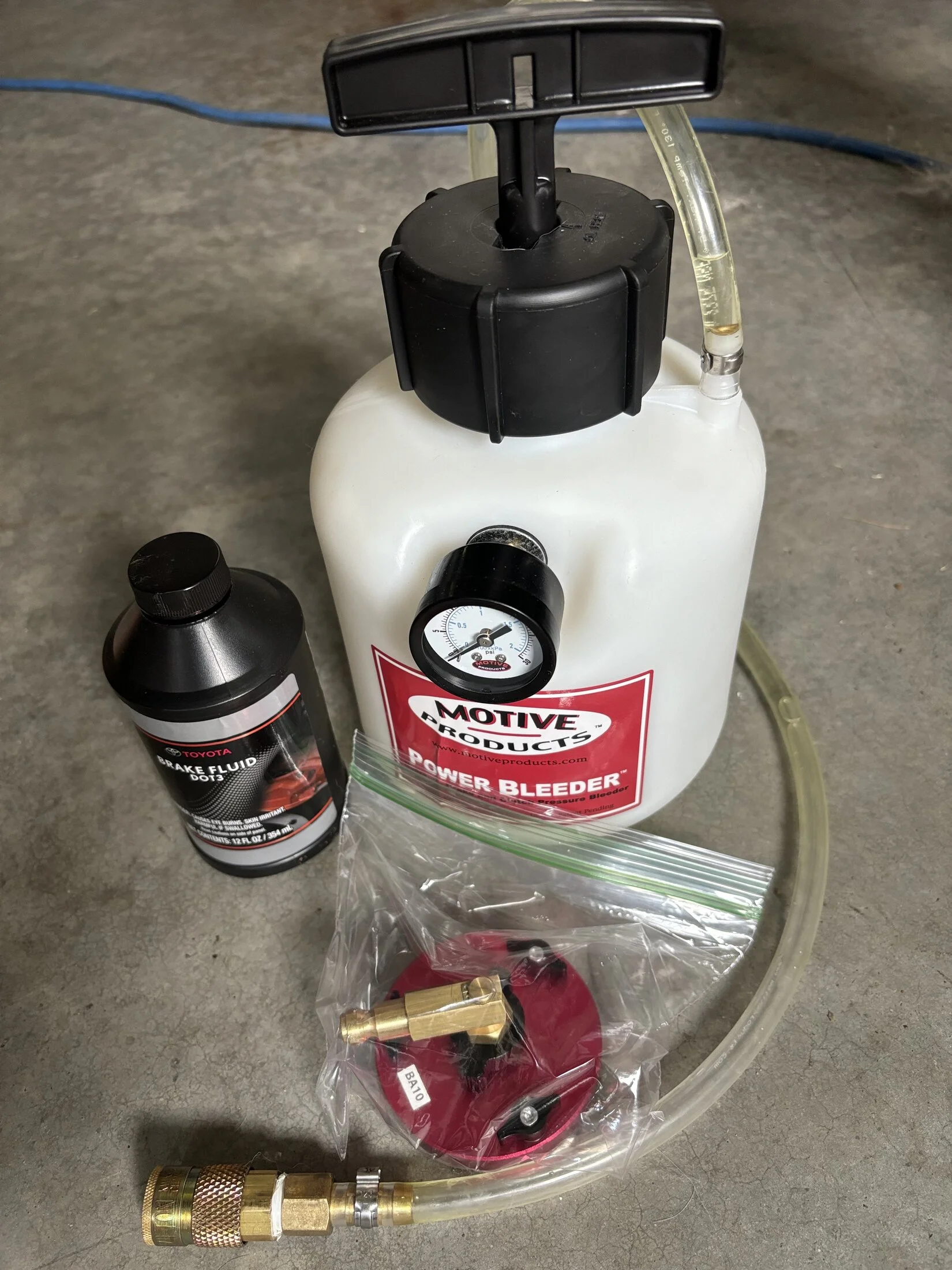

After noticing my brake fluid color not as clear as it was when I changed it this year and reading this thread as well as being at a service interval, I decided to replace it with Genuine Toyota fluid.
My 80 series doesn’t respond well to a hand pump bleeder so due to a friends recommendation I purchased this pressure bottle & adapter which makes the job go so much better and so much more control with less chance of air being in it. For those of you using one of these curious how much you typically pump it up to.

"curious how much you typically pump it up to"
I pump it up to 15psi (needle pointing vertical @ 12 O'clock) which IIRC is what Motive recommends; as the bottle empties the pressure drops and the flow slows down a bit so I pump it back up between each bleeder position while checking the fluid level in the bottle.
Tips: don't walk away while bleeding using the bottle, IME it empties quicker than it may appear. Try to keep the bottle upright as if it falls over on it's side it could suck air before the bottle is empty. IME you will need at least one quart to fully flush a neglected system, I used two quarts IIRC.
