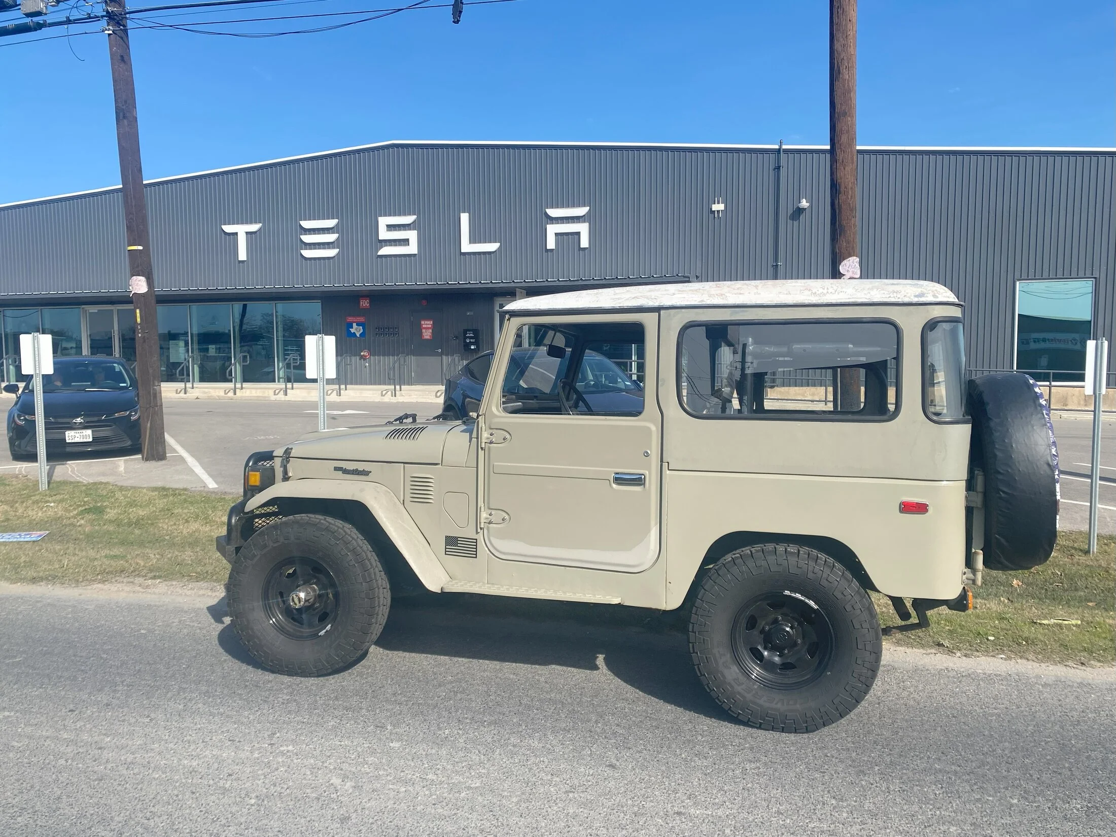

I am closing in on wrapping up my "frame on" restoration. I need some advice on replacement springs. I am not a suspension expert, so I am a little intimidated by the various options and leery of pulling together parts from different suppliers. As far as I can tell the springs are original and the shocks are Bilstein's.
This is my first '40. I am not planning any crazy rock crawling. I'd like a comfortable ride that can handle off road when necessary. Looking at other 2.5" lifts it looks like that will get the body up away from the wheels and provide better clearance. I am currently running 32" tires.
I am leaning toward the CCOT 2.5" HFS lift kit as it has everything I need for a total replacement. My question is, am I spending too much for what I need? Here's an old shot from the side. It shows how deep in the wheel well I am in the back. I appreciate that this is a very "general" question. I don't mean to start a holy war. I know there are a few mudders who have tried different options. Just looking for some advice even if it's to confirm that the CCOT option is a good one.

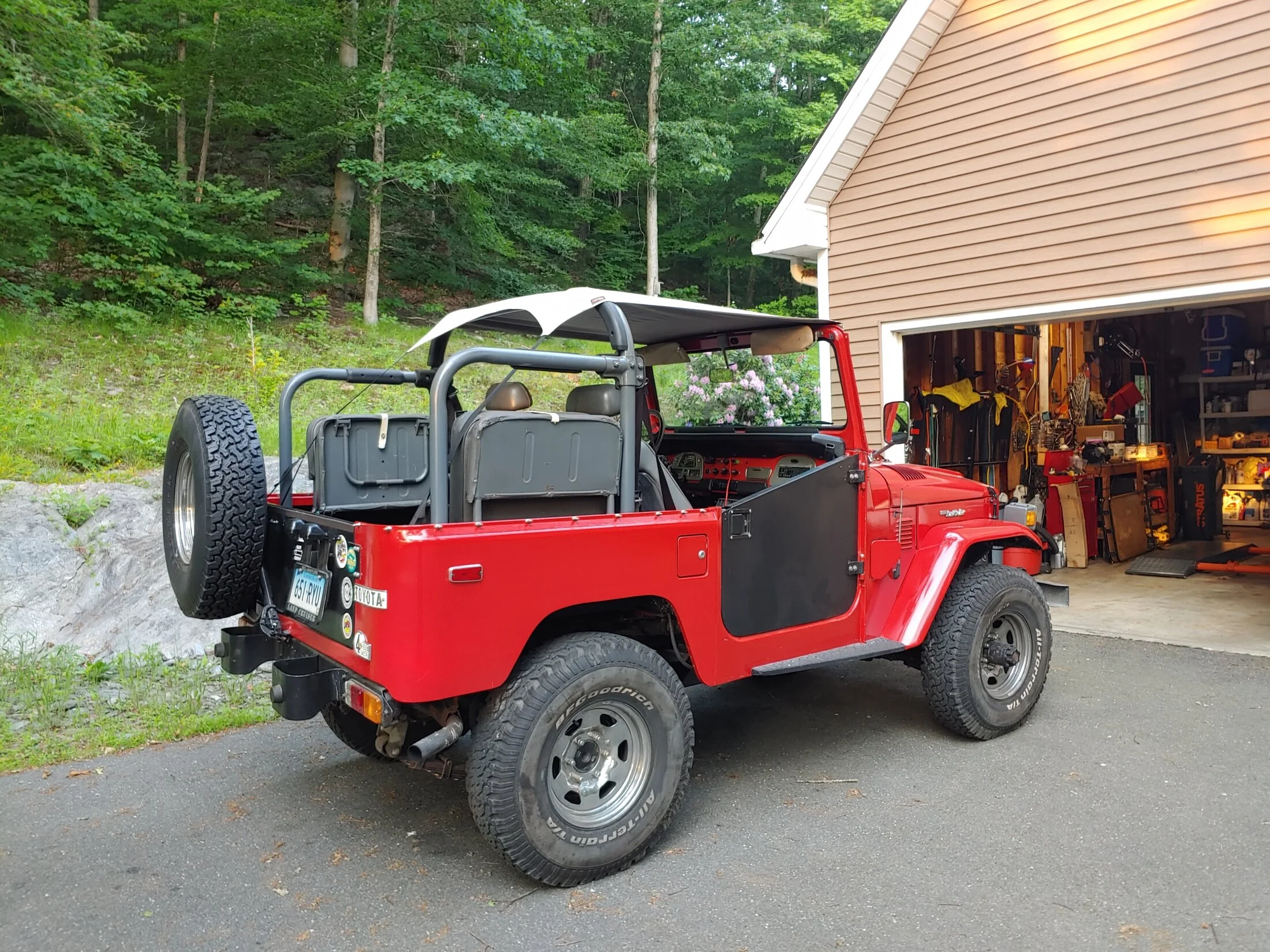

I have a HFS suspension on my 79 FJ40 running 33 x 9.5 BFG AT's.
It is not the softest ride but it has held up well.
