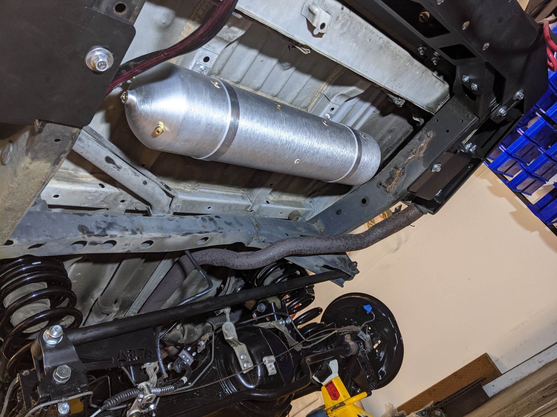

A 5 gallon under? Did you find some odd oblong shaped one? Most 5 gallon are kind of big diameter wise(lifted truck or not).
Aluminum air suspension tank.
Ooh! very sneaky.

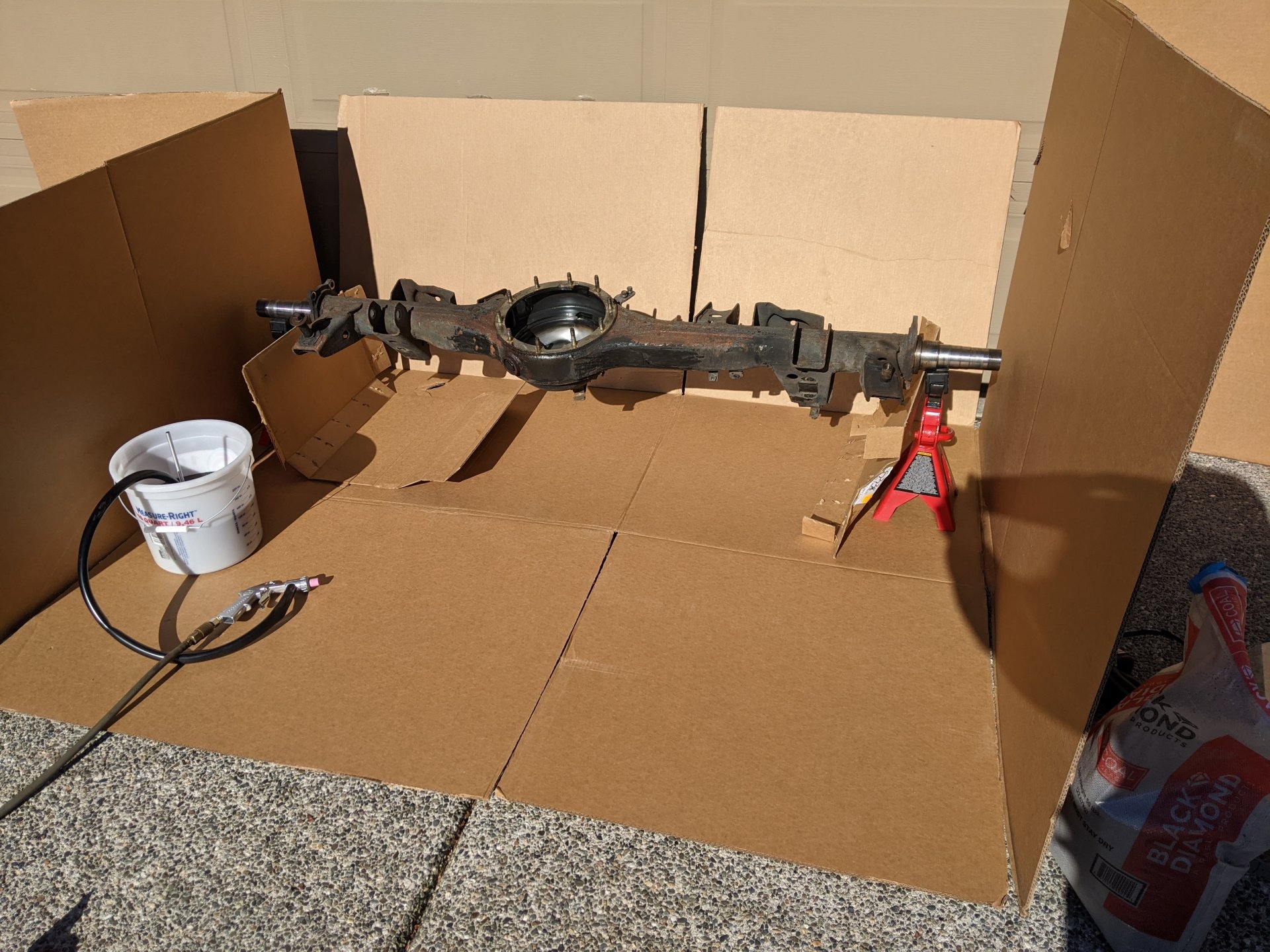

I also had an incredibly dumb episode where I thought I might be able to bucket blast the rear with my 6.7 CFM compressor. Yeah ... that didn't work too well, despite my sexy cardboard set up.
