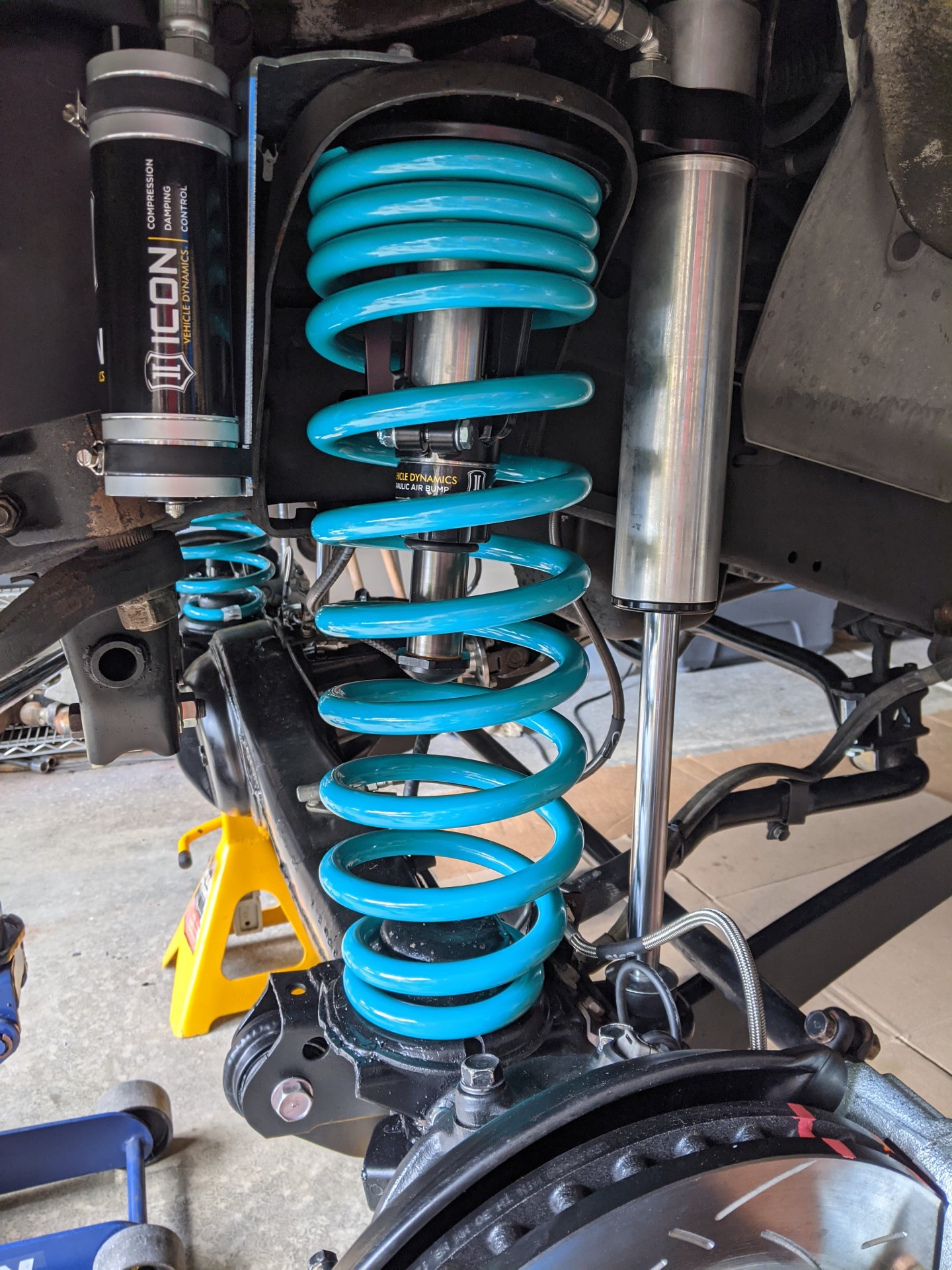

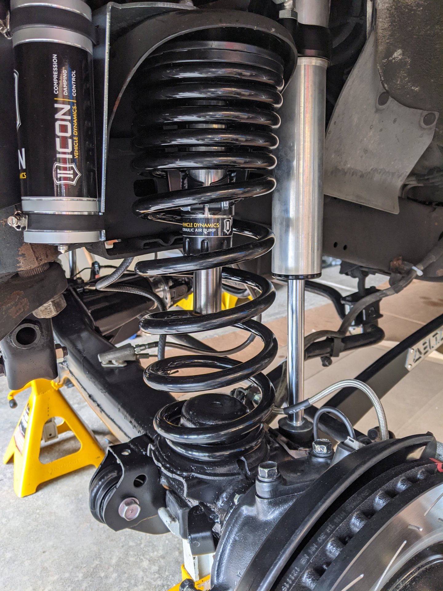

New Dobinsons VT springs in (next to 3" Icons).
That looks really good man. Decided against powder coating?
Wasn't sure these springs would work out and may have had to work out something with the Vendor, so I didn't coat. Might do something in the future, but good enough for now.
No joke, I think it works with your ride. It wouldn’t work with my 6M1

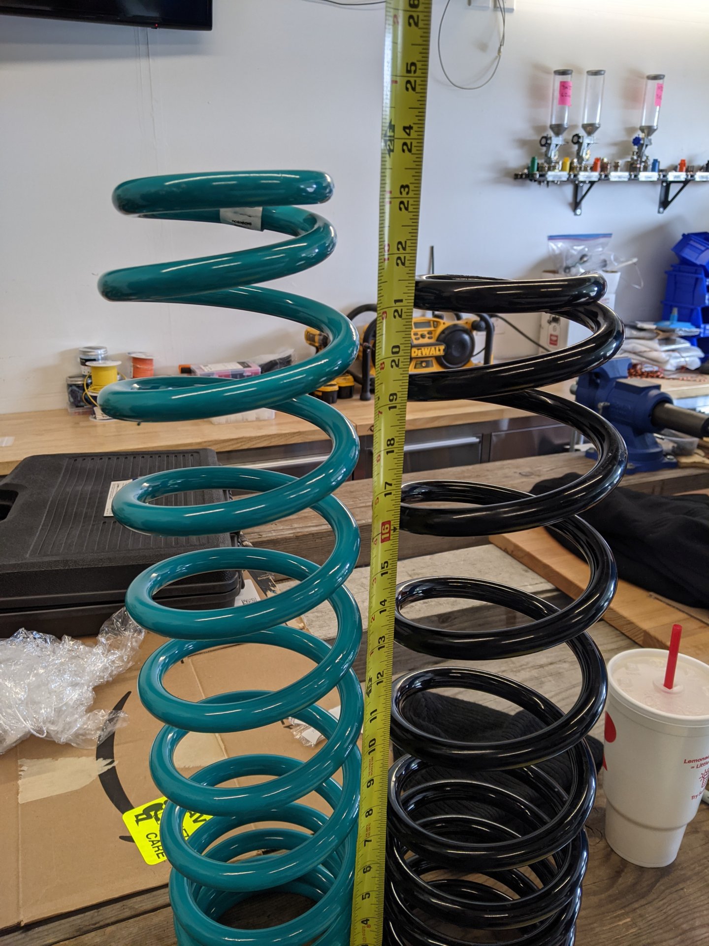

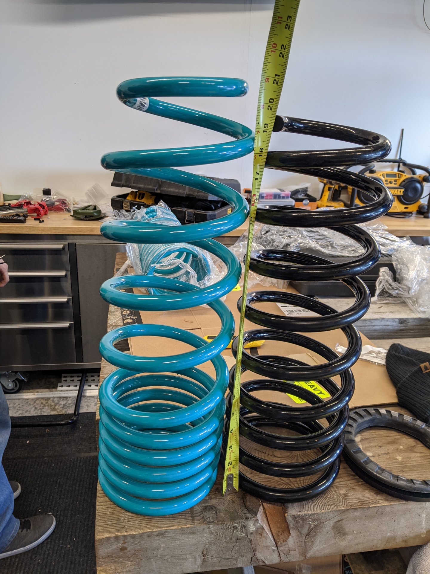

In case anyone is interested in the before and after measurements in comparison to the Icon springs:

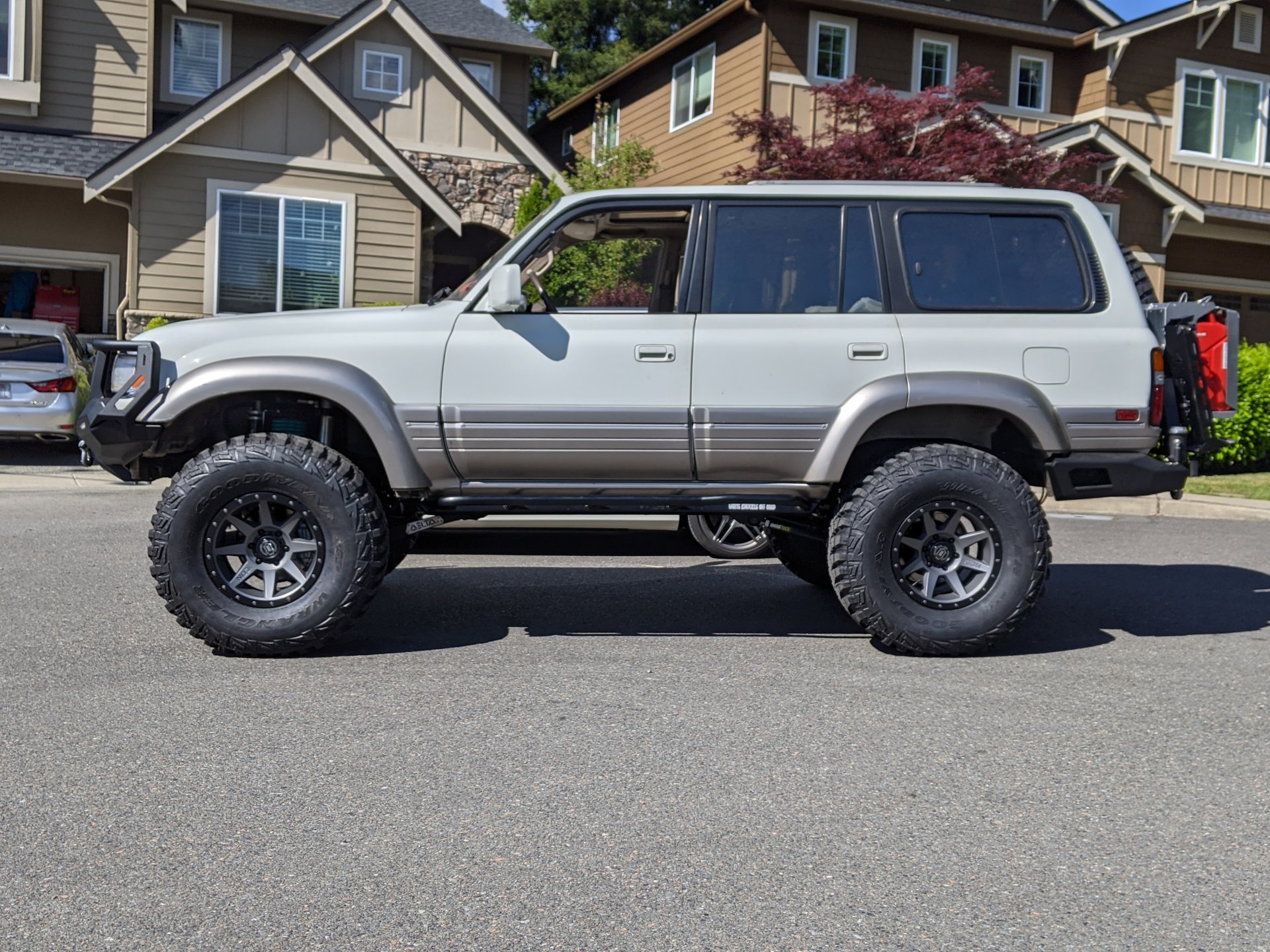

Front ended up right where I was expecting, rear is about an inch high. Might pull the rear spacers if I don't see some settling and a drop once the truck is loaded normally.
Looks about right to what I’m getting and I may be 1/2” higher up front without the extra weight minus the 1” spacer. I can see your front springs with a bit less gap than me at the top.
Are you happy with the front 1”spacer? Inner front fender clear ok when turning now? Overall I was thinking of milling down the 1” body spacers to 1/2” with this and seeing yours I may still go there. Had to run up to Aspen for the weekend without the cruiser and wish I could have taken it to play around a bit.
I do have the MRR 4”-6” rear and was worried but can pull it to check down travel when I get to where I can get the rear in. Think it may work well now.
Yeah, happy with the 1" spacer up front. Still going to have to trim the inner rear of the fender well, but not significantly. Doesn't look like any interference on the front of the fender well at full lock with articulation.
I'm running the 0-3" shocks that came with the original kit. Both ends are looking a little short.
Definitely going to want to address those shocks. Surprised that they are that short being designed for a 3" lift. Not sure if you can track down any Slinky Stage4 shocks, but they'd be perfect length for your new setup. Availability is scarce on them right now.

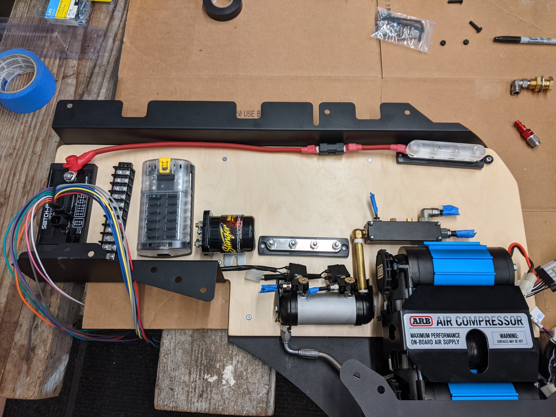

Started on the QPM today. OBA system is plumbed to the push fittings. Still deciding how I want to place the electrical.
