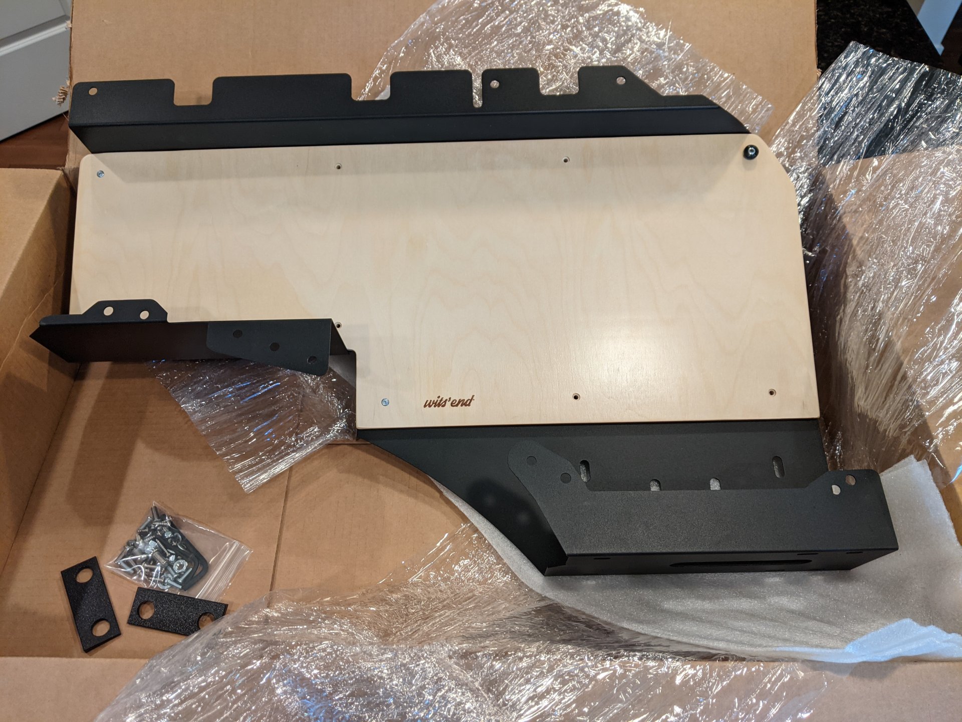

keep an eye on your sunroof drain tube when you install the qpm. It just needs a slight push to not get pinched.
Thanks for the heads up.
Mine showed up 2 days ago...but so did another (much larger package in a crate 😎). So I haven’t even opened the QPM yet.
When did you order yours? I ordered mine back in March.
