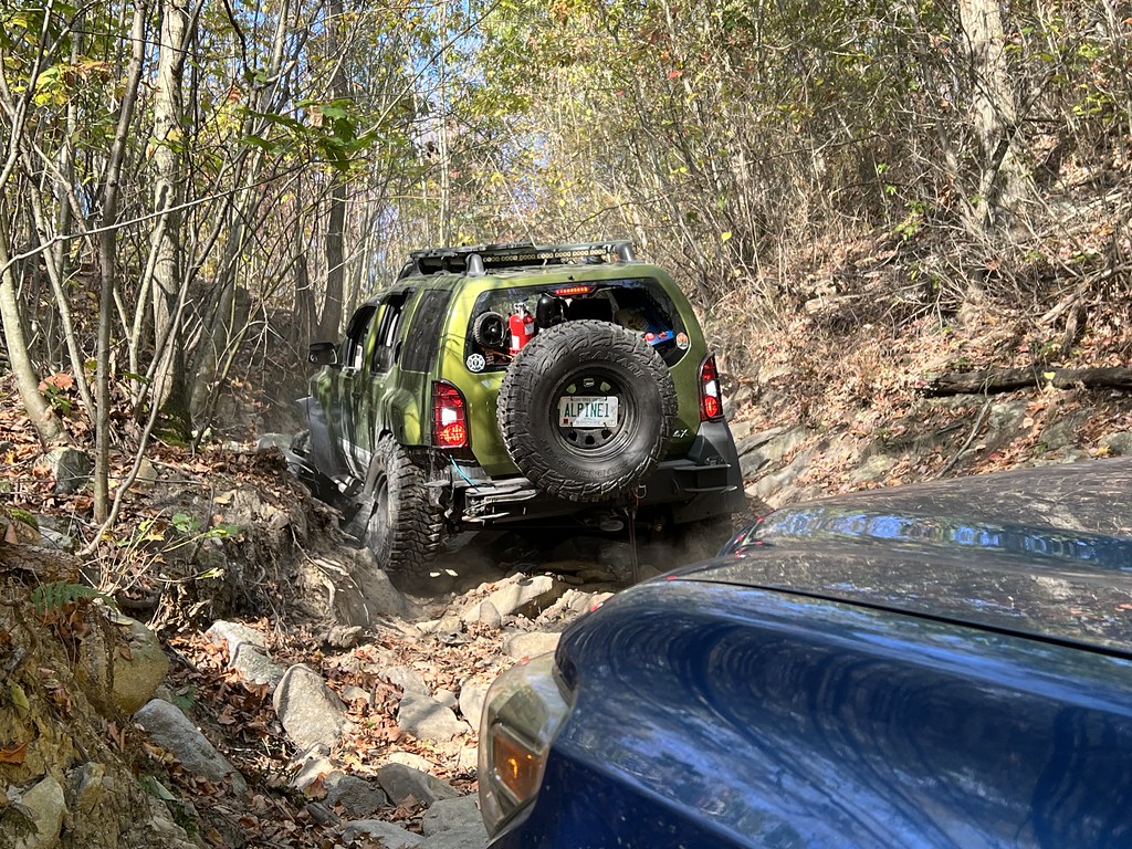

  • Knew this a thousand times over, but clearance is everything. In those pictures where I'm hung up on the rocks and the winch line is out (which we didn't actually use in that instance, instead just stacked rocks and backed off the obstacle with some push power from friends), I was only in that situation because a) I probably could have lined up a little better for my approach and b) The right front lower control arm was 1/2" from clearing the rock I got stopped by

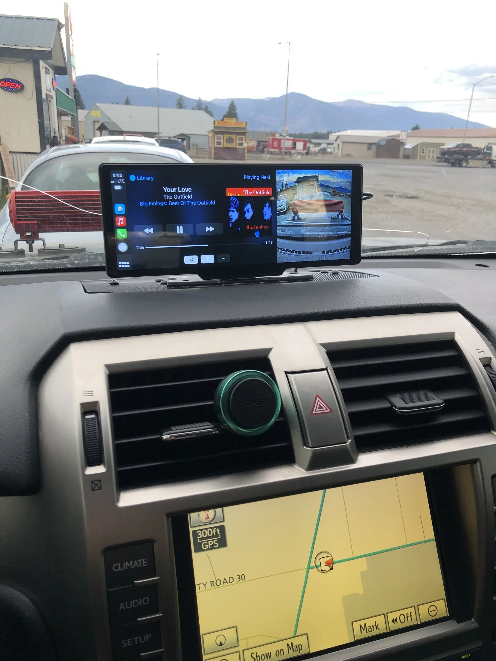

  • Starting to have more issues with the Grom VLine2, which now simply won't do CarPlay at all. Need to unplug it and plug it back in...
  • Suspension travel with the Ironman kit is solid, but might be worth exploring the KDSS off switch mod for next year
How long have you had it? Mine after ~3yrs is nearly unusable. The screen will either freeze and it won't take any touch inputs or it'll black out but take inputs. It long stopped doing wireless carplay less than a year after I got it.
I said F it and put on one of these until I hear more feedback on the Carlinklife unit.
This unit so far is pretty neat. Wireless carplay works great. My only complaint is not with this unit but my hands free in the GX being atrocious audio quality on calls and using the factory GX mic. The Bluetooth radio quality is good so that's what's important LOL.
*edit*
It has a built in 4K 60fps dashcam too.
Installed it 4/2023, so a year and a half.
Cool looking unit, which is it?
At this point I'm just using the Ram mount with the phone in it for nav when I need it. Not worth the headache of dealing with the built-in infotainment.
Cool thing about this unit is you can remove it from the mount and store it anywhere and it'll work with a USB-C cable to power it. It also can allow phone mirroring with your iPhone. It's still on sale and isn't expensive.
I like that it'll mirror one's phone. I like my phone's UI and am used to it with maps, music, and so on.
Does your car's phone still work through the car's factory system?
Yup. That's what I was getting at with the low quality mic/phone audio from the factory GX. Perhaps it's because I've got a 2010 and it's an old system?
