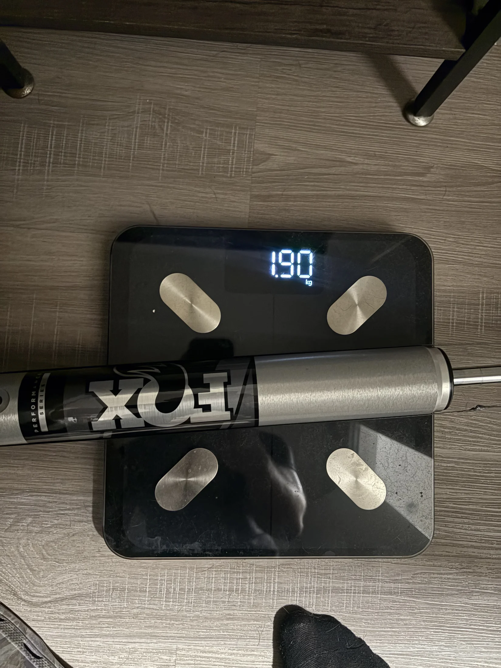

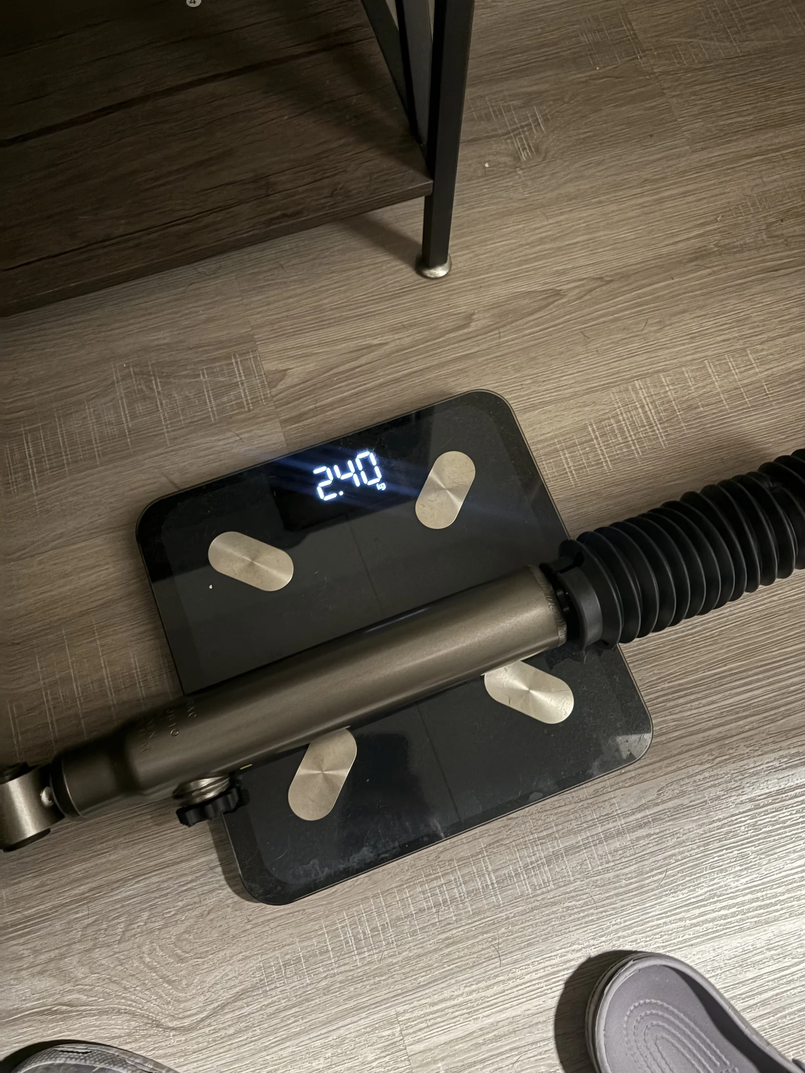

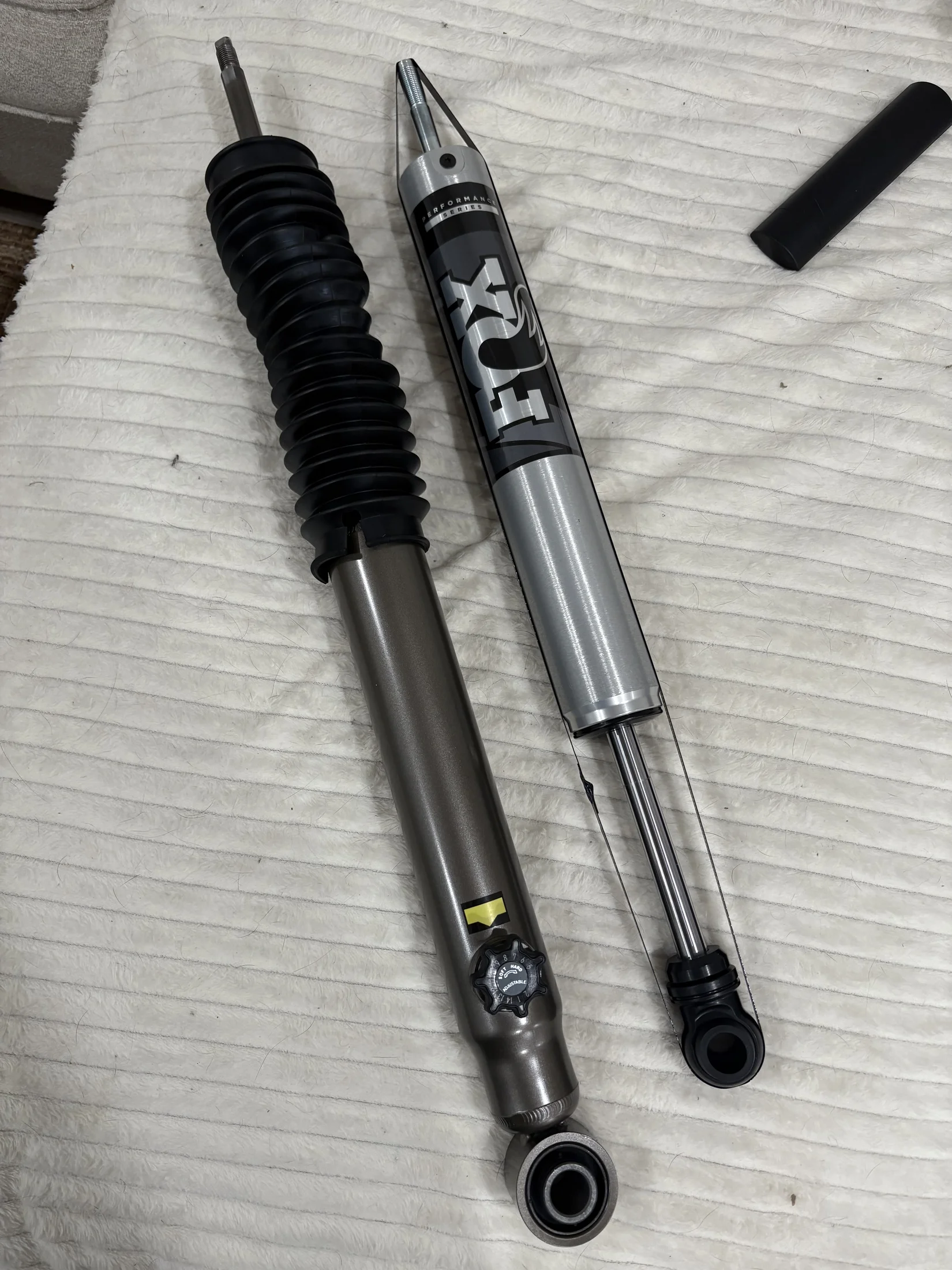

Unfortunately, I couldn’t find a full KYB lift kit in stock. First, PartsGreek sent me the rear shocks without the springs and told me I had to return the shocks before they would try to locate the springs. After that, I tried to find the front KYB SR kit in stock, but after calling 5–6 stores, I realized it would most likely be a special order anyway and not worth wasting time. I also didn’t understand why the rear shocks were delivered uncompressed or not even partially compressed. In the end, I decided to go with the Fox 2.0. You can see a detailed comparison of the rear shocks in the photos.
View attachment 3956477View attachment 3956478
Curious as to how you landed on the Fox? Seems like a higher performance (stiffer) shock that you were originally looking for.
I have spent many hours on YouTube watching comparison videos of different stores and workshops and 10/10 said it was the softest upgrade.Unfortunately only 2 posts on reddit and 3-4 videos and asian countries said KYB made the car softer.Also I still want to try (at least for experiment) the shock absorber kit KYB but not in stock 🤷🏽‍♂️.
Maybe next week I will install Fox 2.0 and give feedback.
