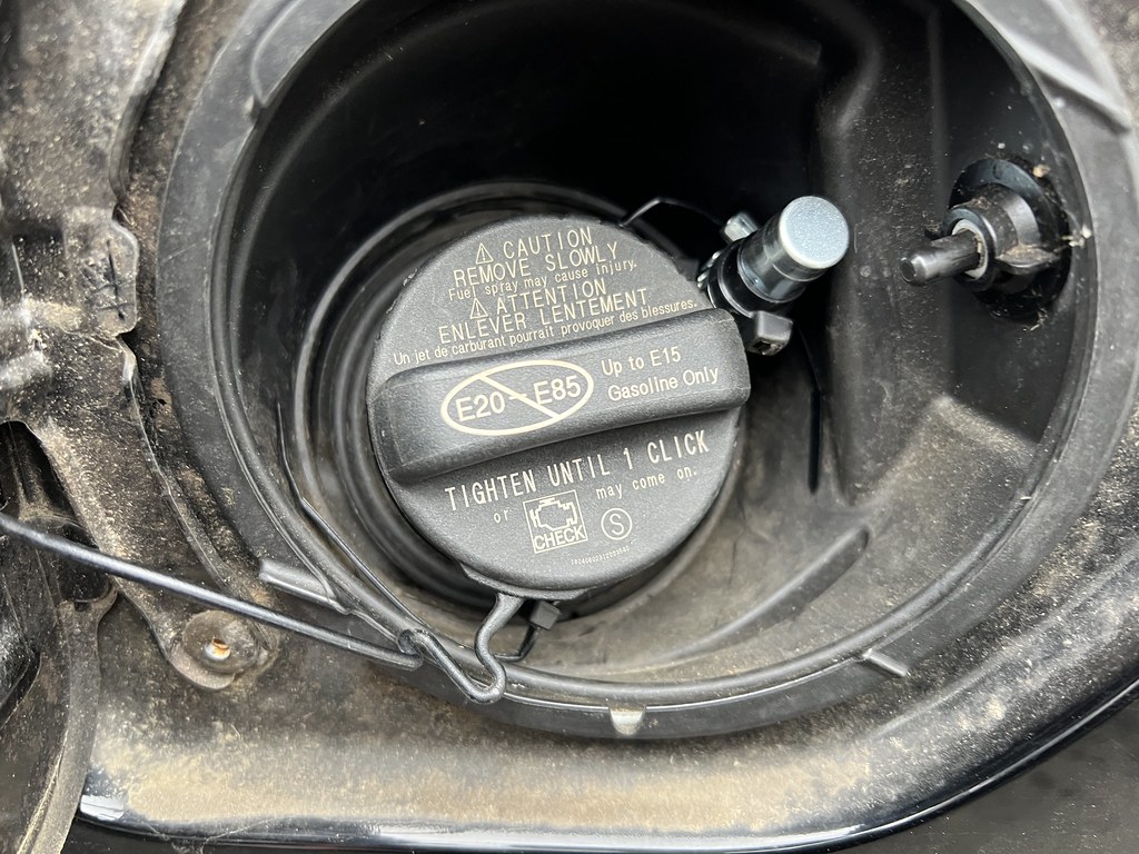

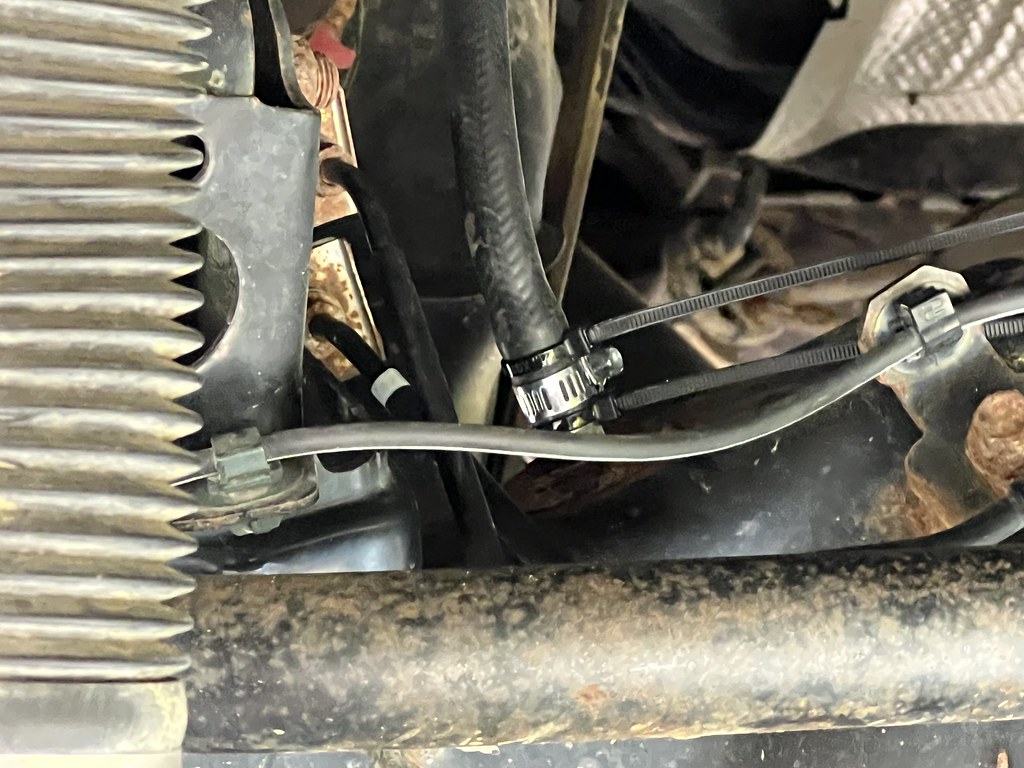

Installed the TEQ Customs diff breather relocation kit over the weekend. This had been sitting on my work bench for a year and a half, finally found time to install it. Easy enough: Unscrew stock breather cap from the rear differential, screw the supplied plug on, run the hose down the gas cap well by prying the rubber gasket back with a big flathead, snake the hose to the diff and connect the hose to the union, hose clamp and zip tie everything down. More words than it is actual work.

Have you considered routing to your rear tail light instead? Stealth install option so that you don't have to see it every time you pump gas

I did consider it but chose otherwise. The gas gap route inherently vents fumes, and should there be any-- ideally none whatsoever given the sealed nature of the diff and breather-- I didn't want them anywhere near the cabin or even cargo hold. I also don't mind seeing it every time I put gas in the tank.

What about the front diff?
Or is that another year's wait? 😆
When I first built up my rig, I was all about wanting to vent my diff's, but after talking with some people, we just don't get enough water features to go through down in our neck of the woods and was advised not to bother with doing it.
I do like the xychromosome - https://forum.ih8mud.com/members/xychromosome.178819/ idea about using the tail light. Here in CA, that may be construed as a vent for a second aftermarket fuel tank, which are not legal in CA when getting your rig smoged.
