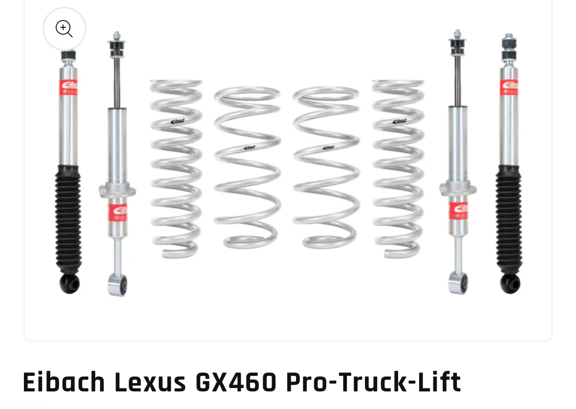

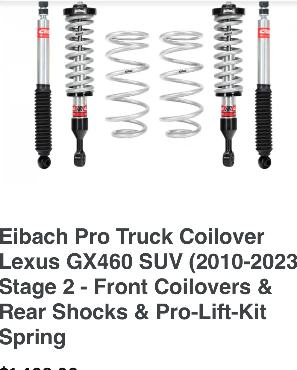

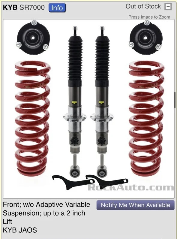

Hi all,
I have a 2020 Lexus GX460 (60k miles) on 32.5” Falken Wildpeak tires — each wheel added ~20–22 lbs over stock. Since the switch, the ride feels harsher, especially when hitting potholes. It seems like the shocks can’t keep up with rebound, and the ride feels jittery.
My goals:
  1. Softer, more compliant street ride (no lift).Sometimes doing overland.
  2. Better shock absorption over dips and bumps with extra unsprung weight
I’m considering:
  • KYB SR Battlez kit
  • Eibach Pro-Truck Stage 2
  • Eibach Pro-Truck Sport
  • I would also be happy if someone could find me comfortable springs that don't require replacing the struts.
Looking for feedback from anyone who’s tried these setups — especially in terms of comfort and whether they improved the issues I mentioned. Open to combining springs + shocks if needed, but want to keep stock height.
Appreciate any advice!
