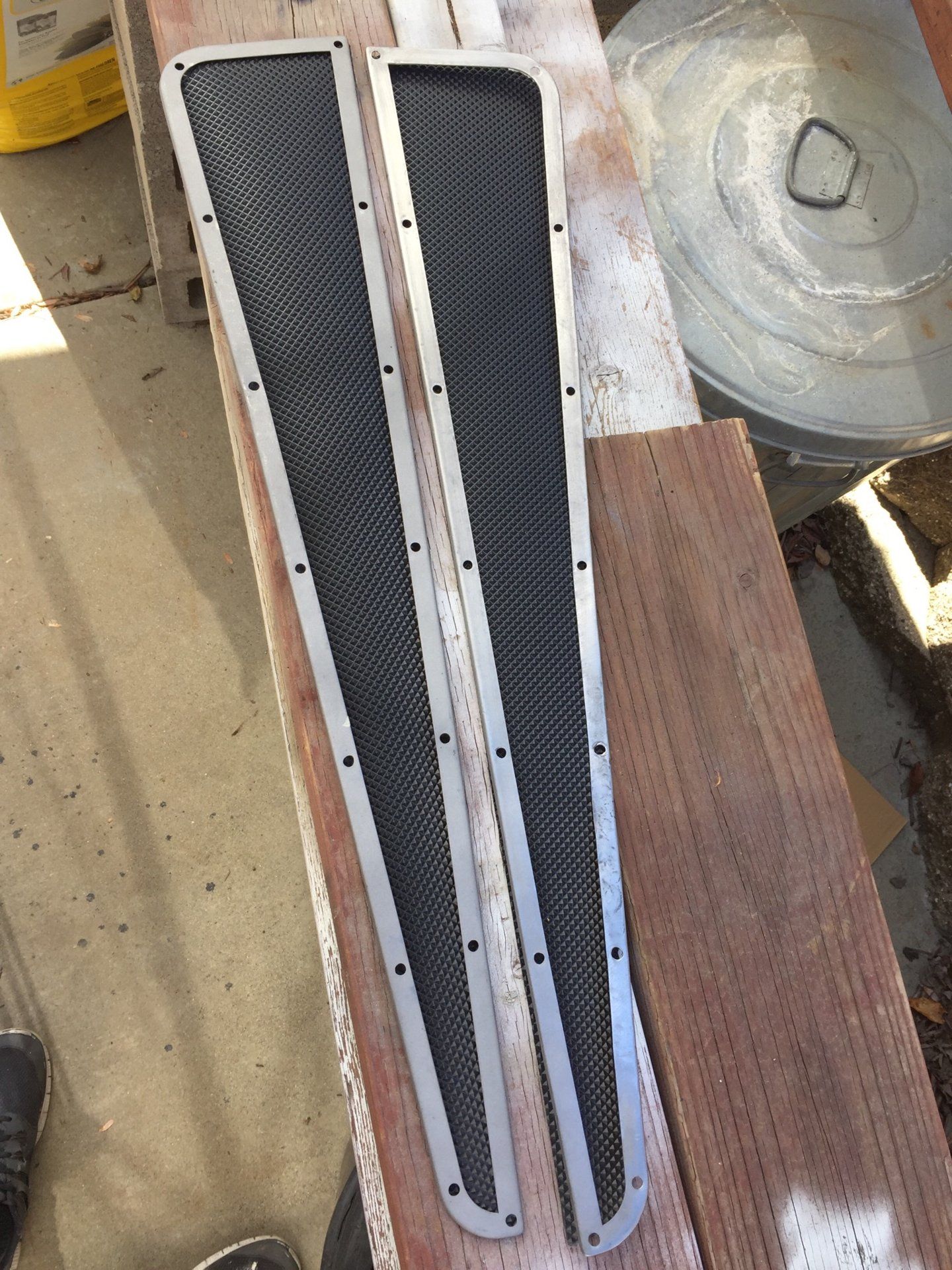

Just got these back from having them media blasted. I love the way perfectly clean metal looks :)
I sent in all 3 running ( 2 L and 1 R) boards and 2 top pieces. The extra running board I found in the garage had tons of holes from rust so I am putting that one aside for now.

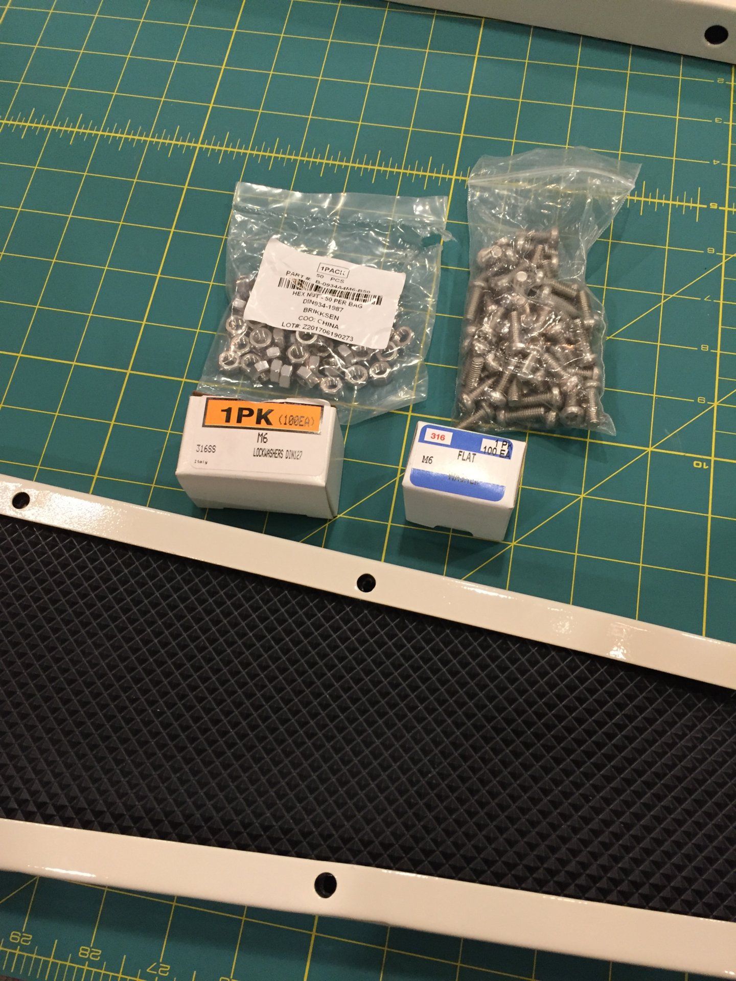

I purchased the hardware from Overland Metric. They look great but are not an exact match to early year hardware. The early years are more of a dome shape. Regardless, they look good and I will continue to use these on other areas on my rig.

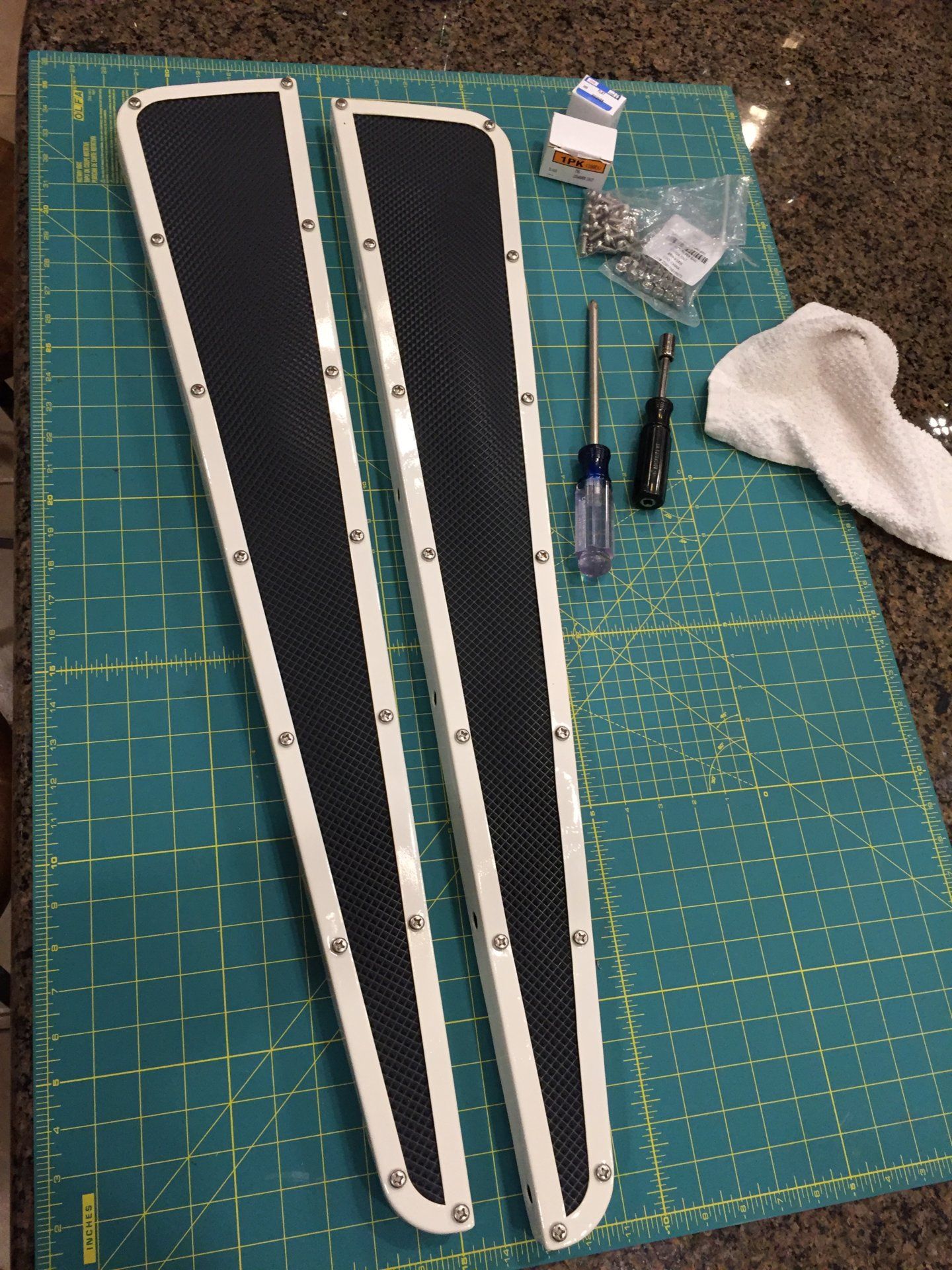

I need to apply another coat here in a few days. So in the mean time I punched the 6mm holes on the rubber matting. I was going to use a standard punch but it wouldnt cut through the rubber. I picked up a pack of metric hole punches for $10 on amazon. They did the job :clap:

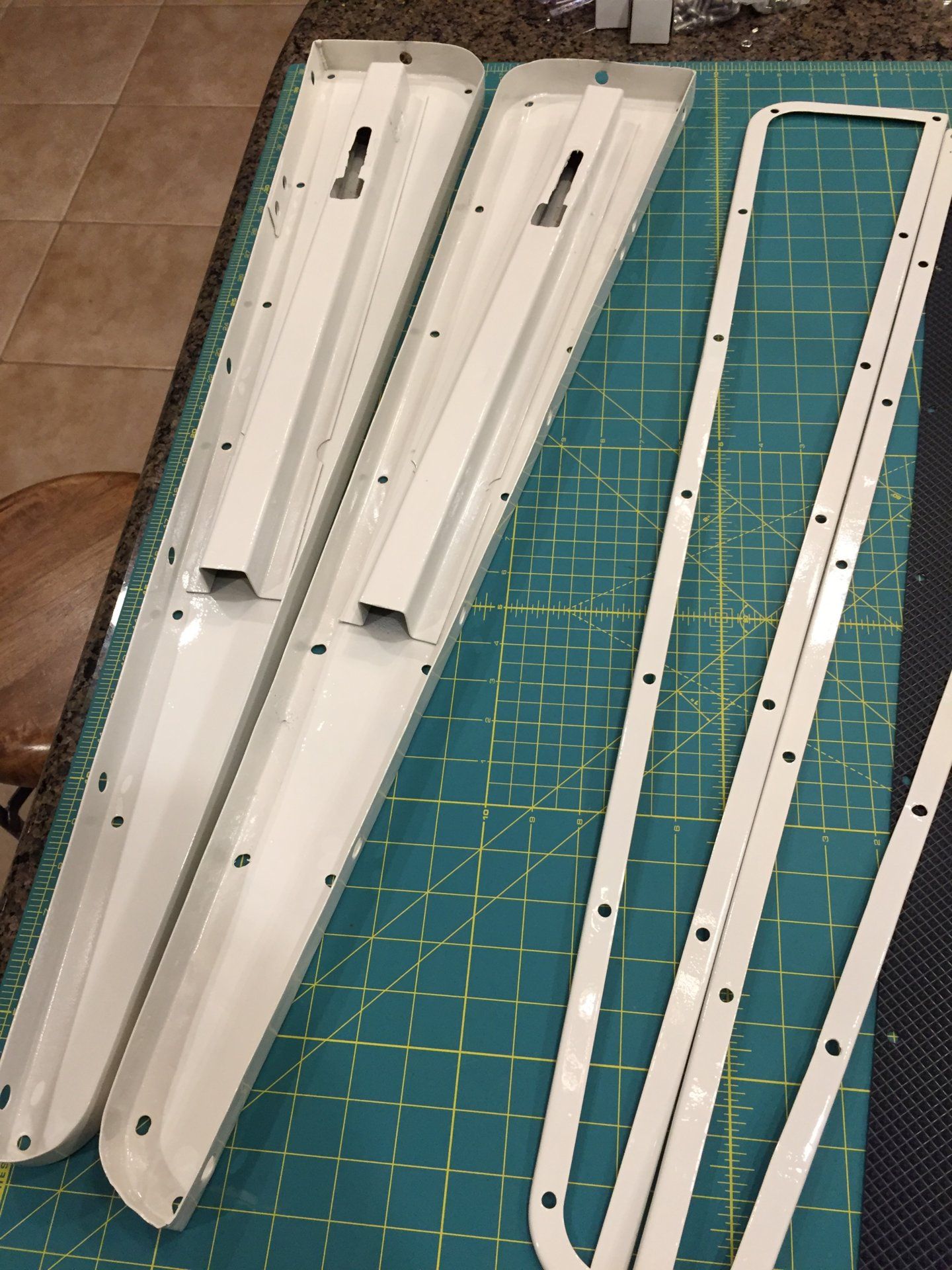

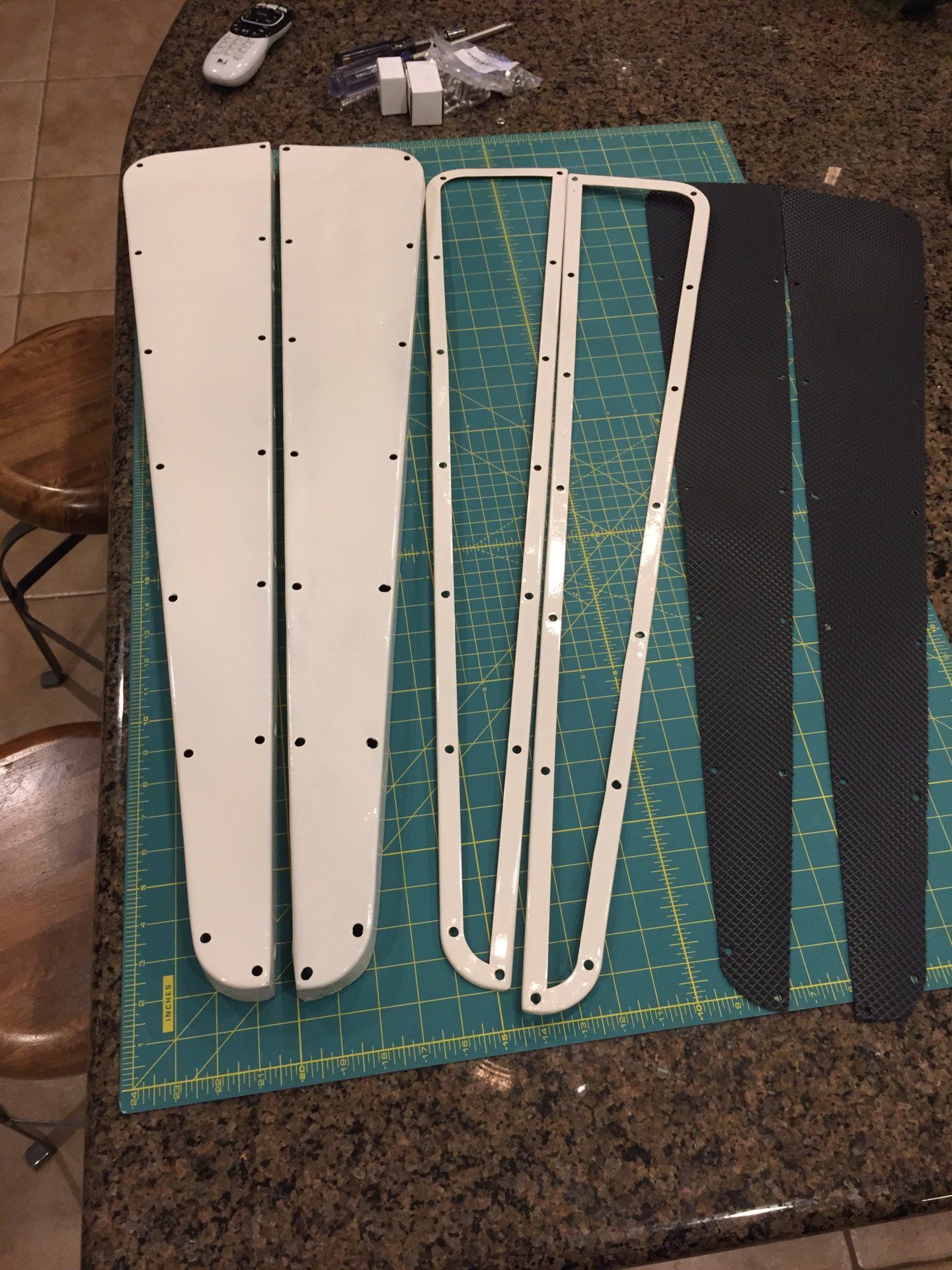

I epoxy primered these the other days and then used some body filler to smooth out some of the small side dings. Looking back, I probably should have used a filler putty but they still came out nice. I only needed to do this to the sides you see when they are on. After they were smooth, I applied another coat of epoxy primer to seal them up before I painted.

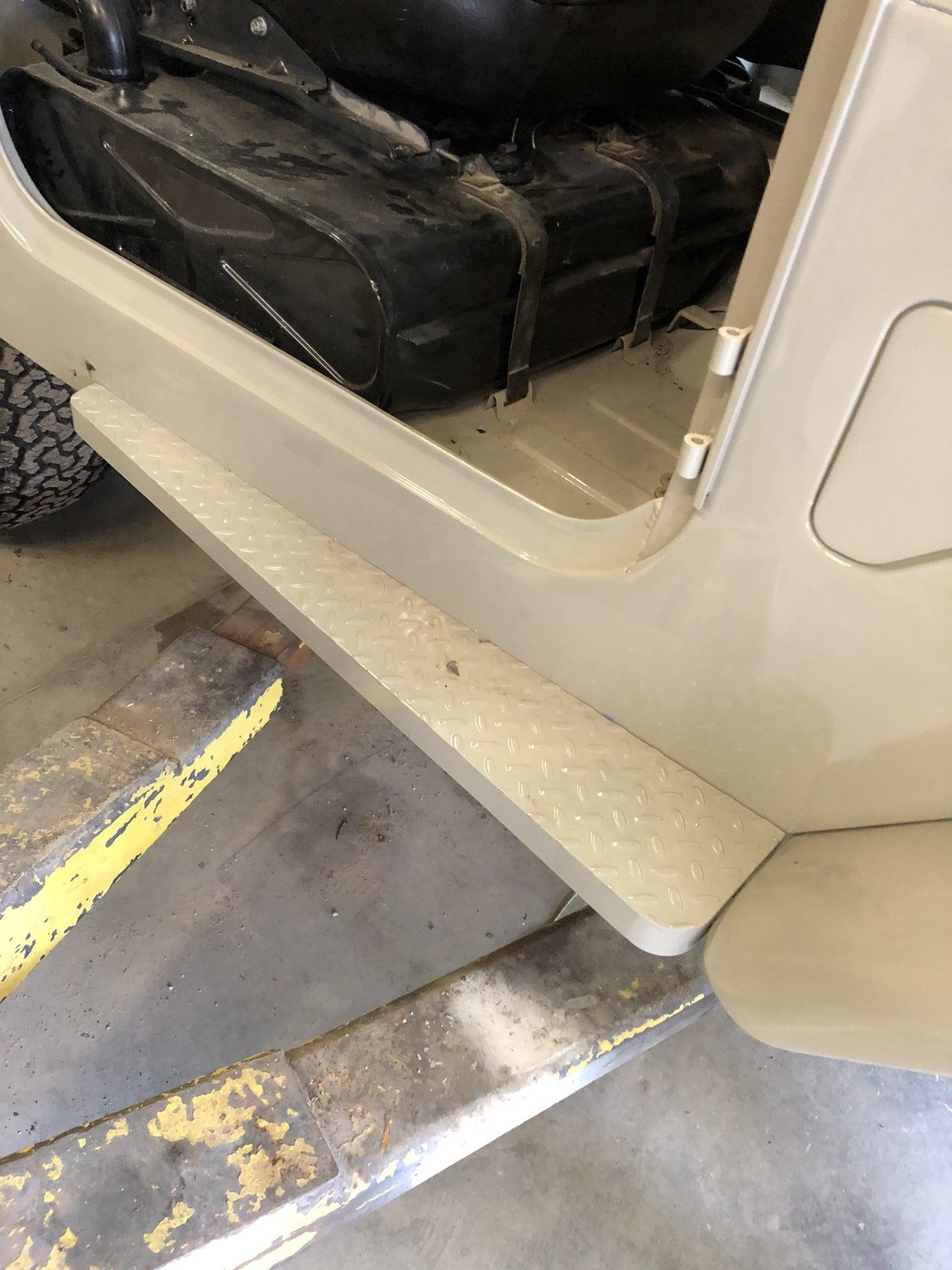

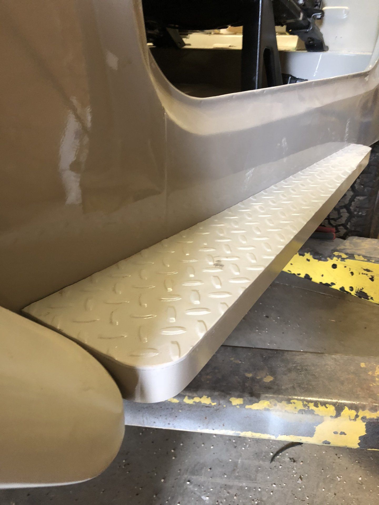

I finished painted the running boards yesterday and put them together today. :bounce: I purchased stainless JIS heads but unfortunately they are not an exact match to original. The original hardware was more dome shaped. These still look good though.
Putting them on the rig tomorrow and I will post some final pictures. Special thanks to @kevos37 for reshaping and welding these things up! They came out great!

I decided against the white rubber with the white paint. But could always switch back once I paint my cruiser to a stock color. Unfortunately my wife is telling me that will be around 2118. :D

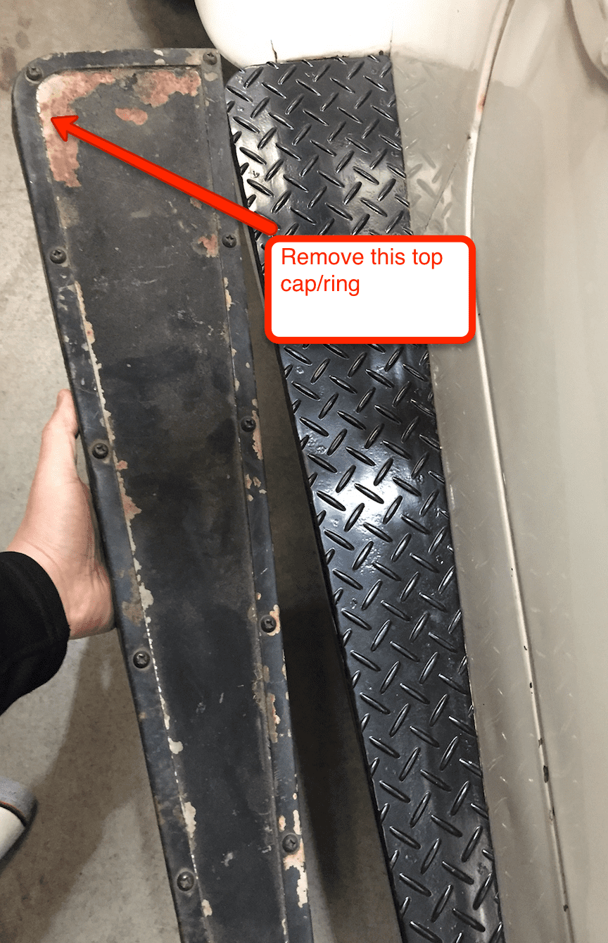

I picked up a set of early running boards that I plan on restoring. They need a ton of work as the passenger side is pretty beat up and the bottom channels on both are gnarly (The board pictured is the better of the two). The sides of both are really wavy and dented up. I am going to do my best at shaping the metal again but this isn't my forte.
I was racking my pea sized brain on how I can restore these boards. I think I have an idea but it might be challenging.
Let me know if anyone has a better way to approach to fixing these.
1st - My plan is to take the new running boards apart and then have them media blasted.
2nd - Start working out the dents and bends on the top ring pieces. This is the piece that holds the rubber floor material in place.
3rd - I will then take my existing floor boards and remove the top diamond plated cap by cutting the welds off that hold it in place.
4. Once I have the top rings from my new boards off, and the bottom piece from my old boards cleaned up, I can then combine those two pieces.
Here are some pictures. The new driver side board I am holding is in MUCH better shape then the passenger side. That one is all jacked up. Of course I will include the appropriate rubber when I put them together.
