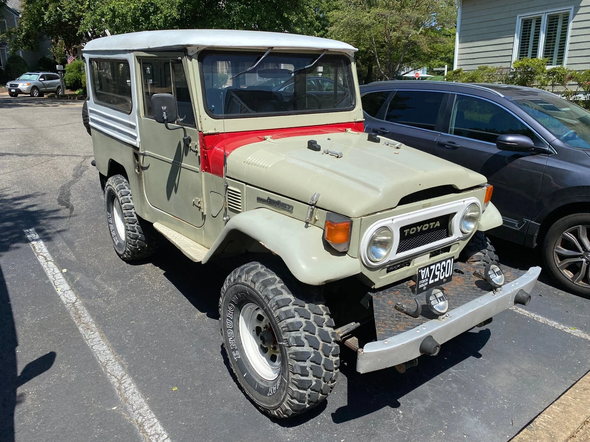

I bought this truck off of the MUD board in August.
Limped her off the car carrier and up to the garage. Really need to look her over to see what I want to do for her. I have a desire to do a smaller budget version of what the FJ Company has been doing to the Fj43s that they sell. Clean, simple, sound.
Wheels for certain. New 15" rims with tall skinnies. Swap out the front turn signals for some early round ones. I like the original side mirrors more than the 80's version.

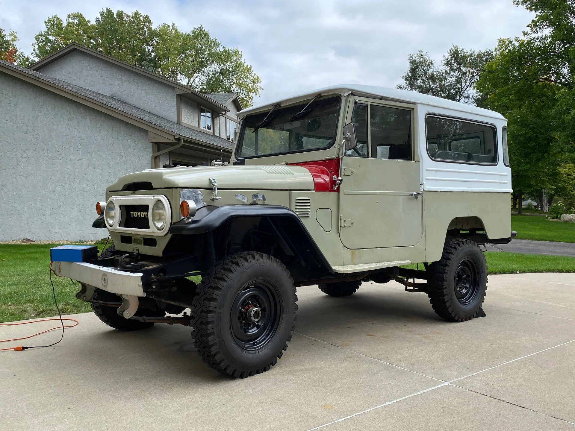

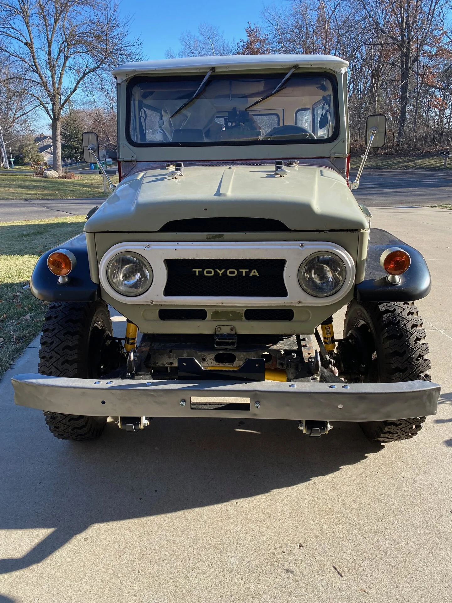

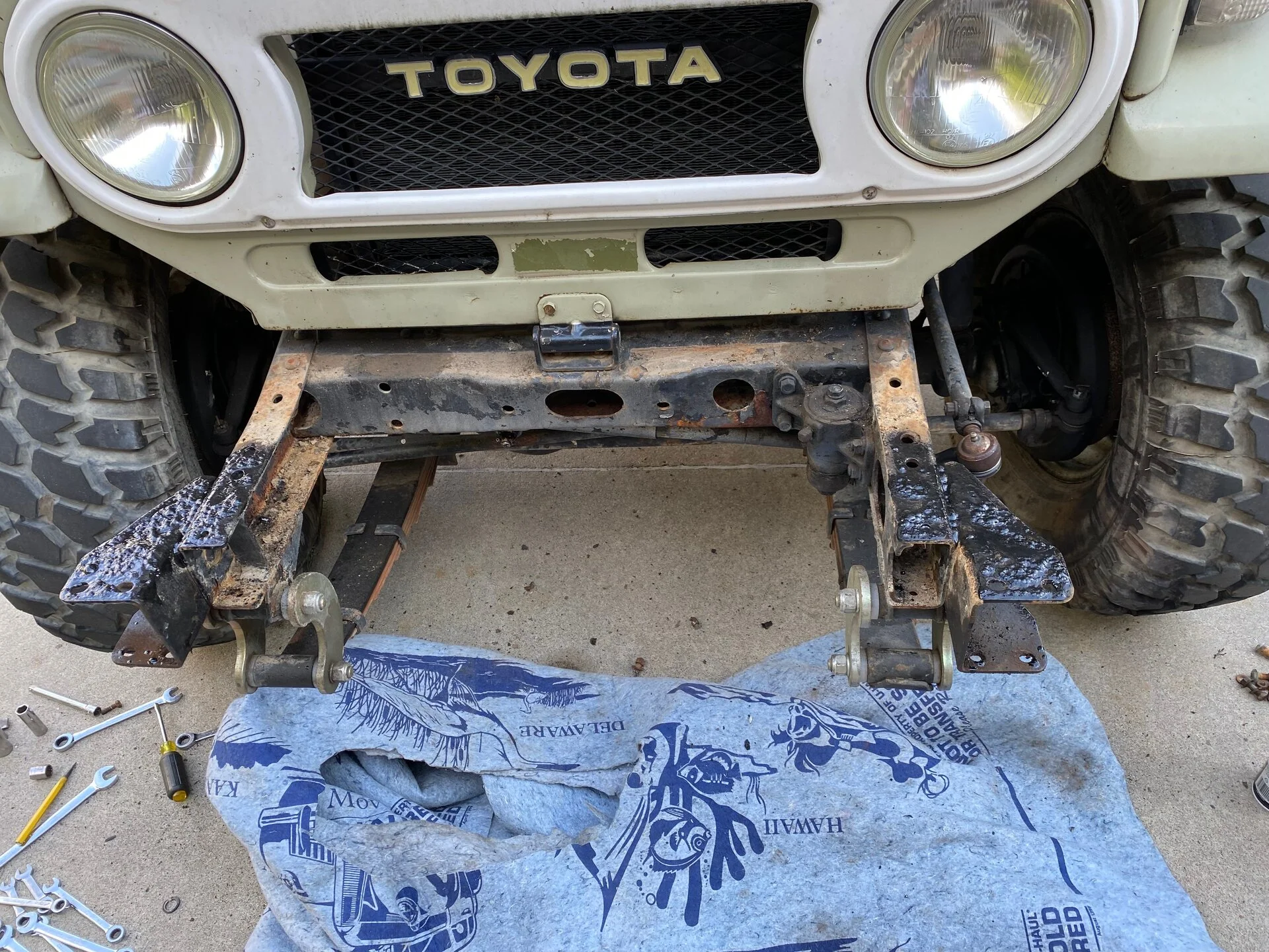

Lots of bondo on the fenders. Decided to put new OEM ones on. Cleaned up the front bumper. Removed the diamond plate support and the fog lights. Had some of the holes filled in and then powder coated in anticipation of an 8274 Warn winch installed. Ordered a winch plate from @powthief19. Holes in the aprons from the later turn signal housings are now filled in.

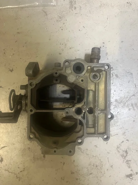

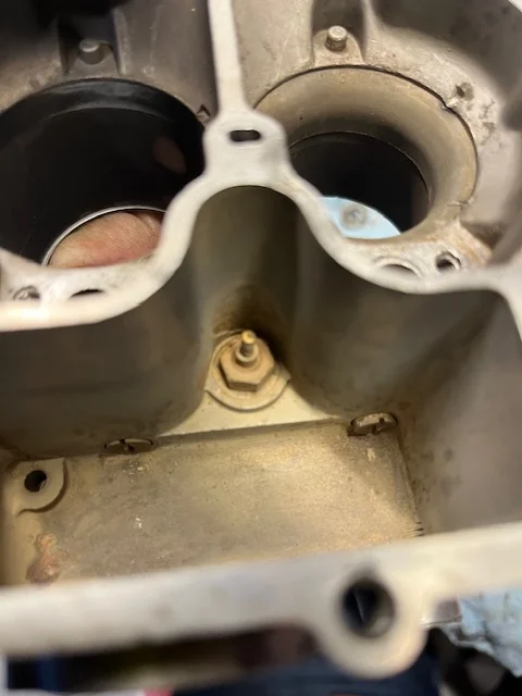

The exhaust is a mess. Decided to go with a header and new, larger pipe out the side. The carb looks to be a bit jenky. I managed to get it and the intake manifold removed. Definitely been messed with over the years. Sending the manifold to have it decked and the carb studs redone. Sent the carb to Mark's Off Road to have @65swb45 fix it, if possible.
Took Matt’s carb apart Tuesday. When I called him to discuss the post mortem, the top of my list was the prescient phone diagnosis i had made the week before based on his description of the symptoms: bent float!
The carburetor had been more or less brutalized by the last ‘person’ ( and I use that term loosely) that had been inside it. I’ve had a few dozen over the decades where the power valve was frozen. But never one that was broken and left in place!
Without the spring to retract the internal piston, the valve was open all the time! It literally took three seconds with the right tool to take it out.
The resulting overly rich mixture probably helped compensate for the lackluster performance of the accelerator pump. With the spring removed from the chamber, I dropped the plunger in and it fell straight to the bottom of the bore (which is not a good thing).
All these things are fixable. What is not is the kluge of fittings screwed into the inlet that vaguely resembles the leaning tower of Piazza.☹️
After discussion, we elected to replace the air horn.😉

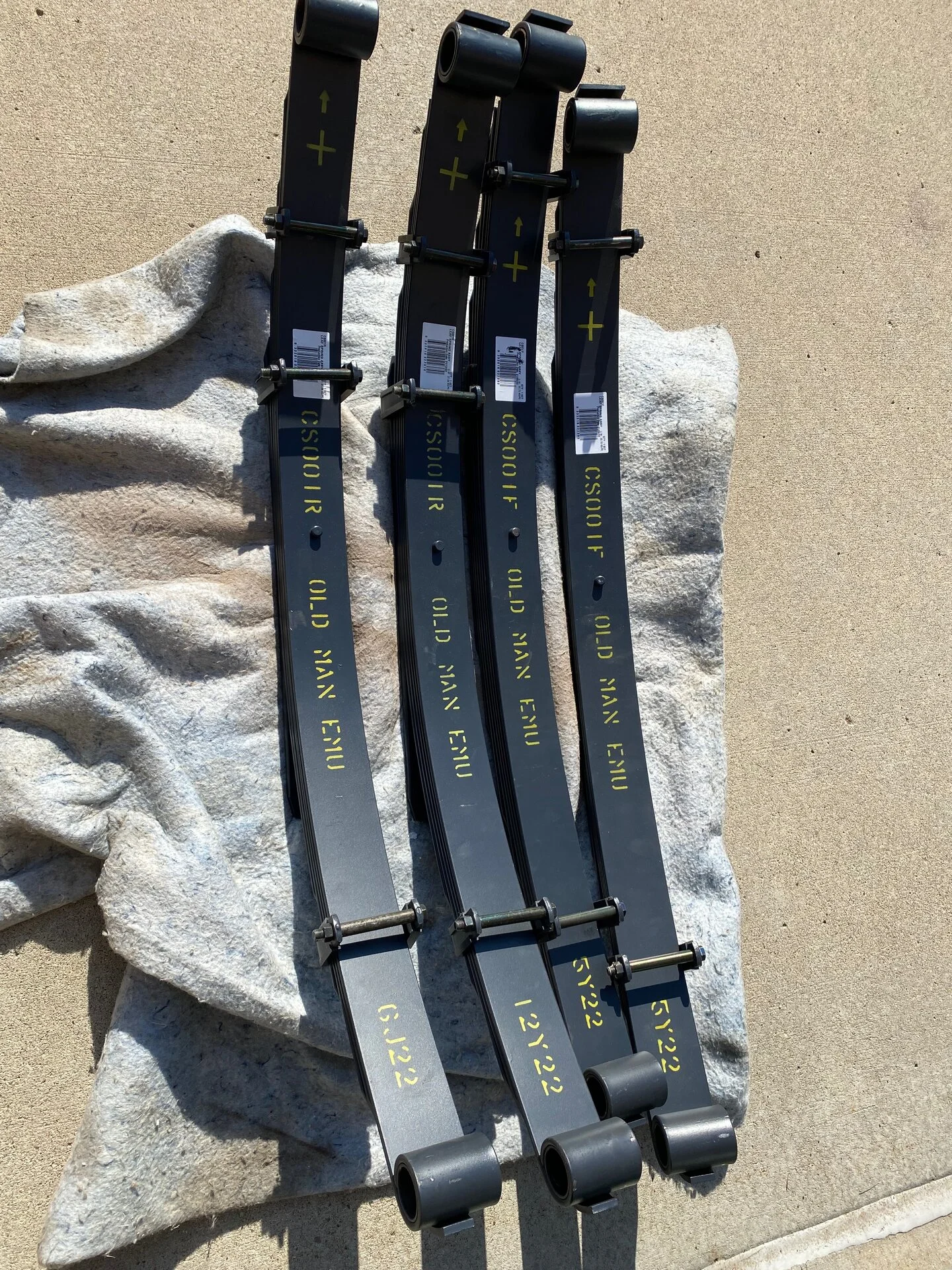

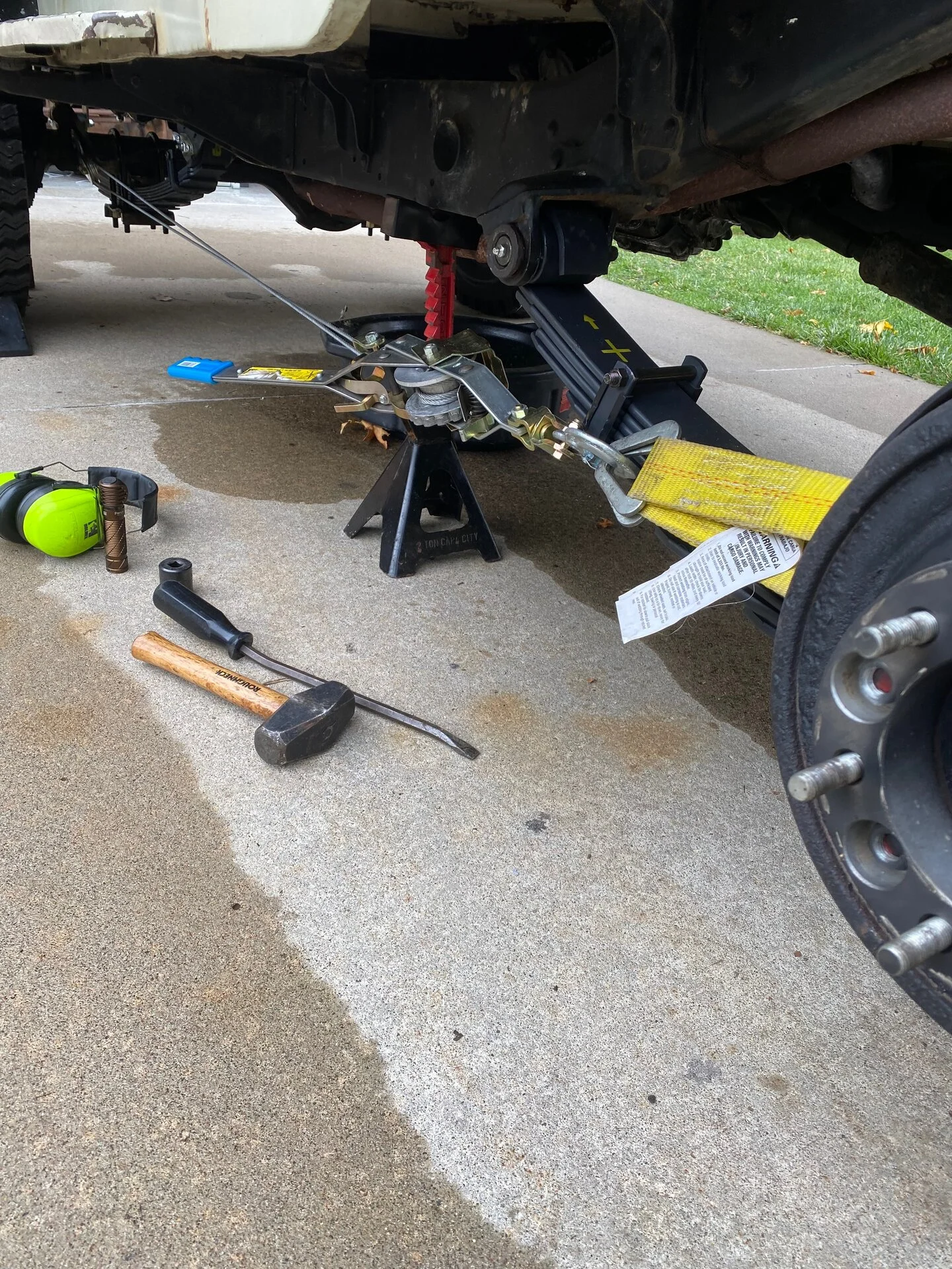

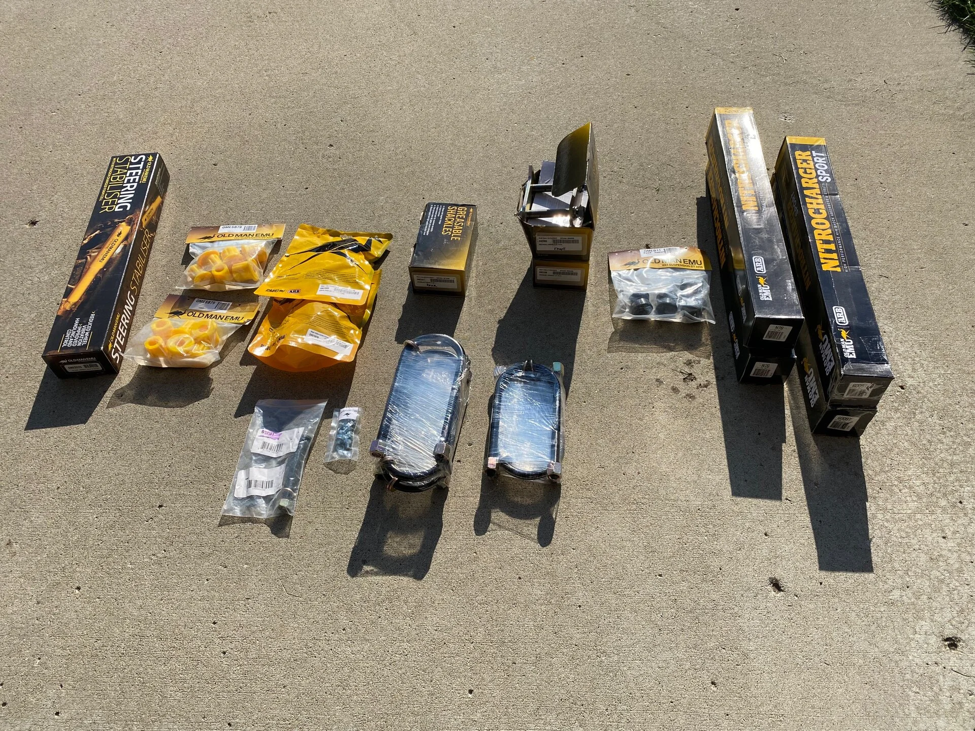

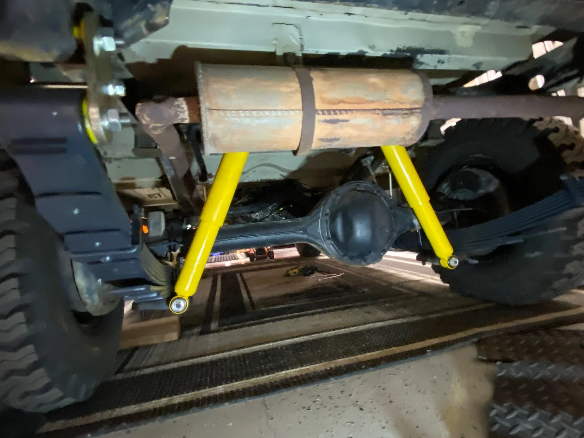

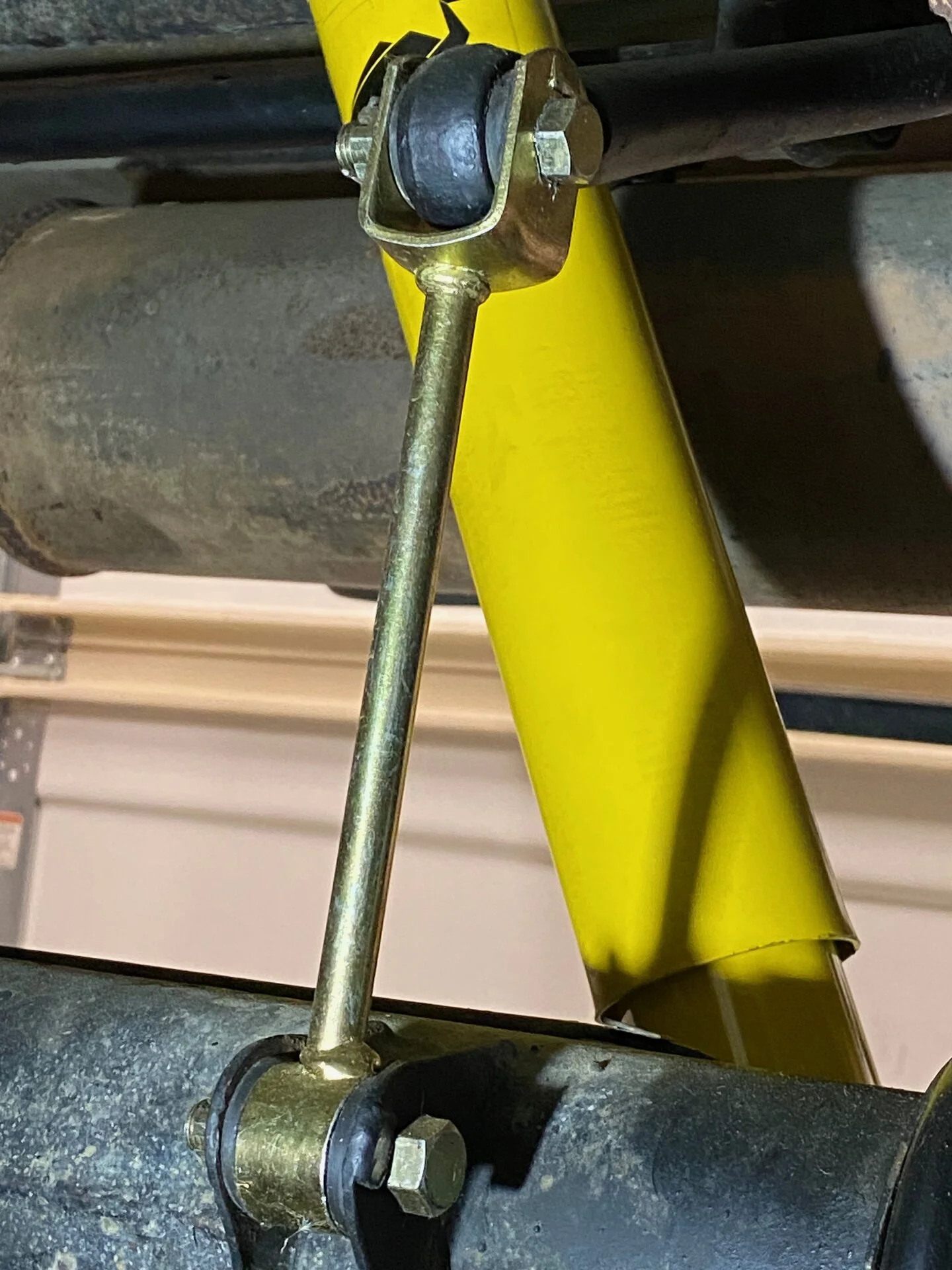

Not a fan of the 5" inch lift with the major sag in the rear passenger side leafs. Ordered up a Old Man Emu 2.5" lift kit from Cruiser Outfitters. Successfully got the rears on in one afternoon. Fronts installed in another afternoon. Got creative to pull things into place with a strap and come-along in reassembly.

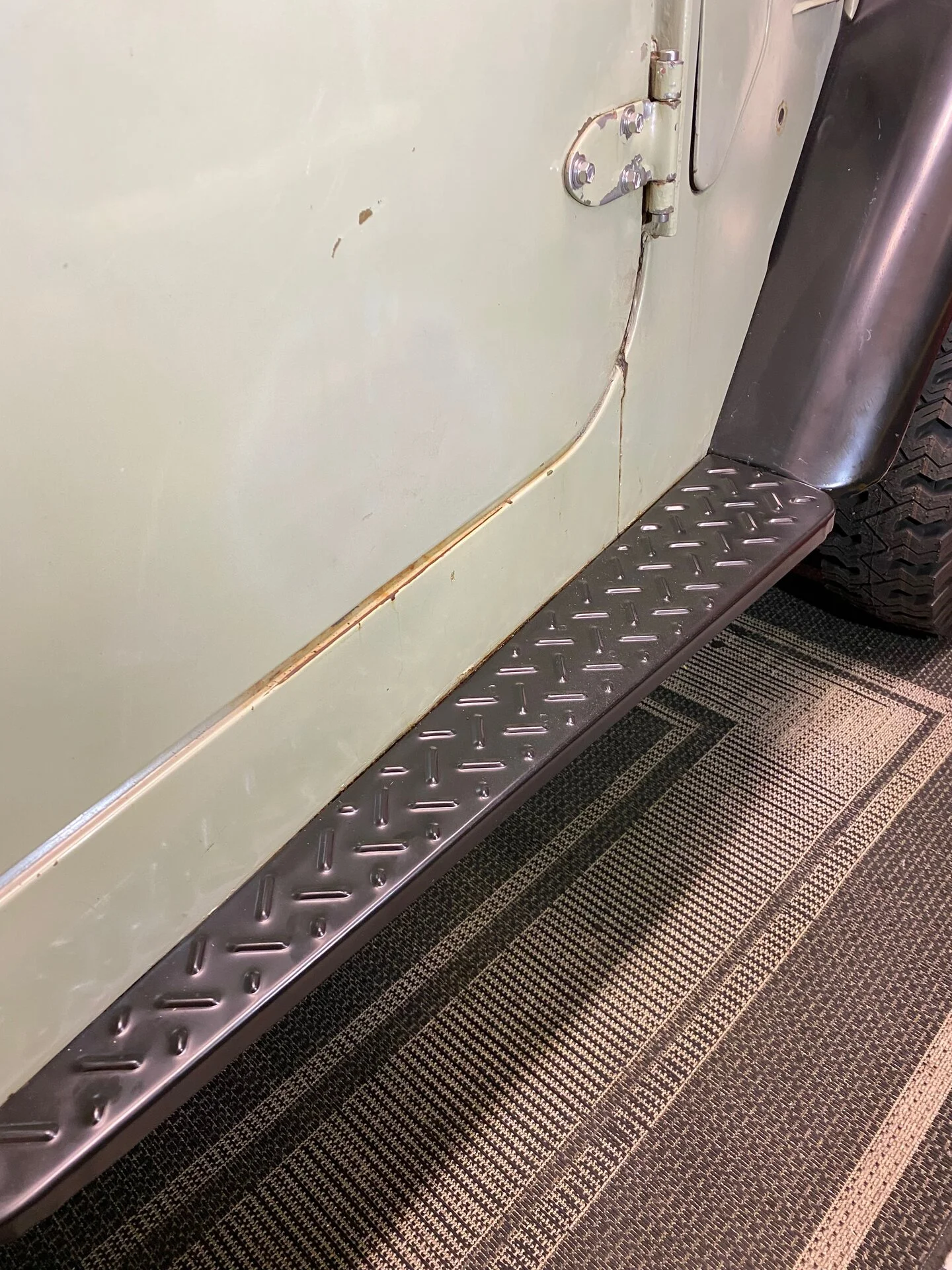

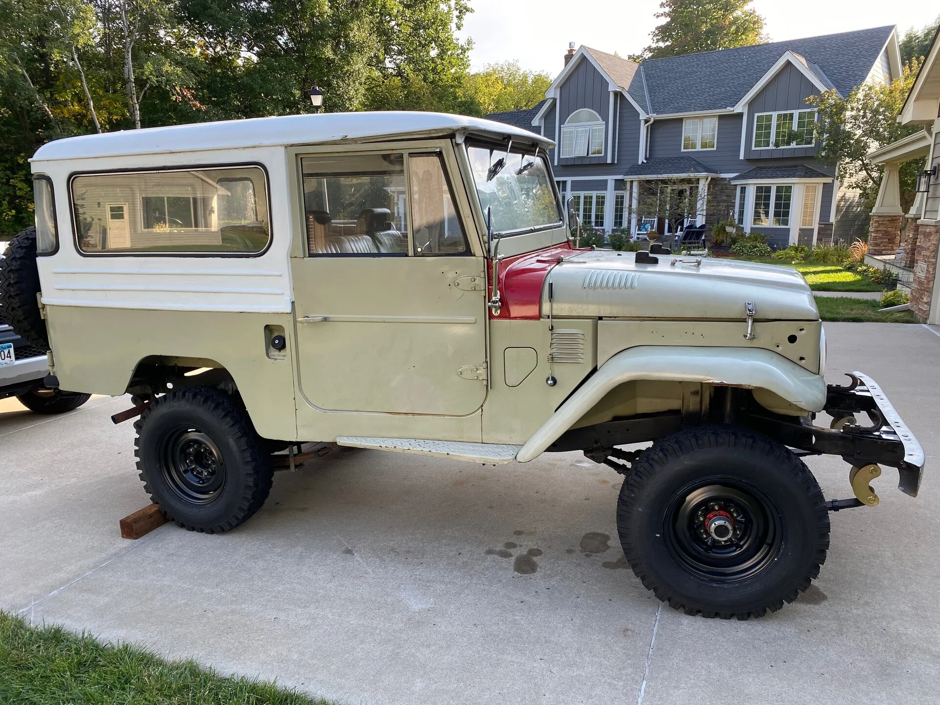

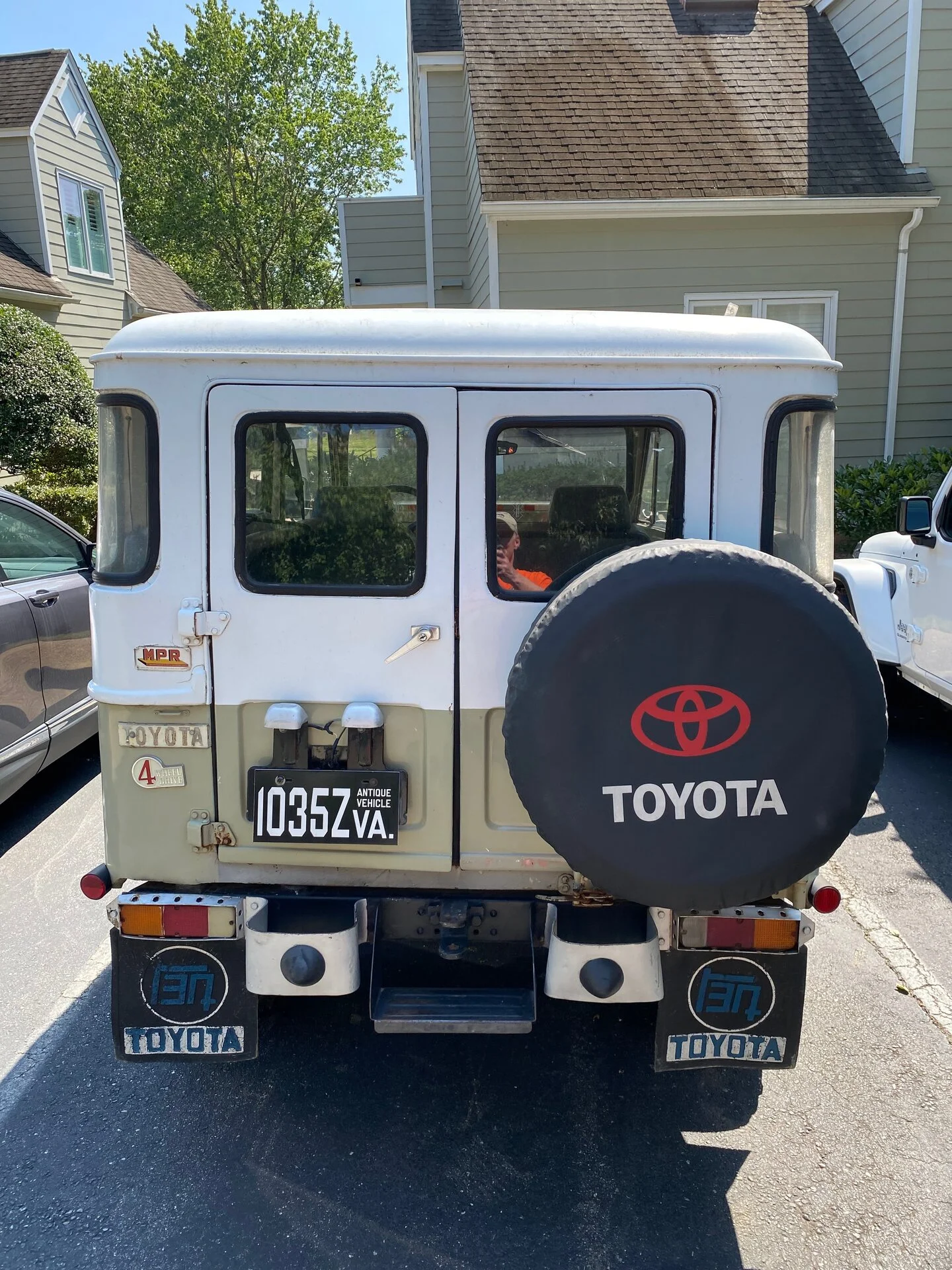

Truck sits with a nicer stance now. With the new fenders in place the running boards didn't seem to fit all that well. Removal and examination showed that there were extra bolt holes and few of the other holes didn't align with the body holes. Bought a set of OEM running boards fixed the problem. Easy install.
