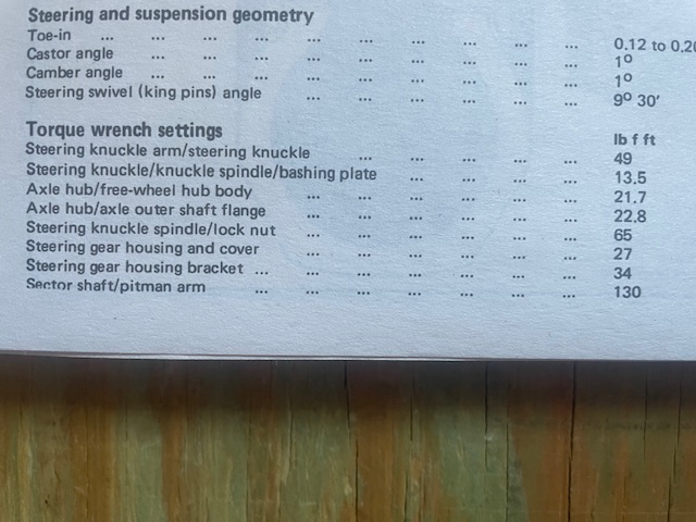

I know about RTFM already. I'm scared to tighten this spindle lock nut up to 65 lbs. Just wanting to know if anyone has actually tightened theirs to that much torque before? My manual says to do it that much but I'm just paranoid of stripping these threads. I already had one close call and just don't wanna have any setbacks.
I rarely use a torque wrench. Doesn't it say something like torque to 50lbs, then back off an 1/8 or 1/4 turn? I spin the hub a bit once torqued then spin it after backed off an 1/8 turn. Install the star washer and torque outer to 50.
I'll post a picture of what it says in my manual but I'll go 50 lbs and leave it. Thanks for the advice.
Are you concerned about the key on the star washer, jumping the key-way and cutting thru the spindle threads? Is it a new star washer?
Yeah all new thrust washer, nuts, and lock washer from Cruiser Outfitters. I'm just afraid of ruining the threads on the spindle or the nuts. Seeing how this thing is put together and realizing that those nuts are what keeps the wheel on LOL.

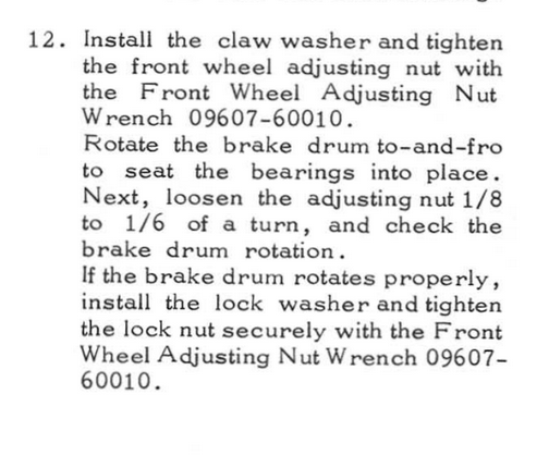

It says 65 but I'm sticking with 50. Manual says to tighten and then back it off 1/8 to 1/6 of a turn. I did about 1/6. My home brew spindle socket was plenty deep and fits just fine.

The 2nd nut should just get torqued and not backed off.
Right I did know that. I have done lock nuts on my tool box before but these are just so thin I was questioning putting this much torque between such few threads.
65 lbs is not an insane amount of torque. The nuts are thin but the force is distributed over a wide area due to their large internal diameter.
If you're really concerned about the wheel coming off, I can't see why you'd be tempted to second-guess the Toyota engineers. :meh:
Yes, but the area of a cylinder-shape gets substantial with diameter. These spindles are huge.
I recall an engineering lesson from the machine shop. It was that the vast majority of thread strength and tension holding occurs with just three full turns of thread engagement. I'm not sure if is folklore or not.

Interestingly, the 1971-1974 Toyota FSM is silent on torque values for the adjusting nuts. It just says to "tighten" them. So maybe 50 lbs is ok? 65 is probably also ok. Carry on.
Thanks to Cruiser Cult, the FSM is available here:
I printed a copy and put it in a three-ring binder. I refer to it constantly in rebuilding my '72.

Thanks. I went to Spectre and downloaded it. This is what Cruiser Outfitters showed me also and that's why I was getting ocd about it LOL. I'm just gonna see how 50 feels at first and then go from there.

Just wanted to say this for all the noobs like myself. For 1974 FJ40, RTFM is correct on the Haynes manual. You can tighten the spindle lock nut (outside nut) down to 65 lbs no sweat.
