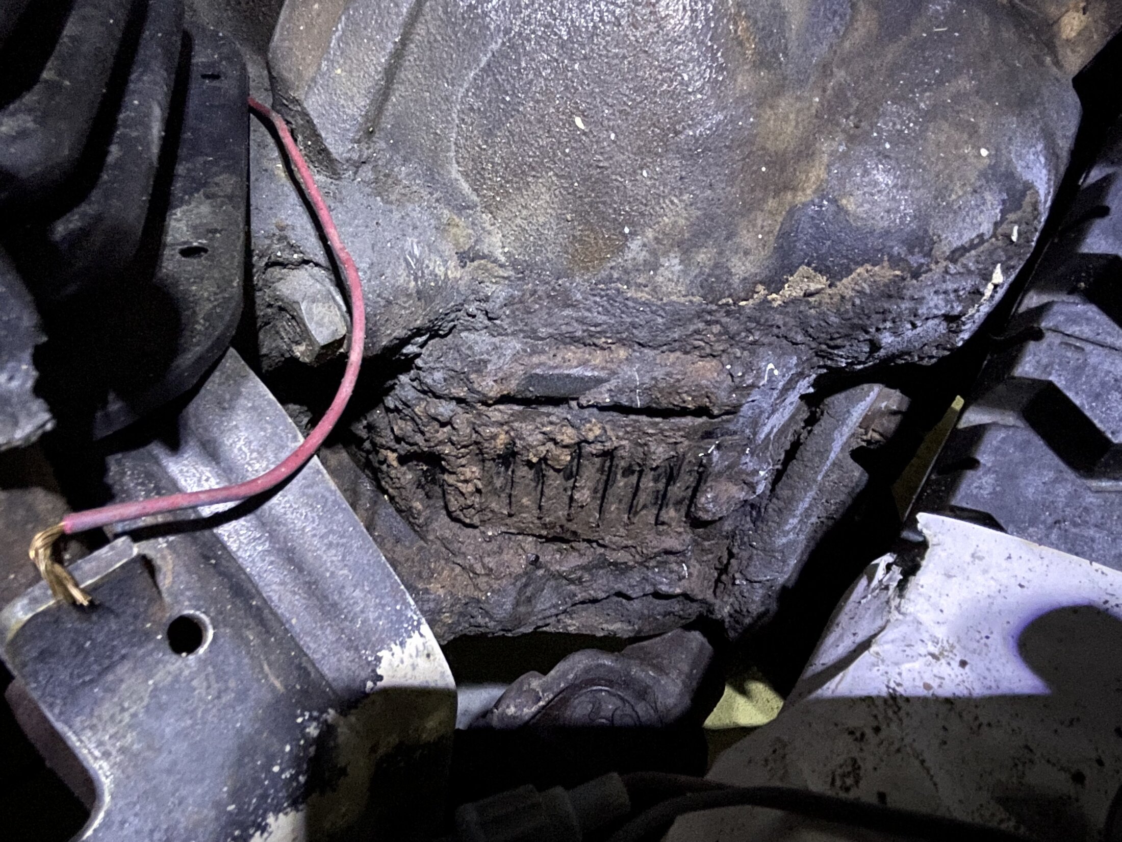

About to replace the clutch. I saw this vent looking part on the right side of the tranny. I know these things are built for abuse, but before I get after this thing with wet blaster and angle grinder with wire wheel do yall have any warnings or does this thing look compromised to where I need to do something else before cleaning it all up?
Nope, unbolt it clean it up and slap it back on. Left side bolt only needs to be loosened but right bolt needs to be removed and it slides right out
